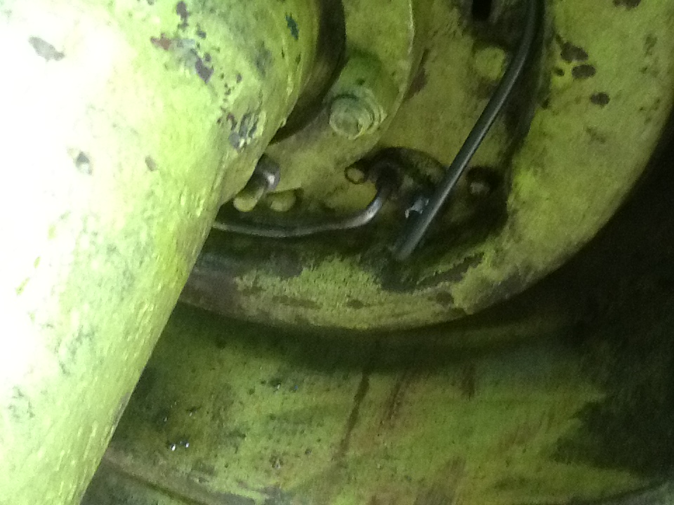

I got a bunch of other stuff done I have not listed yet, including pressure washing two inches plus of oil buildup off the rear axle. I got a handful reaching up there. The steel brake line is crushed with vise grips at the right rear wheel, likely because that wheel cylinder was leaking. So I took a measurement to replace it. I also gathered other information. The plate that locks the lower articulation pin nut in place is missing, and the nut is backed off a little. Terex wanted a crazy amount of money to have one made, they’re out of stock. I will make one. I said I was a machinist right?? It’s a 3-1/2” hex with two 5/8-11 bolts holding it, and I will Locktite this time.

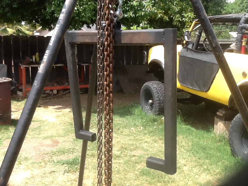

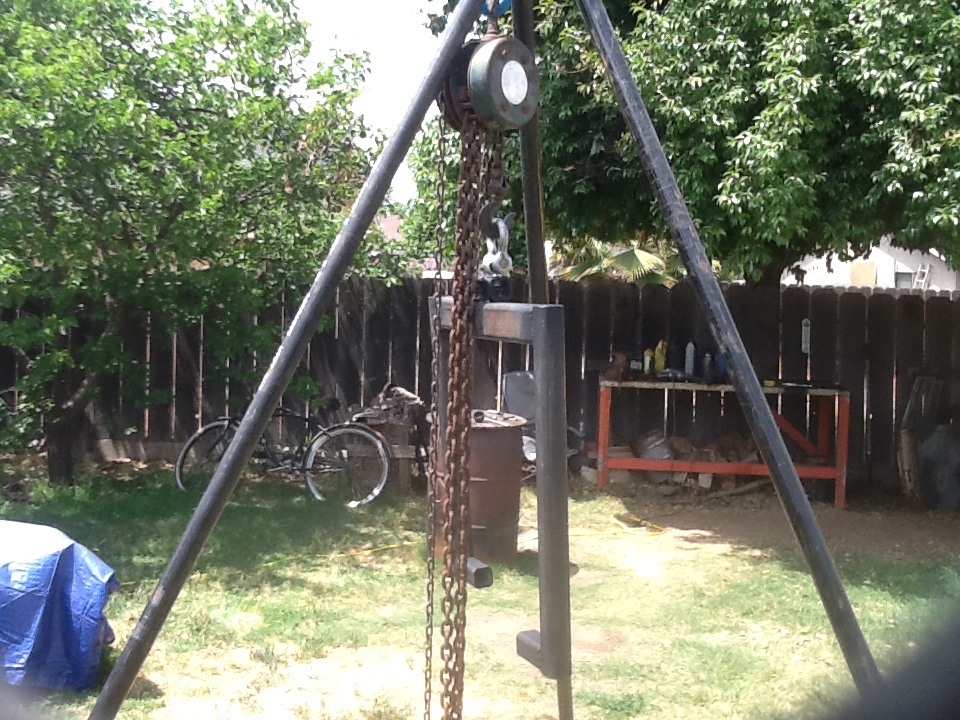

Also measured and took notes to build something to lift the wheels using a chain hoist, gonna build a tripod to hang the hoist from. And checked lug nut size, there are thirteen nuts that take an 1-1/8” socket. I got a lot done this last trip, and lined up more to do before I go back up.

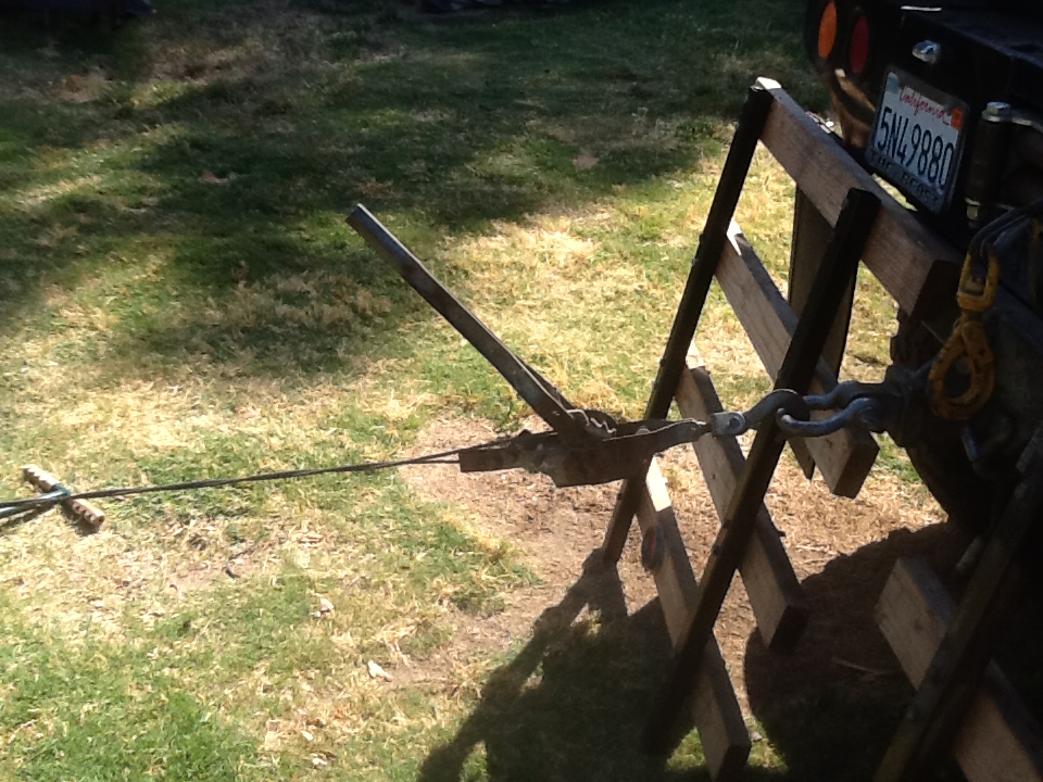

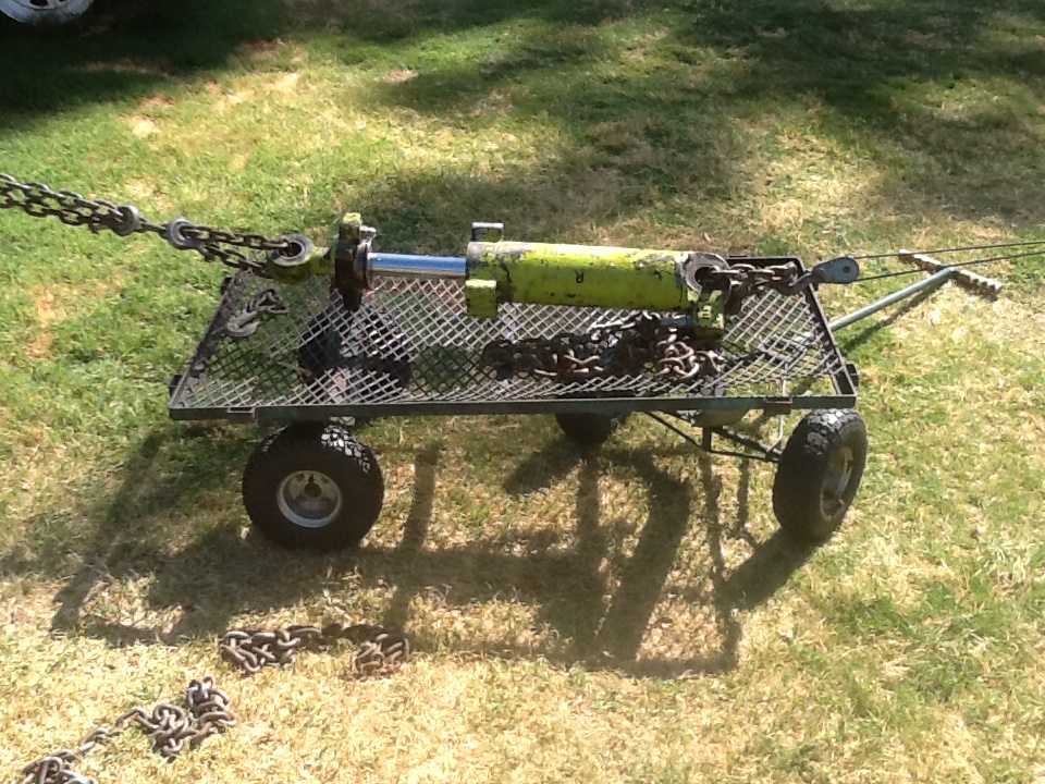

Had to pull it apart with a come along.

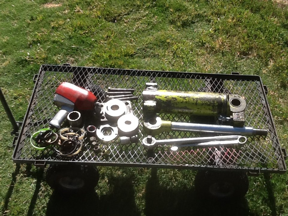

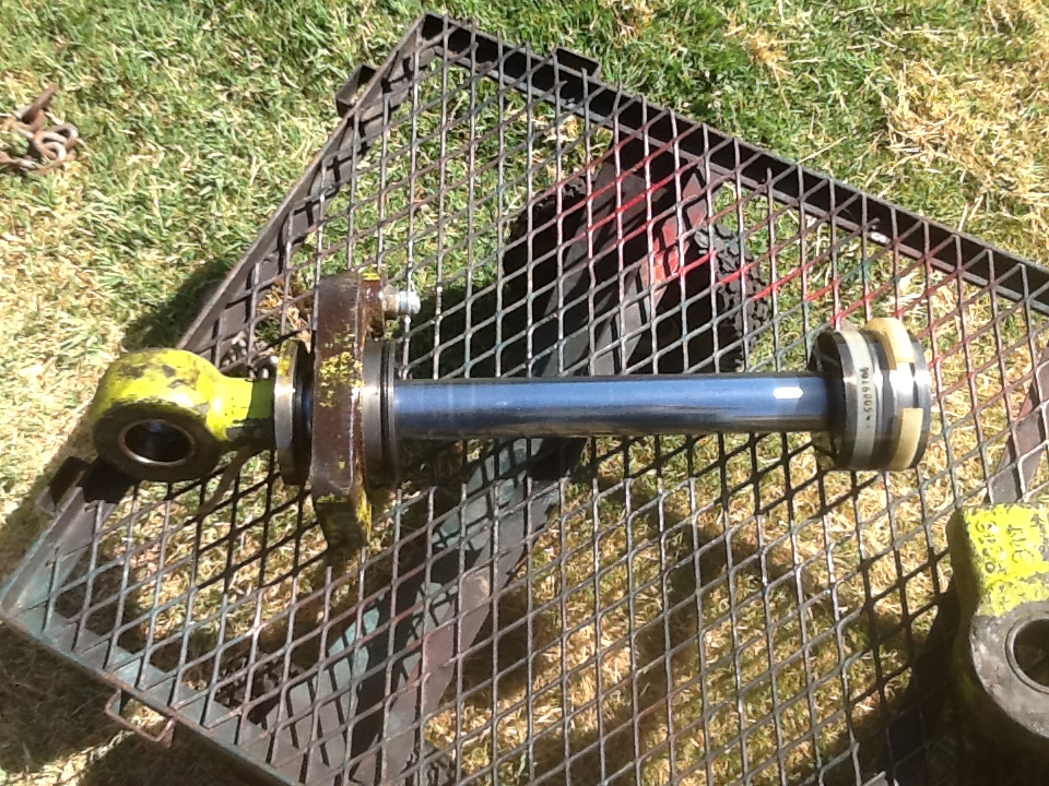

All the new parts match.

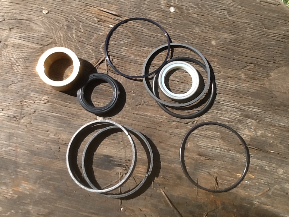

Could not finish the second cylinder, one of the seal kits was packed wrong. Three of the pieces were not right. I will work on getting that corrected tomorrow. I have other stuff to do while waiting shipping.

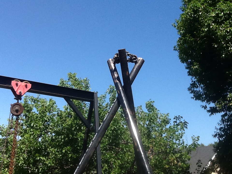

I just ordered the missing part from the steer cylinder kit, and o rings for the steering manifold assembly & unloading valve. Also some fuel line. Because I'm waiting on this stuff I went ahead and built a contraption to lift a wheel off so I can get to the wheel cylinders. My gantry crane is too big to haul.

Replaced the rear right side brake line, the old one was crushed with vise grips to slow the flow of fluid to the wheel cylinders. I know from experience you can't stop the flow completely, even with the vise grip still on.
