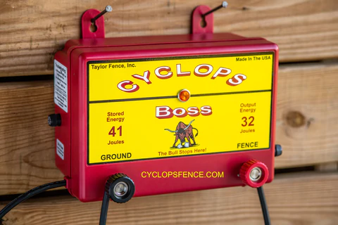

This is the charger I use. It has been the best charger I have ever bought.
It isn't cheap but it's the largest they make.
They make smaller ones ( less Joules) that cost less.

Kenmac very familiar with the Cyclops line , Any cowpoke , rancher , buckaroo, hired hand etc , that accidentally urinates on that 41 joule Boss will instantly be transformed into a female . Hey for fun have you ever tried to figure out how much $ per month it cost to operate it if its on 24/7 . Maybe $18 ? Just a wild guess
They come down some in price @ one time they were near 1K
Big 10-4 on that. Cooks your hot dog instantly. :p
