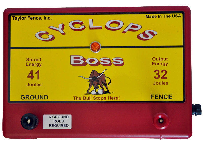

   / Electric Fence Options of Mini Horses. #59
#60
Thanks bullbreaker for that link. If I was going to build a real fence the Cyclops would be at the top of my list.
Around here it is hard to have a garden because of the deer and I know this charger would be great for that.
