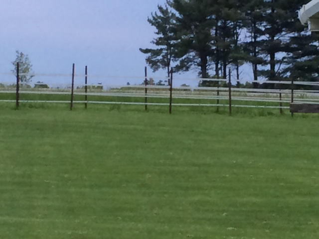

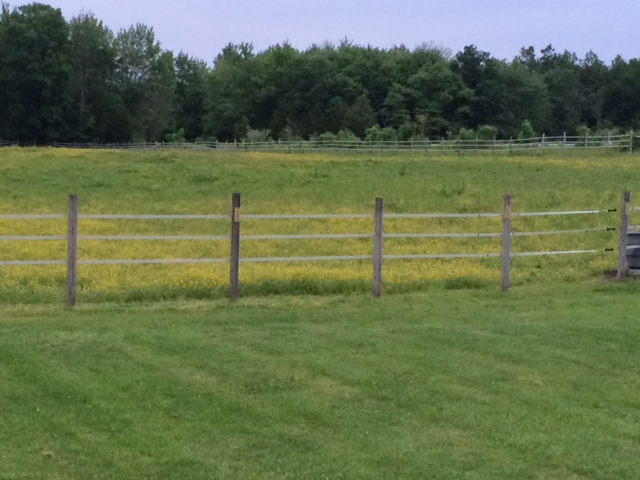

We have had horseguardfencing installed for 15 years. The horses, deer and humans can see the white tape. I used their lag screws for the line tensioners and McFeely square drive stainless steel screws for the line brackets. A pair of scissors, tape measure and a cordless drill with a square drive bit are all you need to install it. Some places I used T posts and they also sell sleeves that cover the posts and work with the tape. It really is pretty simple to install and it lasts.
The first photo is of 3 strands of tape on 4" x 4" x 8" PT posts, the second is white tape on T posts with brown sleeves.

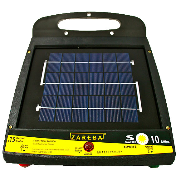

I plan on ordering 1 like You just got , but look again Gale on bottom left hand corner of charger it says ".15 joule" .
Still one heck of a deal , those things go for almost $200 .
