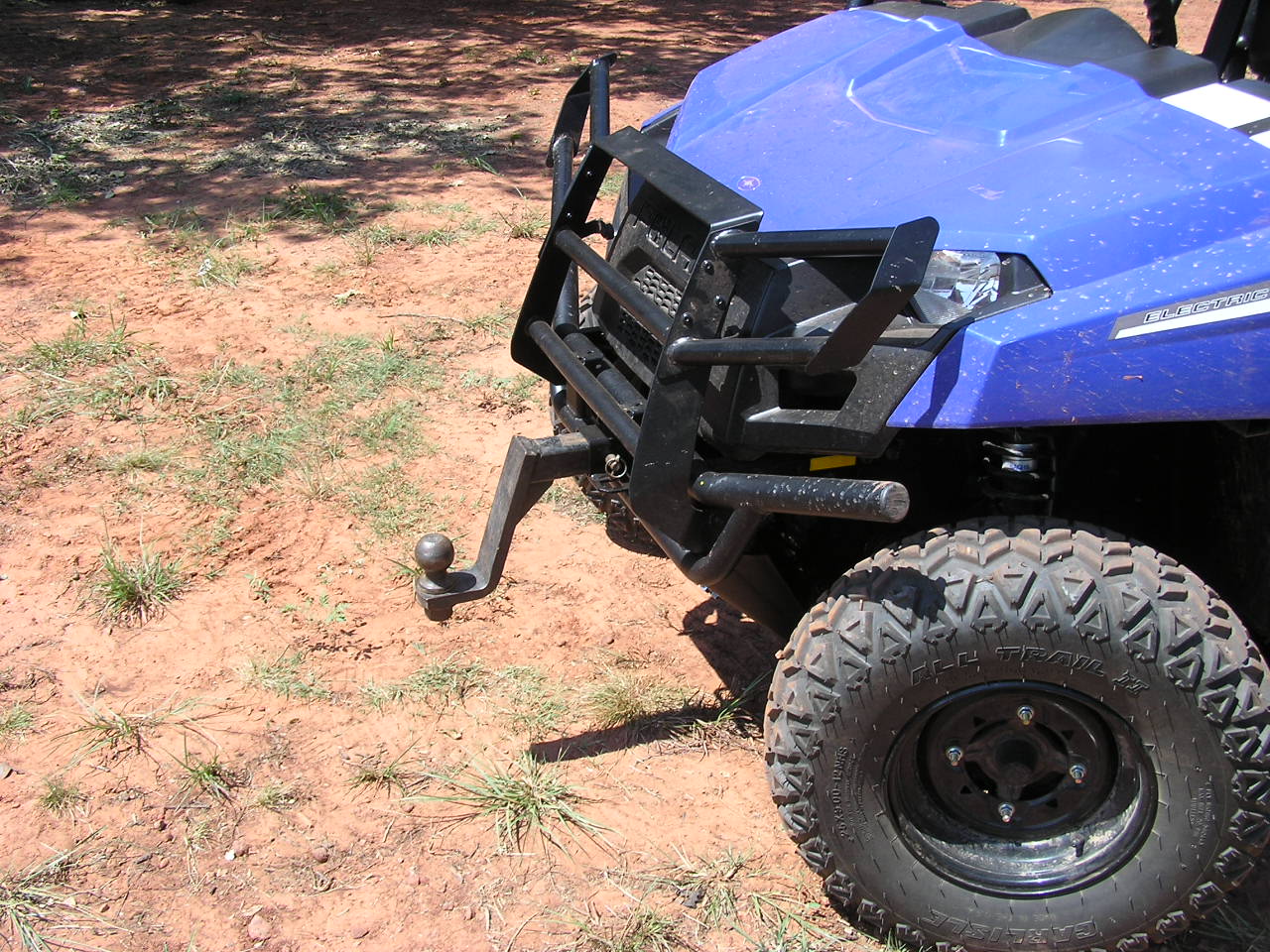

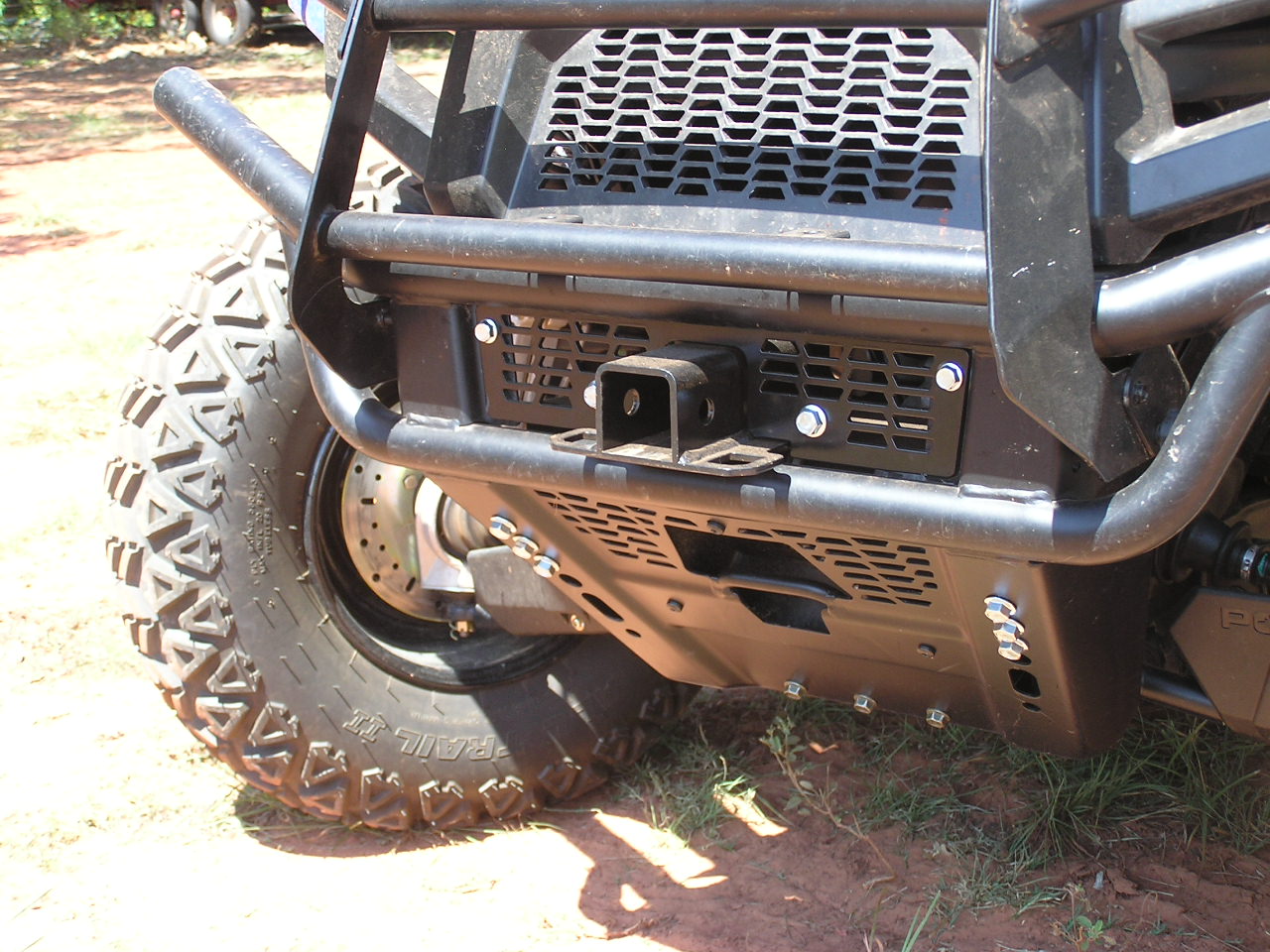

Got the front receiver hitch Installed a few days ago.
View attachment 334155 View attachment 334156
This is one awsome machine, very happy with it. :D :thumbsup:

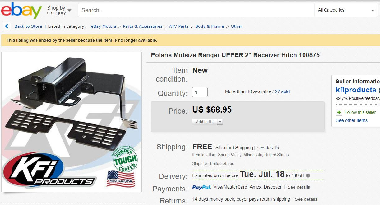

Wondering about that front reciever hitch. Is that a Polaris-made item? Sure looks handy.....and provides lots of protection too. (I'm always worried about sticks and brush for my radiator vehicle)
   / Electric Polaris Ranger
#14
The receiver hitch is aftermarket from eBay.
The brushguard is an option from Polaris
Polaris Off Road Vehicles: Four Wheelers, RANGER RZR Side by Side ATVs and UTVs
There are aftermarket brushguards available for all brands of UTV's

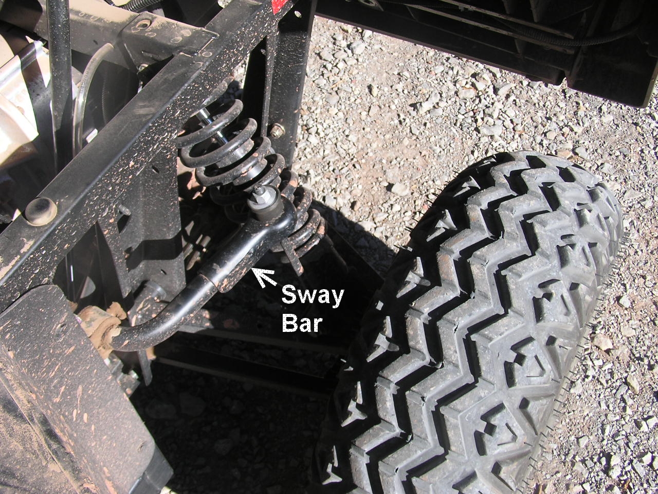

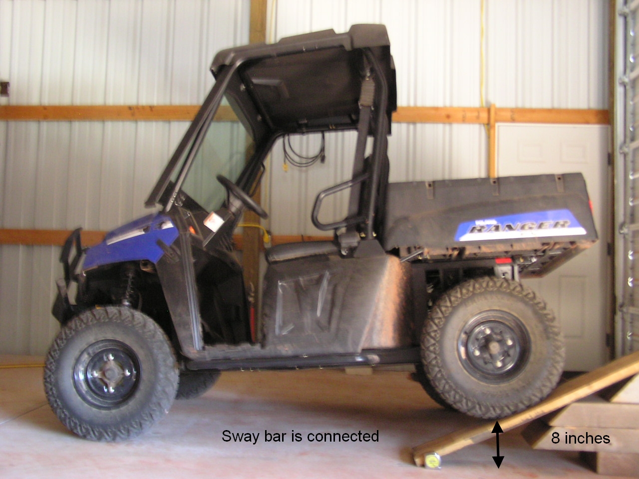

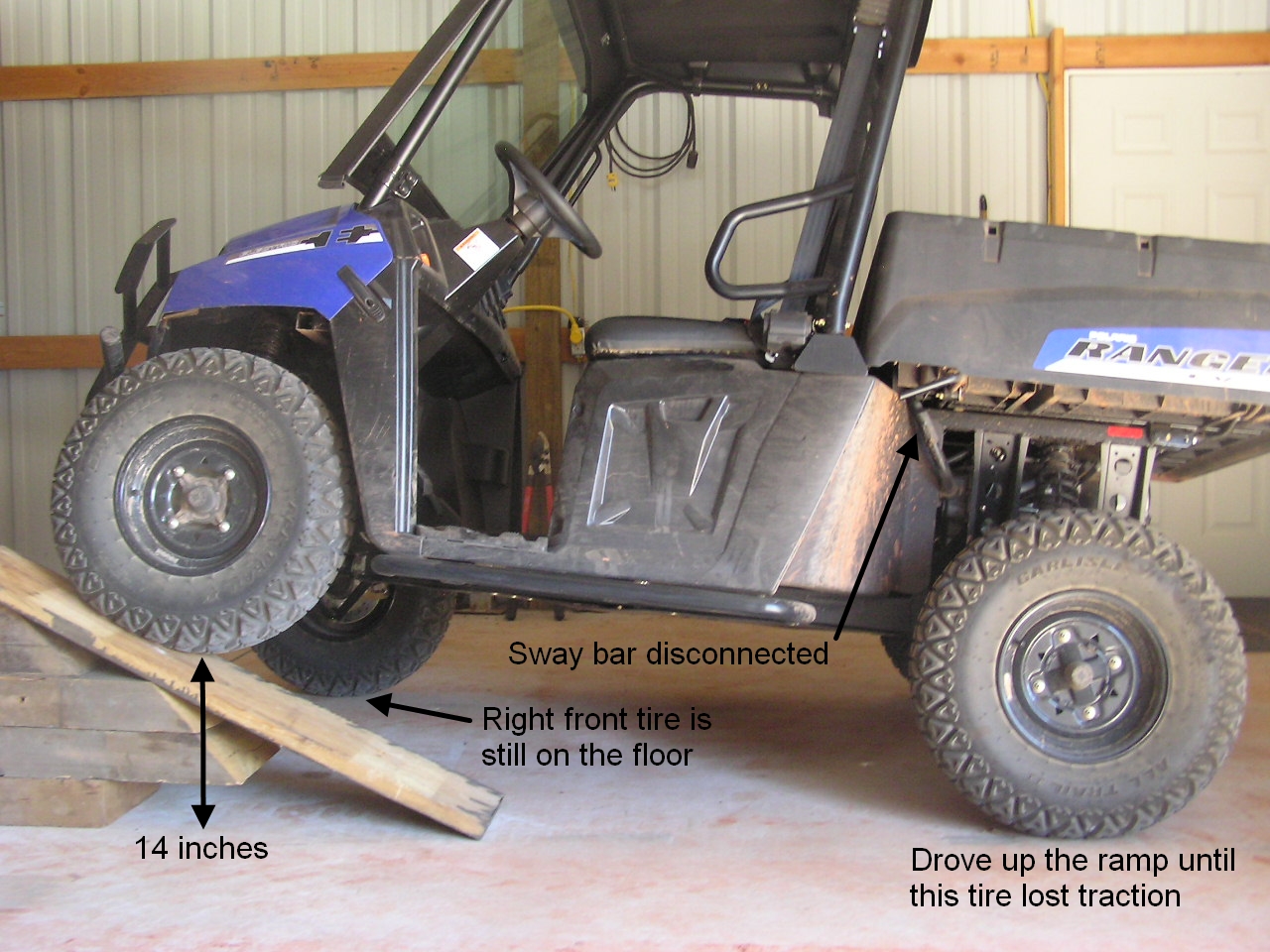

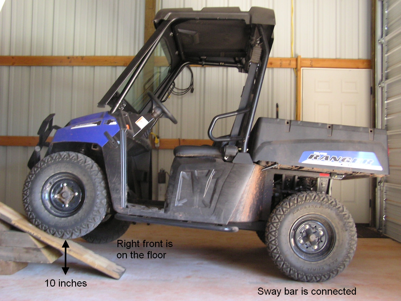

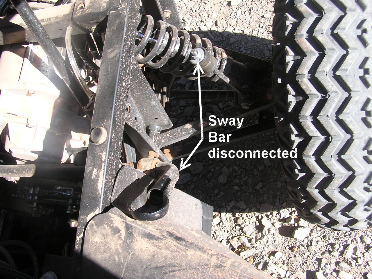

I disconnected the sway bar to get a little more suspension travel.
I had to shift out of 4WD, because it tried to go up over the end of the board, with the right front wheel in the air!
Rear articulation.
I am going to leave the sway bar disconnected. :thumbsup:

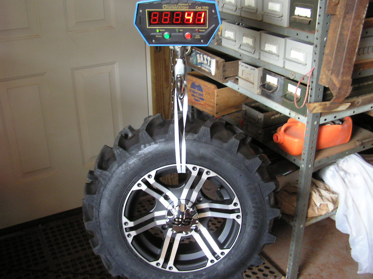

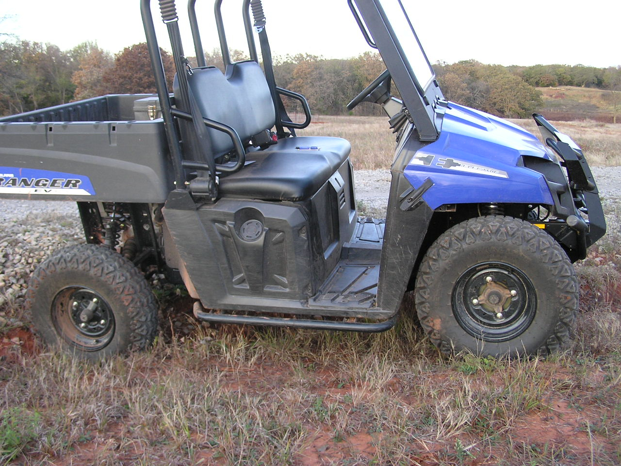

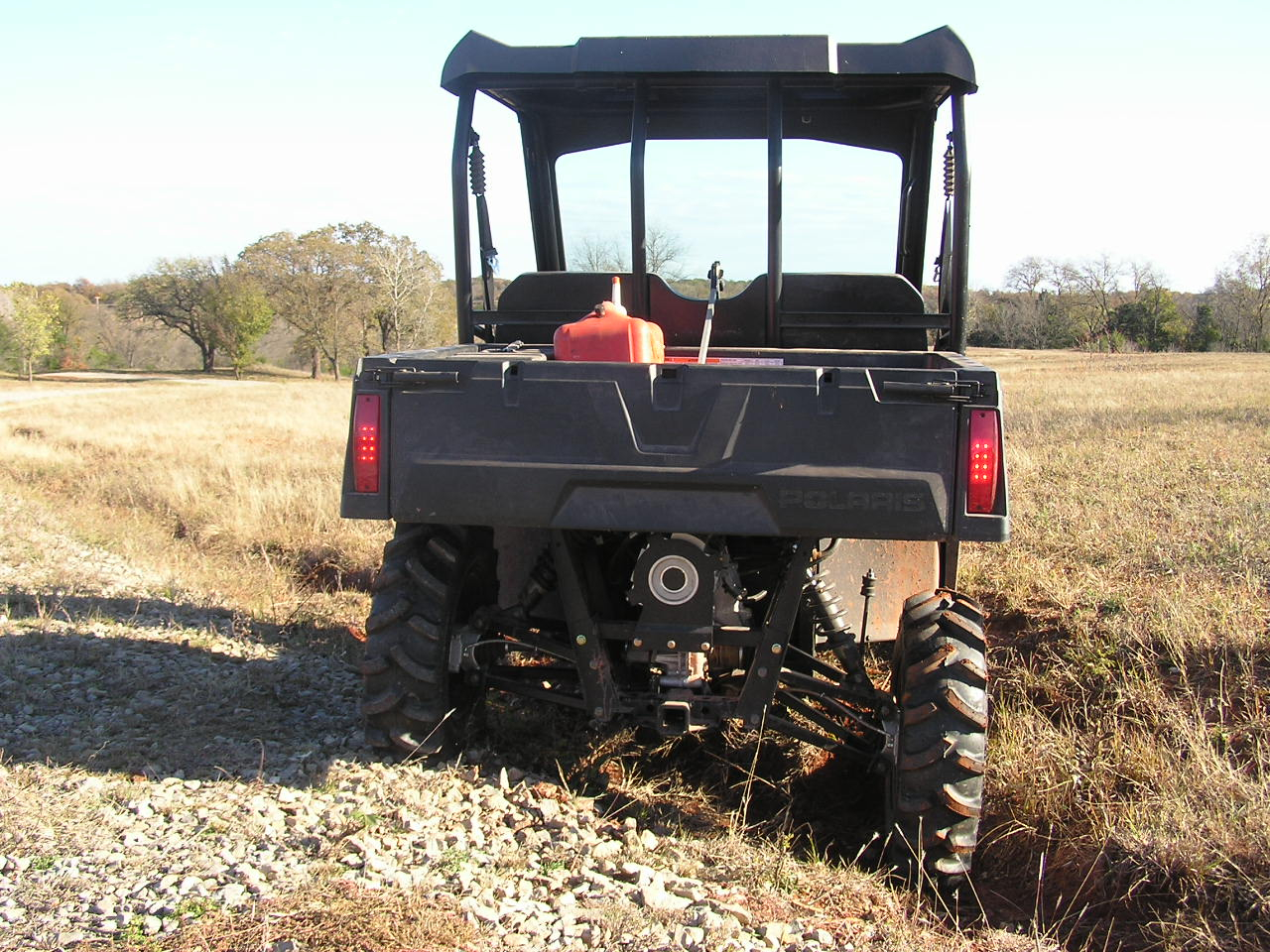

Replaced the Carlisle 25-9.5-12, All Trail II, with Interco Interforce 27-7.5-14, 6 ply, 2" narrower, 2" bigger diameter.
The aluminum wheel and tire weigh 41 pounds.
Parked with diagonal wheels in a low ditch along the driveway. The left front is not touching the ground. Plenty of tire clearance on the front right .
Before:
After:
Most of the weight is on the left rear, still good clearance.
Before:
After:
Notice the sway bar is disconnected for maximum articulation.

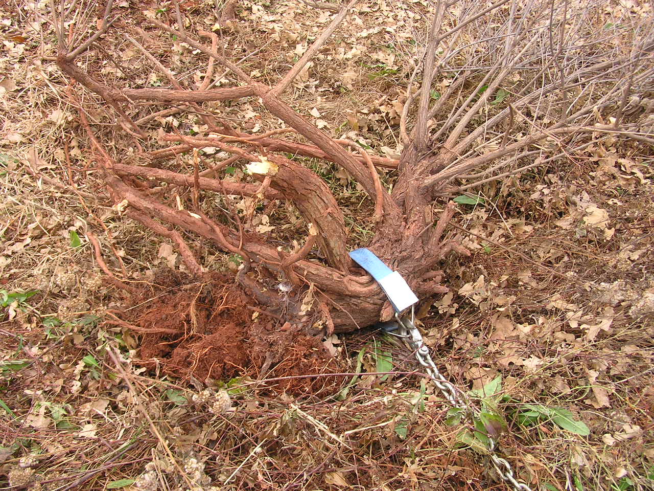

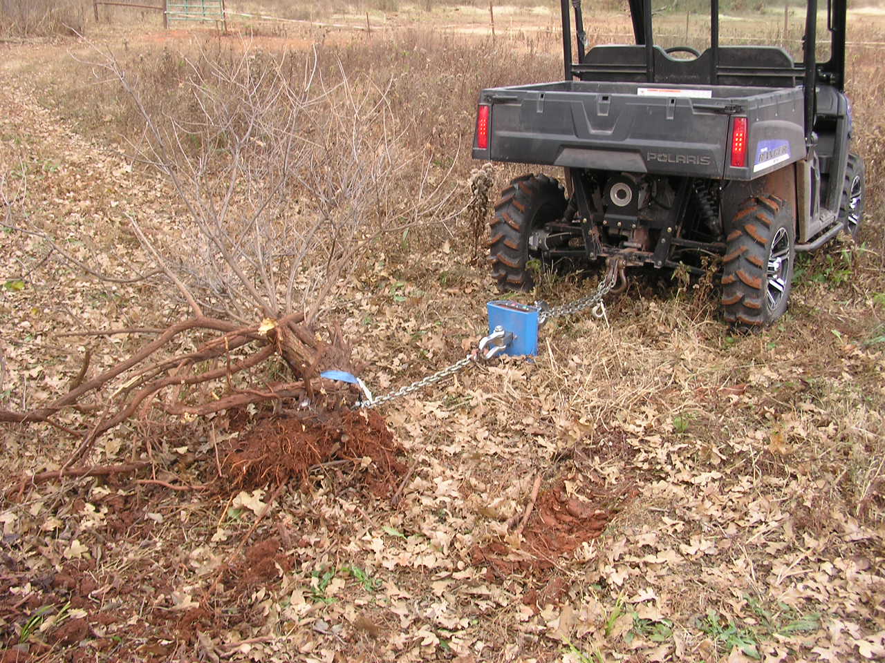

I decided to find out how much drawbar pull the EV has. I hooked the crane scales to what was left of a small tree at the edge of the pond. The beavers had chewed through it many years ago, but it was still growing.
As I started pulling in turf mode, I could feel the left rear tire slip, then the right rear slip. I switched to AWD and the chain tightened again, but even though the the wheels were spinning a little, I was moving forward. I stopped, got out and took a picture.
The tree roots were coming out of the ground! :eek:
This is the surface that I was on.
I went ahead and pulled it all the way out. :thumbsup:
If anyone asks me "how much can it pull?", for now I will say "enough"

Replaced the pictures that disappeared from post # 15.
View attachment 341985 View attachment 341986
Rear articulation.
