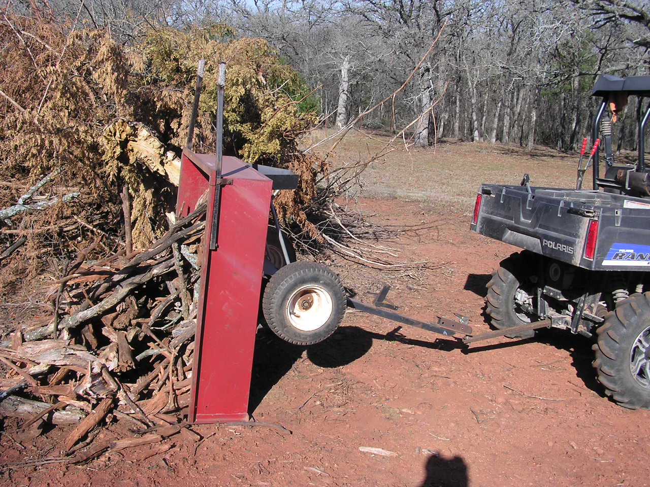

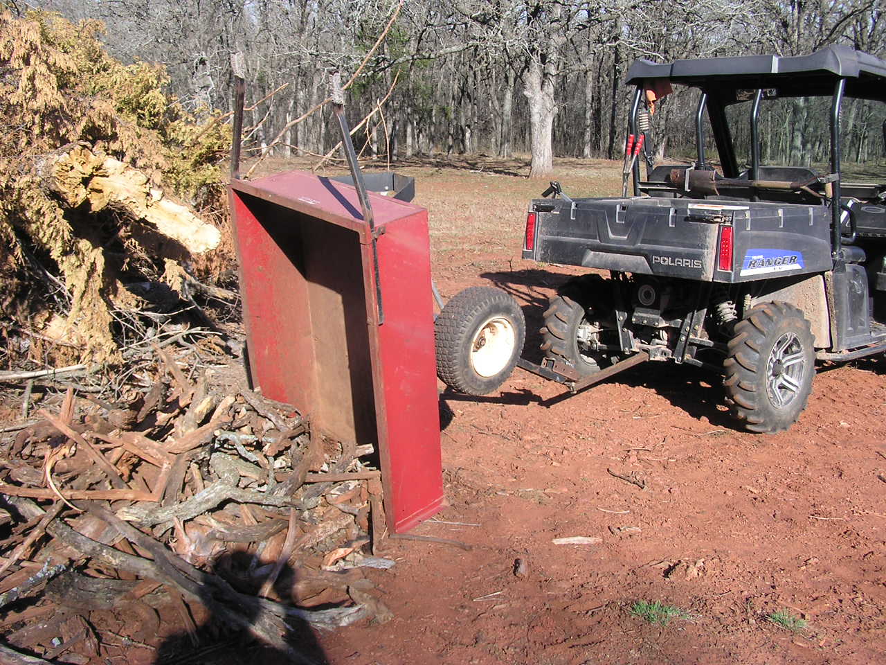

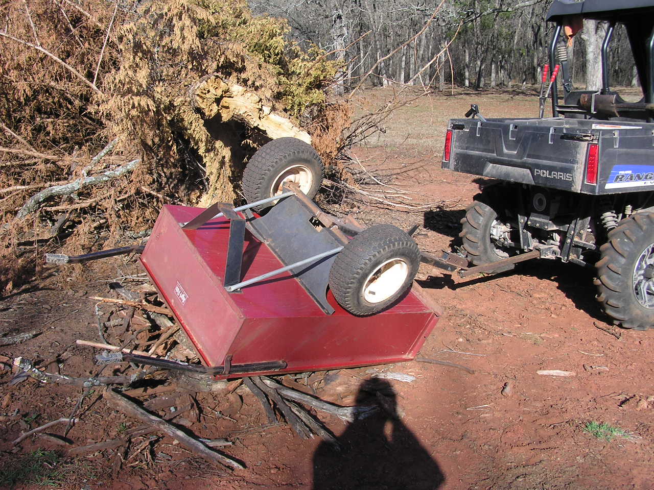

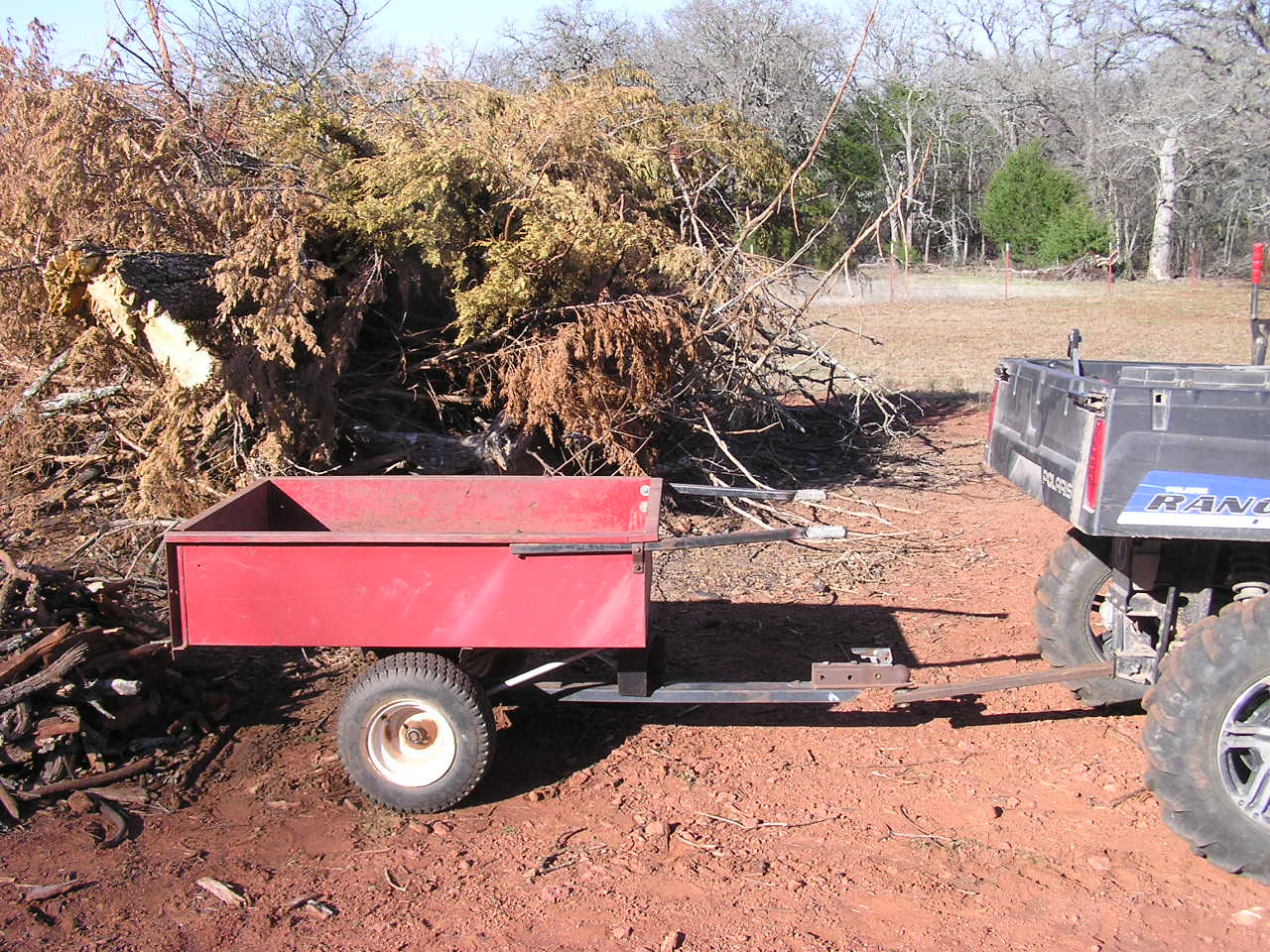

Dump trailer full of small pieces of dead wood.
Left the tailgate in, pulled the dump latch, backed up.
Backed up some more, max dump angle! :D
Pulled forward some, gravity is working on the load.
Pulled forward, straight up.
Pulled forward some more, it is empty. :thumbsup:
Latched down, ready for another load.

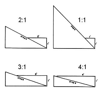

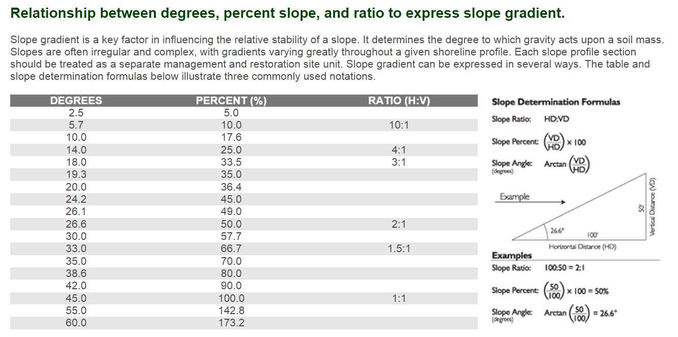

Just realized I never posted the side slope ability of the EV here in this thread, it has been posted many times elsewhere, so for those that haven't seen it, here it is.
This is what 30 degrees of body lean looks like on the back of the dam, a 26.6 degree slope, 50% slope or 2:1 slope.
The hanging tow rope shows true straight up vertical.
