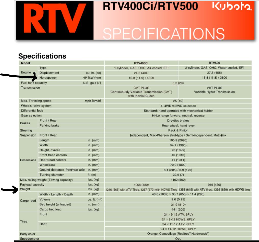

What model RTV? The one that showed up when I searched "RTV" was under 1400 pounds and a 16 horsepower engine.

No, it is still on the to-do list. The crane scales have to have the weight steady for a minute to lock in the reading, so I will have to have my wife drive with me in the back watching the scale readout. With the shutter lag on my camera, I might not get the max pull in the picture, but it would be close enough. What model RTV? The one that showed up when I searched "RTV" was under 1400 pounds and a 16 horsepower engine. Our EV has a three phase AC 30 horsepower motor with tremendous torque in low range. The best way to find out which can pull more would be to chain them back to back. :thumbsup: :D <img src="http://www.tractorbynet.com/forums/files/atvs-utility-vehicles/447541-electric-polaris-ranger-rtv-jpg"/>
The RTV900XT weighs 1863 pounds without a cab and 1,995 pounds with a cab. I doubt the electric ranger is 30 hp continues. There is 745.7 watts in a hp. That is 22,365 watts for a 30 hp motor. If my math is correct the batteries are going to have to produce at least 466 amps continues. The hp on either rig really doesn't matter as long as they are both capable of spinning the wheels in 4x4.
