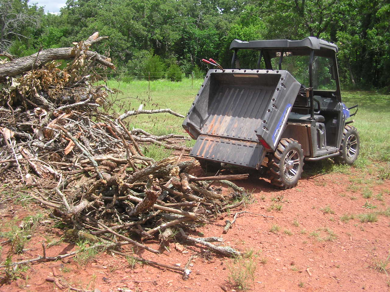

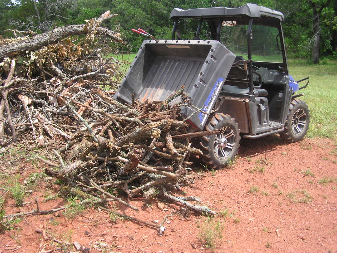

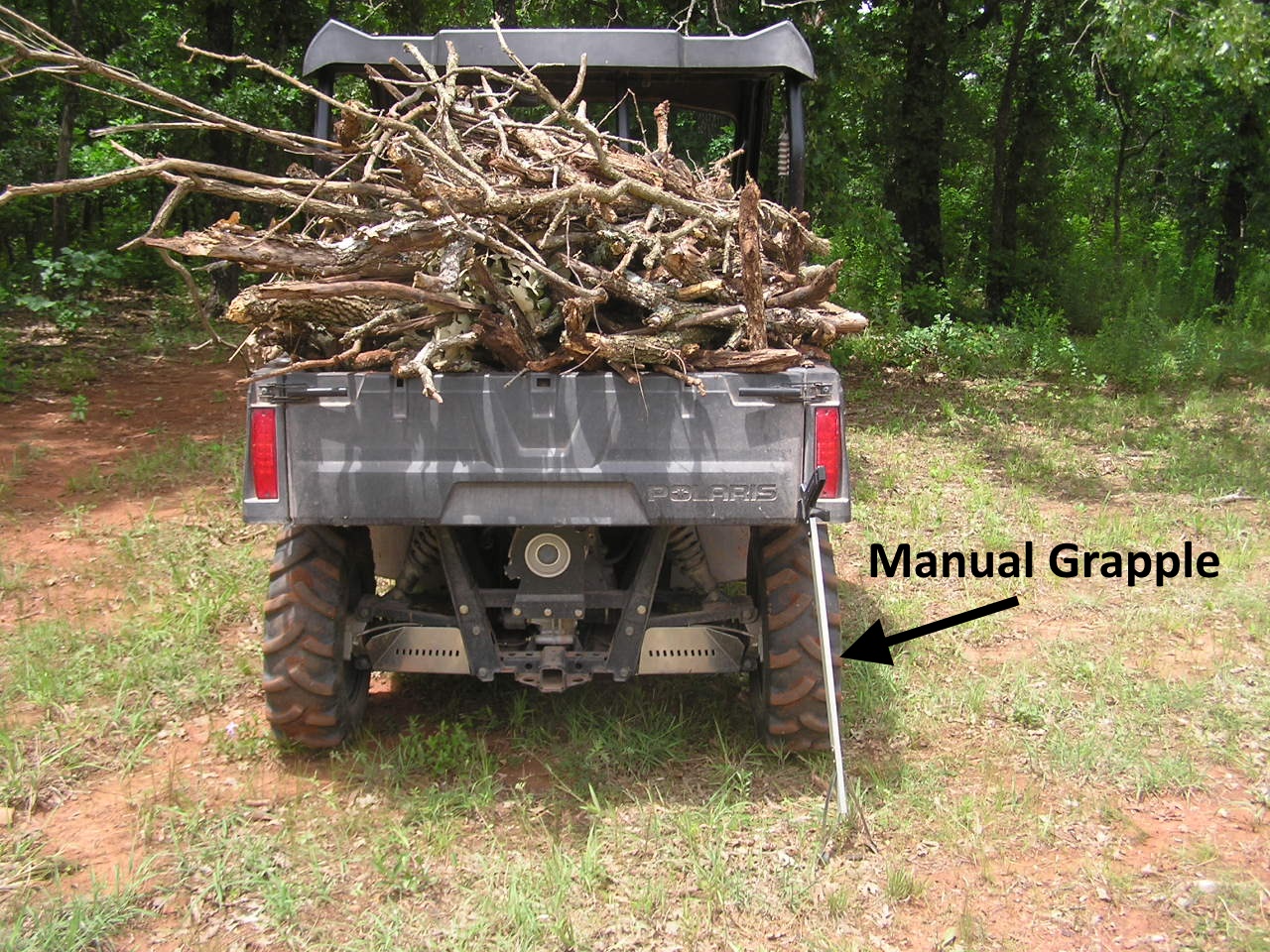

This is the largest load of brush so far! :thumbsup:
   / Electric Polaris Ranger
#84
LOL!!! I love it! Glad to see you're getting some use out of it and having fun at the same time. What's the story? General clean up?
Yep, had some high wind gusts with thunder storms lately. Lots of dead branches broke off of the oak trees in the woods close to the house.

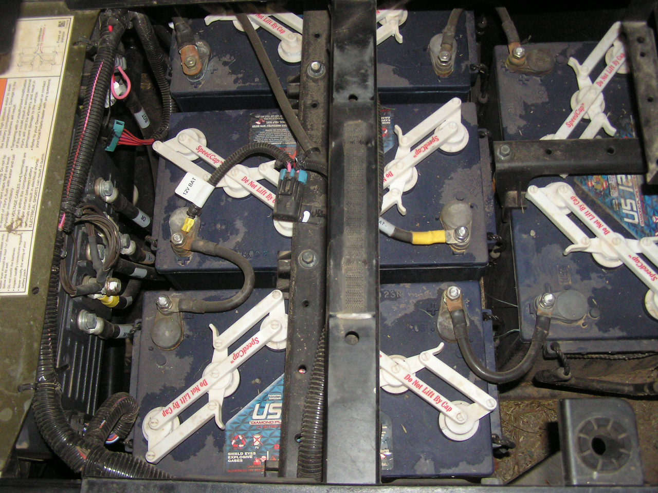

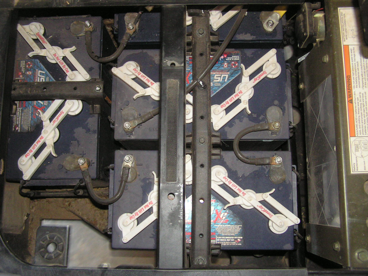

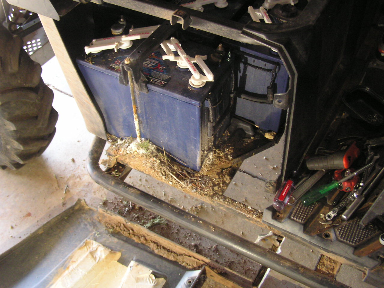

After 4 years of almost daily use, the deep cycle lead acid batteries were getting weak.
After some research I ordered the 8 kWh Lithium Ion conversion kit from: Voltronix
Here are the original batteries, under the seat:
Left side.
Right side.

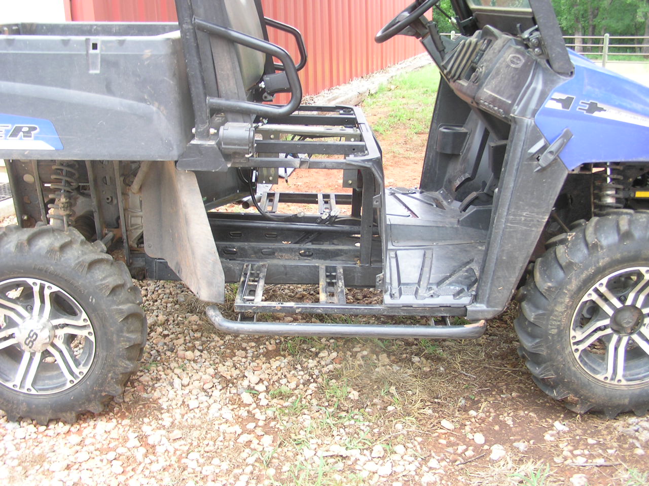

Removed the side panel.
Removed the batteries.

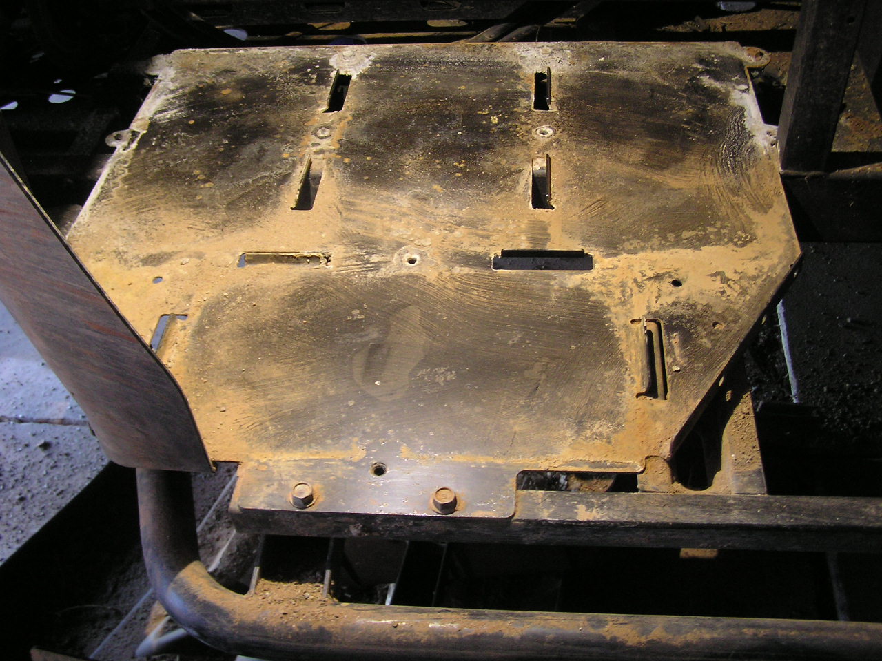

Removed the battery trays and washed it out.

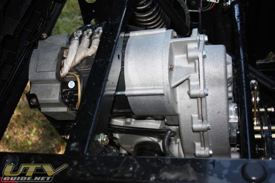

Just out of curiosity do you know what the specs are on the electric motor for your EV? I gave my land pride treker I had to my dad and it's having motor issues. Wondering how hard it would be to just convert it from Gas to Electric if we have to replace the motor? That would work way better for what they use it for anyway.
It uses a CVT Clutch drive system and the current motor puts out 1250-1350 rpm at idle and 3800-4000rpm max. So I am thinking if I could find an electric motor that we could put in the same spot as the gas motor that has similar RPM capabilities we could make it work with the existing drive system. It's got plenty of space for batteries under the seat similar to the EV Ranger so I think I could put the batteries in.
I am sure someone has done similar conversions but I am not real familiar with electric motors or the type we would need for this type of conversion.
#88

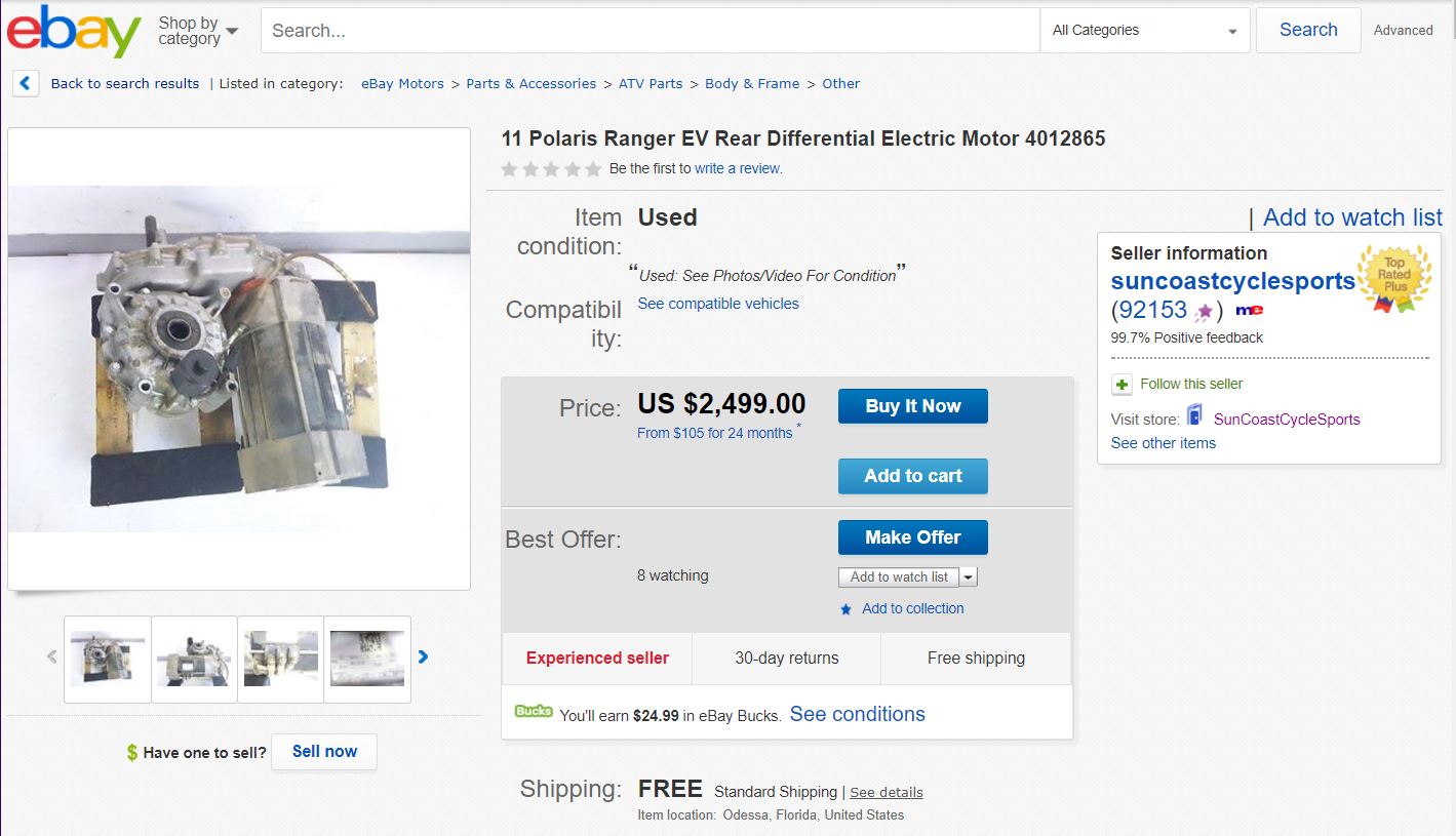

Yep, the specs are 30 horsepower, 3 phase AC, powered from a 48 volt DC Sevcon 650 amp motor controller.
There is a used motor and differential on eBay now:
This is the motor in the EV, under the dump bed:
I have no idea what the motor controller and a 48V battery charger would cost, but I know that I would not try the conversion with Ranger EV parts. :thumbdown:

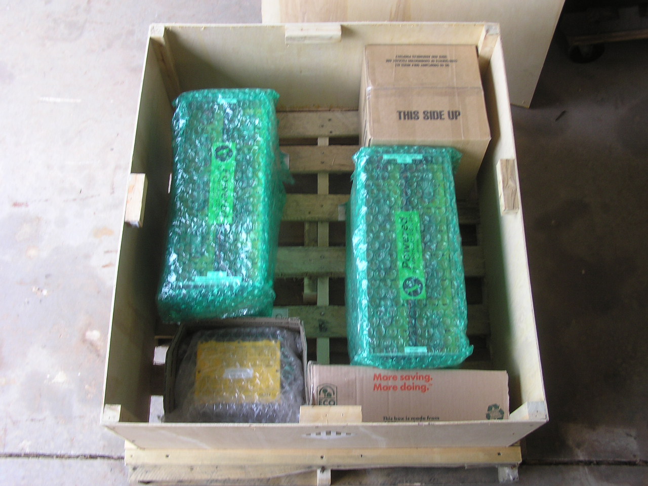

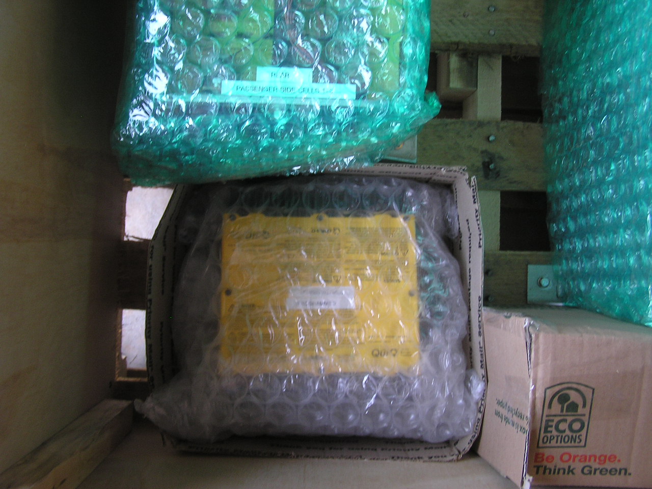

Re: Electric Polaris Ranger, Ordered The Voltronix USA 160Ah Lithium Ion Kit

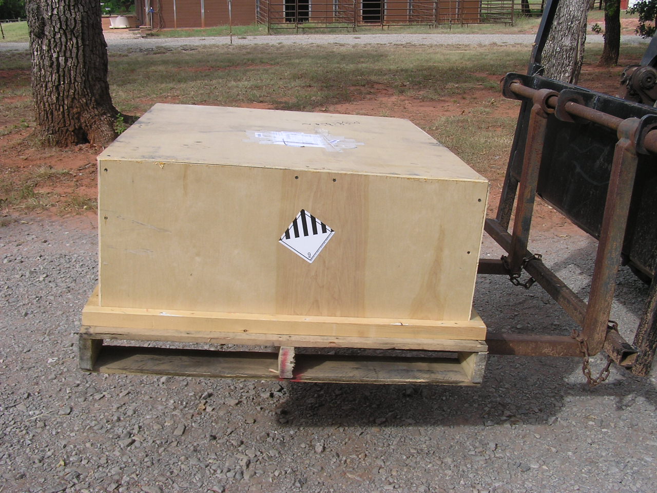

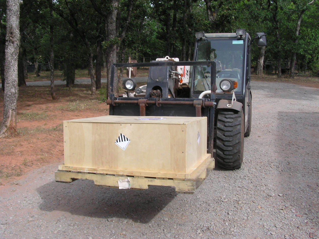

Beaver Freight delivered the conversion kit today. :D
Used the V417 to unload it.
They added 1/4" plywood to the skid to make a sturdy shipping crate.
The battery rack modules are bolted to the skid and everything else is bubble wrapped and in custom cut cardboard boxes.
This is the battery charger.
