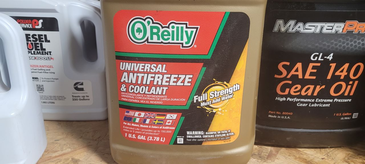

Finally getting around to draining the coolant so I can replace the heater plug.
I've somehow lost track of what coolant/antifreeze I've been using. Is it just the standard green antifreeze or does it use something special? The owner's manual is no help. It just says 50/50 mix and capacity is 4.2 quarts. I'm gussing that the lack of any specific warning on the owner's manual means it's not too picky.

In today's market you can buy a variety of Antifreeze. I use this. It doesn't matter what's been previously used and will mix with any type.
You can buy this full strength or pre mixed. I never buy pre mixed, what a ripoff. I can figure out how to add equal parts of water/antifreeze. :)
