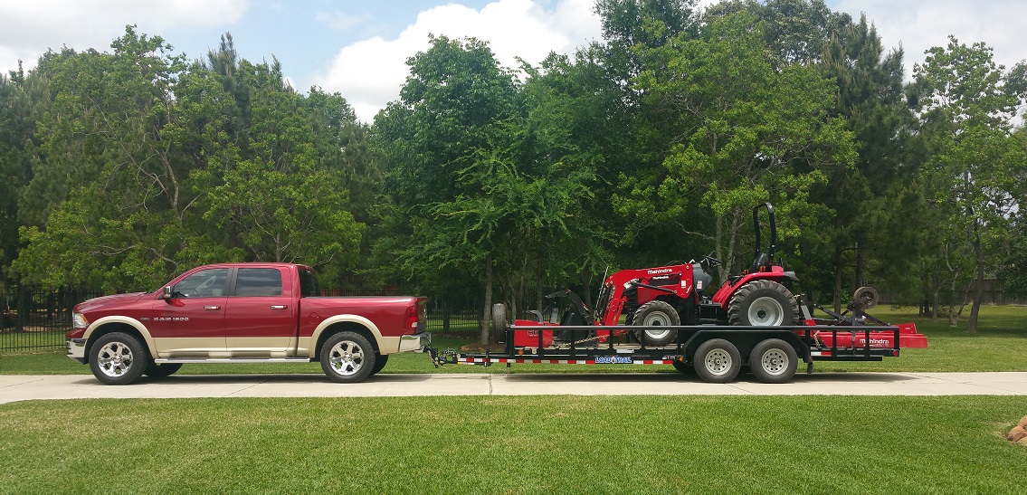

<snip> It was time for a little research. A quick, but fairly exhaustive effort keyed me on to what was needed for a half ton to manage a loaded 20' Medium duty trailer, (10,000+/- pound capacity). Bumper pull was my only reasonable option for this half ton truck, and at this length the tongue weight can get up there, especially when hauling multiple implements.

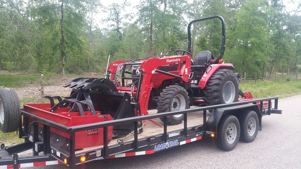

This trailer is loaded with the unit that will be tackling the new property. A Mahindra 2538 with FEL, Med Duty 6' Cutter, 6' HD Box Blade, and a 60" Grapple. It all registers at +/- 8,400 pounds incl trailer and chains/binders. The picture shows that there is probably more than 10% on the tongue.

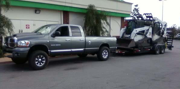

Wow, a t250 is about 9500 pounds. So two of them in that little trailer....and behind a SRW....yea, people are stupid.

Just a quick update and note of thanks for the suggestions and advice above. *** Disclaimer - I am not finished yet and appreciate that I still have some load balancing and shank work to do, so please don't crucify me for sharing this interim update.
I hauled 40 miles today after a few more tweaks and it was flawless. Really impressed with the equalizer and the airlift brand bags. I only use about 20 psi in the bags and the equalizer is just helping out to keep rear squat at less than an inch with the front coming up about same amount from unloaded height. I have a leveling kit on the truck so it's already a touch taller than stock - and those are 34" tires too. The only small remaining problem there is that the shank that comes with the equalizer is a touch too short, so I am having to put the trailer tongue about two inches too high and thus getting more leverage on the truck as the front trailer axle isn't taking it's full share of the load. I have a 14,000 pound Curt shank coming that I will switch out with before next trip. Even though it's not perfect yet, we're getting very close. That hitch makes the interstate drive very pleasant.
Also adjusted load and moved tractor back about 3' as suggested and also unbolted and flipped up tail wheel while flagging the portion of cutter hanging off back. I can load the box blade and then pull up with the bucket in the grapple and then set it down just behind the box blade. A couple of chains, a couple straps and bingo! Perhaps this thread will be helpful to those who would like to multi task with their Ram half ton. Just be sure to leave room to stop and don't get in a race!
First pic shows it is almost there. Just need to get that longer shank on to get the trailer level and balance trailer axle loads. This pic shows plus 3/4" in front and minus 3/4" in rear. I can probably scoot tractor back another foot as well. Need to check TX rules on max overhang. I thought it was four feet allowed, but I need to confirm.)
Loading order. First box blade, then grab bucket and hook up cutter. Place grapple bucket on trailer floor just behind box blade and then flip tail wheel up and flag the overhanging part of cutter.

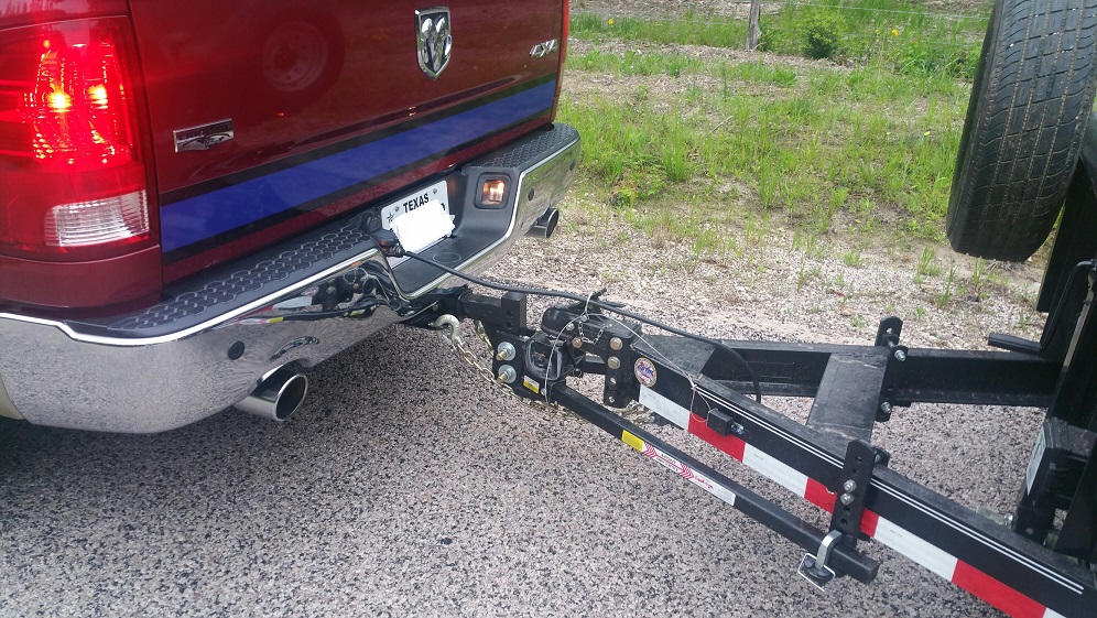

Here is stock equalizer set up with their shank in the lowest position. It just needs another 2" to get the trailer level with the truck essentially level as well. (So I guess that would be net 3" more for the new shank if including truck rear going back up a bit - will experiment.)

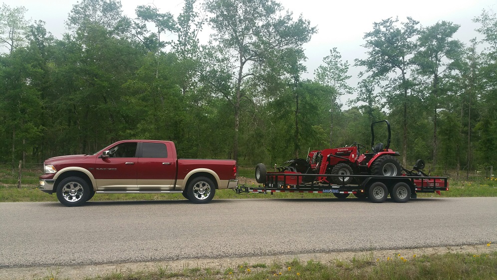

Final report - success achieved
Static unloaded truck measurements to wheel well lip - Front 38", Rear 40". Using Equalizer Hitch and coil helper bags with 30 psi.
BEFORE - TRUCK NOSE HIGH AND TRAILER TONGUE HIGH - Equalizer provided shank with hitch at lowest setting and all implements on trailer with reasonable balance: Measurements to wheel well lip and bottom of trailer frame. Truck - Front 39", Rear 38" Trailer - Front 18", Rear 15"
AFTER
- LEVEL TRUCK AND TRAILER - New longer Curt shank with hitch lowered 2.5" and all implements on trailer with reasonable balance: Measurements to wheel well lip and bottom of trailer frame. Truck - Front 39", Rear 39" Trailer - Front 16.5", Rear 16" (Lots of forces moving around here as more weight is placed on front axle of trailer - ride is really good now.)
