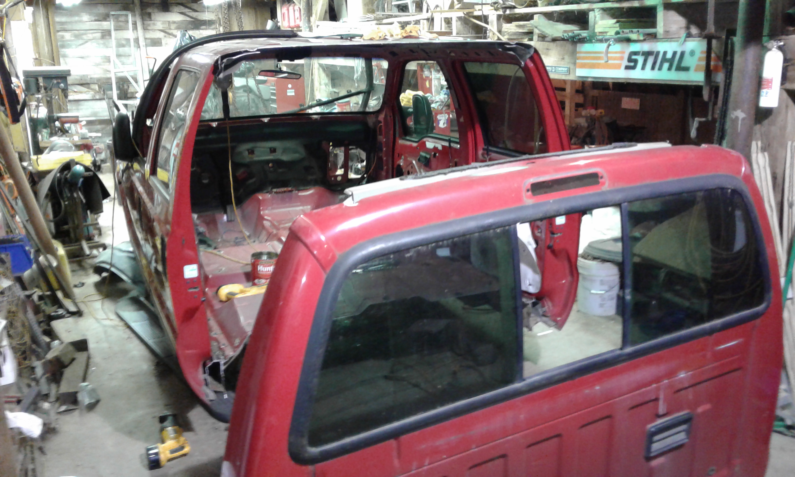

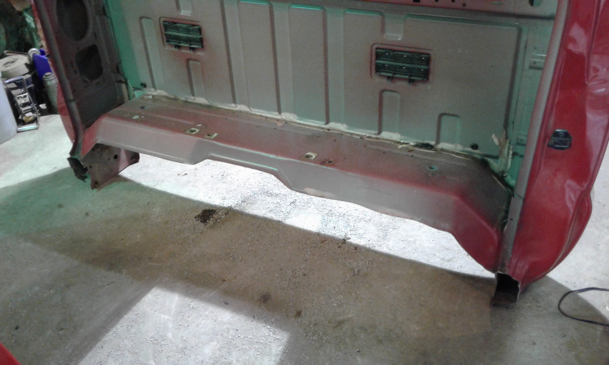

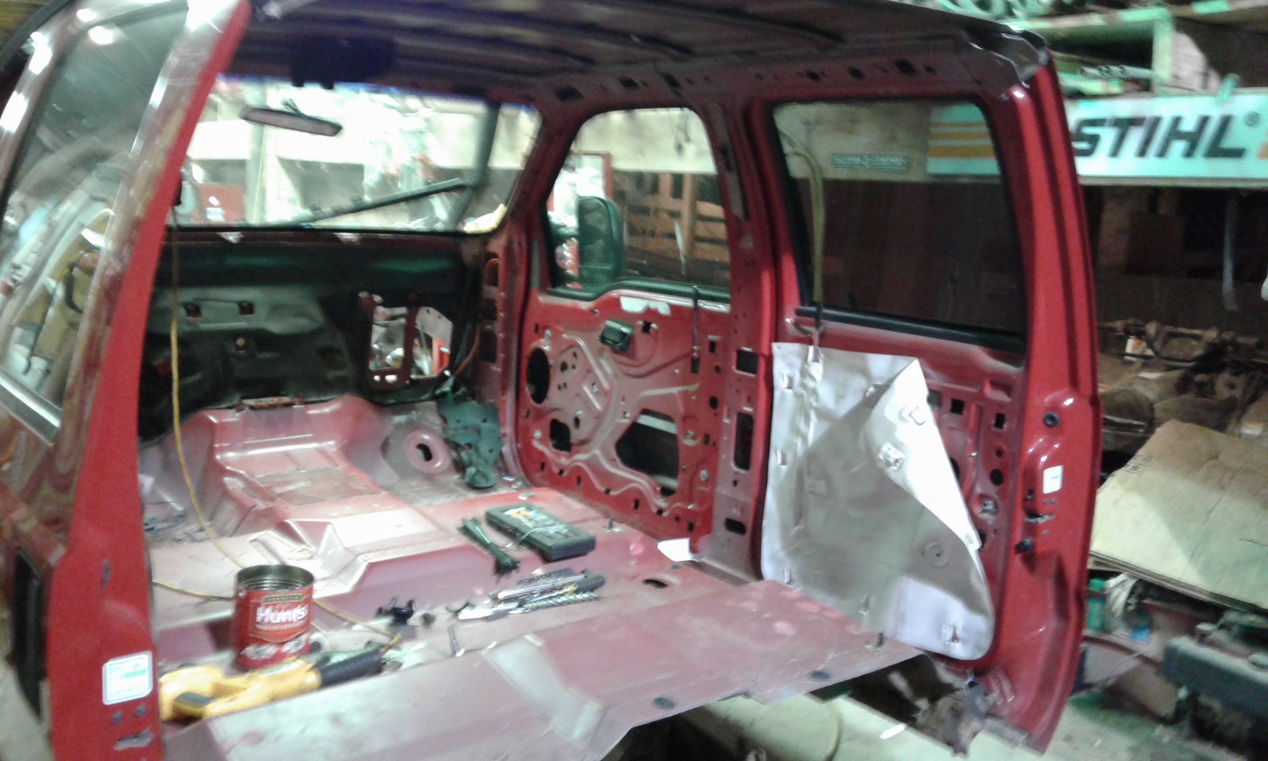

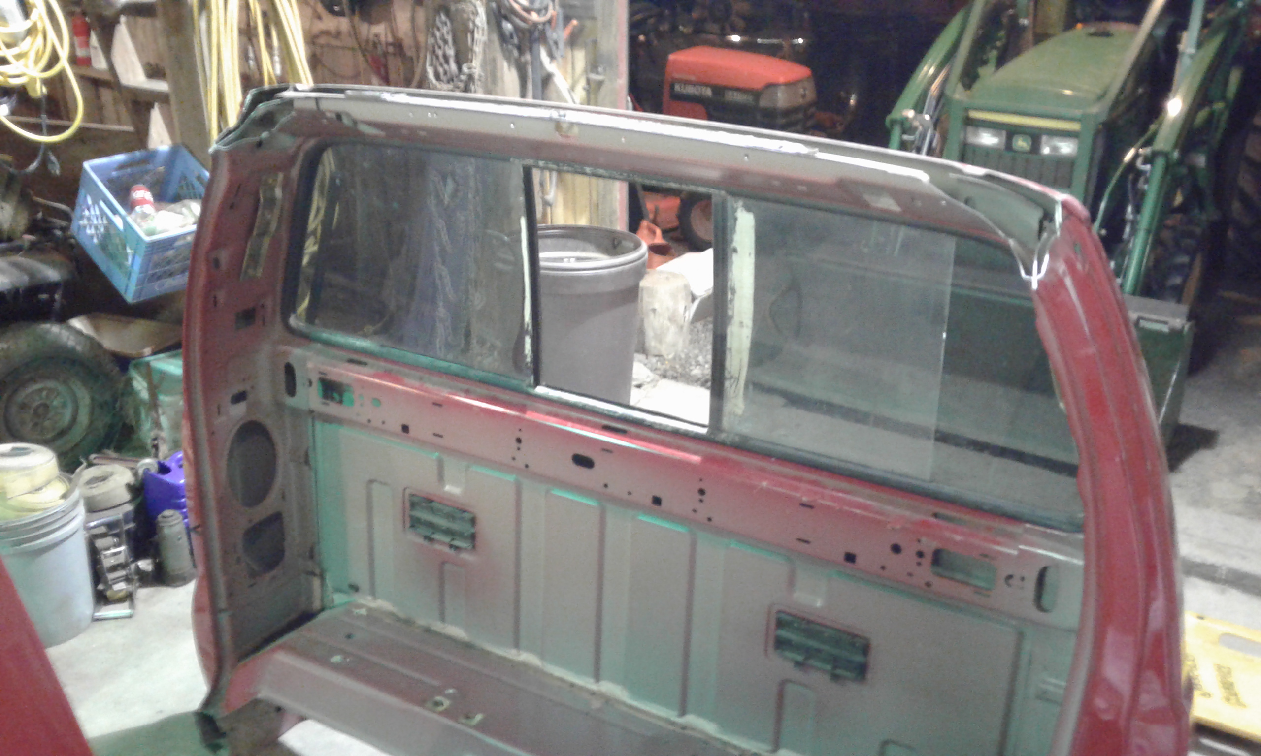

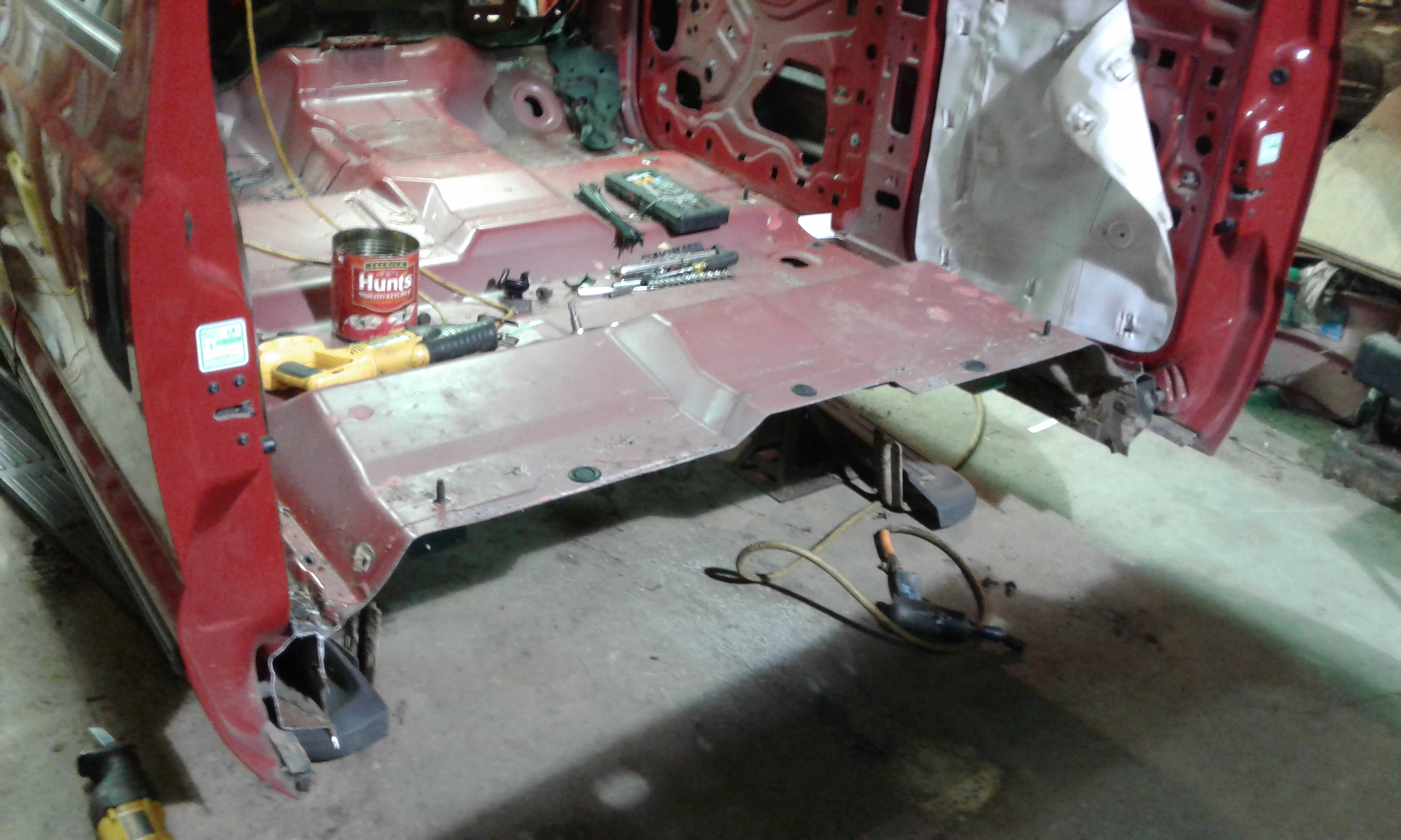

Finally got to spend some time on the cab this evening. Got all the parts that had been stripped out of the cab off the floor behind the cab, and out of the cab. Was about to head to the house, was looking at where to cut what to remove the back wall... after a few minutes I said 'WTF... here goes nothing' and grabbed the sawzall.
Lends a whole new meaning to the term 'Separation anxiety'.

Impressive!!
   / Extended Crew Cab- The SuperDuperDuty family hauler #58
You've committed now, that often lessens the anxiety.
