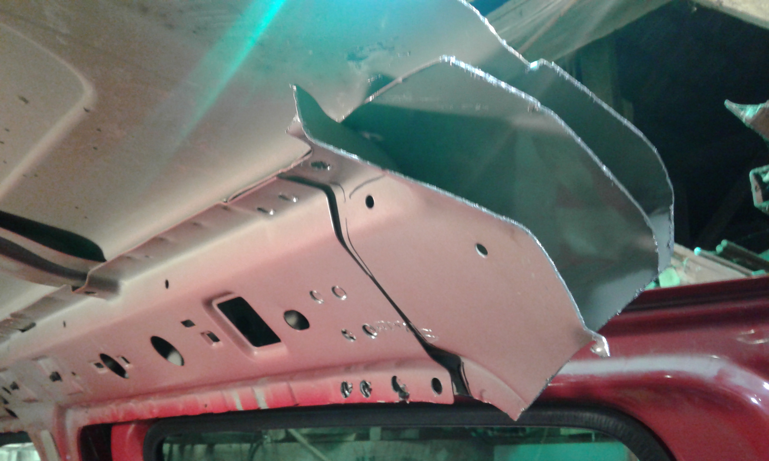

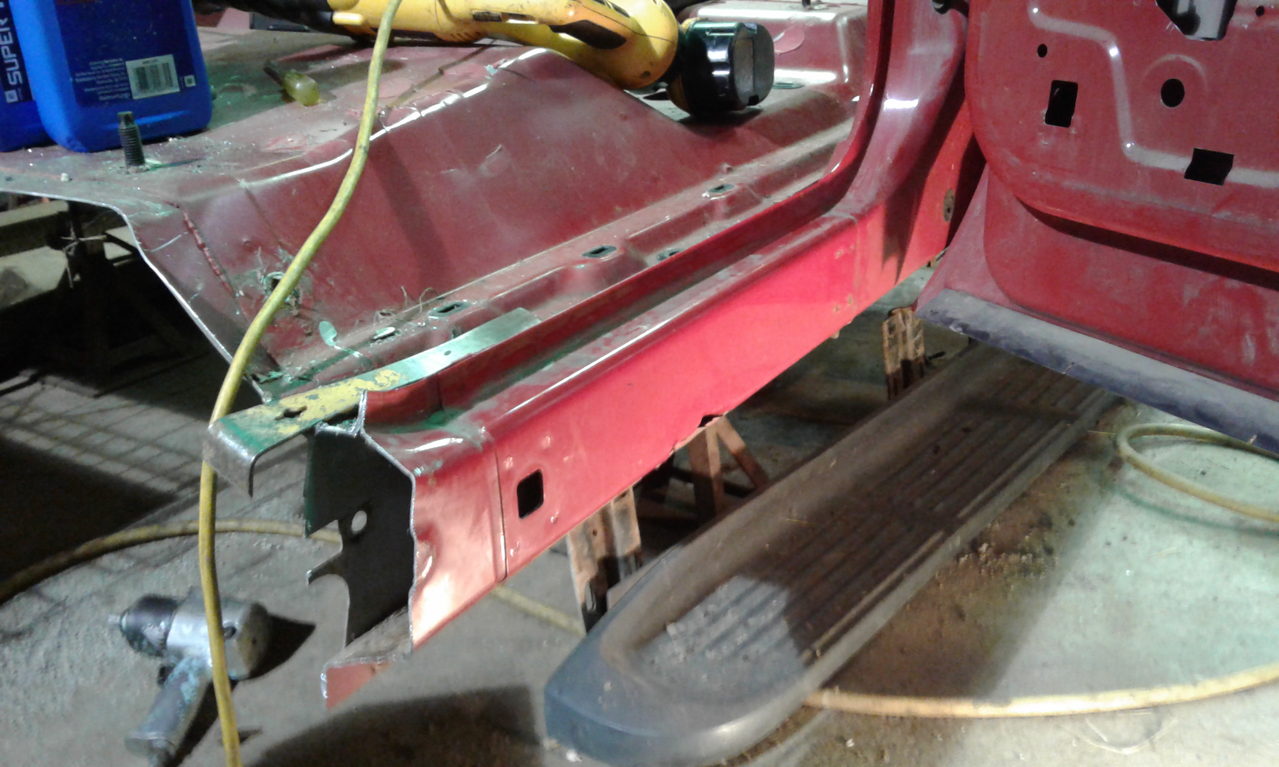

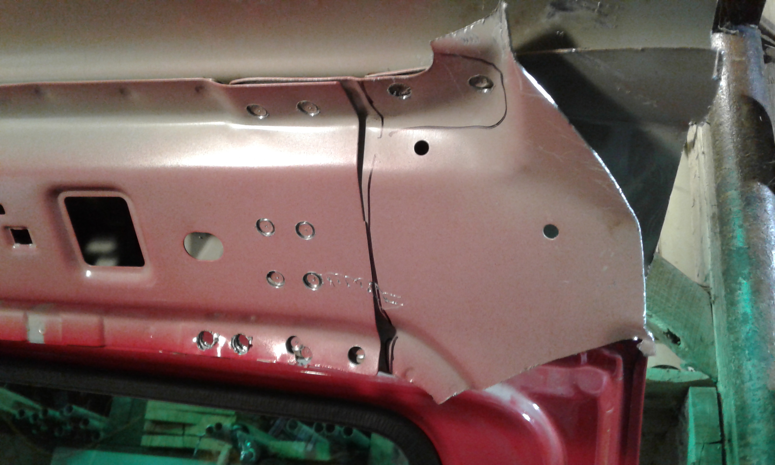

I got a spot weld cutter on Saturday, and had Monday off work, so I had a chance to start removing the ends of the cab corners and top corners where I cut off the back of the cab. Not much, but it's a start. Lots of work ahead.

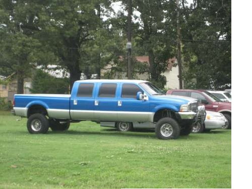

No turning back now! Here is a thread on a 6.0 stretched to a 6 door, may be some helpful things. The Hillbilly Stretch-Limo (my 6-door Superduty project) - Ford Truck Enthusiasts Forums
I read through this whole thread on my phone on the weekend. The roofline looks like it takes some work to get right. Looking forward to seeing how DC deals with it. Having the roof Rhinolined seems like a good idea, never thought about the stresses involved up there. Someone also mentioned using the roof off a van.
