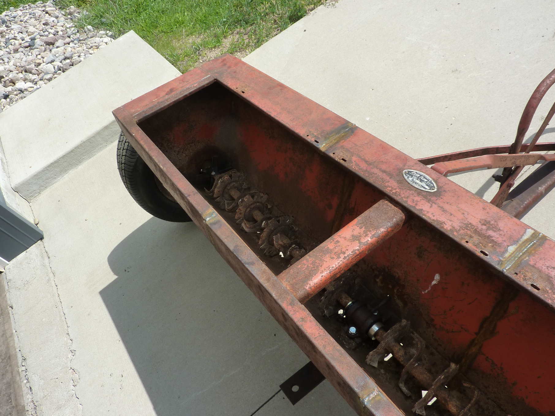

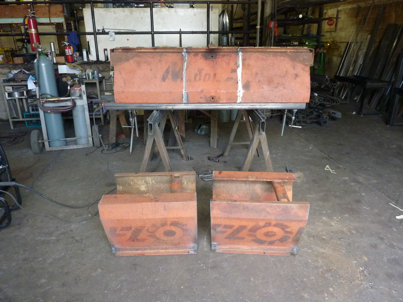

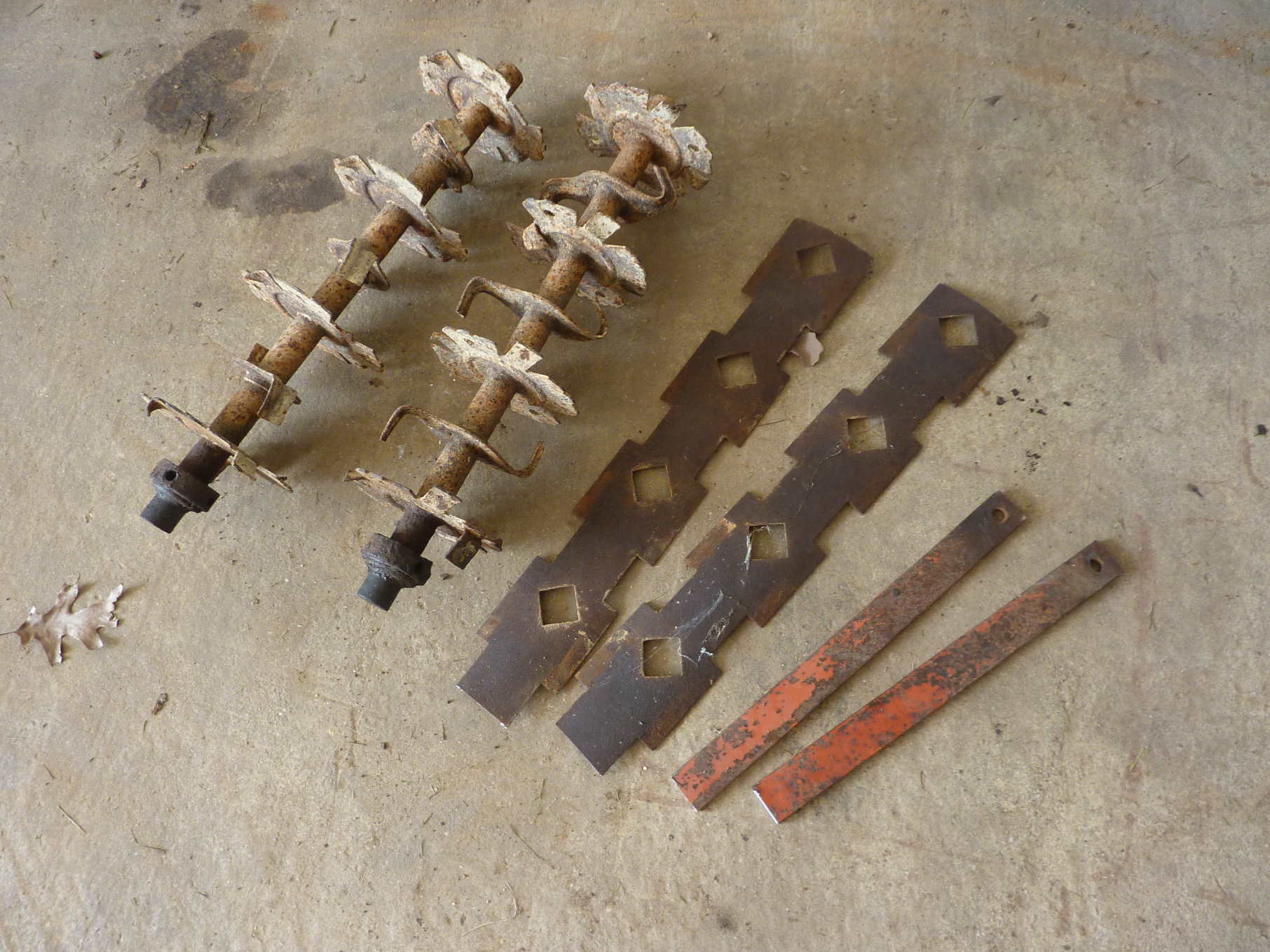

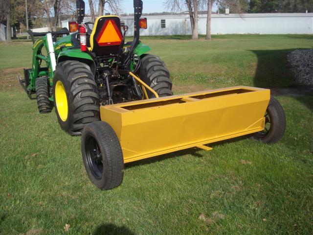

Thought I would show a pic of the EZ Flow I cut down to six feet wide. Not too hard of a project. The last pic shows the two foot sections removed from either side. I left the center section in tact....as that is where the beater bearings are located and it holds the mechanism for the shut off plates.
This week I'm going to clean it up and get it painted. Liming just got easier!

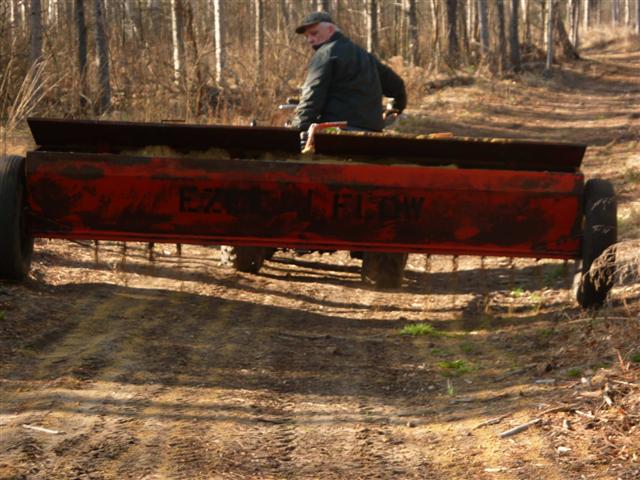

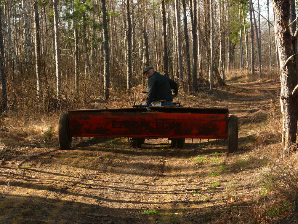

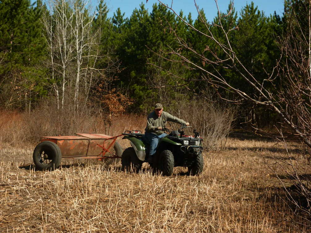

This past spring I spread 14 tons of ag-lime with our ten foot EZ Flow. It pulled fairly well with a Kawa 400. The sixer should pull with a smaller ATV and allow application to our trails and pass through narrow places better. The pics show the operation.

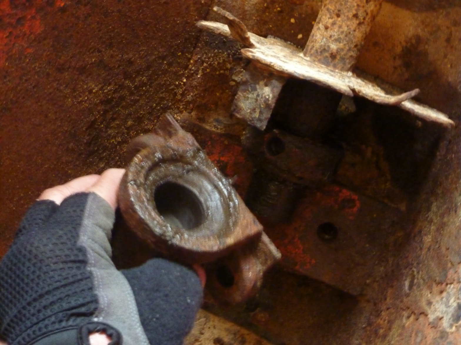

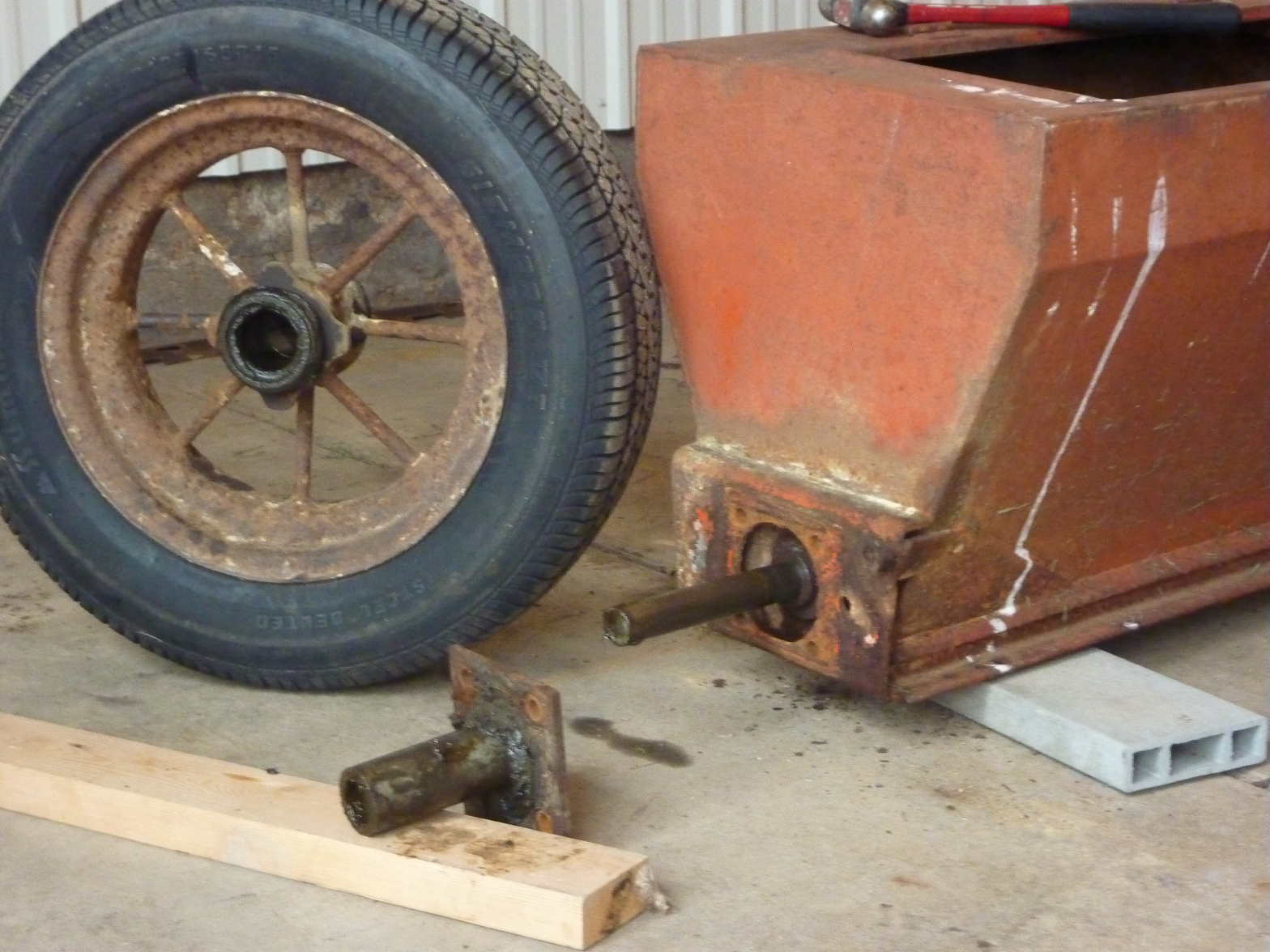

The wheels are spokies which have a specially designed hub to operate the agitators. They are held on by a single bolt.....which is also a shear bolt. (I have sheared one once when applying lime and I hit a tree.)
I took these pictures when I disassembled my spreader and cut two feet from both sides of the hopper - in order to turn a ten footer into a six footer.
I believe the pics detail the drive and hubs. Picture #2 shows the bearing block that is held in the center and it holds both agitators (which on my spreader are driven by the left and right wheels).

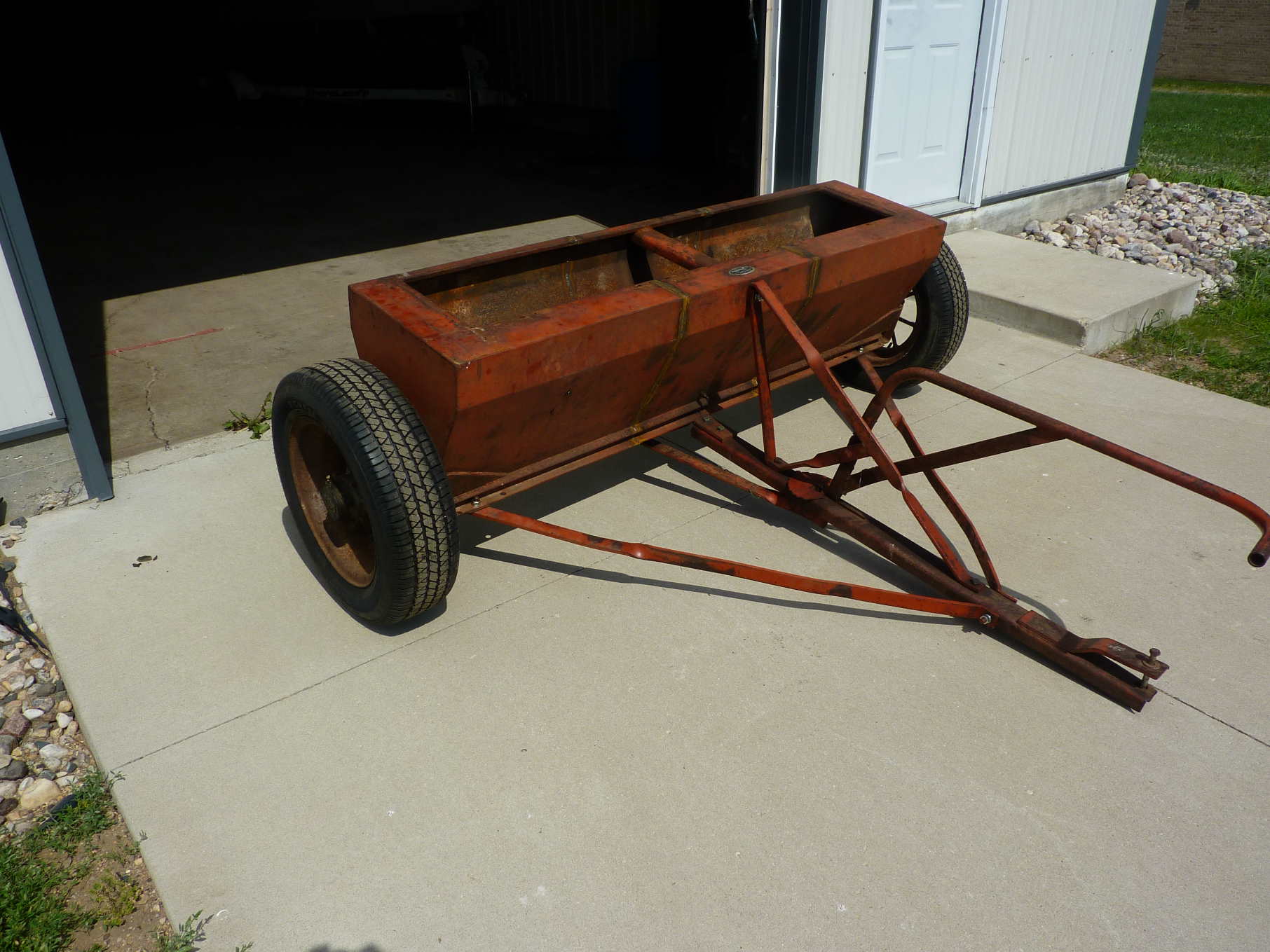

I show one pic below after making it narrower and getting paint applied. I show it hooked behind my tractor, but I can easily pull it with a four-wheeler as shown in the last pic.

Thanks. I hope you can figure a way to get yours operating. I got to thinking about the wheel hubs.....and that is going to be a challenge for you. IIRC about 2/3rds of the wheel hub rides on that outer, bolt-on section shown in picture #1 (which is about 3" diameter)......and 1/3 of the wheel hub is of smaller diameter and drives the agitator shaft (which is about 1 1/4" diameter).
I remember the inside of the hub was made with a bronze sleeve and it is a novel arrangement. There is one grease zerk in each wheel hub to feed either end. The tire size is unusual and in quite close relationship to the hopper in places....but I found some low-cost car tires to fit the wheels.
