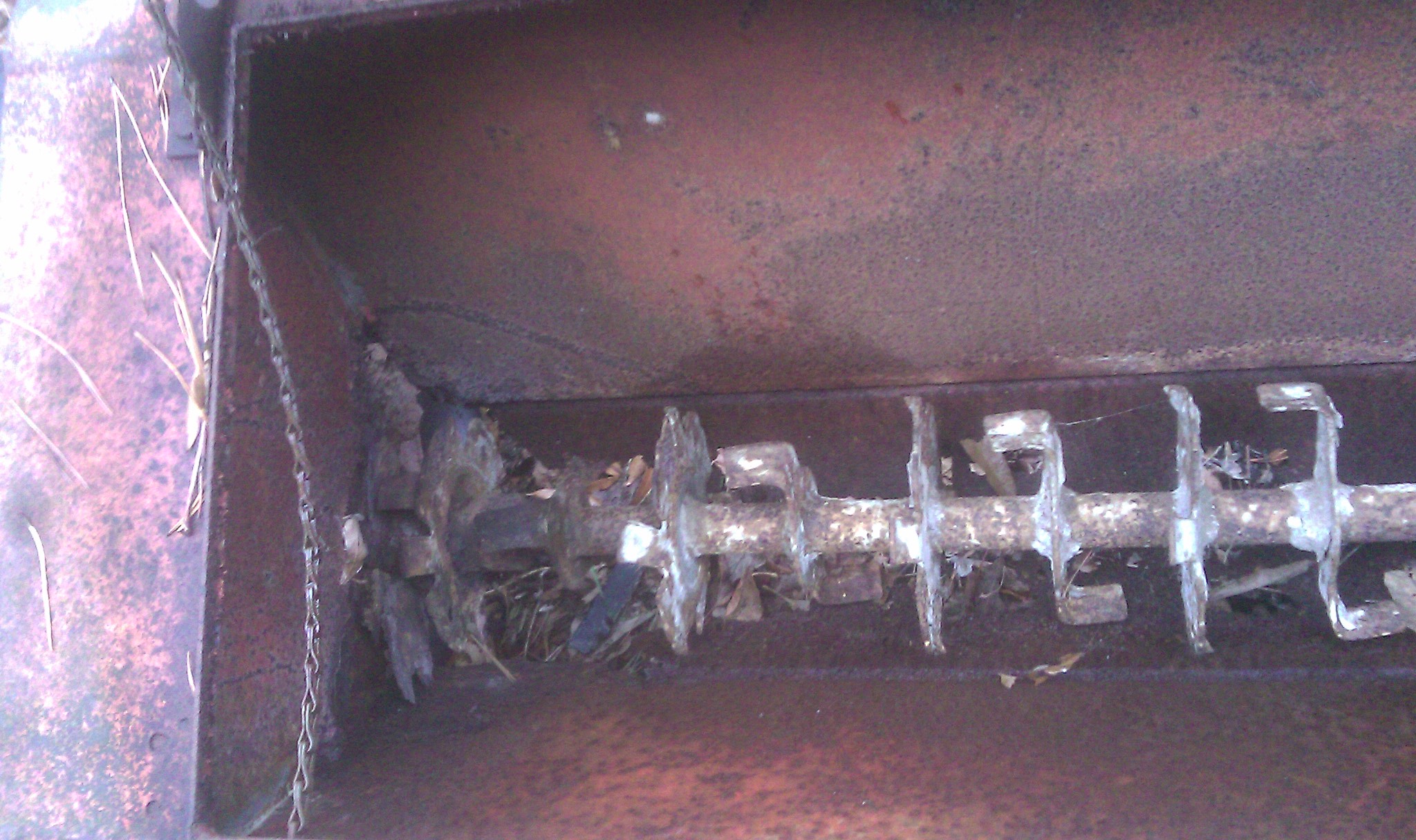

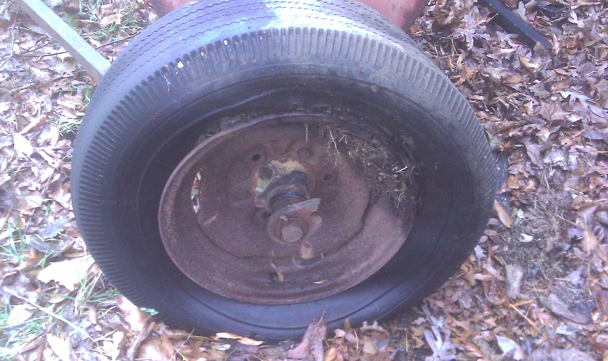

I decided to not get this one, but here are some pics of it.
Most of the bottom of the spreader was rusted out.
The hubs were a three bolt setup that looked like it takes a standard 6 lug AG wheel, but only three of the holes are used.
It also looks like it has a means of disconnecting the agitators from the wheel hub.

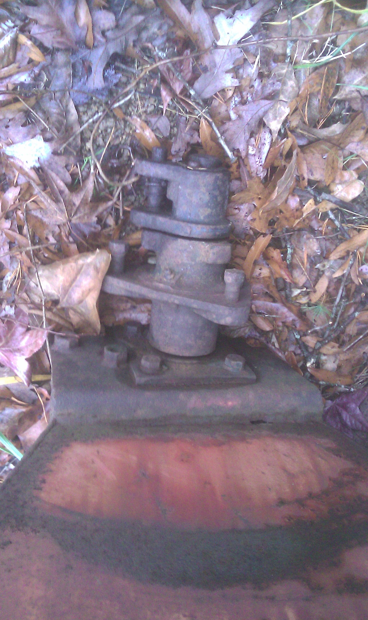

The wheels are spokies which have a specially designed hub to operate the agitators. They are held on by a single bolt.....which is also a shear bolt. (I have sheared one once when applying lime and I hit a tree.)
I took these pictures when I disassembled my spreader and cut two feet from both sides of the hopper - in order to turn a ten footer into a six footer.
I believe the pics detail the drive and hubs. Picture #2 shows the bearing block that is held in the center and it holds both agitators (which on my spreader are driven by the left and right wheels).
I show one pic below after making it narrower and getting paint applied. I show it hooked behind my tractor, but I can easily pull it with a four-wheeler as shown in the last pic.

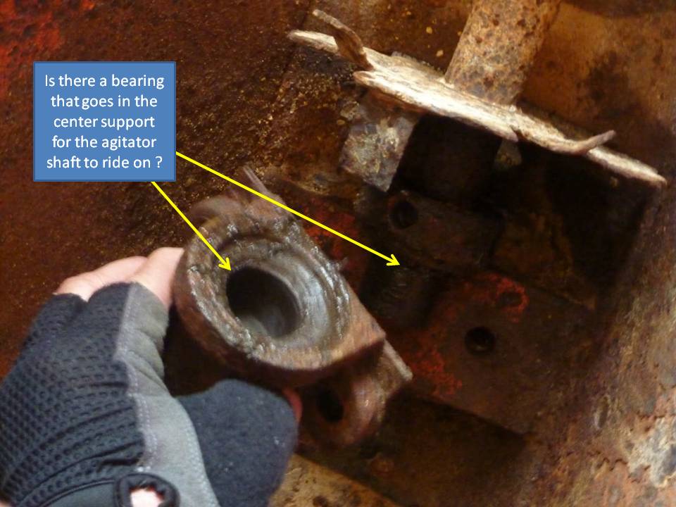

I have a question is there a bearing or bushing in the center shaft support?
I just saw the pictures you posted of the EZ Flow you bought. Looks good.....nice find! Probably worth the wait vs the first one you looked at. :thumbsup:
The pic you show is of me holding the center pillow block / shaft support. Mine had no bearing or bushing in it. It simply supports the ends of the shafts and has a collar with a set screw.
The collars on mine were frozen on the shaft(s) so when I reduced the shaft length I bought new collars. I had the (reduced lenth) shaft ends cleaned up to insert into the block (I think I had to remove some aggitator sections?). I beleive the original collars may have had some type of curves along the sides to mate with the pillow block (shown) which acted as a grease seal. The collars I bought do not have such....and are just flat. The pillow block has a grease fitting and I will keep it lubed with a few strokes from the gun.
Keep in mind the shaft is retained (in and out) by the wheel hub / cross bolt assembly on the outboard end of this shaft. The collars primarilly "just" keep he material from getting into the pillow block.

On mine the center pillow block / shaft support is loose and the shafts can move up and down. I'm assuming that this movement is wrong is that correct.
I wonder if I should put a sealed bearing in there?
