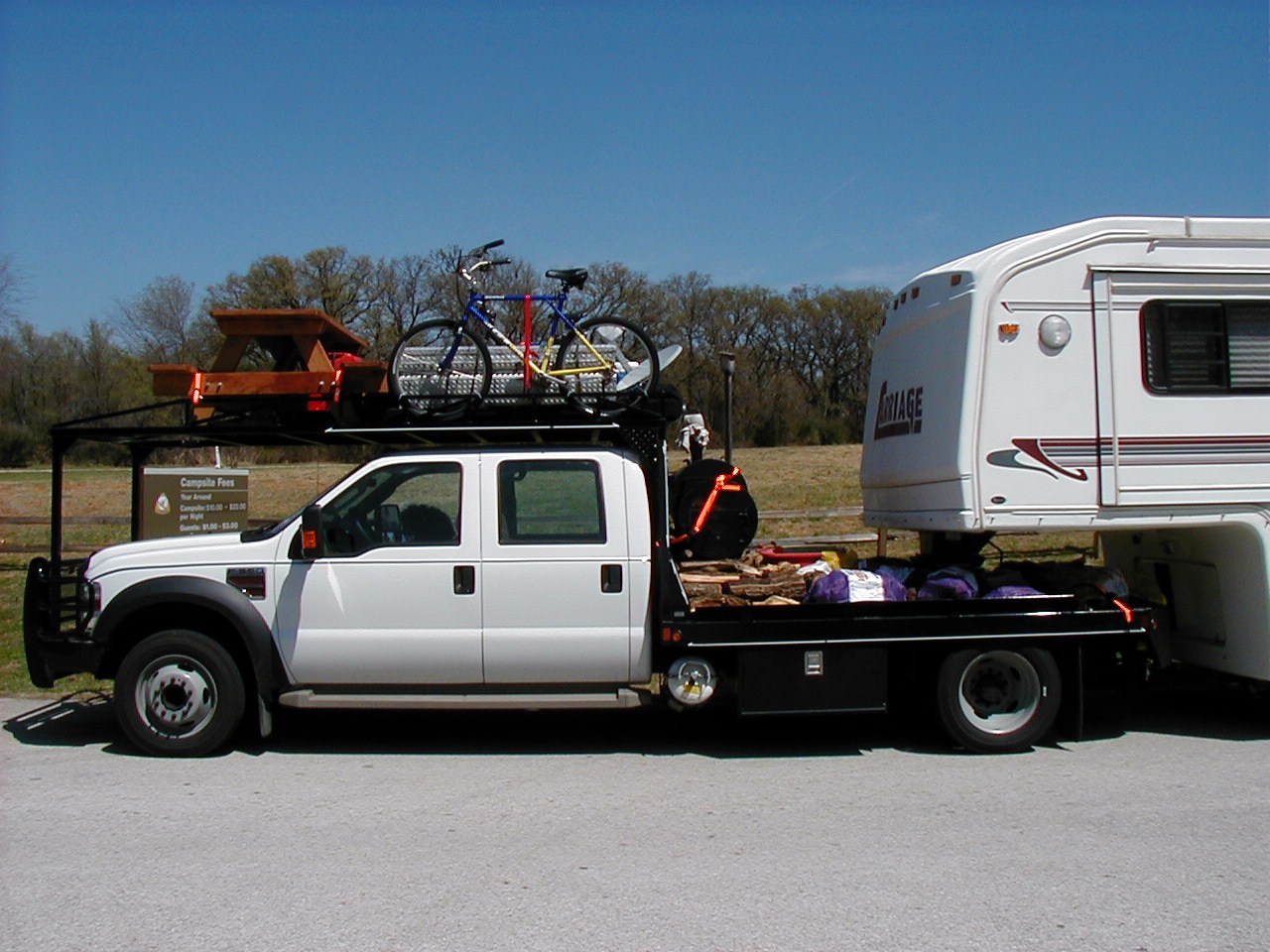

Since one of my brothers has been pulling his fifth-wheel with a 2008 F550, and I knew he'd had it in the shop a lot for emission control problems, I sent him an e-mail that he might want to see this thread. He said it was the first he'd heard of this kind of problems, but that he didn't have to worry about it anymore; said he sold that "hangar queen" to a Ford dealer friday.:laughing:
Smart man. Problem is, Ford is on to this and they won't give us much for trade in on 6L and 6.4L trucks.
The right thing to do would be to give us some kind of compensatory reward for having to put up with the problems or voluntarily recall all of them for repair.
