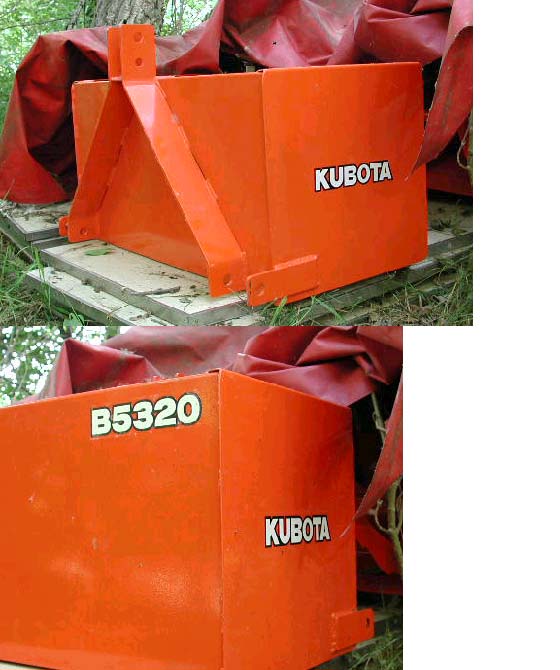

I had a thought today about this. I bought my loader this past winter. Prior to that I used a rear 3 point scoop for moving material. I've been trying to sell my scoop, but no interest. So I'm thinking that for those times that I'm moving loose material (dirt, gravel, ect...) mabe I can use my scoop as ballast and also to add considerably to the amount of material I can carry in one trip. I think it would work great if the scoop is filled first before the loader and then dumped last after the loader. I don't know how much a filled scoop would weigh, but I'll bet it weighs close to what my 48" loader bucket weighs when full. Scoops are fairly cheap to buy. This might be the ideal counterbalance when moving material is the job.
   / FEL Counter-balance #23
Rogue
Here is the ballast box that came with the loader

I bought wheel weights for my BX when I bought it 3 years ago. Worthless if you're talking about ballest for the FEL. I use my 72" rear blade, works fantastic. But to be honest, you better practice with it and get used to pucker factor because BX's are VERY tippy. I move a lot of stone and have had to slam the loader down more than once till I learned my lesson. Don't get me wrong, I love my BX, but the narrow wheel base makes loader work with heavy loads tough.
