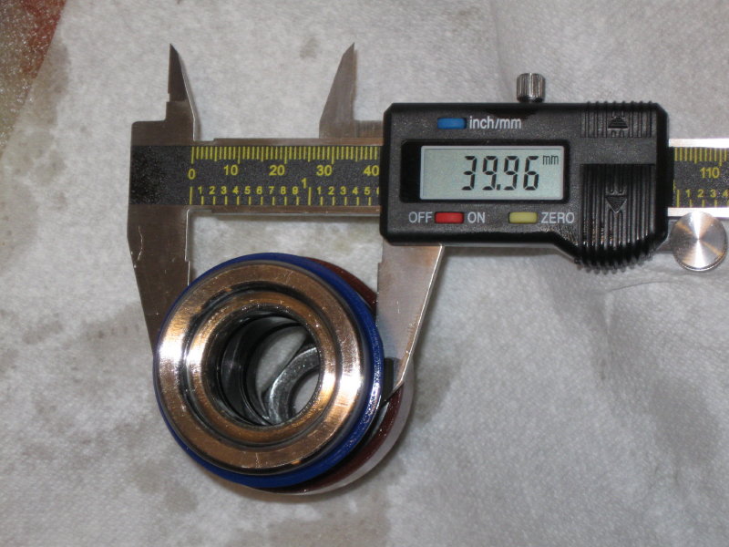

Andy,
Need some assistance with the wear bands.
Measurements are:
Cylinder bore (ID): 45mm
Piston (OD): 42.65mm
Groove 'wear band' seats in: 39.95mm
Height: 14.87mm
1. What material is this wearband made of?
2. Can you point them out on the www.mfpseals.com website?
3. Rule of thumb 'torque spec' for nut that holds piston in place?
Thanks,
Don

45mm is the od, 15mm is the height, and 2.5mm is the thickness. Your piston is 39.95mm or 40mm for arguments sake. 45-40=5mm, divided by 2 because you are measuring both sides of the wear band gives you a thickness of 2.5mm.
As far as a torque spec goes, I figure the thread od and look at a torque chart. They can be found in any good catalog. With torque, more isn't always better.
Good luck, Andy

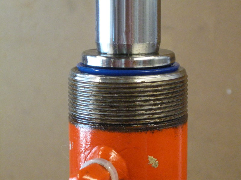

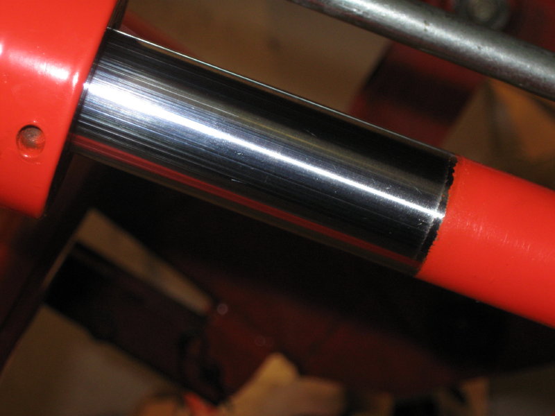

Cylinder reassembled without a hitch. Oiled the inside of the cylinder and the seals first, then with a little pressure and 'wiggle' the first seal slid in. A little more pressure and the second seal slid in.
Finished the reassembly, some fresh paint, then remounted the curl cylinders back on the loader frame. Initial results are promising. Raised the loader bucket waist high, leveled the (empty) bucket which extended the curl cylinder about 3.5". After 5 hours there was no leakdown, the cylinders did not extend at all. After 14 hours the cylinder moved out about 1/8" of an inch. :)
Just in time for the late season snow storm :eek: we're getting.
Don
