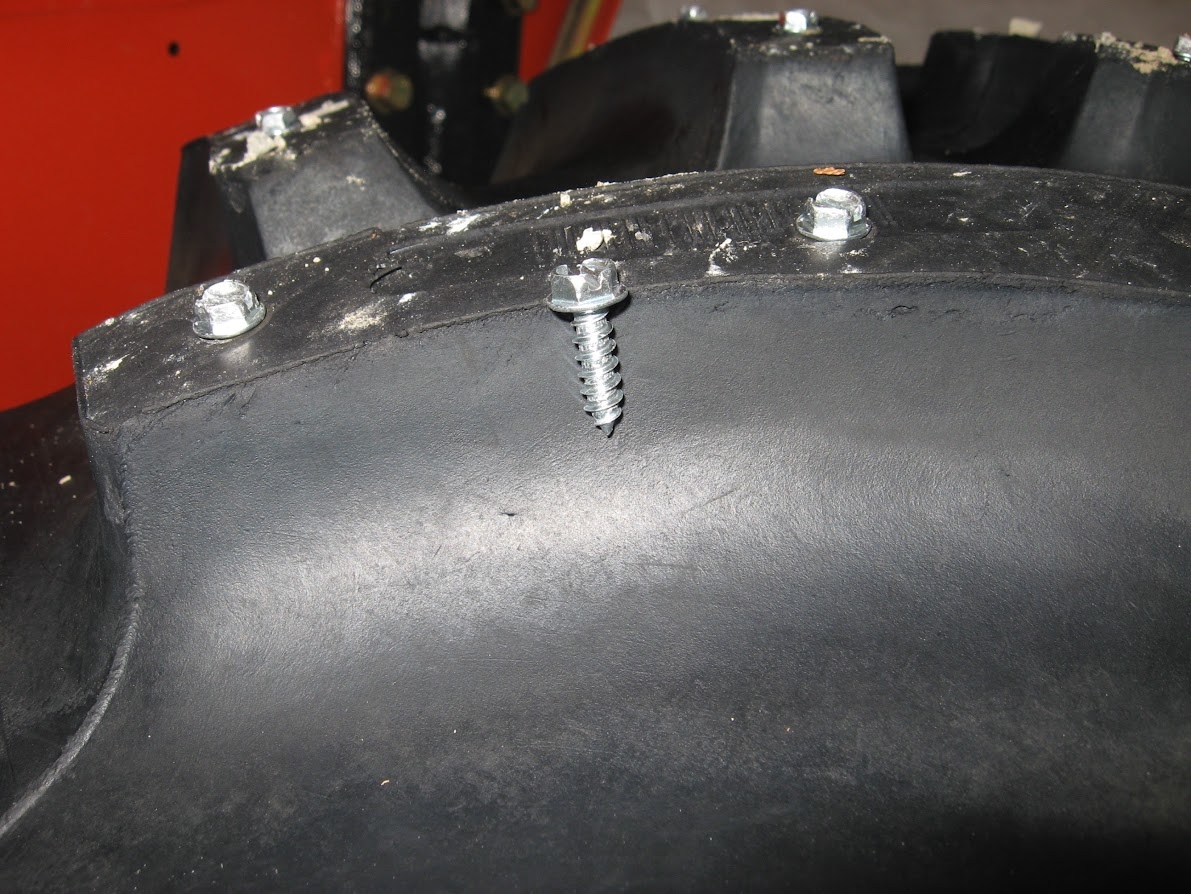

I would try the rear blade first, make sure you can reverse it for heavier snows, or try to plow with the storm. Also if your tires have the tread depth, you can stud your tires for $20-30 with some hex head sheet metal screws. They give some decent grip on ice, but won't damage your road or your tractor with too much traction. I pop these in if my driveway gets too icy, and leave them in until spring. They don't seem to wear much and I've used the same ones for a decade now. These ones are pretty large 3/4" ones but going down a size will work and I've used very small ones for the ATV tires to plow the pond.
