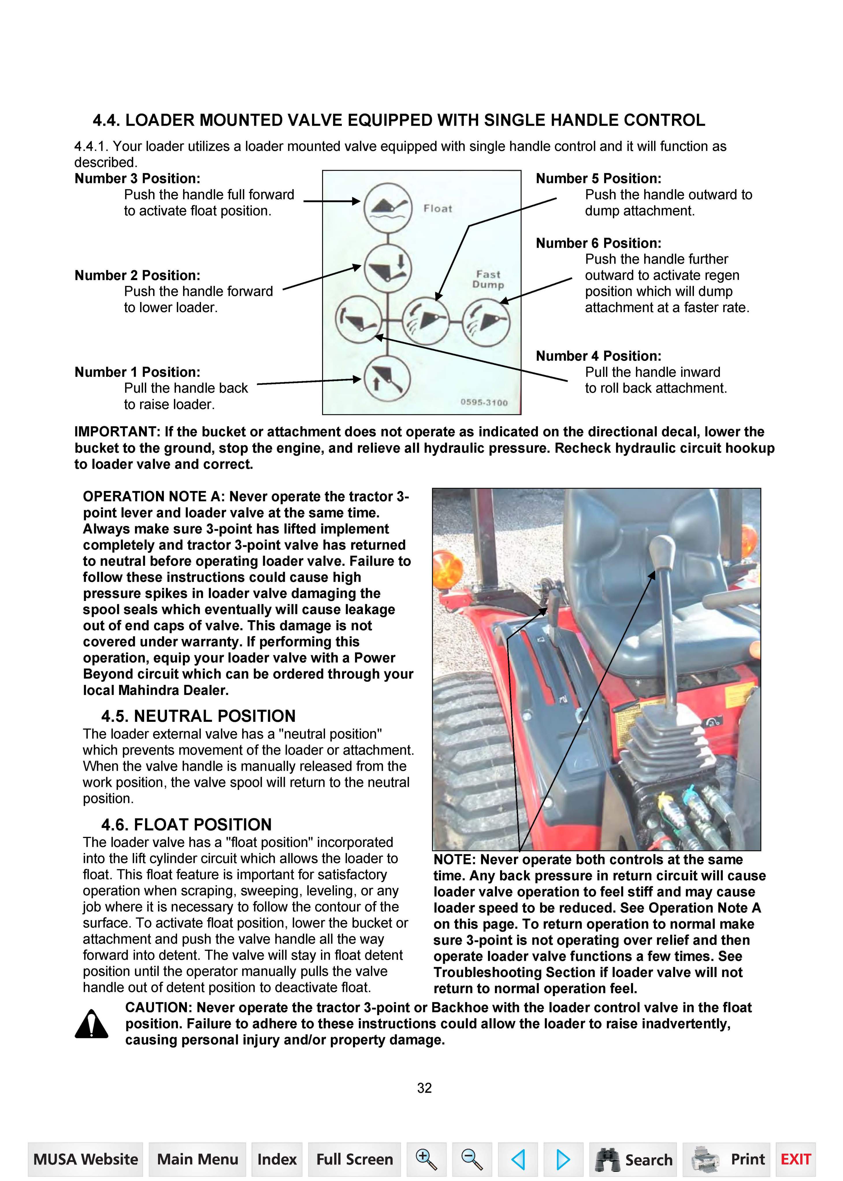

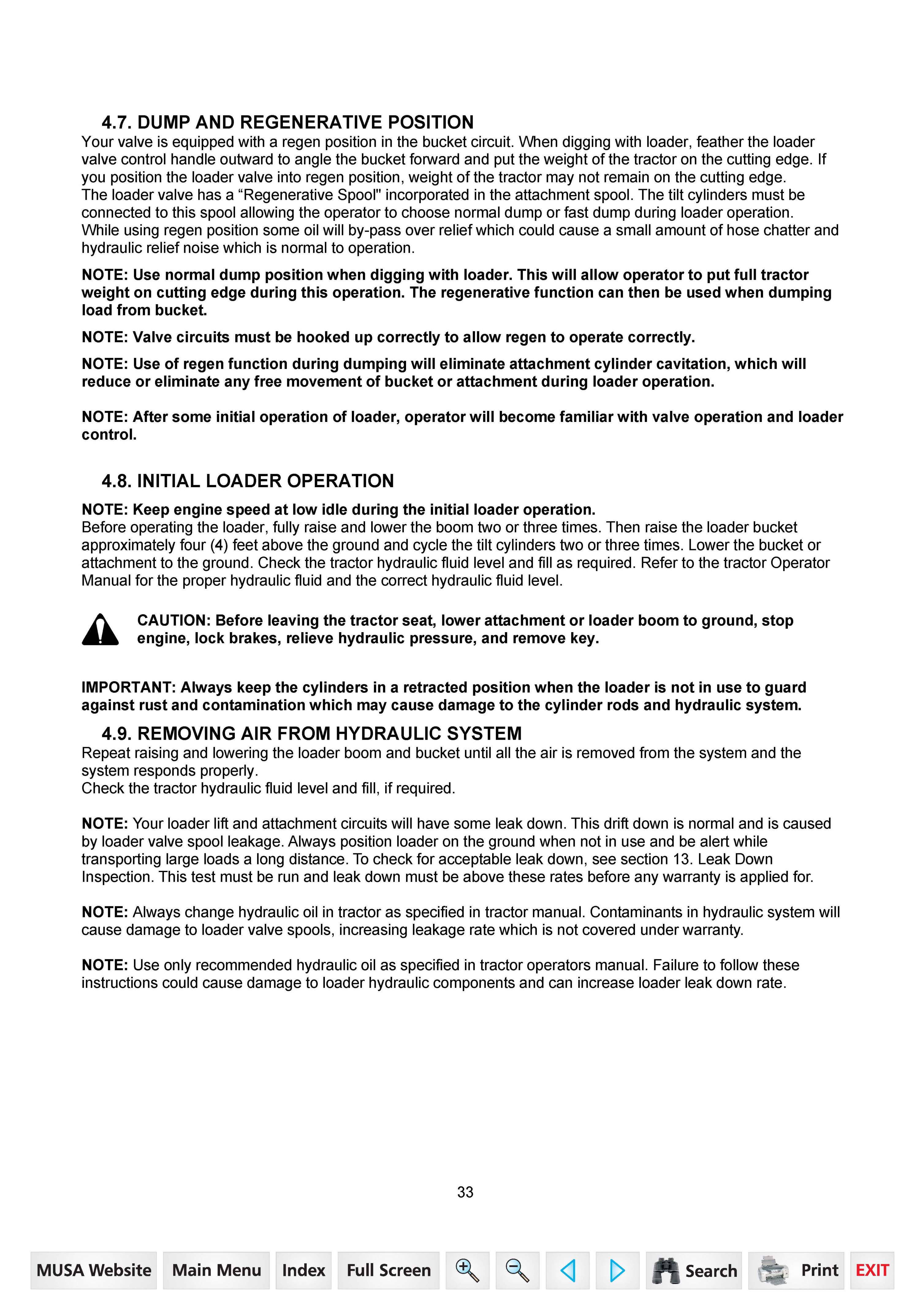

I gave my loader manual a read thru last night and found that a regen mode is indicated in the usage instructions. The wording is a lil wonky to me, so maybe someone can decipher.
These are the 2 pages were the regen mode is mentioned.
-J

Does your regen work like it should?
Do you really have a fast dump?
That's where I'm unsure. It says I do, but I've never been able to "find" it.
I've always been under the impression that it just wasn't there, but these pages are now making me doubt myself again. I haven't been able to try the method it describes just yet... maybe tonight, definitely this weekend. I'll be sure to post back when I do.

If you move your lever slow enough to the right you will find a point to were is pauses... not fully stopped but slows down a lot. then when you go further right it will go fast... its not noticeably faster than the first speed so your tractor is operating normal.

It is certainly not much faster than normal dump (which is really slow). I found it telling in the description Shift provided that use of regen eliminates cavitation and thus bucket will have reduced or have eliminated "free movement". I thought that was the purpose of "regen" so as to free up the cylinders so the bucket WOULD move more freely and dump faster. That tells me the valve is designed so total diversion of flow is not attainable. The description further states that valve hook up must be correct to attain regen. How do you mess that up? All bucket movements correspond to the descriptive use of the bucket so where could an incorrect hookup be if the bucket is functioning as it should?

Using regen, you should almost double the speed as the pump flow and the rod end flow is now gong to the base end of the cyl.
If you creep the lever to the right, past the soft stop, it might not seem fast, but if you slam the lever to the far right, you should see a big difference.
The regen is not only there to stop the cavitation, and floppy bucket, it will do a fast dump, because you are almost doubling the flow to the base end of the cyl.

On the regen thing, here is a good explanation from kennyd from another site. He is talking green tractors, but I think the theory applies:
Regen is a "feature" of most modern FEL (Front End Loader) valves, it's on the Dump (joystick far right) circuit, and is also referred to as "Fast Dump". The reason it is nice to have is that without it, the weight of a filled bucket can actually "pull" the bucket down faster then the fluid can enter the other side of the cylinder, this will create a air pocket and give the bucket a "floppy" feeling until the joystick is held in the dump mode a few seconds to refill the cylinder pushing the air past the seals. So we add "regen" or "regenerative" function to the valve.
Regen solves this problem by actually filling both sides of the cylinder at the same time with hydraulic fluid. But how will that work you might ask? Well, because there is more volume on the side of the cylinder that extends it since the rod is taking up space in the other side, it "overpowers" the rod side and lets the cylinder extend-thereby dumping the bucket. So since now both sides of the cylinder are "pressurized", the air pocket can not develop, eliminating the "floppy" bucket syndrome. One other added bonus is that the bucket actually dumps faster due to the higher flow rate required to do all this, that's why it's referred to as "fast dump" sometimes.
So, now you may be asking "this is cool and all that, but why do I need to know about it? The answer to that is simple, if you ever try to run a snow plow with two SA (single acting) cylinders, or a cylinder that drives a chute rotator on a snowblower you will soon find out that they won't work if you push the joystick to far right in the regen mode. The plow won't work because since both lines are pressurized-both cylinders will be trying to extend at the same time binding everything up. The rotator won't work because there is no weight pushing the cylinder closed like there is on the loader.
On most, if not all John Deere tractors there is a lockout the limits how far the joystick travels to the right to keep it out of the regen mode.
/ FEL Quick Dump #60
Both the max and the 3016 take right around 4 seconds from full lock to full dump. I checked about 3 of each. You will not feel a bump or change in the lever when it regens. When yall operate the lever start pushing to the right very slow and about halfway you should see the bucket pause. then keep going and it will start dumping again. Its hardly faster than before the switch but it is just a bit. When you use the float it will take away all functions of the loader this lets the weight of the bucket and loader float while back dragging. If that's what you ment by no tilt while in float mode.
