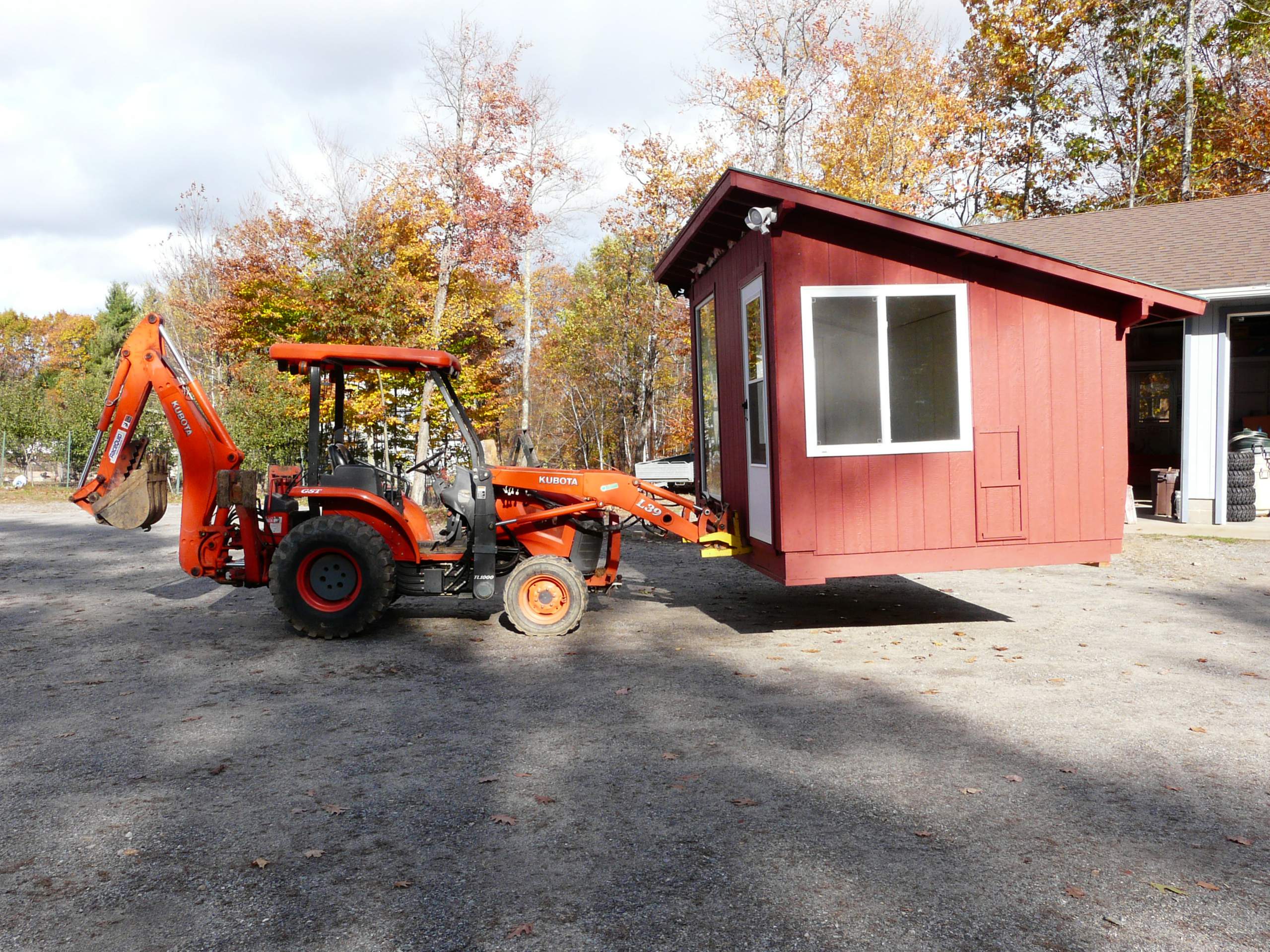

Here is about 750lbs and is distributed WAY outside the pins... IMG_2337.jpg
/ FEL Quick Dump #92
Actually its over 800lbs now looking at the specs of the pallet fork
/ FEL Quick Dump #94
Here is about 750lbs and is distributed WAY outside the pins... View attachment 417365
That is nice to see that the Max28 when set per spec can actually lift something. I have lots of stuff where a small tractor that has some fight will fit the job just fine.
Those L39's are surprisingly strong. Onr thing I've always wished I had was a mini exc. I hear where guys have picked one up for a song but that's not my luck. One of my friends bought an entire full size Bucyrus Erie for 6 grand made in 1961 and it still works.
/ FEL Quick Dump #97

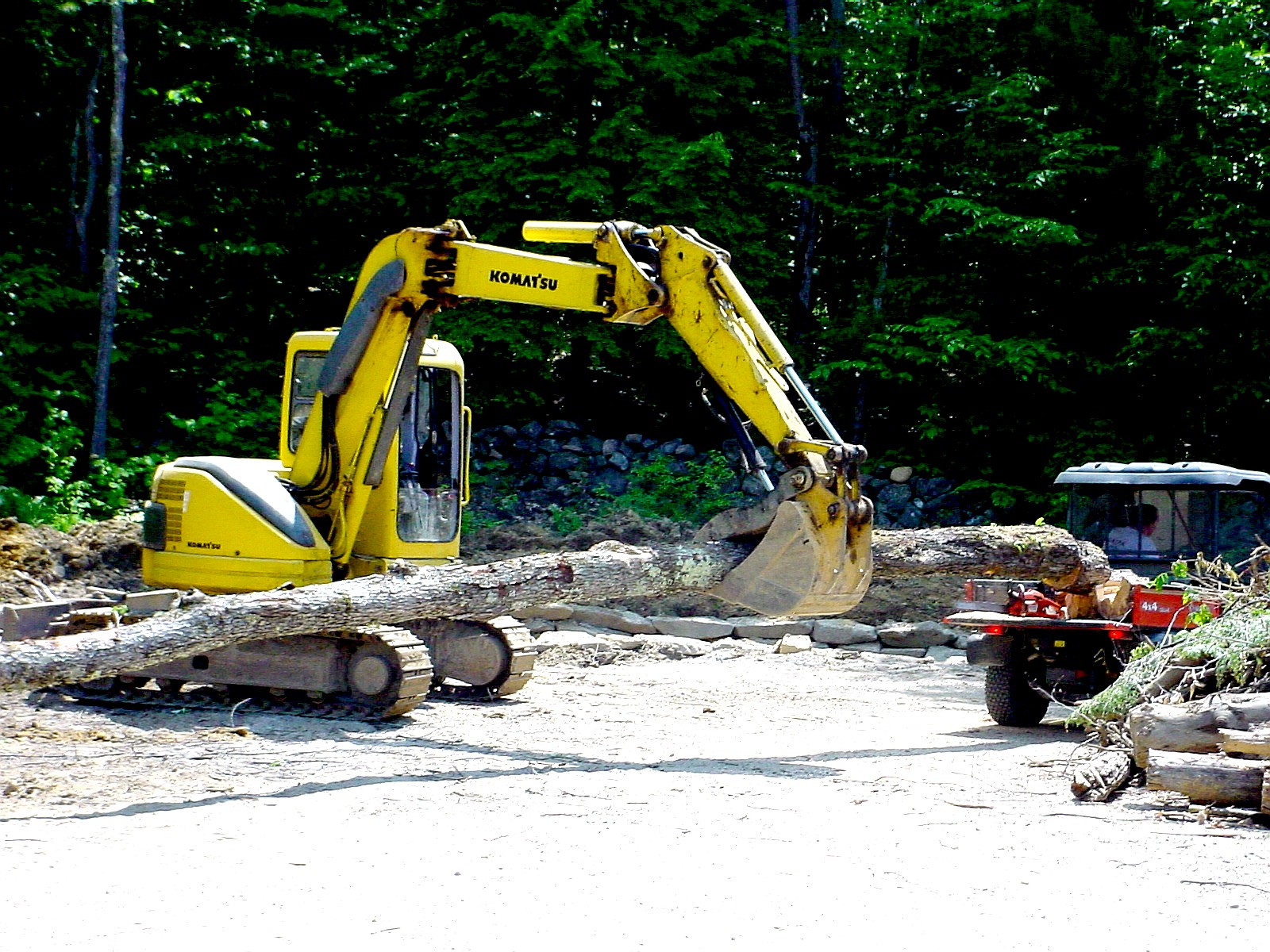

Some of the Kubota Loaders are decent, others not so much, only good for manure, hay and sawdust.
Used the Excavator today to reach in the pen and lift our just slaughtered big Black Angus Cow on to the butchers truck for processing, As the cow weighed near 1,200 lbs, the L39 would really struggle. The L39 BH is rated to crane 1,100 lbs, but the thumb lowers that by at least 100 lbs and does not have a lot of reach or lift height. My excavator weights over 17,000 lbs. I would not want to have a smaller excavator.

I love that thing. Where'd you find it?
/ FEL Quick Dump #99
I bought the excavator thru an Ebay Store.
The seller did not want to deal with hassle of selling it himself, so when he bought a new machine he parked his old machine on the Komatsu dealer lot telling him to sell it. The owner also listed it on E-bay and had an E-Bay store deal with the leads. Long story short, I did talk to the actual owner, did the financial stuff with the eBay store, and did the inspection, initial service, and delivery arrangement though the Komatsu dealer.
My PC75UU2 has 5601.3 hours ( I looked) All functions work, except the radio, the AC when it gets too hot out, (overheats the machine) and the fancy computer, (yes, the thing has a real computer and its a 1997!) The computer would set your dig depth and how close the bucket can swing to whatever your trying not to damage. It is a grey market machine, built for construction work in cities. It had potentiometers and sensors on all the joints of the stick so the excavator knew where the bucket was relative to a touch off point.
