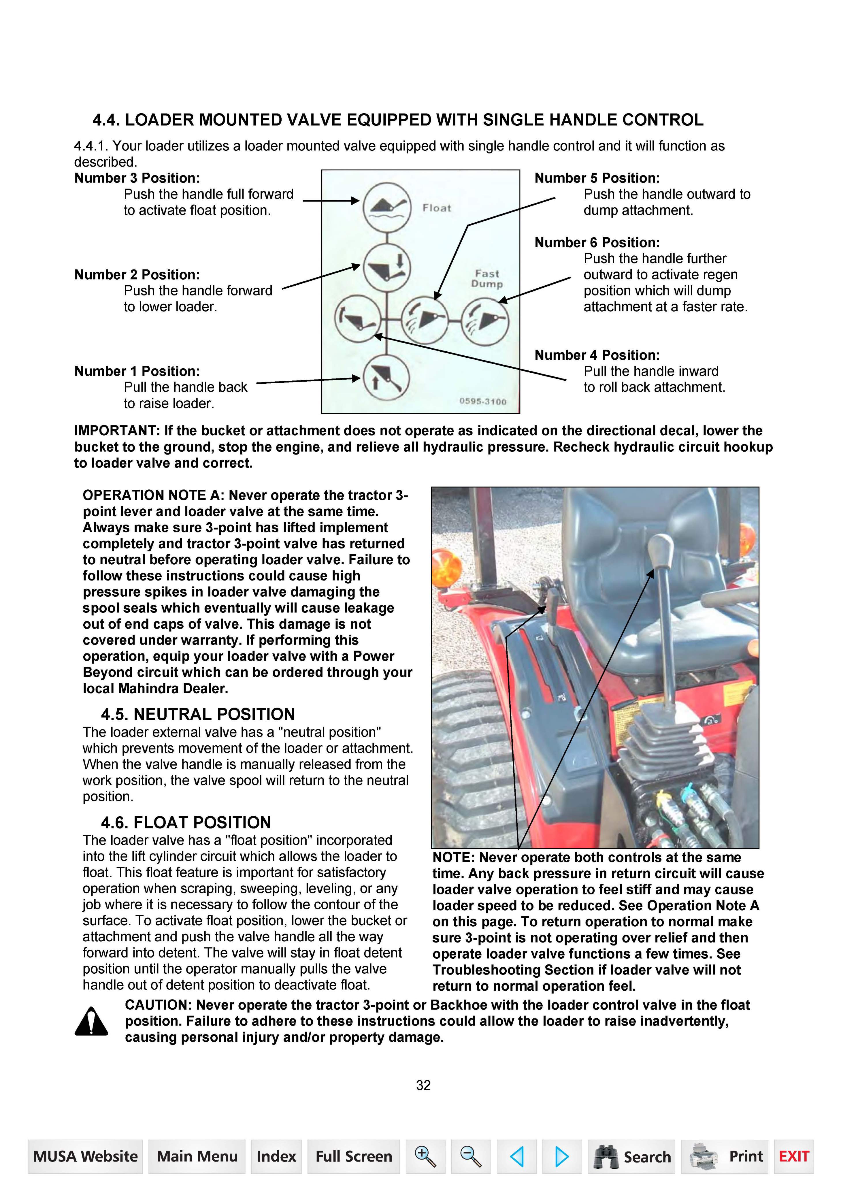

On the regen thing, here is a good explanation from kennyd from another site. He is talking green tractors, but I think the theory applies:
Regen is a "feature" of most modern FEL (Front End Loader) valves, it's on the Dump (joystick far right) circuit, and is also referred to as "Fast Dump". The reason it is nice to have is that without it, the weight of a filled bucket can actually "pull" the bucket down faster then the fluid can enter the other side of the cylinder, this will create a air pocket and give the bucket a "floppy" feeling until the joystick is held in the dump mode a few seconds to refill the cylinder pushing the air past the seals. So we add "regen" or "regenerative" function to the valve.
Regen solves this problem by actually filling both sides of the cylinder at the same time with hydraulic fluid. But how will that work you might ask? Well, because there is more volume on the side of the cylinder that extends it since the rod is taking up space in the other side, it "overpowers" the rod side and lets the cylinder extend-thereby dumping the bucket. So since now both sides of the cylinder are "pressurized", the air pocket can not develop, eliminating the "floppy" bucket syndrome. One other added bonus is that the bucket actually dumps faster due to the higher flow rate required to do all this, that's why it's referred to as "fast dump" sometimes.
So, now you may be asking "this is cool and all that, but why do I need to know about it? The answer to that is simple, if you ever try to run a snow plow with two SA (single acting) cylinders, or a cylinder that drives a chute rotator on a snowblower you will soon find out that they won't work if you push the joystick to far right in the regen mode. The plow won't work because since both lines are pressurized-both cylinders will be trying to extend at the same time binding everything up. The rotator won't work because there is no weight pushing the cylinder closed like there is on the loader.
On most, if not all John Deere tractors there is a lockout the limits how far the joystick travels to the right to keep it out of the regen mode.

Statement: Regen solves this problem by actually filling both sides of the cylinder at the same time with hydraulic fluid.
Not true, as the rod side fluid is flowing out of the rod side through the valve and to the base end.
The flow in the base end is actually pushing the rod side fluid out to the valves other work port.
Regen will work whether there is a load or not.
Some Kubota tractors are different and have regen next to neutral, so they are in regen when starting to dump.
If they do not want regen, the lever is moved further to the right for power dump.
Regen is more noticeable at fast engine rpm's.

Here is a fact about regen.
You know when using a cyl, that fluid flows to tank from the rod side or the base end.
However in regen, the tank outlet is blocked by the regen spool, and all flow is routed to the base end of the cyl.
So, if no fluid flows from the tank port when using the curl spool to dump, you are in regen.

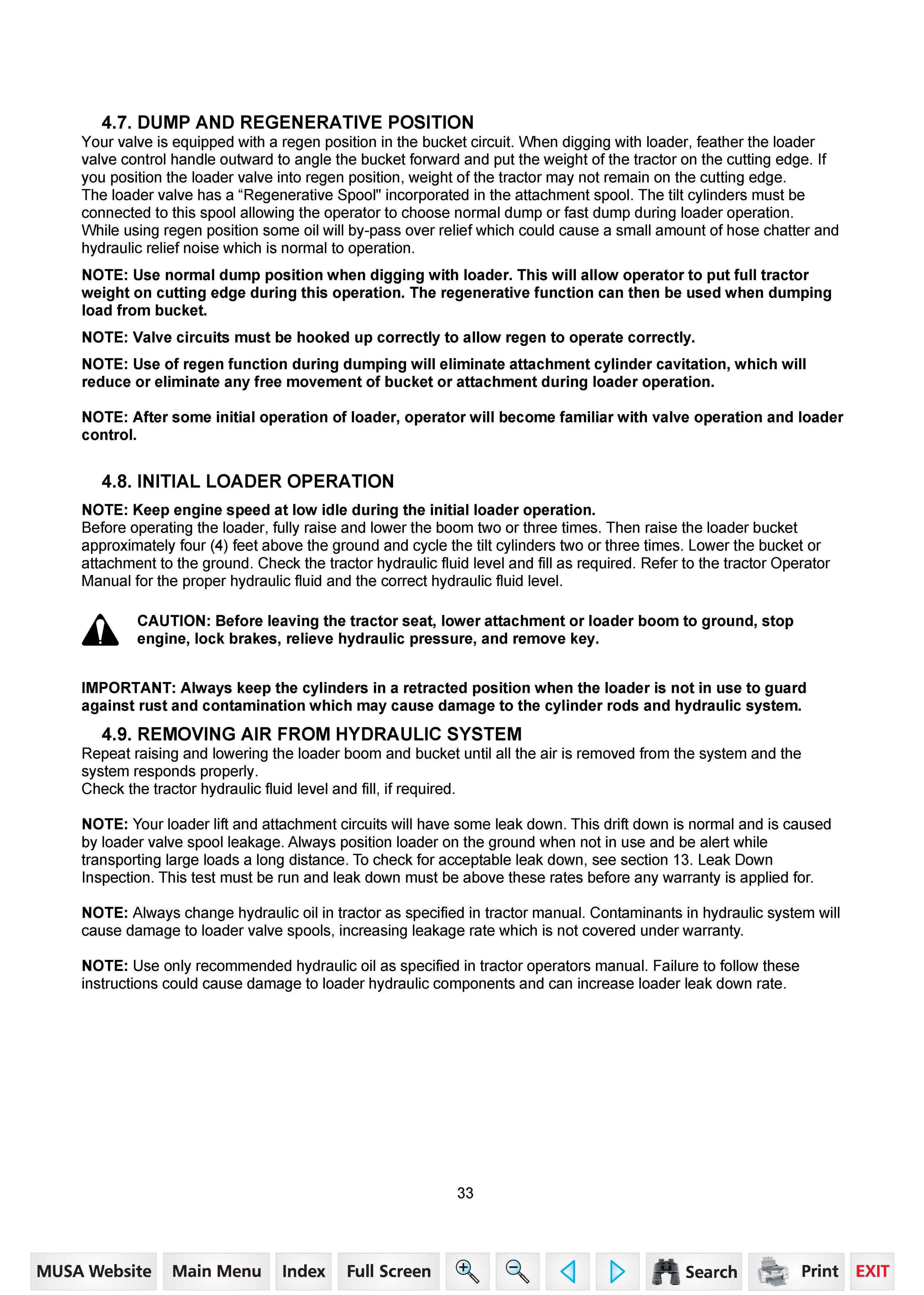

This post was a long, good read. Well I think my Kubota L39 only has regen on dump only. That explains the quick speed it will dump and the total lack of oomph it exhibits on back curl. I think Kubota was afraid the large cylinders would sheer the bucket travel stops if it had full pressure going to the piston side of the dump without regen. Still not all that much power in heavy duty back dragging.
I palyed with my new Mahindra Max28 tonight.
The regen circuit operates just as expected in the manual. back curl is strong, until to pushing to regen, and regen is faster than a no regen dump, but not impressively fast.
I think the hydraulic relief is set way too low. It will pick up the front end just barely with the loader arms, but the small bucket will get stuck driving it into a soft snow bank. The Max28 seems only marginally stronger than the very tired loader on my 30 year old Kubota B7200D.
Kubota B7200D 4x4 With loader
Why does it the Max 28 smoke more on startup (Light grey Smoke, maybe a hint of blue) than my B7200D Kubota does after it sat idle all winter? I wonder how the Max 28 was broken in the 2-1/2 hours run time it had at the dealer? (There are 4 hours on meter now) Do other people experience a good long puff of smoke on start-up?

yup, move the lever a little, it dumps reeeeaaaallllly slow, then a 'dead spot' in the lever, then what I would call a normal dump. There's nothing fast about it....but acceptable.
I just never paid attention to it before.
I didn't check the 'cans' as I suspect mine is what everyone else has.
Thanks for the great explanations everyone.
