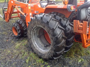

I put dual tires front and rear(one rear with anitfreeze) on my L 2800 and besides keeping me off my nose when picking up heavy loads (almost daily) it adds a lot more stability side to side as I am mostly on uneven soft ground. Kinda spendy but worth every penny.

We have got to see pics of this L2800 with duals front and rear.

Here Randall, the rear ones are commercially available but I had to make the front ones myself.
   / FEL -- Rear wheels in the air!! #28
lets try that again pics didn't attach will try just one this time

Why did you choose to go with smaller fronts? I am guessing turning but do they really provide traction and stability??:)
