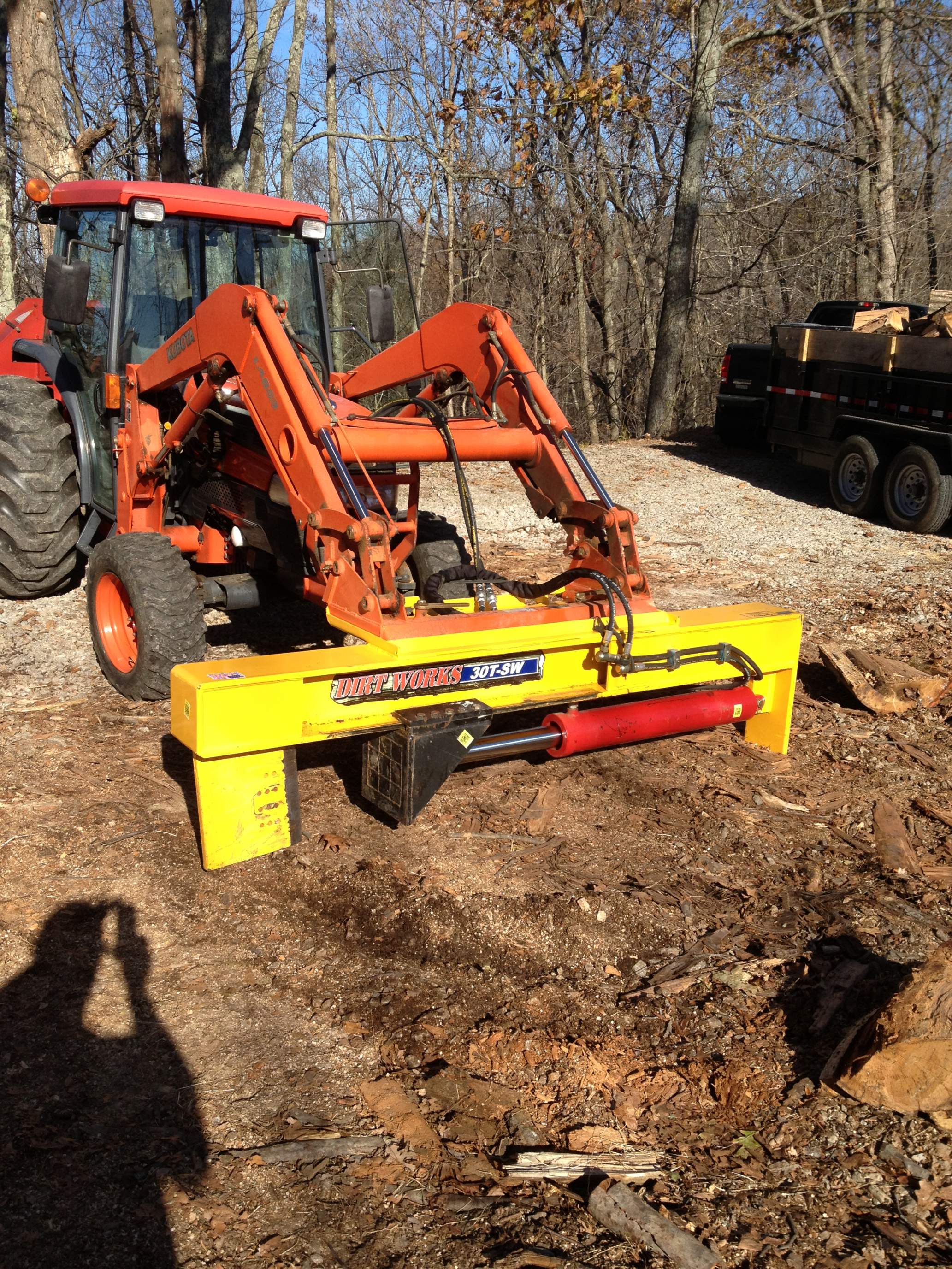

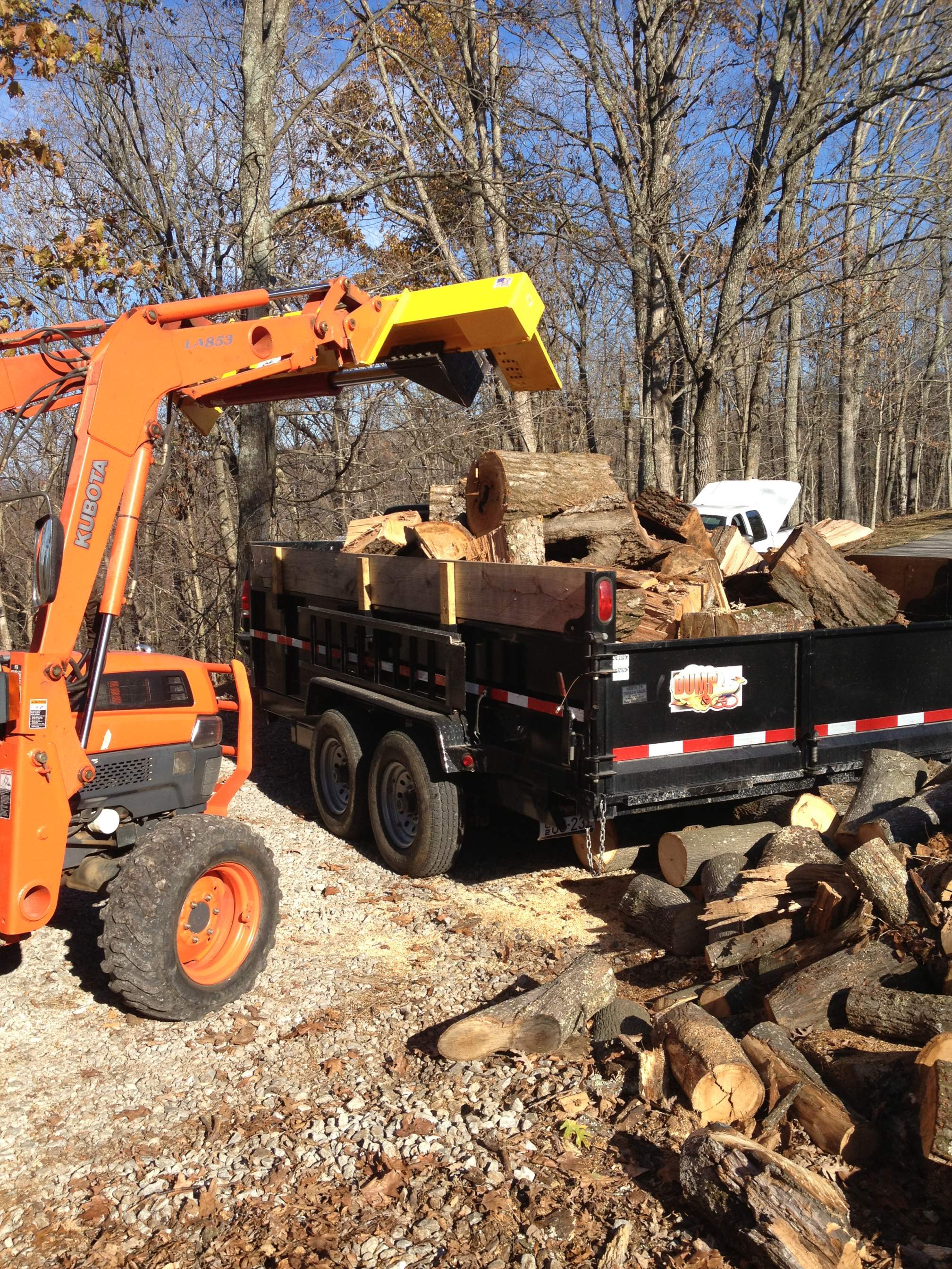

I got my splitter on Friday and I'm glad I did, splitting and handling the wood will never be the same. I quarter the large pieces of wood and let them fall into my dump trailer, then I haul it to my splitter. I raise the dump bed with the tailgate on the trailer shut resulting in never having to bend over and lift another piece of wood off the ground. I touch the wood one time (by hand) and that's splitting it with the SuperSplitter and stacking it. I love the visiability with the sideways splitter and cycle times are not bad at all. By the time I get the tractor turned around the splitter is open and ready for the next piece.
I give this splitter two thumbs up for ease of use and keeping possible back injuries at bay. Tomorrow I begin teaching my wife proper operation so I can continue sitting in the lawn chair with a cooler close by. Supervising is a true art and I must continue mastering/perfecting it.

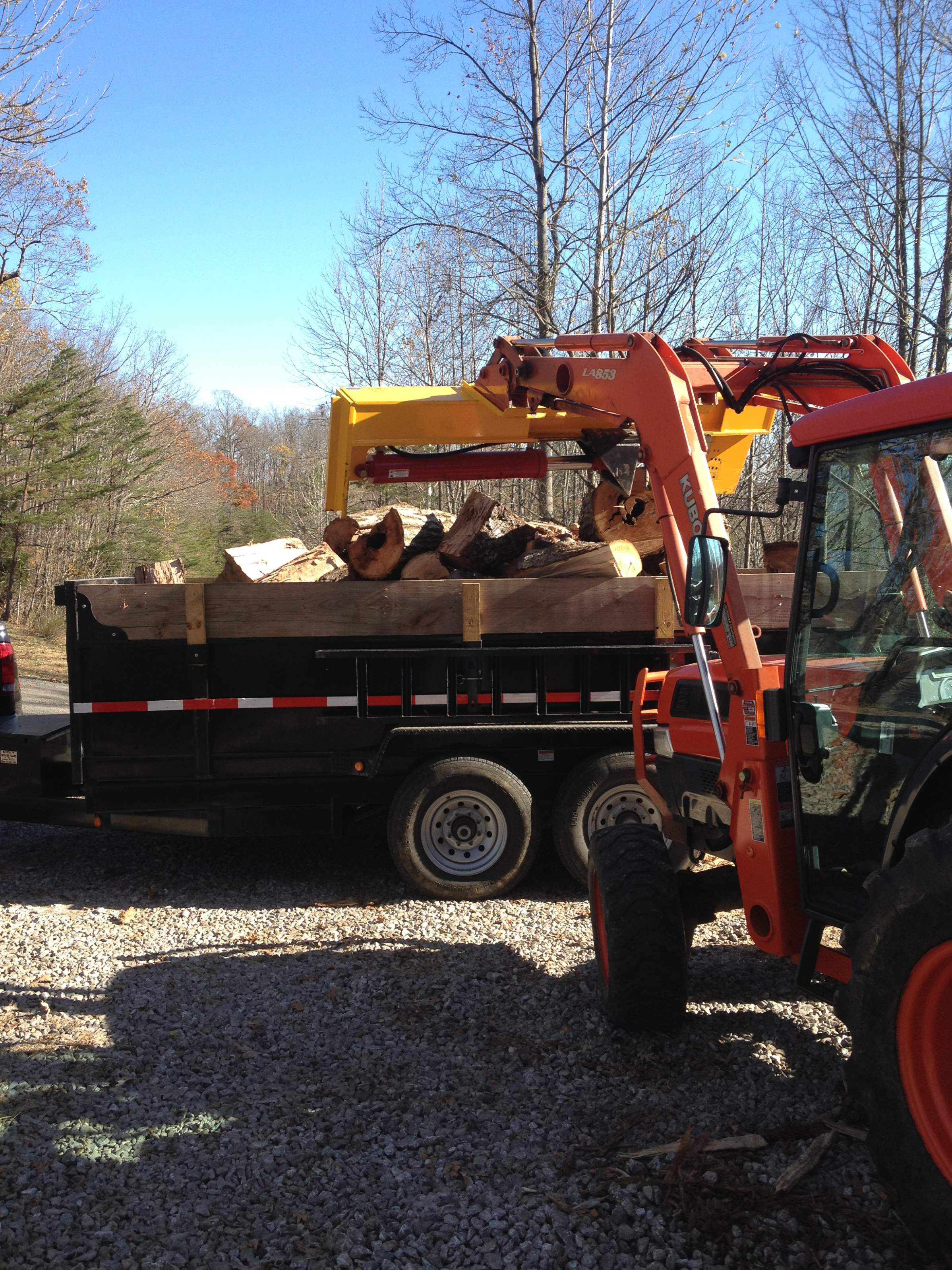

Boggen - The process involves using a chainsaw to drop and buck the limbs off, then using my Farmi Winch mounted on my 3-PT Hitch to drag the log to where I can get the FEL with the log grapple onto it, usually up the side of a mountain. I then cut the logs into 14-foot lengths and load them into the dump trailer. I pull the trailer load to an area (landing) for unloading/dumping. I take my tractor and saws to the landing and my wife running the tractor and using the log grapple on the FEL picks up the log and I cut it to 20-inch lengths, avoids bending over and keeps the cut from the uncut segregated.
The next process is I'll use the splitter wedge to manipulate/move the cut 20-inch in length pieces of wood. I'll pick a large piece out of the pile, pinch it with the splitter to pick it up and move it over to the ground to get the first split. I then take the half just split, pick it up, take it to the dump trailer and split it over the trailer reducing it to a quarter of its original size. I thought it would be time consuming with a front end loader, that is moving and manipulating the wood but I found that to be very easy and fast. I never have to leave the seat of the tractor and can quarter the wood in just a few minutes.
I haul the quartered wood to my Super Split Splitter up by my wood shed, raise the dump bed to keep the wood fed to me and with the bed in the air the closed tailgate is around the same height as the splitter, meaning, no bending over, no reaching down, simply move the quartered piece horizantally onto the Super Split table and get at it. I can quarter split and then Super Split/Stack 2 full loads (14' x 7' x 4') from the dump trailer a day by myself and still manage to stay well hydrated with Miller Lite.
My only regret is this type of splitter was not invented years ago. I have several friends with back problems relating to splitting firewood and in speaking to one of them today and showing him my pictures he is now interested in getting one himself. I will comment on the model and company I purchased it from:
1. Outstanding quality, heavy duty does not begin to describe how this unit is built. Fit and finish, perfect.
2. 30-ton model walked through some tough wood without even straining or slowing.
3. Make sure you run at least .50" hydraulic line to it from your tractor, huge hydraulic ram on the splitter but I still managed quick cycle times (7-sec in, 7-sec out) without running the tractor hard at all.
4. Excellent customer service, speak with Aaron (female), she gave me free shipping, $2,795 to my door.
In closing, in the past I always stayed away from big wood due to the effort required to handle and split it. The storm on June 29 took down over two dozen virgin Red Oak, White Oak, Hickory and Black Walnut trees on my property. These trees required a 36-inch bar on my Stihl 066 to cut through them and yes, on those large pieces I split them into 8-pieces in order to reduce them in size to be more manageable. The final update was installing 12" tall sideboards on my dump-trailer, I can't go around half loaded now can I.

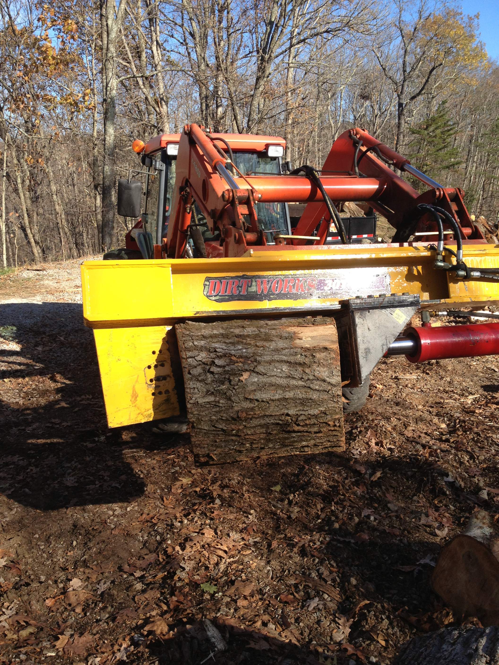

View attachment 288276View attachment 288277View attachment 288278View attachment 288279View attachment 288280
I know this is an old post but I'm building one of these splitters on Friday. I noticed you're not using the wings on the wedge for the 4-way split but you also said you quarter the rounds. Is there a reason you're not using the wings? Didn't know if perhaps you didn't purchase them of you did but didn't like them?

The wood I was splitting was of all different sizes and the wings that created the 4-way wedge was splitting the smaller diameter wood into pieces too small for what I like so I took them off. On the larger wood the 4-way wedge was perfect. The splitter I have has 3 different heights I can mount the wings and I should of tried the different heights but I was in a hurry. I will mount them at the "half-way" height this week which will allow the smaller wood to be unaffected by the 4-way and just be split in half. I'm thinking of doing a video and even mount a Hero HD camera on the splitter itself to enhance the video, will see.
