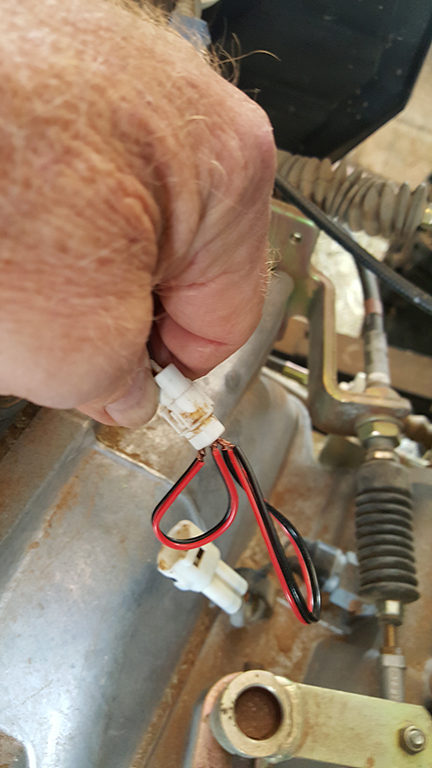

Okay now I am confused. When I shorted the switch on the transmission, nothing happened and if I read and understand what you are saying, it should have started. I am going to go short it again (right now) just to double check. Thanks Stu
Okay I jumped / shorted the switch on the transmission. I inserted two wire into the female side, one on top and one on bottom to make sure it was making contact. THE RTV DOESN'T START! This doesn't make sense unless both the starter switch and the transmission switch are bad or it is something else. Please advise. Thanks Stu
   / Fellow Kubota RTV900 owners / mechanics - H E L P P L E A S E #65
True, by jumping between those two wires, you bypassed the relay and the safety switch circuit. Try jumping between the B/W and small red/blue wire, then start the rtv like normal. Do this when everything is plugged in. Let me know.
With the relay plugged in, and if you jumper between these 2 wires on the back side of the connector, it should start with the key if the relay is OK. This bypasses the whole safety switch circuit.
   / Fellow Kubota RTV900 owners / mechanics - H E L P P L E A S E #66
The power that energizes the starter solenoid does not go through the safety switch. The power that activates the relay is what goes through the safety switch, THEN, the relay connects the B/W to the B/Y.

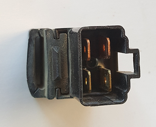

No I donot understand, Are you saying that the black 0216_2 small.jpg switch is bad?
#69
That is the relay.
I read the explanation above so from that I order the relay! Now I realize I could have goofed. Please advise if I did.
