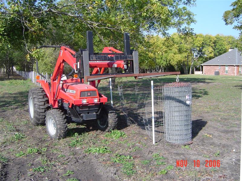

Here is what I have been using for horse mesh. It is a copy of wrought'n harv's from here on TBN. It works better than a pocket on a shirt. Same design should work with something to space the rolls out.
James
I like that! It looks like a rotating link at the top fastened to a rod or pipe running through the fence roll and welded or fastened to a round plate at the bottom. Is that right? How do you keep it from pulling back away from the direction of travel, or is that not a problem?
   / Fence Building - Barb Wire Racks #10
It does lean a little on the last 10 of 15 feet of the roll. By then the roll is light enough to handle. The reason I think it works is due to the pipe being about 1/4 inch thick and the bottom plate is also 1/4 inch thick. I have the weight working on my side.
If I remember right, Harvey's design has the center pipe passing thru the top bar keeping it from leaning in the direction of the pull.
I built mine using stuff I had around the house. I just wanted to get thru the last 5 200ft rolls on my place. It has now been used on about 30 rolls and still is working great. As soon as it fails I will build one to match Harvey's.
Thanks again Harvey.
James
