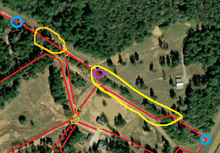

I just looked again on https://findlotsize.com/ to see how far it is between the two pins ( blue circles) and came up with 1,624 feet. Looking at the line, it looks almost exactly where I'm guessing it should go based on the Natural gas Pipeline on my neighbors property.
The distance that I want to go with the fence is 736 feet. This is from the blue circle to the left, to the purple circle.
So I'm trying to find the point along the line, just shy of half way.
There is no way to see through all the trees along the cliff. I do not believe there is a way to run a wire through the trees and pull it straight.
If you looked at the side profile of a spoon, and follow the shape of the bottom of the spoon, you can get an idea of what the ground is like. Except the spoon is bent down, so the tip of the spoon is a fair distance below the handle. The spoon part is in orange, but it goes all the way to the blue circle to the left. The area to the right of the orange circle, to the blue circle to the right is almost flat.

Is it possible to measure out x feet into to pipeline from the 2 blue circles, then find a straight line between them, then measure back x feet to the purple circle?
   / Fence Line App for my phone?
#58
Yes, I could go 25 feet into my neighbors land and pull the wire there, then measure from the wire to my property line. That might work!!!!
If you need to be more accurate using this idea, pull a 3,4,5 triangle at each of the 2 blue points and another at the purple point.
to do this, you would have to have at least one known straight line to work from.
If you don’t have any known straight lines to work from, the 3,4,5 triangle should still get you to within a foot or so.
