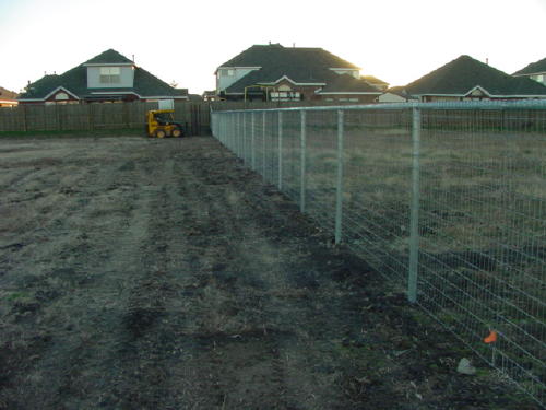

I thought I'd take a picture first thing this morning. /forums/images/graemlins/confused.gif

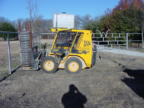

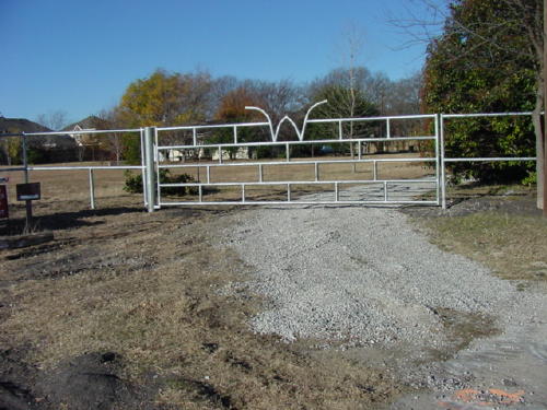

I told the customer that for that price he got a plain pipe gate. The other day he meekly asked if I could maybe put a dubya in it.
I asked him what kind of a dubya did he want.
He explained that all he wanted was one of those square piece ones made out of the pipe in the gate, you know the kind everyone does.
I busted out laughing. I told him not to worry. I'd already planned on a dubya in his gate. I promised him he'd like it.
There's within a couple of inches or so a hundred and twenty five feet of two inch (2 3/8") schedule forty pipe in this gate at three point six four pounds per foot if I recall correctly. It's heavy enough to make the grunt factor do a double take.
The bends I did with my Hossfield. I just bent some pieces. And I went to a little extra trouble to make none of the pieces exactly alike. I don't work that way. /forums/images/graemlins/tongue.gif
I used a bud's shop floor to weld it up. His man is one of those real quiet deadly types. He'll sneak up an idea on you without saying squat that will put you on your heels if not flat on your back. He was looking at those short pieces of bent pipe, them wheels a gnashing almost audible like.
I explained what I wanted and then had more fun than if I'd laid it out myself watching him out of the corner of my eye while I welded up the rest of it.

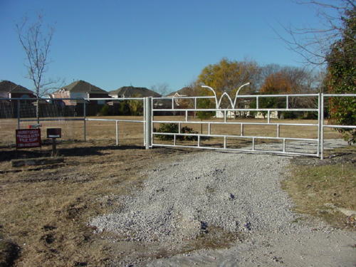

If you look at the hinge post you'll see that I use the gate upright as part of the hinge system. That's point one five four wall galvanized two inch pipe. The pipe is hot dip galvanized. That means it's galvanized inside too. That's a good thing.
Now the pipe has about a two point next to nothing I.D. One of the problems with hinges is if they're not kept lubed and active and they're the same metal they freeze up. Especially if they're mild steel. Rust can be the tie that binds. /forums/images/graemlins/grin.gif
The pin for that hinge is two inch stainless bar. It's not cheap, twenty two dollars a foot for scrap price if'n you're buying. Of course this gate has less than a foot of pin in it. Actually there's a four inch piece at each end. That's enough to tie into the strength of the horizontal rail which is what I think is important. The stainless and the galvanized combination should never bind. They'll also last past my lifetime. /forums/images/graemlins/smirk.gif

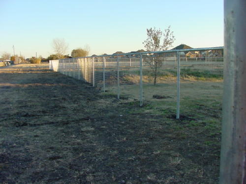

Then I got out the camera near the end of the day for a couple of progress shots.
This is standing next to the gate looking south.

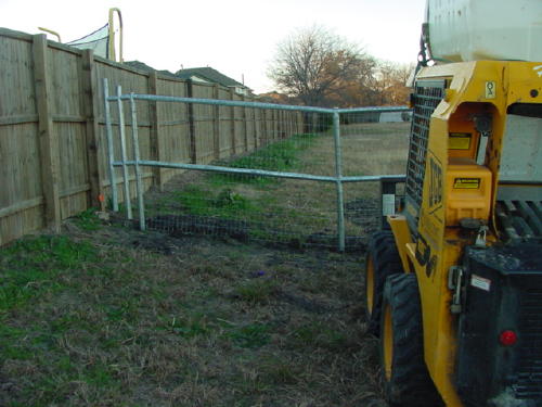

This little angled panel took as long as stretching a full roll. Pain in the backside. But part of it.

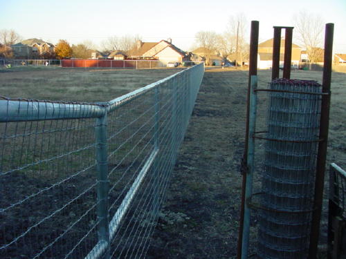

Looking east.
This is five foot non climb horse wire.
I use steel fence ties. Aluminum is for sissies. It doesn't work worth a flip besides getting a job done half way fast like.
When I'm done each fence post will have four ties. There will be five ties between posts on the top rail. Each tie will be tight.
Lately there's come out these twist ties. A couple of problems with those. First the ends are a potential hazard to livestock. Secondly and just as important, they don't secure the wire the way a fenceman doing a steel tie does.
When a tie is put on properly the ends do not present a hazard. And it works with the post and the fabric to get the best out of each.
I'll climb off of my soapbox.
I like my work. I hate to see the craftsmanship taken out of it.
