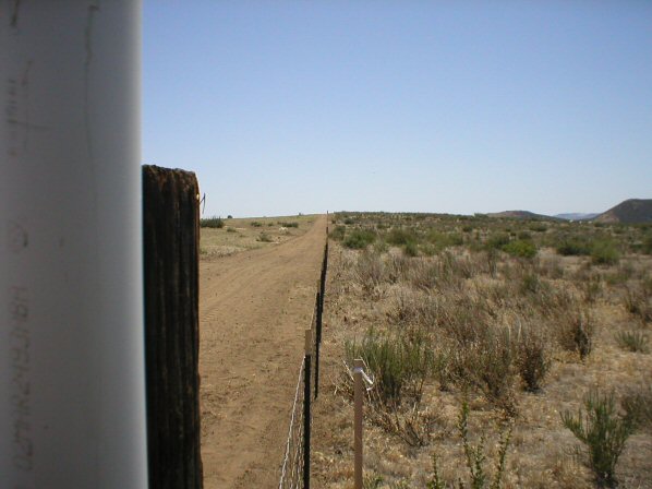

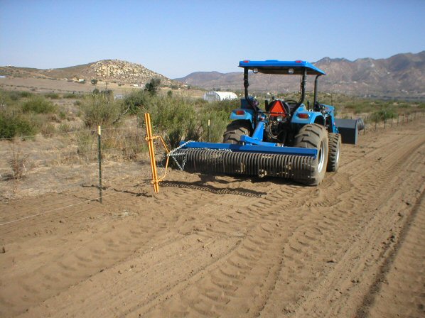

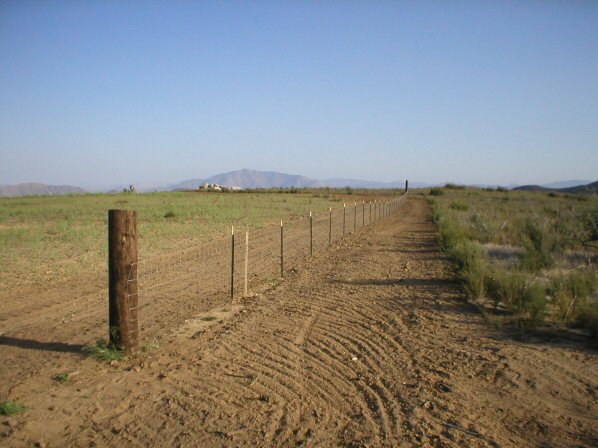

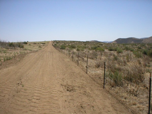

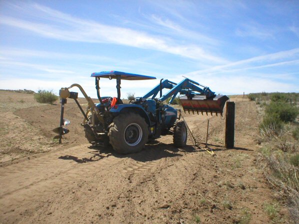

I am surprised at how few people use old telephone poles. I don't see the need for all the bracing myself, I guess it might just be my conditions though.
