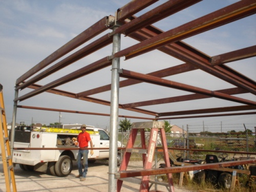

When the purlins are attached I think it comes a little easier to see the simplicity of the system.

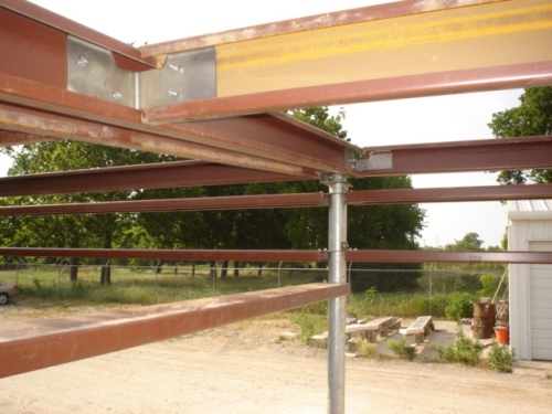

Here's an example of one wall attaching to another.

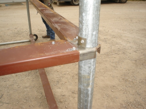

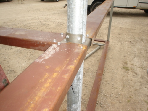

My purlin to purlin connectors are also part of the patent.

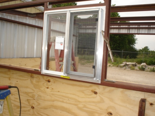

The same purlin to purlin connectors enable one to frame up openings. Here's a window.
But a door frame is no more difficult.
