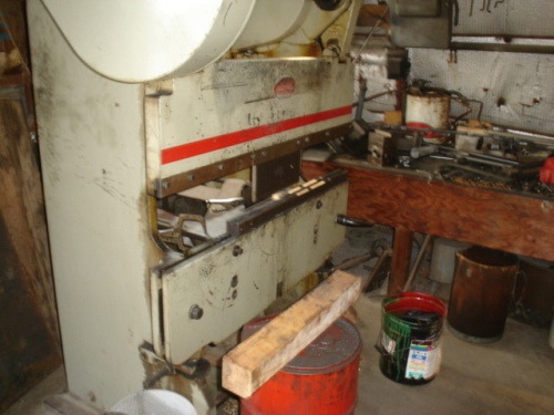

   / Finally, a barn built with our new connectors
#24
The break gets a lot of work when doing my brackets.

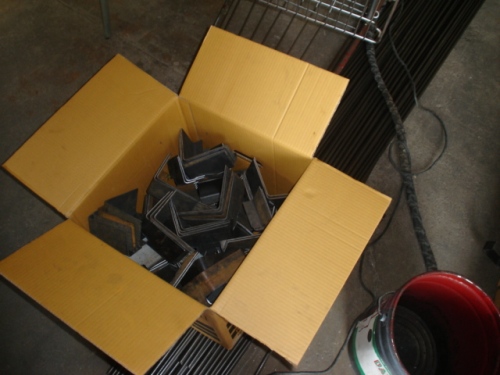

Here's some purlin to purlin brackets we made today.

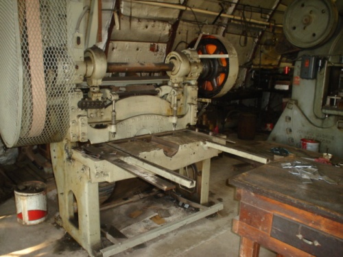

I have to cut down the four by eight sheets into two foot widths for this shear. It's willing, but.............

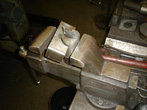

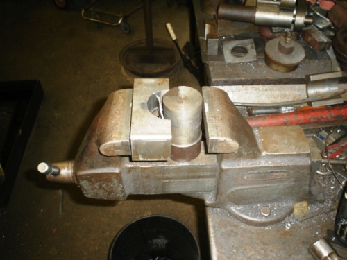

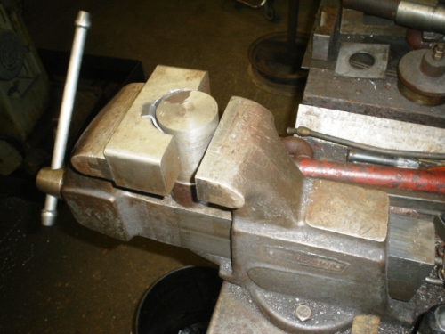

Since we're in a low production mode right now we wanted a method to produce the clip that makes it all work without getting into a big investment.
One of the old guys here came up with this.

#28
The cut and drilled blank is put into the vise. The vise is closed forming the curve.
The blank rides on a lip that insures every piece comes out the same height from base to inside curve of retaining lip.

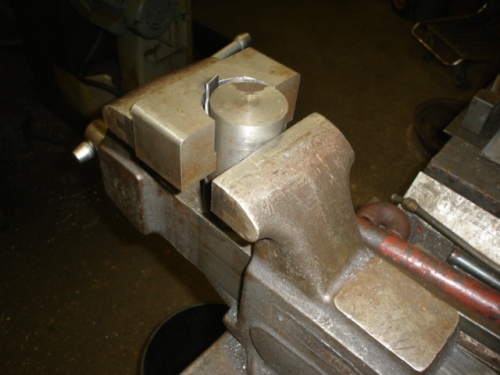

#29
The retaining lip is formed via ball peen hammer.

#30
Don't laugh.
It works.
