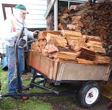

I built one for my tractor in the early 80' that doubled as a flatbed dump trailer. I figured it would work well for an atv. It works well and is very easy to dump and convert. the bed just sits on dowels on the backside of the arch frame. You can use chains, the tongs, or cable. I figured if I were to do much I would preferr the chains and have a few hooks so sthe winch wouldn't take a beating when pulling.

That's a NICE design.. I wish I'd seen that before I built mine. I may have to do some head scratching and redesign work this winter.

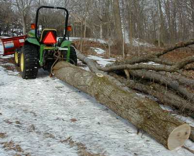

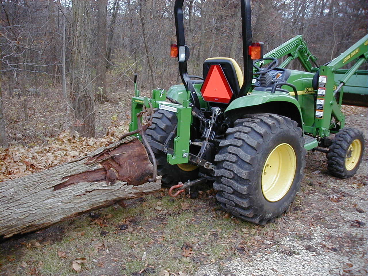

Another twist, and cheap for me, is to use the quick hitch (iMatch for me) and have a couple grab hooks welded for snubbing up choker chains. Easy to toss the log tongs on the top hook, just keeping due caution to the need for counter weight on the front end.
