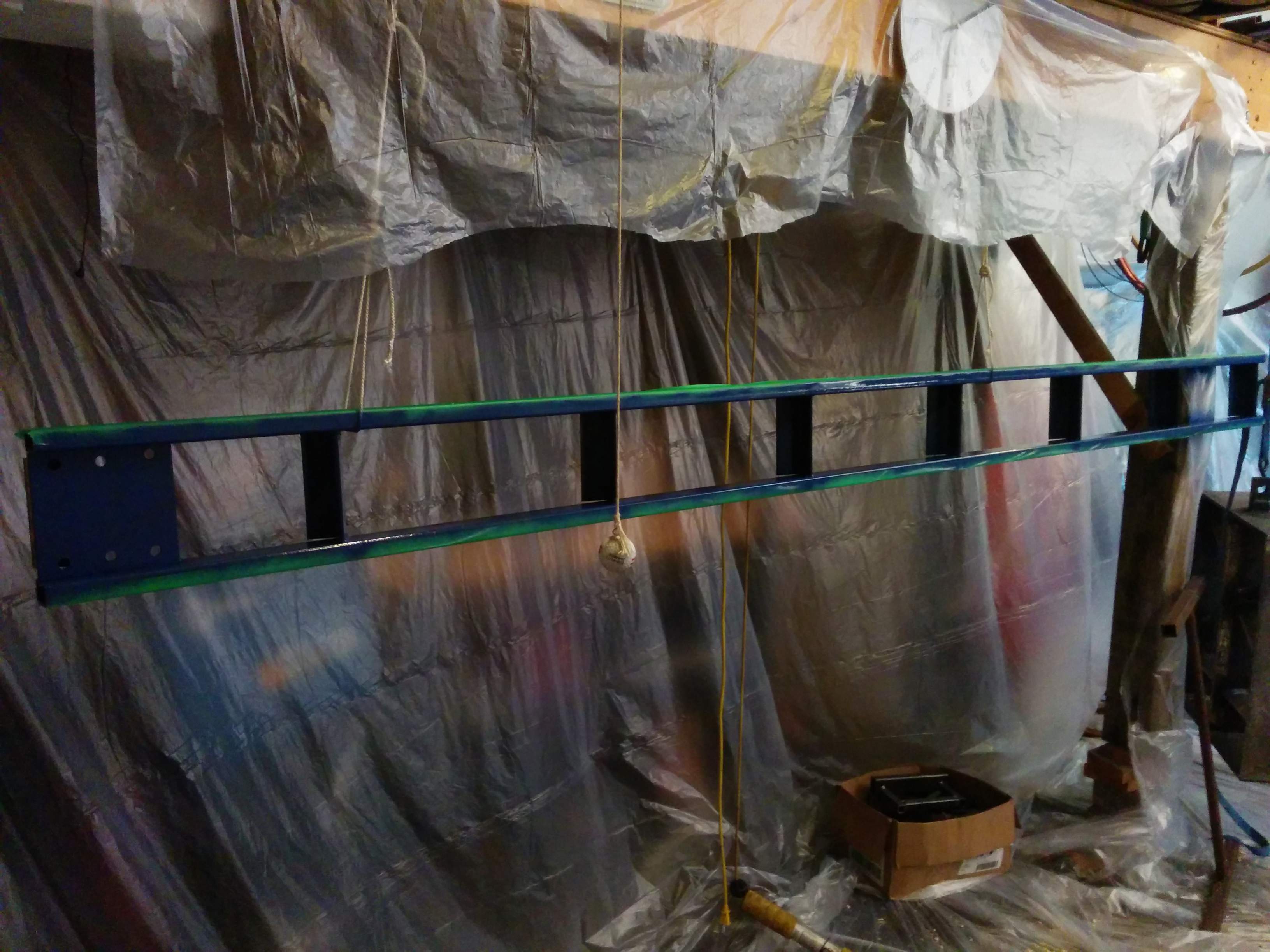

I also finished the pusher plate. A few parts are still only tacked on, but the majority is fully welded.
I replaced the attachment for the cylinder since the original one was bent and distorted with the plate was pushed upward and capped the vertical piece to keep the rain out.
I added some plate to the sides and to the front and back to hold the nylon strips that it will sit on. Four screws will secure it on either side, but really, it wont be able to move anyway. This stuff is amazingly durable, I ripped a cutting edge into a 6' by 4" strip and bolted it under my 1500# blower 3 years ago. My driveway is paved and hasn't worn it down a noticeable amount.

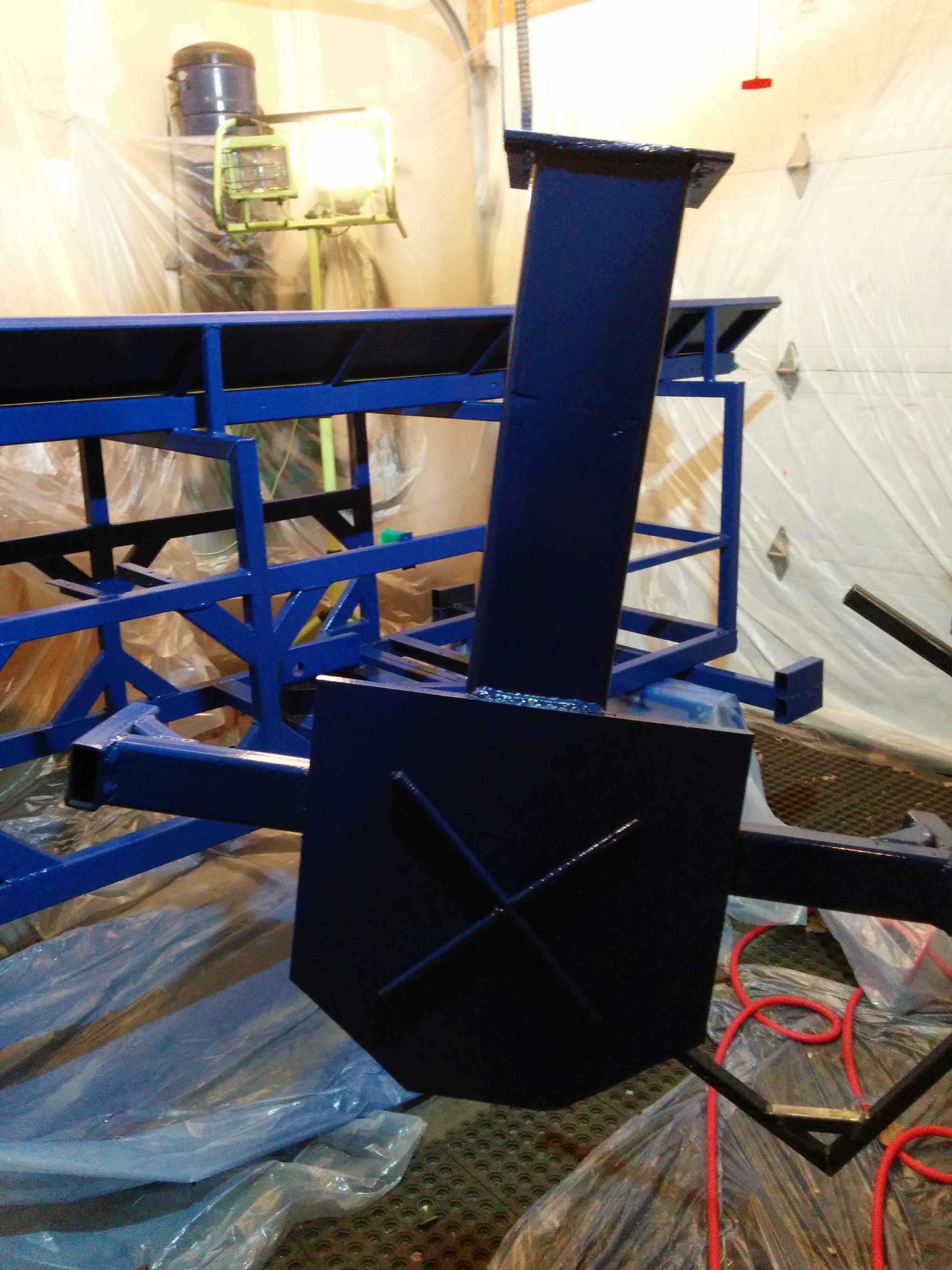

Started off installing the rollers and building the chain system for them. There are now 4 out of 5 rollers installed.
Next, I built a bracket to hold the hydraulic motor. I also made a little plate to allow for adjustment when installing the motor.
Finally, I figured out how to run the chain. Once I add a little extension in front of the trough, I'll be able to install the last roller. I'll then finish the chain system with two idler sprockets to get the chain low enough on the return and add two tensioning idler sprockets to keep the whole mess tight.

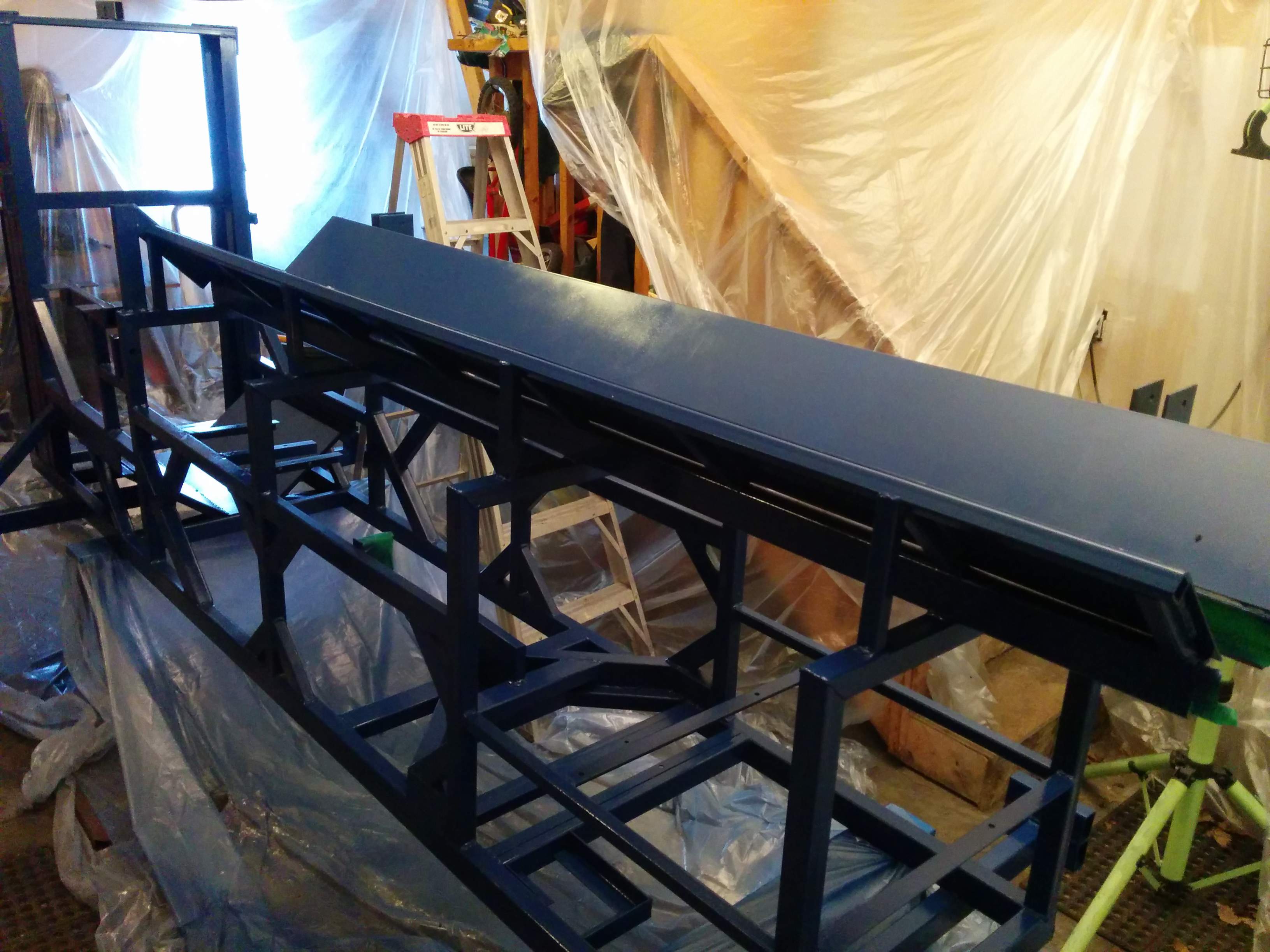

...I then got sick of farting around with the chain system since I was doing way too much thinking (who thinks on the weekend!). I decided it was time to get the pusher plate and cylinder back together. I also wanted to do more bracing.
Pulled out the plastic (nylon, teflon... not really sure)
All contact surfaces got covered.
The whole thing together. Unfortunately, I let my guard down and didn't keep an eye on the angle of the cylinder. It's off by 1" so the cylinder is pushing on an angle. I'll have to take the pusher plate off again, cut off the attachment point and lower it by an inch. PITA, but it needs to be straight.
Finally, I added some more bracing to the attachment point of the cylinder. Yes, this is an absurd way of building this, I should have just started with an I beam, but I didn't, so I'm adding more bracing. The new cross member is 1.5" X 2.5" - 3/16 and it's braced using 2" X 4". I really hope all of this bracing adds up to being strong enough, it is now my biggest concern.

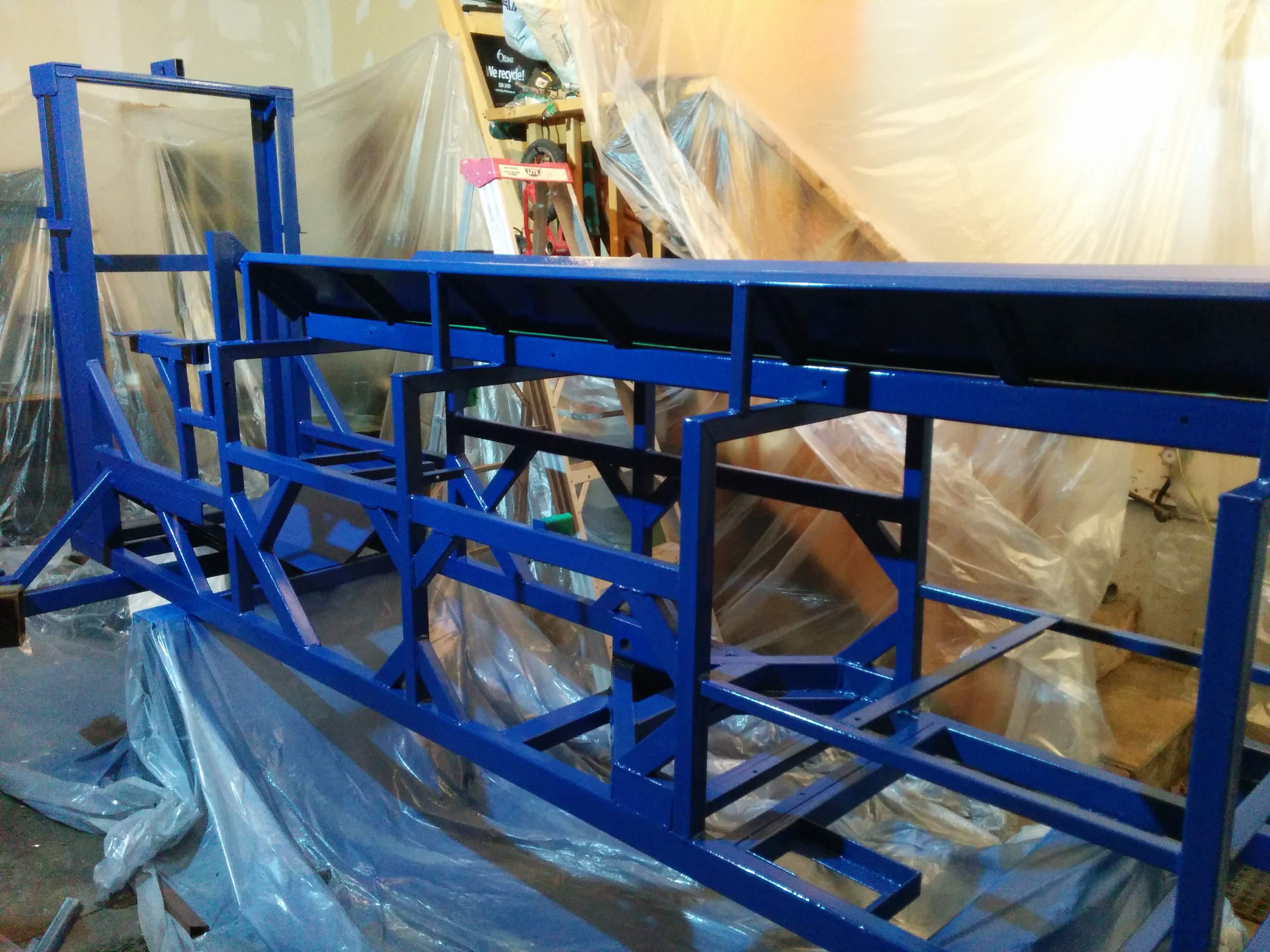

... Still to do:
1) I'm going to add some bracing to the lower trough to make sure my new guides aren't pushed apart.
2) The hub for the hydraulic motor doesn't fit, the shaft doesn't seem to be 1 1/4 as I was told and the key is larger than the 1/4" keyway on the hub. I'll have to figure that out.
3) Also, they sold me the wrong fittings to connect the new hydraulic motor, I even told him I didn't think they were right, but what do I know... I finally got so PO'd at Princess Auto, I went to a specialized hydraulic shop (Parker dealer) and they still sold me the wrong fittings. I also almost fell over when I stopped by on Friday and had them make me two 2' hoses for the motor. They charged me $140 for the hoses and 4 fittings! The list price was over $300! As much as I want to support the local shop, that's just not OK.
4) The chain system needs to be finished
5) The last roller needs to be added
6) The log deck needs to be re-attached
7) The extension for the trough needs to be added and I need to build a support for it.
8) Attachment point for the cylinder needs to be lowered.
9) Need to build a out feed trough so the wood is pushed up and away from the machine.
10) Paint
