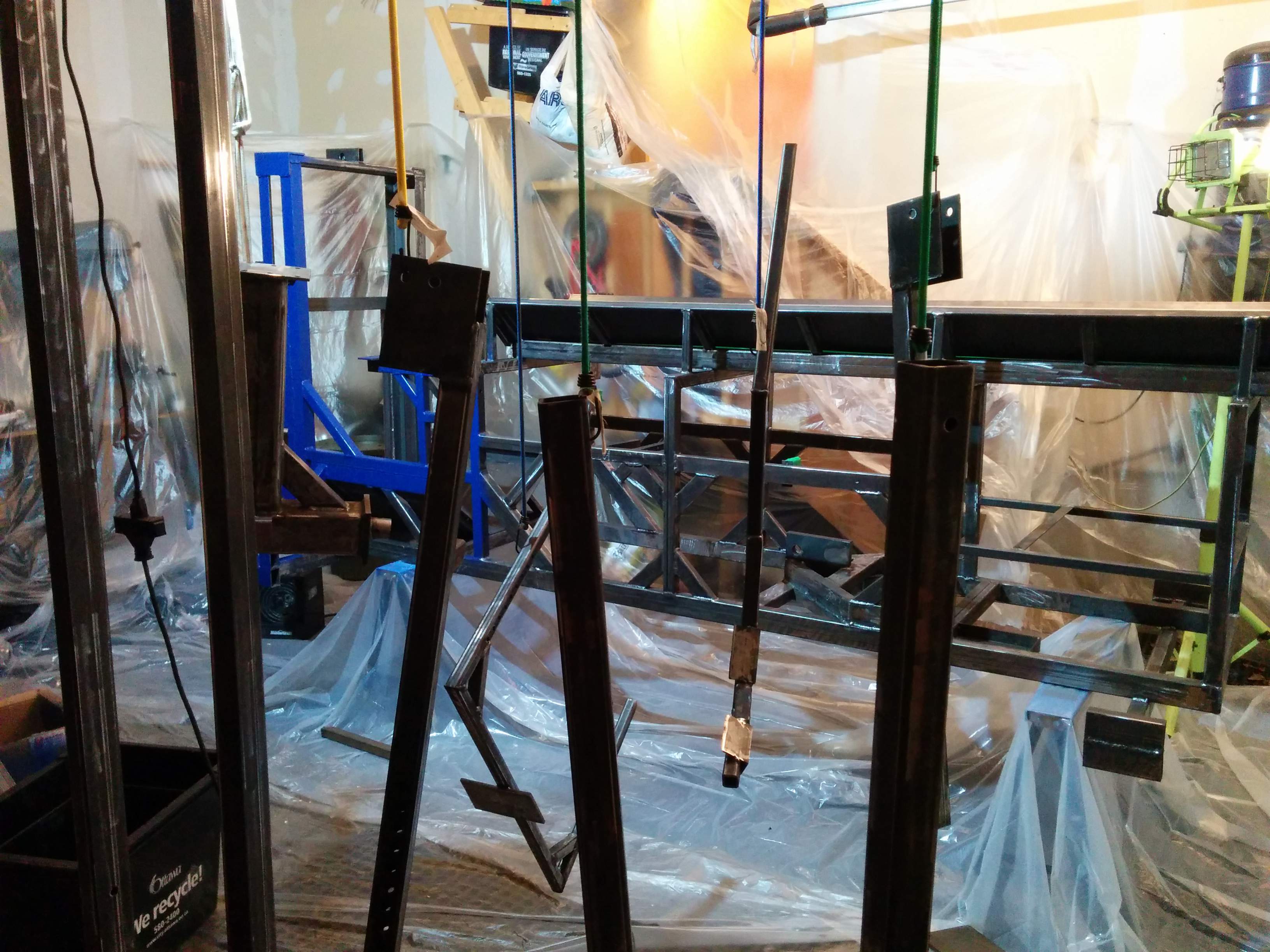

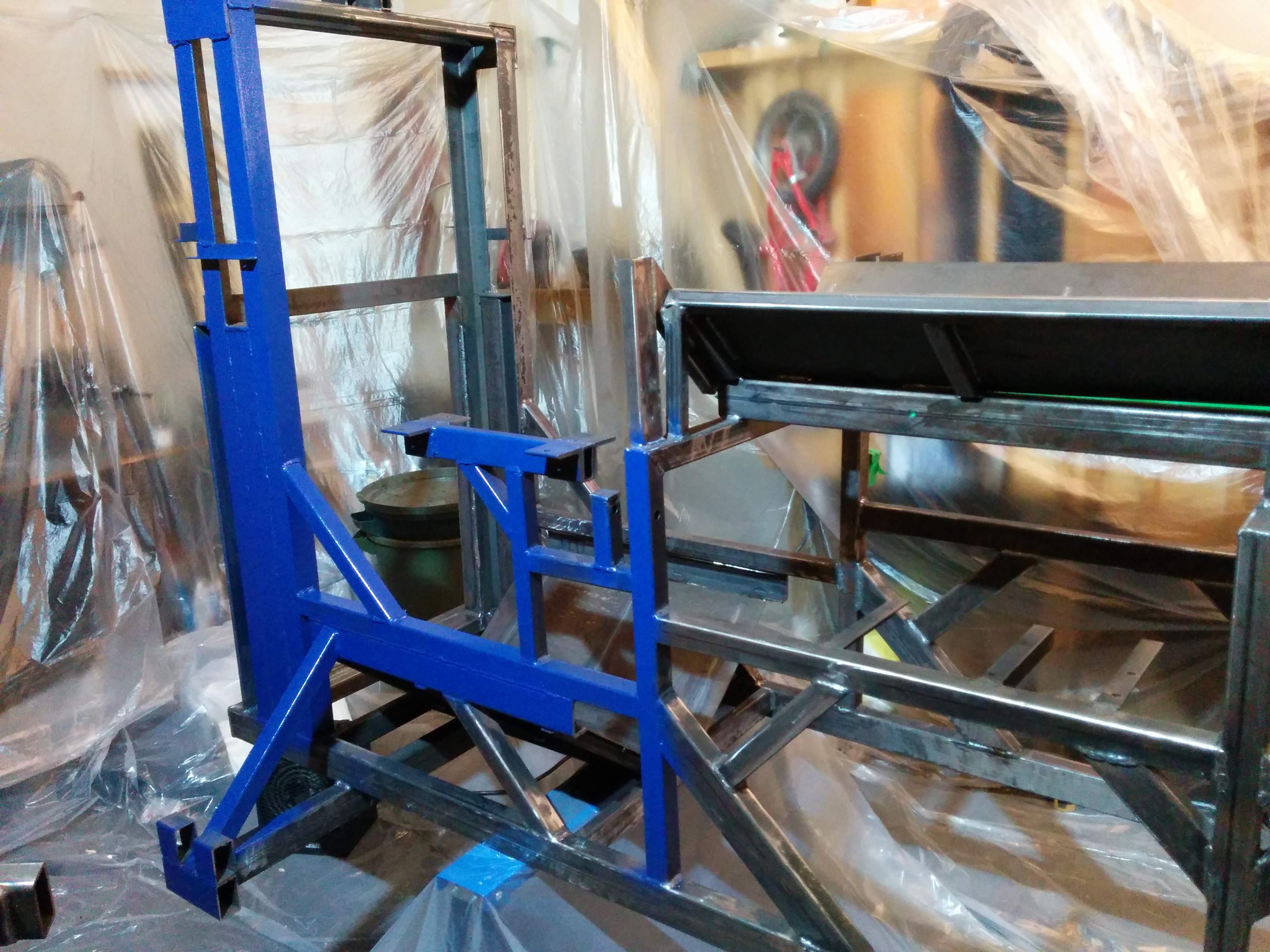

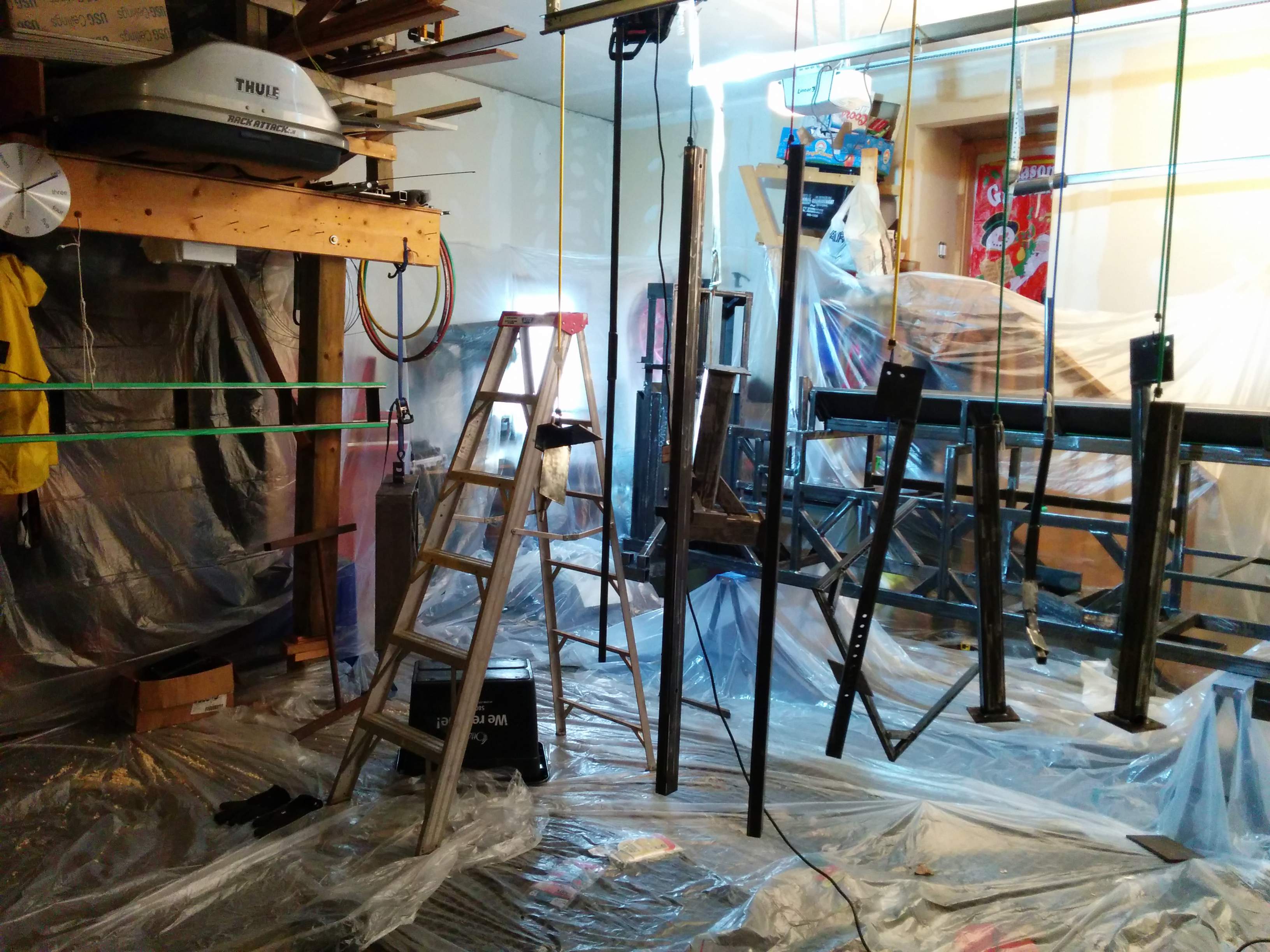

Got a little more done last night along with some good head scratching. Think I have it all figured out now.
Lower rails in place.
Upper rails extended. Just need to add a little sheet metal to make it level with the trough.
Welded a 2" X 4" - 1/4" piece to the bottom of the pusher plate. The two 6" X 10" - 1/2" scraps I cut out of the bottom of the splitter head will be trimmed to 5" tall and welded vertically to it. A T will be welded to the bottom to bolt onto a slide under the lower rails. I cut 3 holes randomly into one of the pieces to plug weld it to the other. 3/4" nylon one either side brings it to 2 1/2" thick to fit into the 2 5/8" space between the rails.

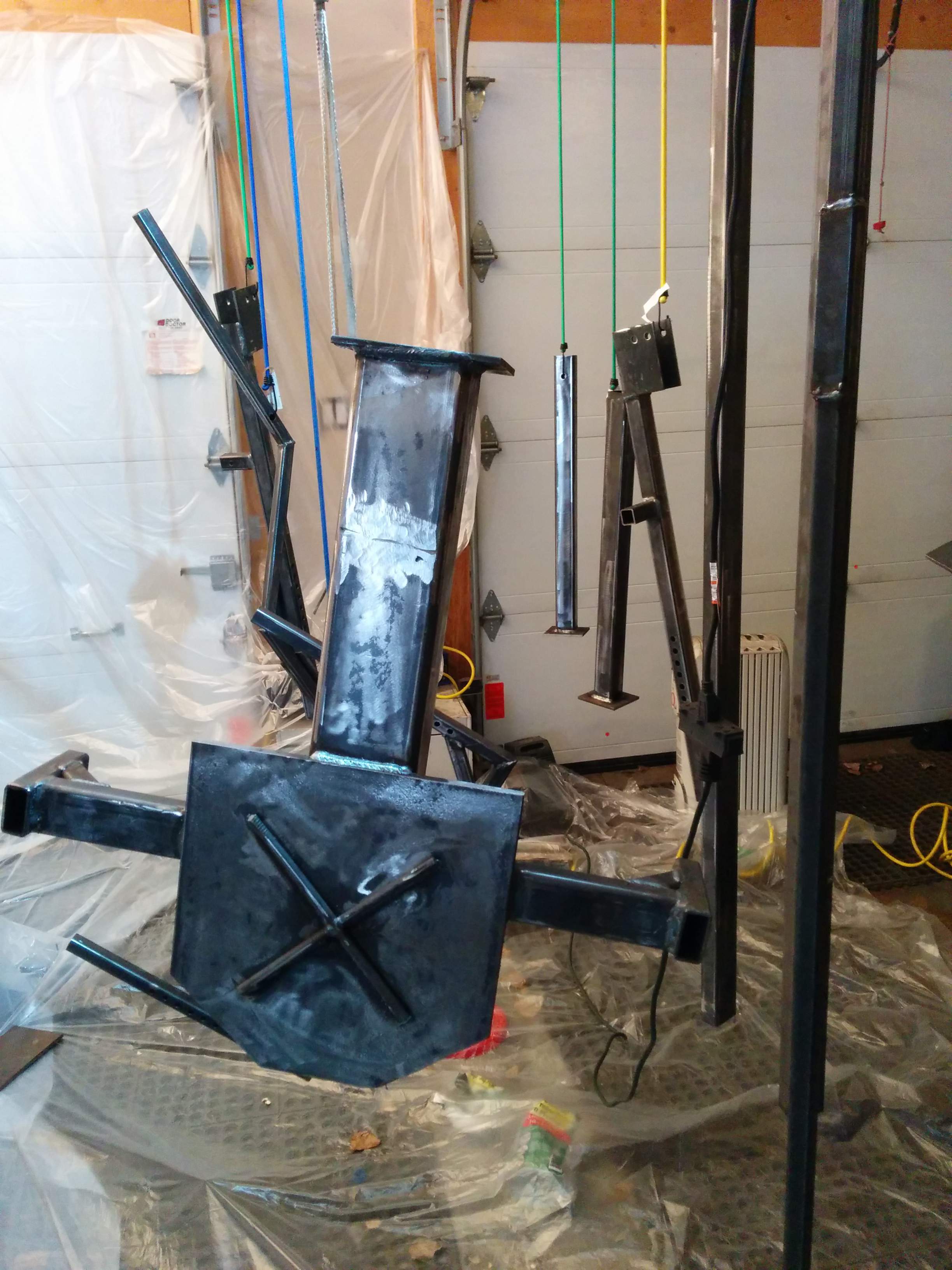

So, you'll all probably think I'm slacking off these days, but this pusher plate re-work is taking forever! By the time I looked up last night it was 12:30 am and it felt like I barely got anything done. The sad part is, I still see needing two nights to finish up the pusher plate before I can start having a little more fun building rollers and figuring out how to install the hydraulic motor.
Pictures all show the pusher plate upside down.
I trimmed the vertical pieces down to 4 15/16" (yes, I actually managed to hit that exactly on both 1/2" thick plates!).
I ripped a 8" X 12" - 1/2 plate down to a piece 2 1/2" X 10 1/2" and another at 5 3/8" X 10 1/2". I then tacked them together and drilled bolt holes through them. The 2 1/2" piece will be welded to the bottom of the pusher plate as a T, then there'll be a 3/4" thick piece of nylon (5 3/8" X 10 1/2") sandwiched between it and the larger piece.
There will be 14 - 3/8" grade 8 bolts holding the plates (and nylon) together. The bolt heads should jam on the vertical piece but if not, I'll have to tack them in place since I won't be able to get a wrench on them.

Picked up the motor on the way home from work yesterday. We when through so many options, I can't even remember exactly what the specs of this one are, but it's a larger displacement and will take a higher pressure and greater flow. It was a more expensive motor because of that, but allowed me to eliminate having to add a flow regulator and and pressure regulator. In the end, it cost about the same but it's a much stronger, slower turning motor.
So, what takes longer than drilling?... Grinding! Oh man, that sucked last night. I cleaned up the two 1/2" remenants from the splitter head frame, ground a groove in the 4 edges for welding, got some more holes drilled through them and got the whole mess welded together.
My final act of the night was to butcher the extension on the pusher plate. I don't have enough light in the garage and didn't manage to follow the lines I drew perfectly. Oh well, I'll weld a cap on it and no one will be the wiser. Oh wait, I just told everybody...
