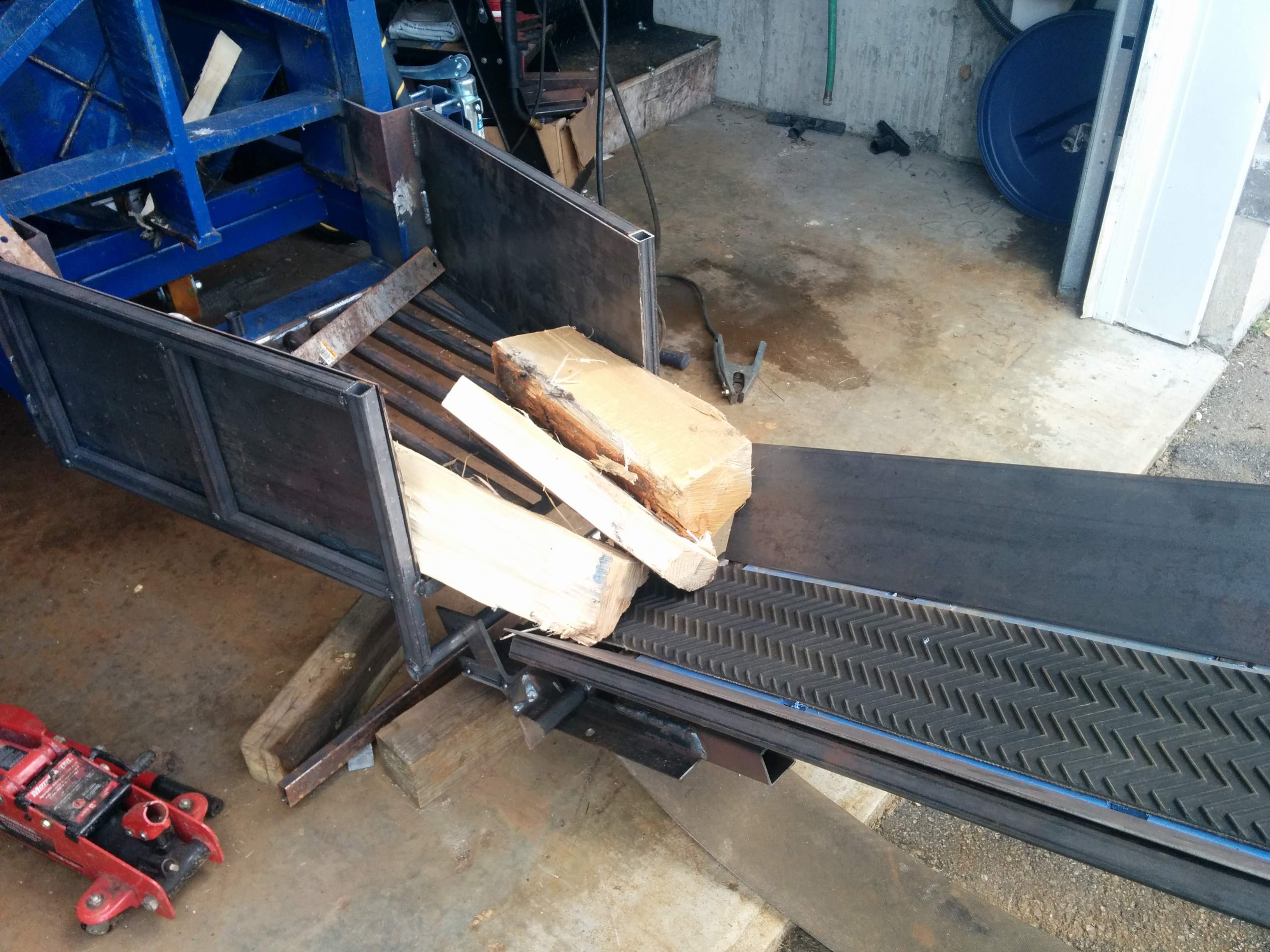

One thing that I see that is concerning is the outfeed section. I'm wondering if splits will jam into the sides that taper in. You may already know that it's ok since you've already run yours.
We decided to narrow things up by funneling things vertically. Then we will be adding the wings to the conveyer as well. This is all in theory however, we still have not made any further progress...
Tried to add image from my phone and the app keeps crashing.... Here.
Oh man I hope it works, I'm done having to solve issues. I have a 24" run off so I think that will give the wood some space to jockey for position. It's 16" at the narrow end and the biggest rounds I'll cut are 18", MAYBE 20". Either of those are still too large after they go through the 6 way wedge and need to be re-split anyway. That's a big reason I have the 24" chute at the end, so I can re-split before they hit the conveyor. I'm thinking the 6 way wedge needs small "wings", basically turning it into a 12 way wedge for larger pieces. I'm considering using 1/2" plate, half as wide as the cross pieces (which are narrower than the main vertical splitting wedge). Since I've pushed a couple pieces through sideways against the grain, I think it could handle it. I just need to make sure it won't jam.

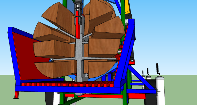

This was my first design, I think it was you that suggested my box wouldn't work, then I modeled the split and found out my wedge, splitter cradle, and outfeed wouldn't work. Determined this from modeling a half split block.
Here is the current design where I modeled a full split
It is all dependent on widths and depths of your outfeed in comparison to the diameters that your splitting.

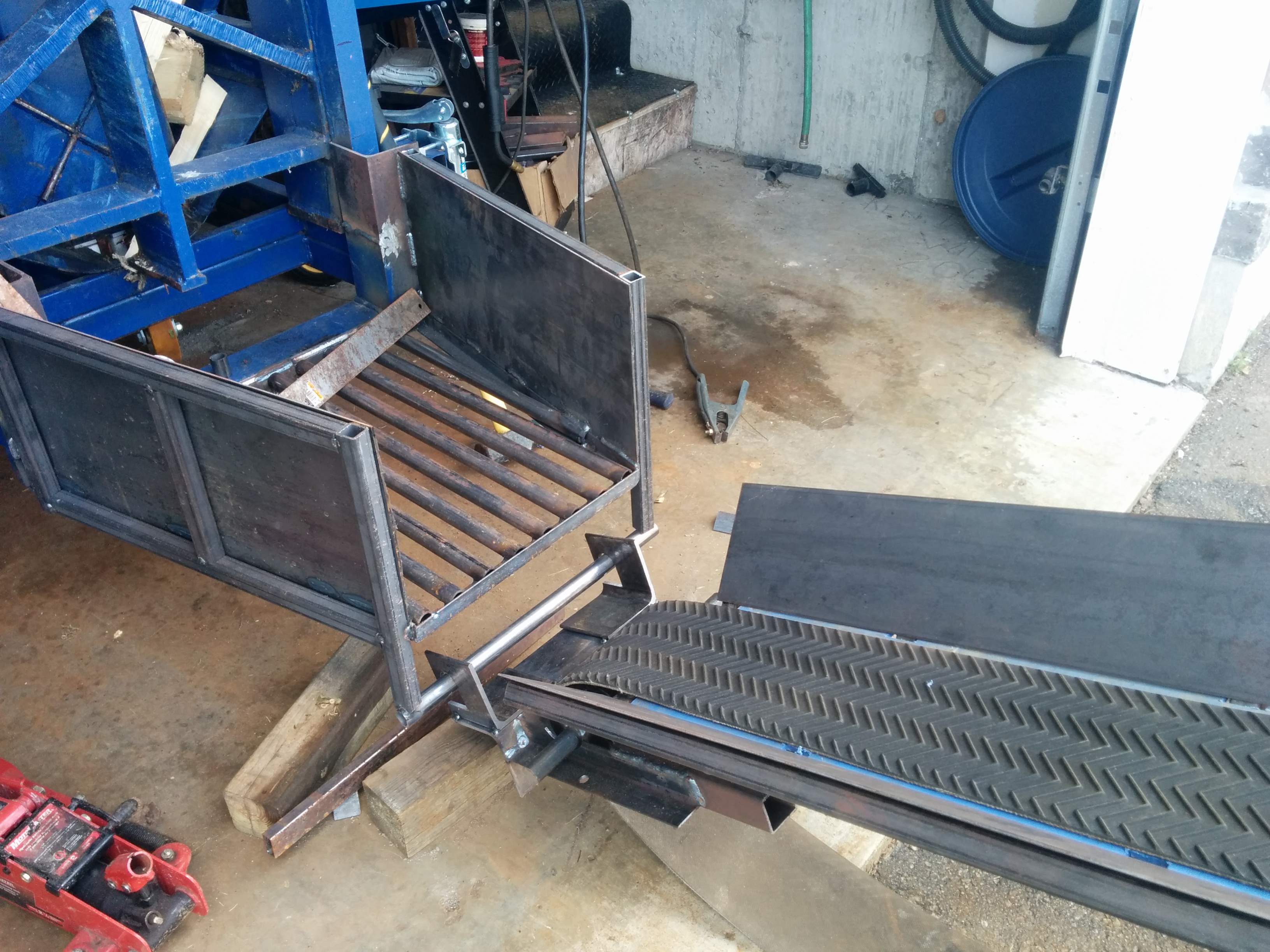

I wasn't going to update this thread again until the processor was done, the video was made and I could show all the updates I'm working on. Well, the wood processor gods don't seem to want this project to ever finish and I'm now under doctor orders not to work on it for one to two weeks (more on that in a minute), so I might as well give a quick update.

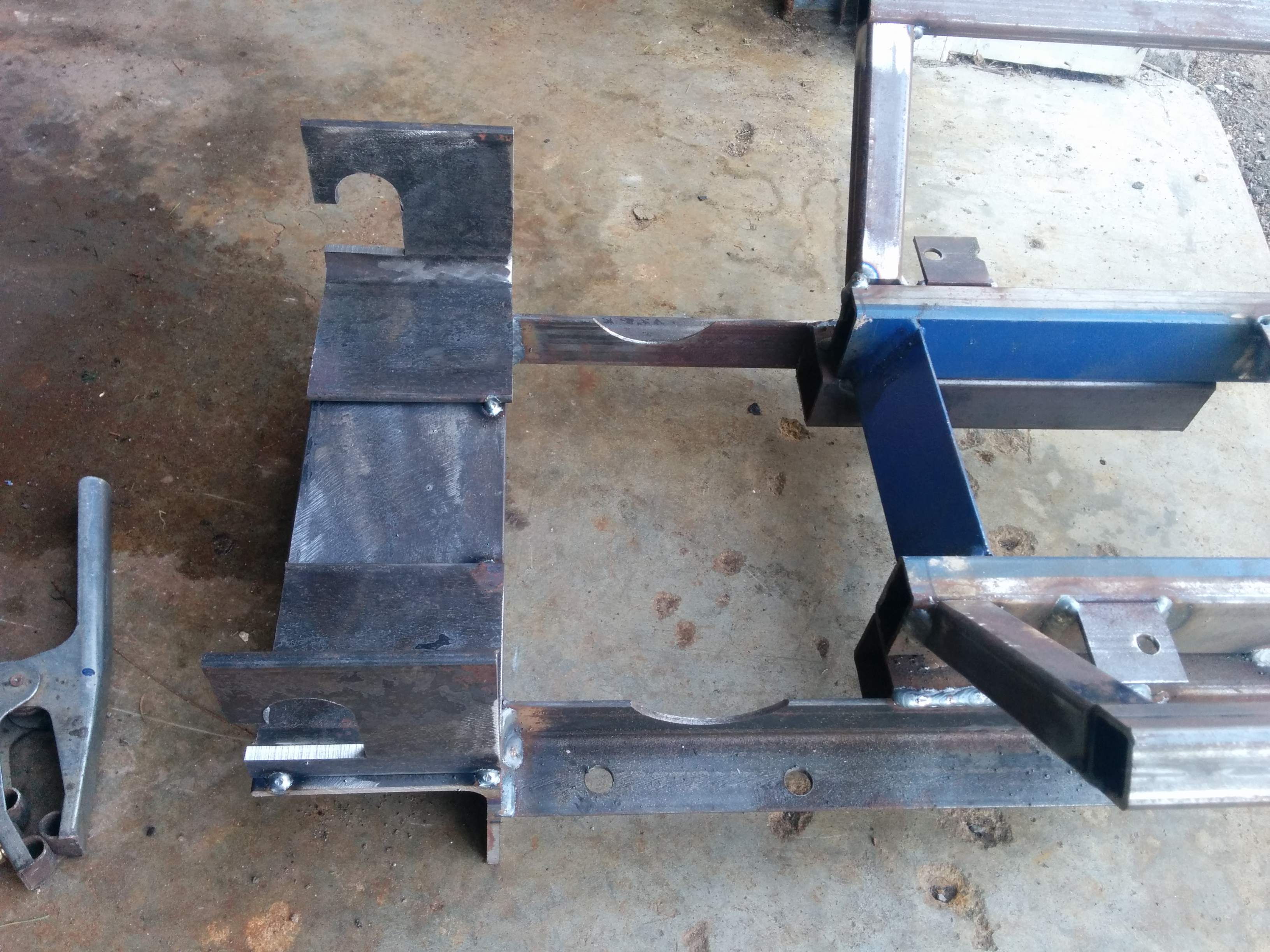

I started working on it again on Monday. I first figured out how to attach the conveyor to the processor. This is what I came up with.
Then I mocked it up.
That's were I stopped taking pictures, but I managed to paint the frame that holds the new tank, I drained the old tank and hooked up the new tank. I even added 5 gallons of fluid that came out of the old tank, and there are no leaks with it just sitting there. On the conveyor, I mounted the electric motor from my cement mixer with a bracket on the side. I finished welding the conveyor and painted it. I was just about to take the flap disc to clean up the tensioning system to allow it to move smoothly then install the springs when I had a little accident and the reason I'm not supposed to work on it for a little while.
