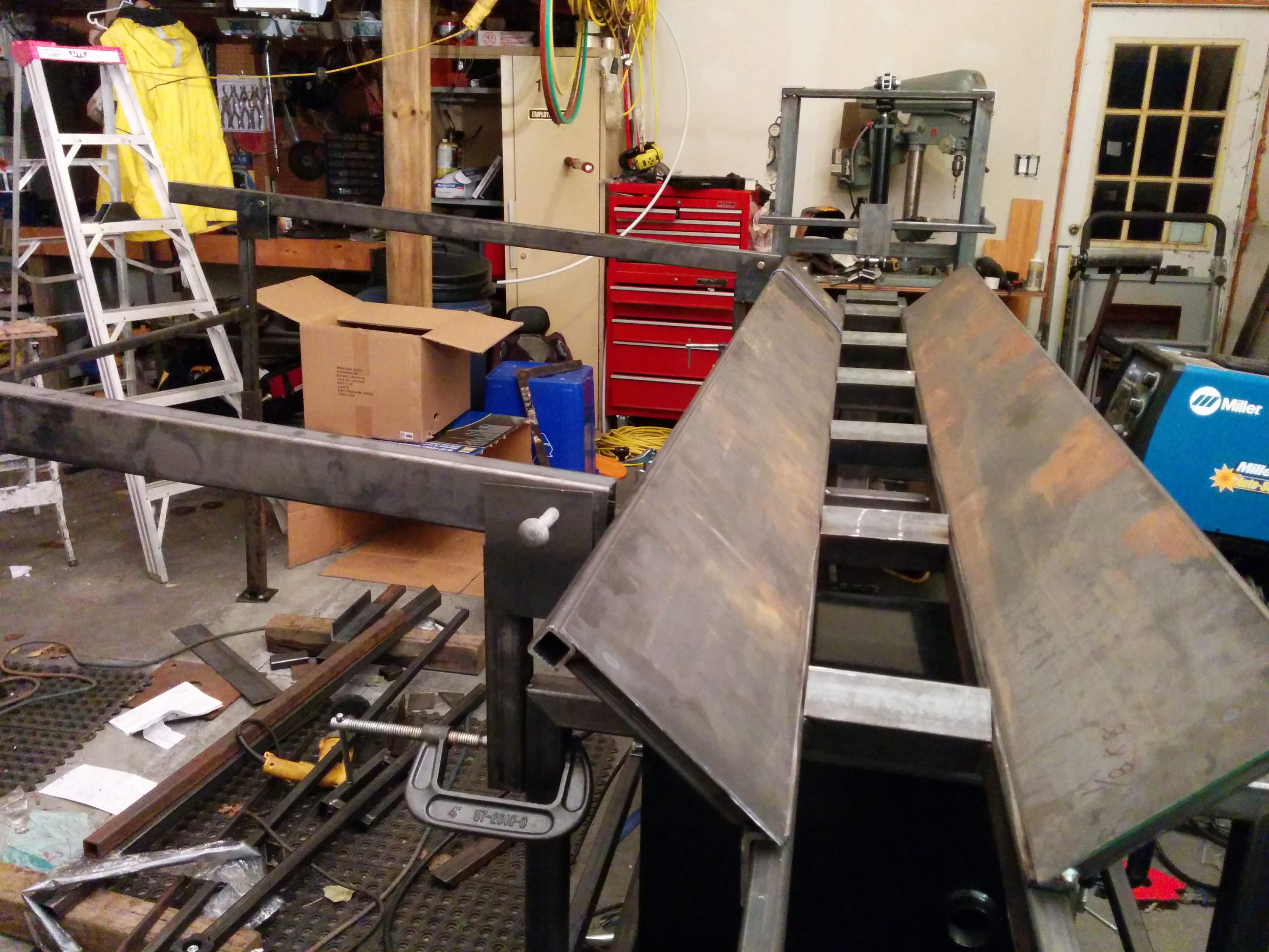

I can't tell for sure from the the photo, but it looks like the splitter blades might not be angled. You may have some problems with the wood wedging in the splitter blades if the blades are squared rather than angled. They should be angled so that the opening between two blades is narrower at the cutting edge and then get's wider at the exit point on the opposite side.
Thanks. Well, when I went to pick up the piece from the welding shop, the shop foreman said his machinist told him the same thing. I'm adding it to the list of wait and see!

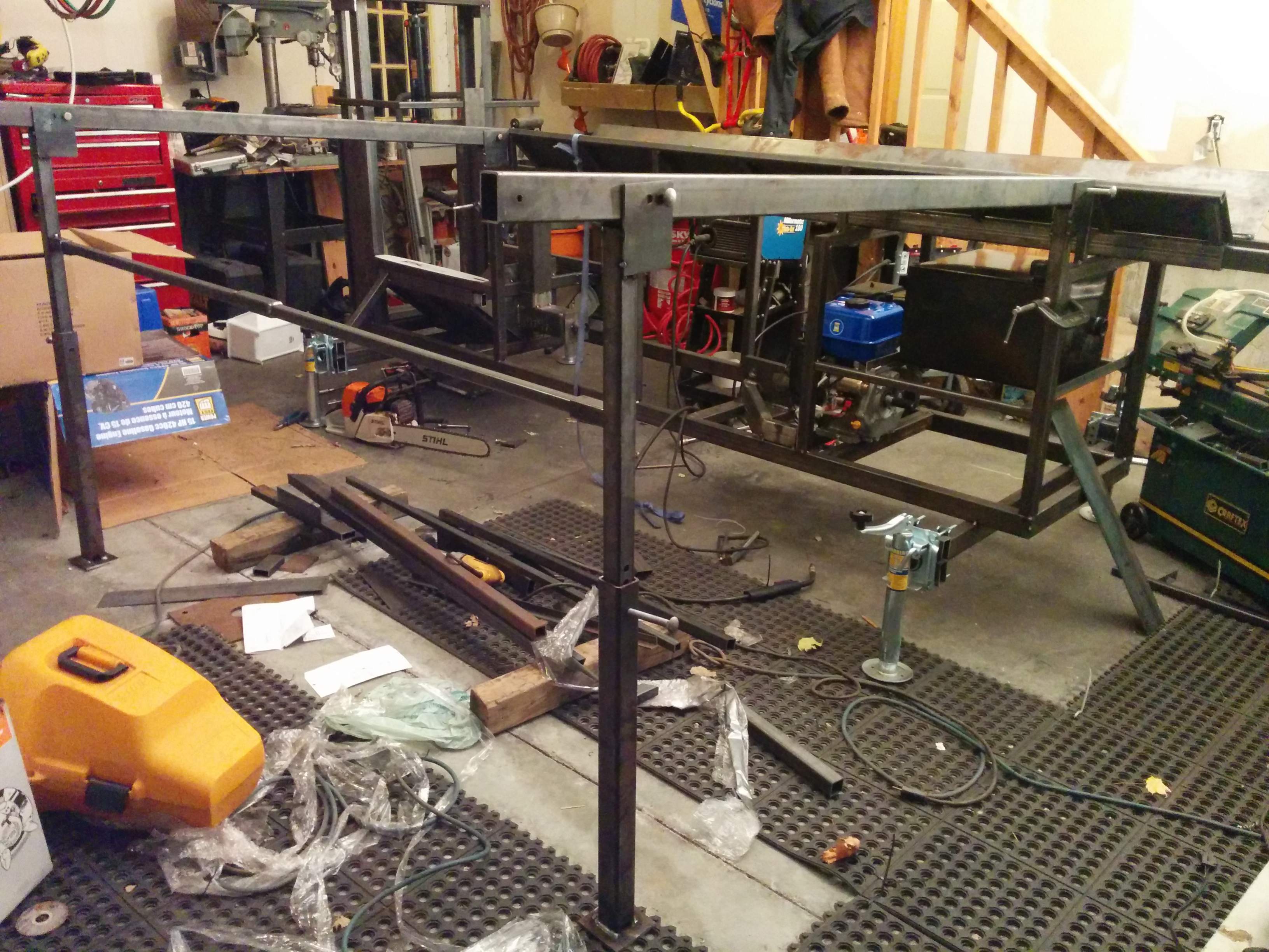

Well, I tried to pick up the processor and move it out of the garage. It's currently pretty stripped down with only the cutting head installed out of all the removable pieces. The tractor picked it up with no effort, but I couldn't figure out a way to position the chains to keep it stable and finally gave up before destroying something. I wanted to remove the splitting head and clean it up to make it fit a little better. I ended up removing it with jacks and saw horses and got it ground down and cleaned up. It fits much better now. I've also finished most of the welding on the main processor, now I need to finish all the removable pieces like the pusher plate assembly, log stands and the arm. That's tonight, tomorrow I'll clean it up and hopefully I'll put a little paint on it this weekend. If I can get it assembled and working sometime next week, I'll be happy.
Cleaned up and ready to paint. I'm not going to put much effort into cleaning the inside of the frame, I don't expect paint to last in there anyway.
