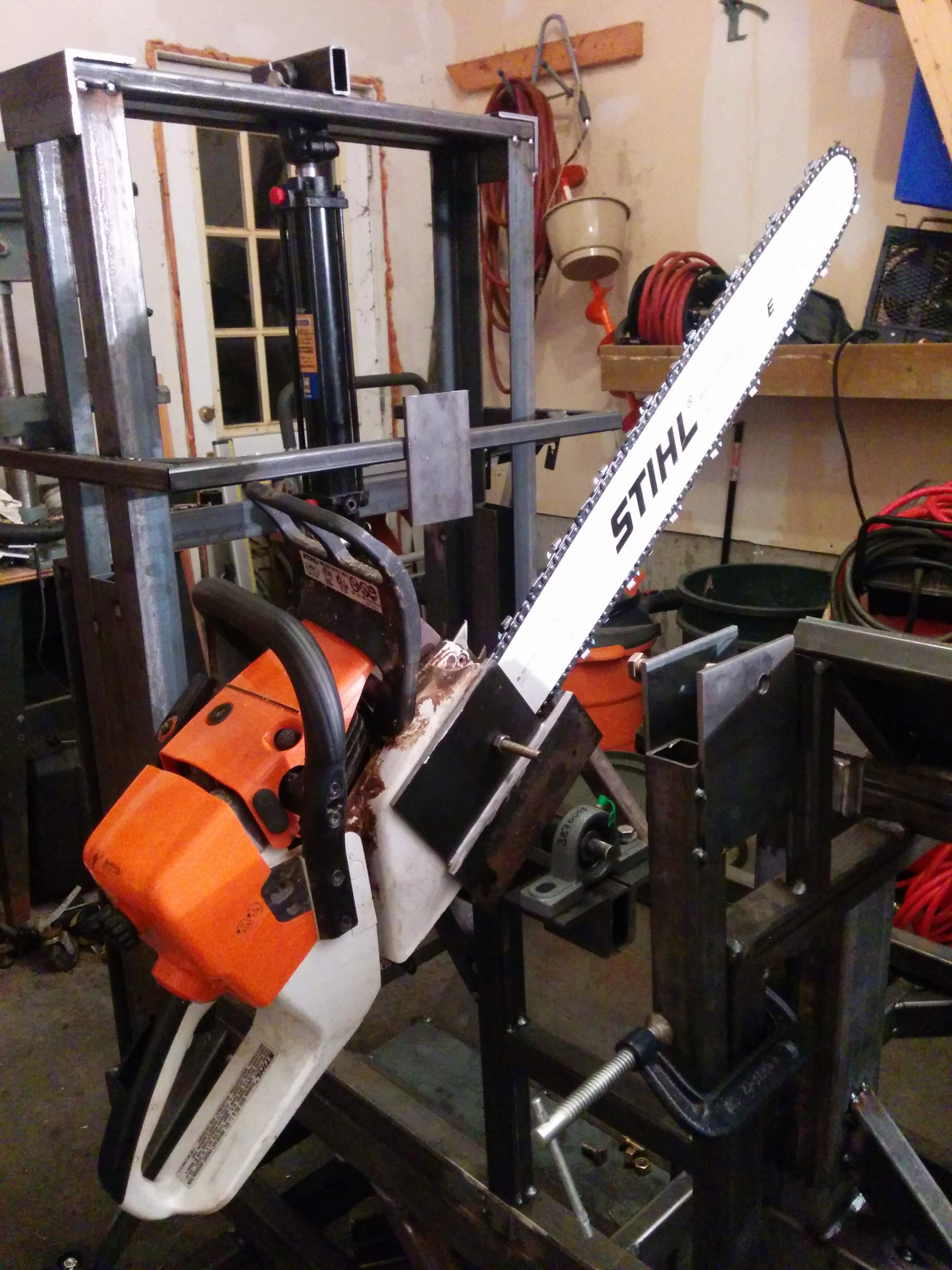

Have enjoyed your building of your machine, I'm building one as well , I'm using 3 ganged John Deere pumps off some donor 1010 loaders , My Dad told me build it for all the scrape wood that won't make it into a sellable log . Like the wind blown stuff and the hollow heartless stuff . All the best to you , I'm looking for a hydraulic motor to run the saw . I have the typical 36 inch 404 harvester bar and a lumber mate 52 inch that was used in a mill to square up the ends of tie timbers

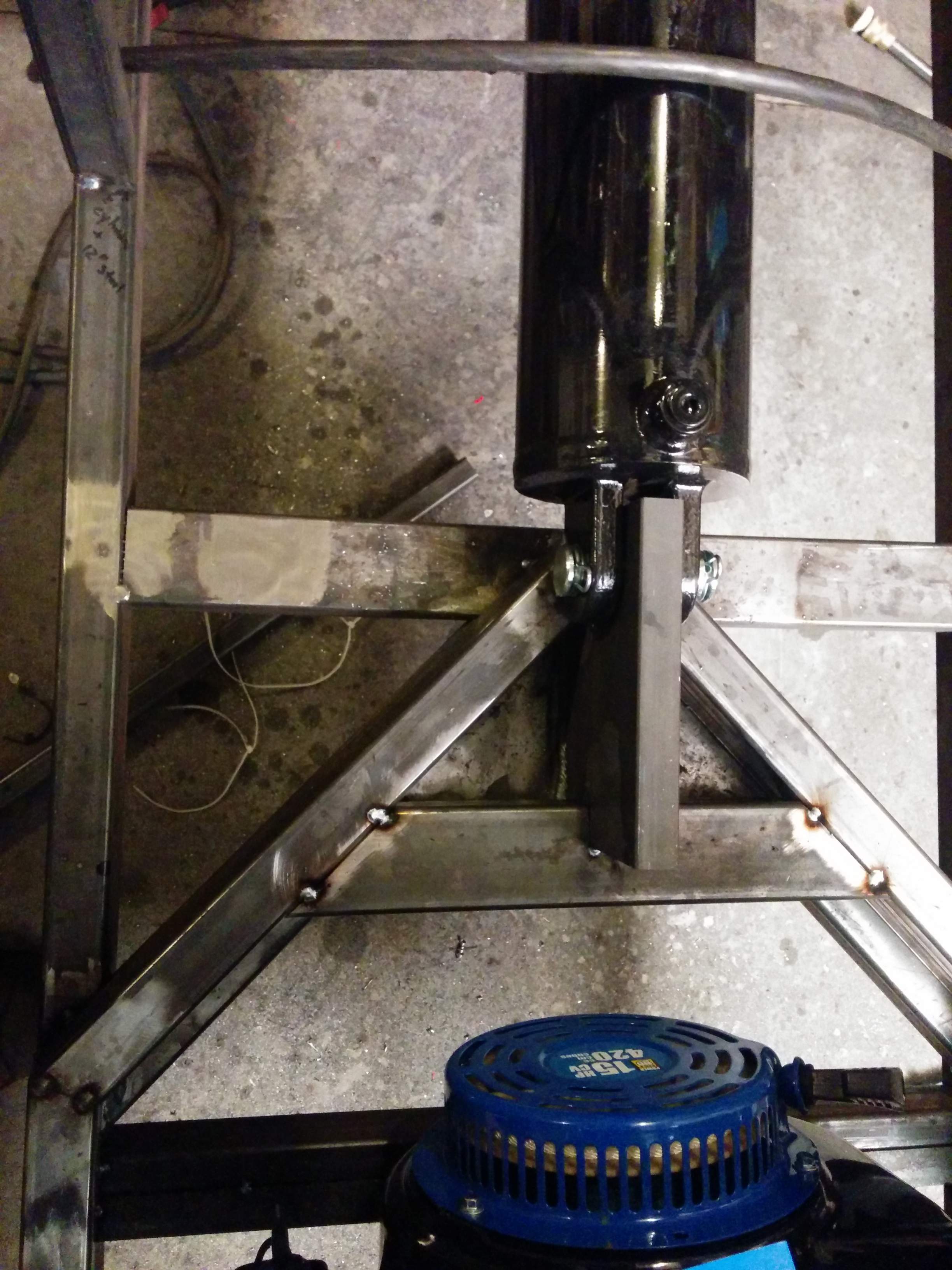

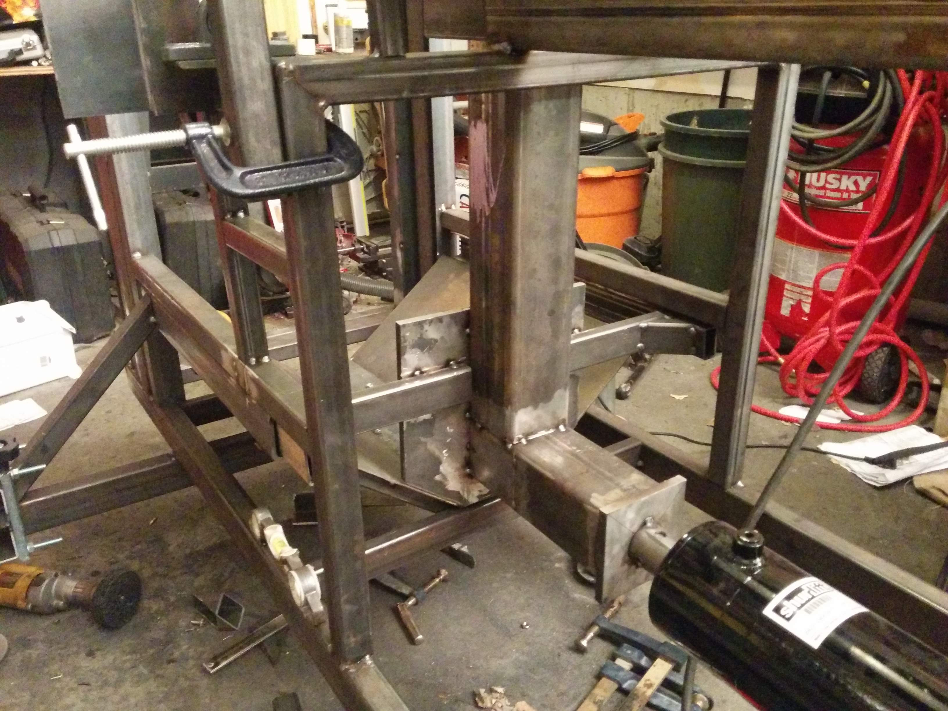

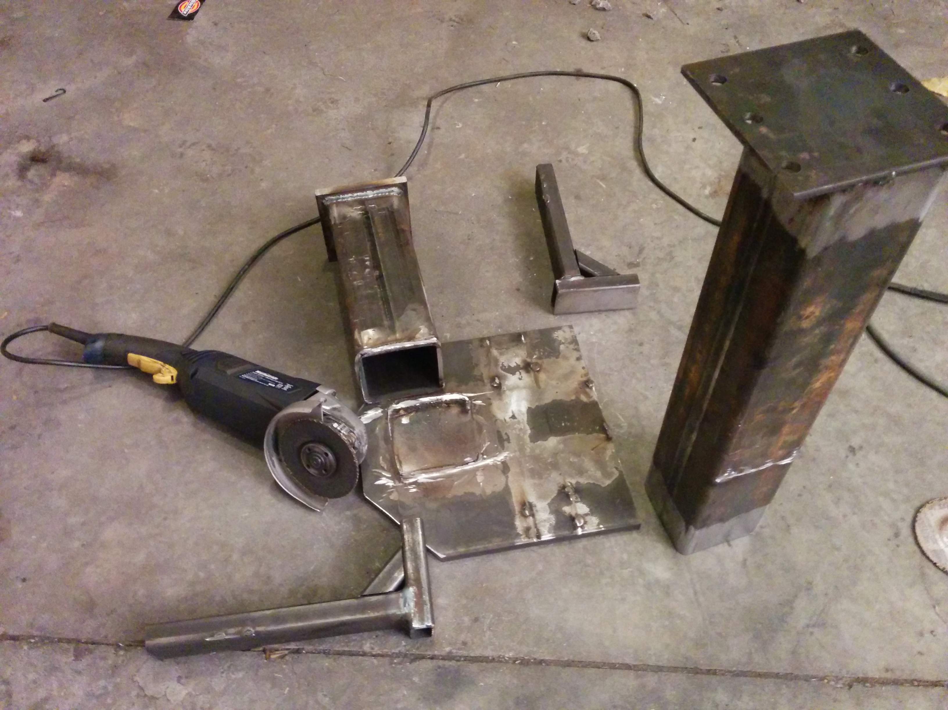

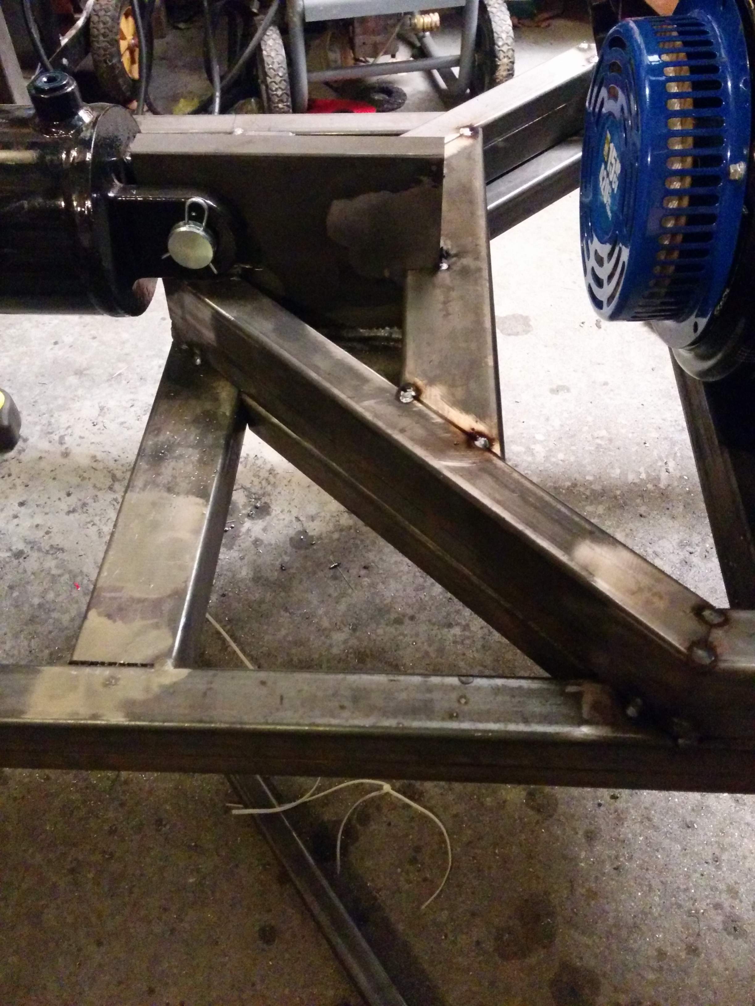

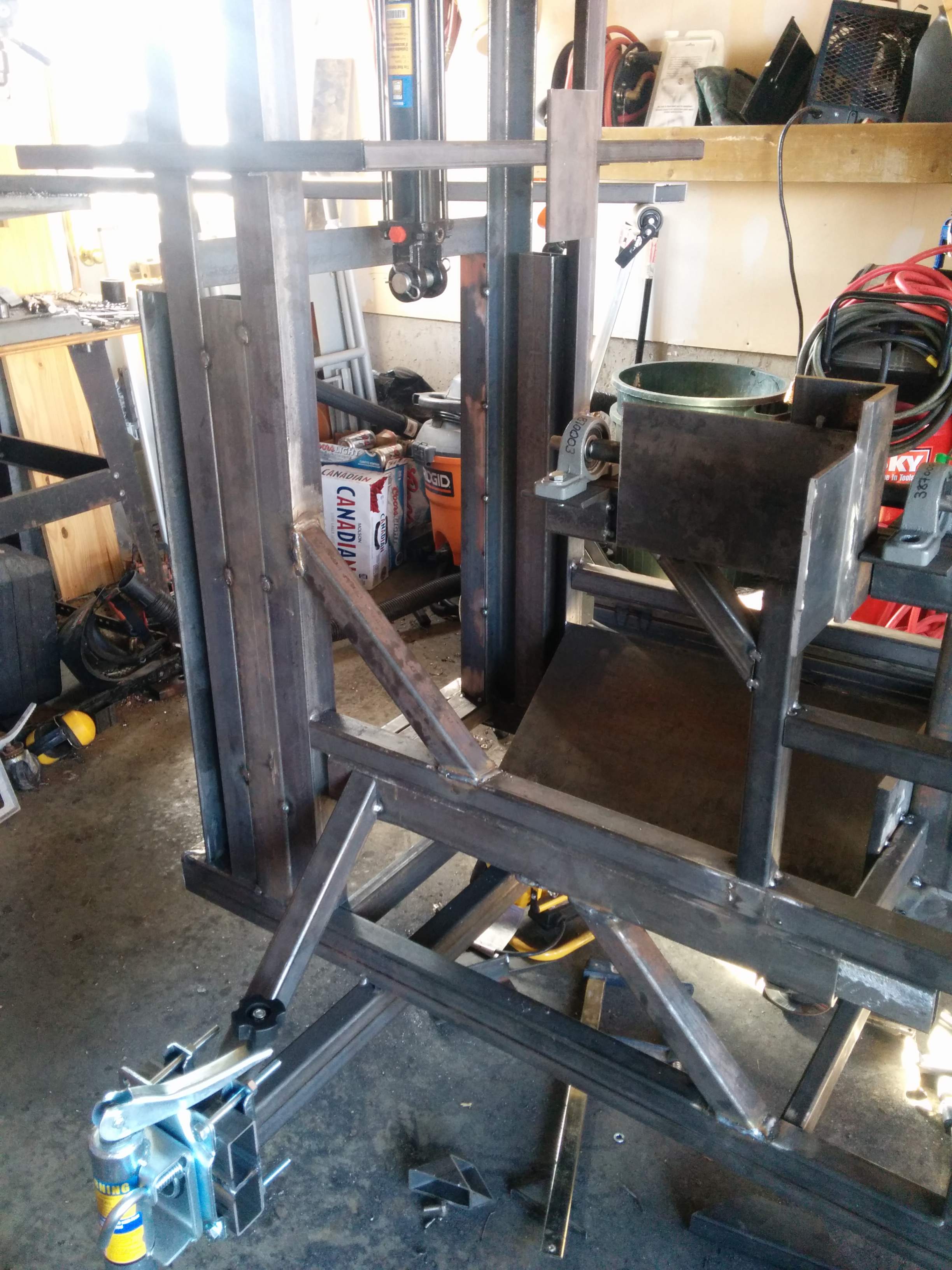

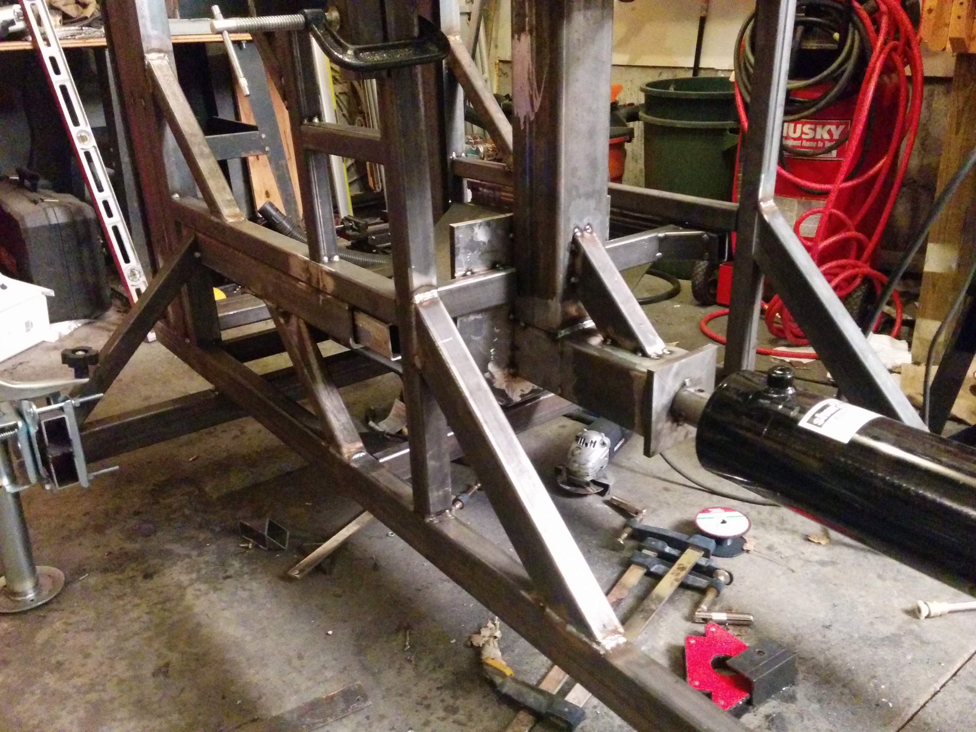

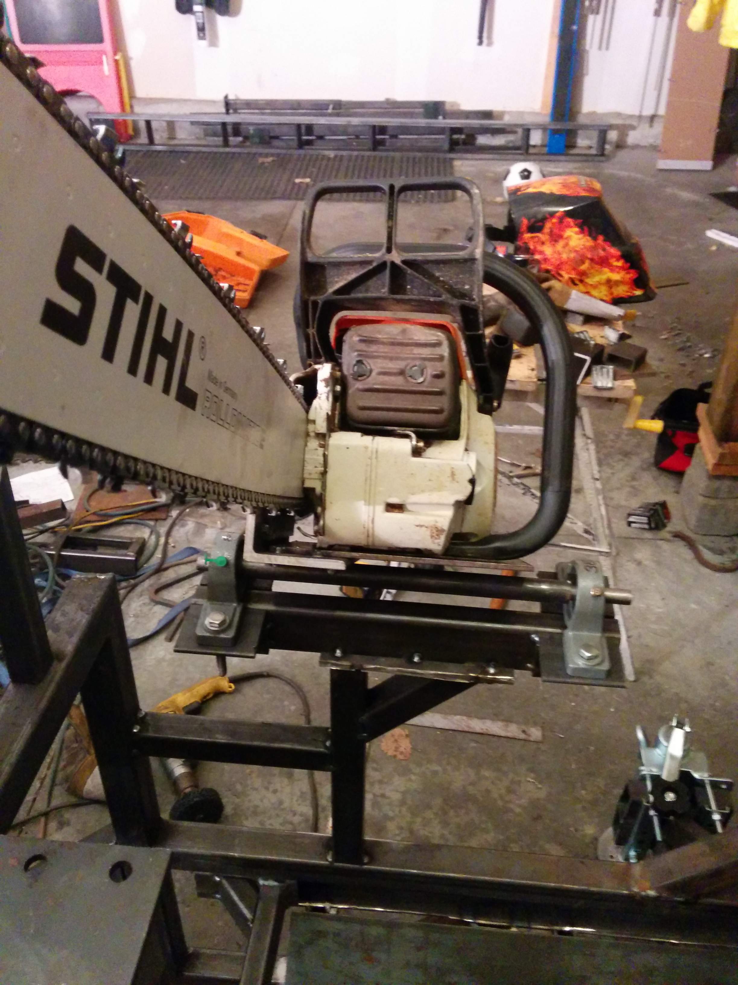

OK, for all you who couldn't sleep over the anticipation of seeing a gleaming beautifully painted firewood processor this morning, sorry, blame CDN Farm Boy:laughing: He stopped by on Saturday night to check it out and made a few suggestions. He pointed out that the weakest part was the frame from where all my bracing ended and where the ram connected. If something other than the wood is going to give, it could be that area. Sooooooo..., being completely out steel, not to mention the apatite for spending more money on my insanity, I remembered the old dump cart conversion I started years ago, never finished and leaned up against the back of my shed. I started it right before I bought my first tractor and, well, lost all motivation to finish it after that.
Looking a little rough.
Butchered the cart, cut it to length and cleaned it up. Lots of bracing now.

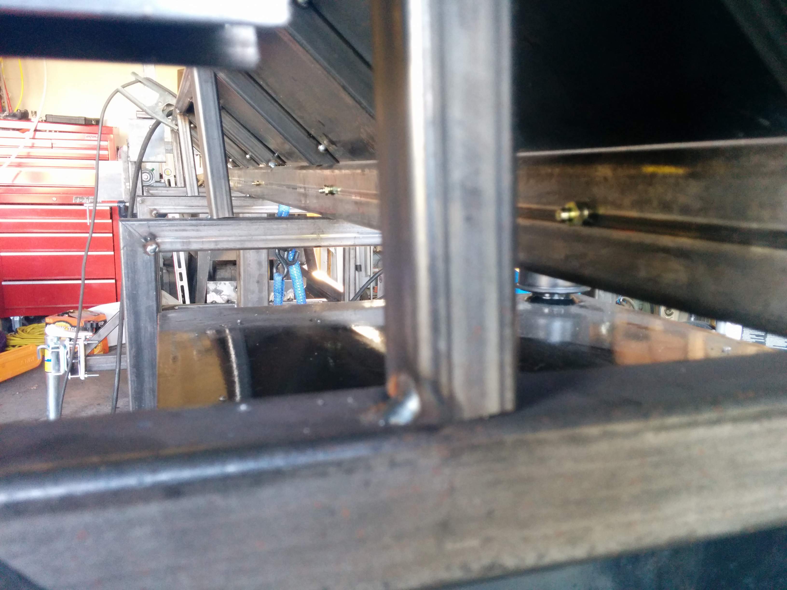

My next post may be cursing CDN Farm Boy for making me add more barcing since the engine now has to be installed from under the processor before the ram is installed. The engine is 18" tall and I now have 19" of clearance. That might not seem like very much when I'm trying to lift the 100# engine at arms length under the processor! I think he should do it since it was his idea :laughing:
So, the entire machine is now fully welded, including the new bracing. Tonight I need to add a rack for the battery, cap two steel tubes that will drink in water and are welded closed at the bottom and then continue cleaning it up. Hopefully paint starts on Tuesday night but probably Wednesday.
I know somebody's going to mention it, so yes, I'm considering throwing the wheels from the cart under one end of the machine. I may see what that looks like but I don't want this thing to start looking like it was built from whatever was lying around, even though that's partly true now.

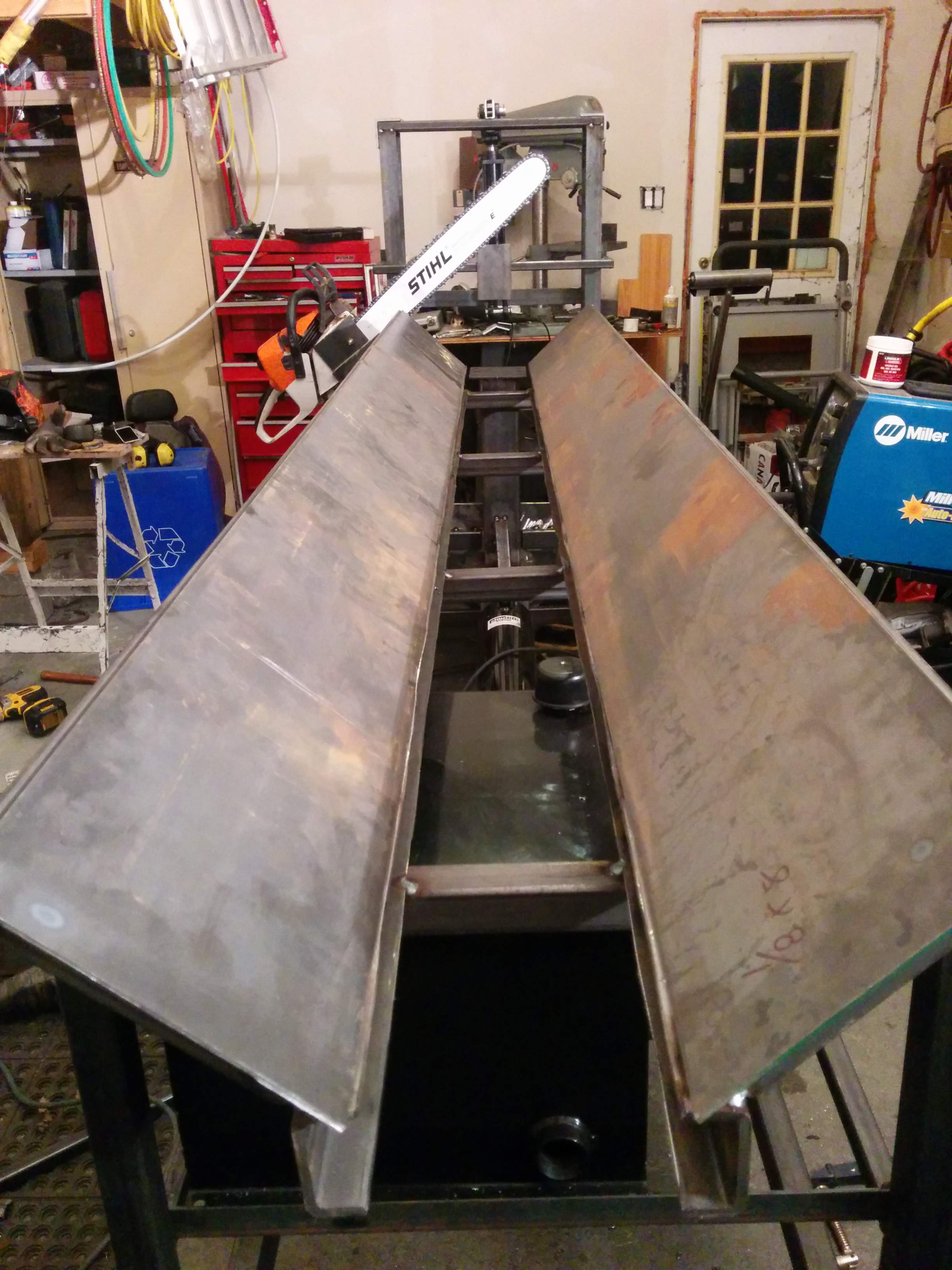

The carts "bed" will be butchered to make a wood chute as well. I need the wood to be pushed up about 3' so it falls into my firewood bags.

I think you created a Monster need to call it splittenstein.

I saw that too , the bracing for the splitter cylinder . I did the same thing tried to split a oak block standing up to test and broke the welds on my cross piece which was a doubled truck frame , now it has gusset at the pin end to the side frame will see if I twist the whole frame

:cough: Sorry about that...cough. ;-) Let me know when you want to install it and I'll come give you a hand.
Seriously though, it looks much better with the extra bracing and even though you had to (eek) use used steel, I'm sure you will be happier in the long run
/ Firewood processor build thread
#110
LOL, thanks. I don't care about the used metal, I'll be happier in the long run if the machine doesn't fold itself in half, my design doesn't lead itself well to curves! I was surprised how well that used metal cleaned up though. The pictures don't show it well, but it's darn nearly new after a few passes of a flap disk.

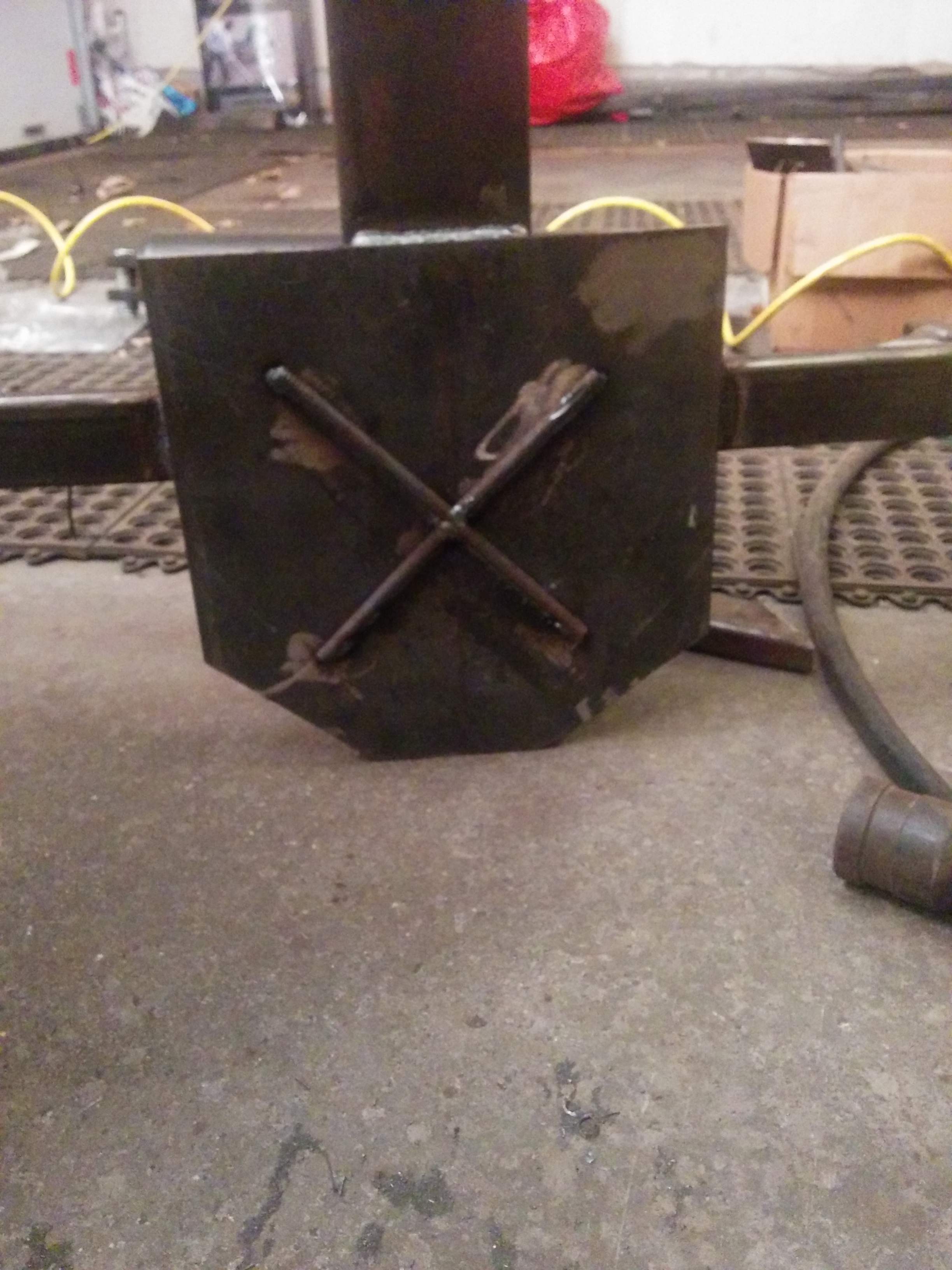

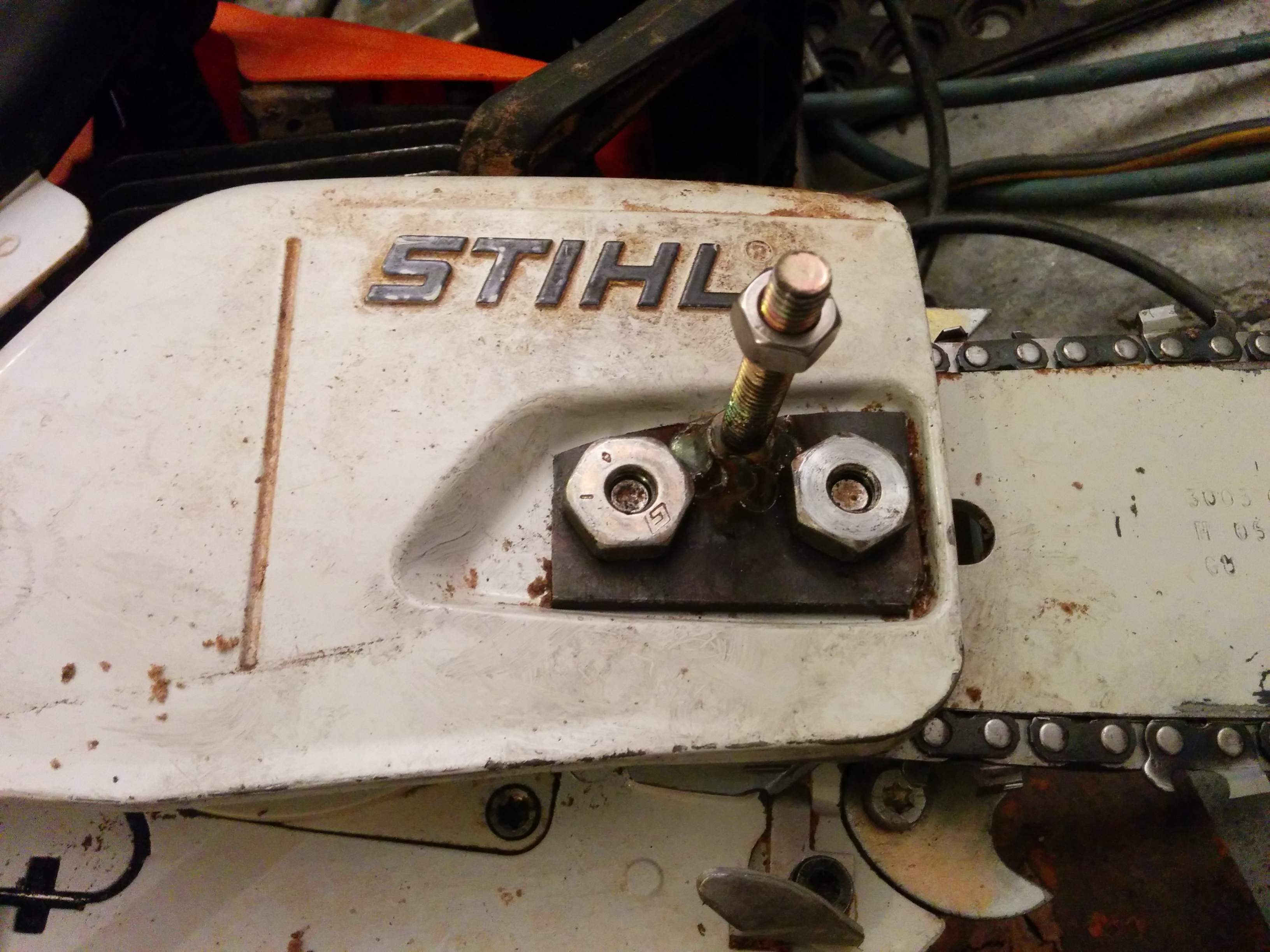

So I said I only had 3 welds left, well I found a few more :laughing: I welded on some hose clamps for the hydraulic lines, rebuilt the log clamp holder since I had more steel to work with now and welded some nails across the pusher plate to stop rounds from moving. I also did some other minor stuff not worth mentioning. I now have 1 weld left (I think) and I ran out of wire! Well, I finished a 12.5 lbs spool anyway and I just didn't have it in me to reload, I didn't feel like being out there last night, so I went to bed. I'll finish that weld and start cleaning it all up tonight. Hopefully, I can tape off some parts, get tarps set up around the machine etc and be ready to paint Friday night.
Nails on the pusher plate.

If that doesnt hold the wood from slipping, I have seen a hole drilled through the plate and a 5/16 bolt with a sharpened tip welded in the hole.
Aaron Z
I thought about spikes but didn't want to have wood stick to the plate and be dragged back when the cylinder retracts. This is a similar design to my logsplitter although the nails on this one are bigger than the wire they used on it. I also thought about cutting pipe about 1/4" - 1/2" long and welding those around in a pattern. I guess it's something to add to the "we'll see how it goes" list!
