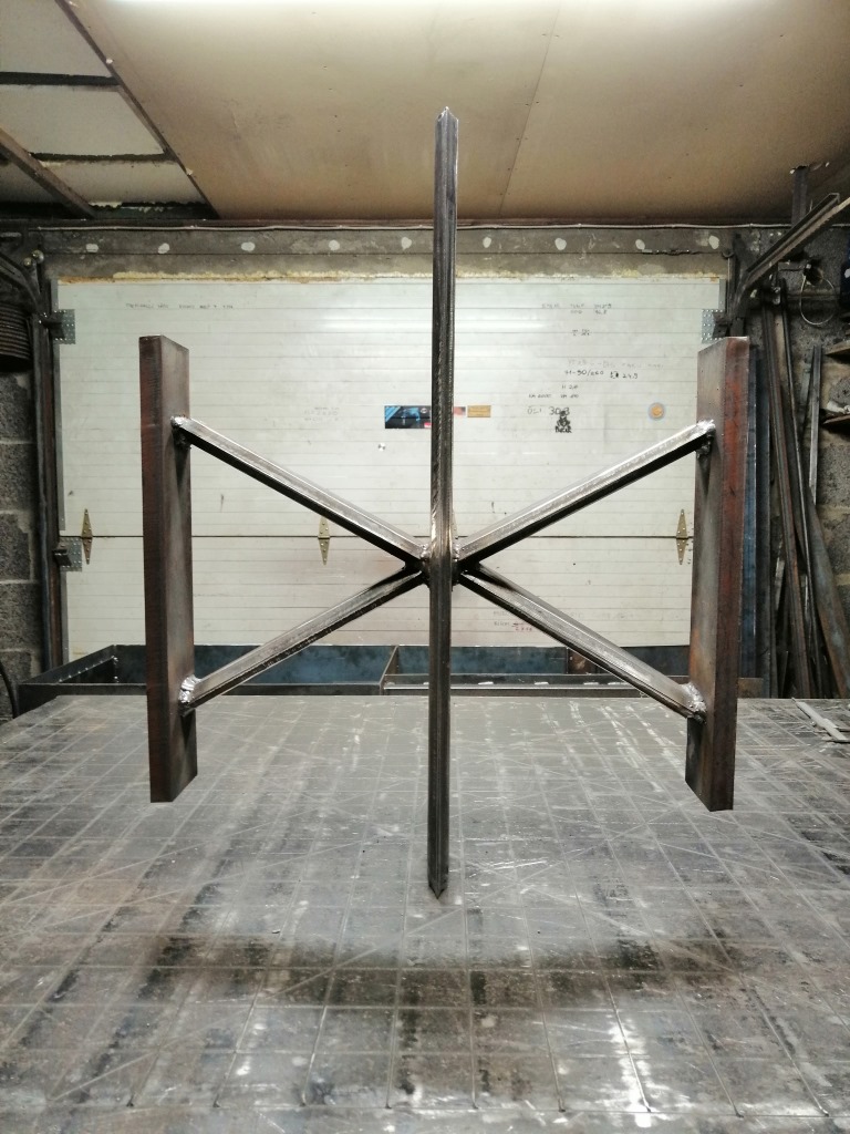

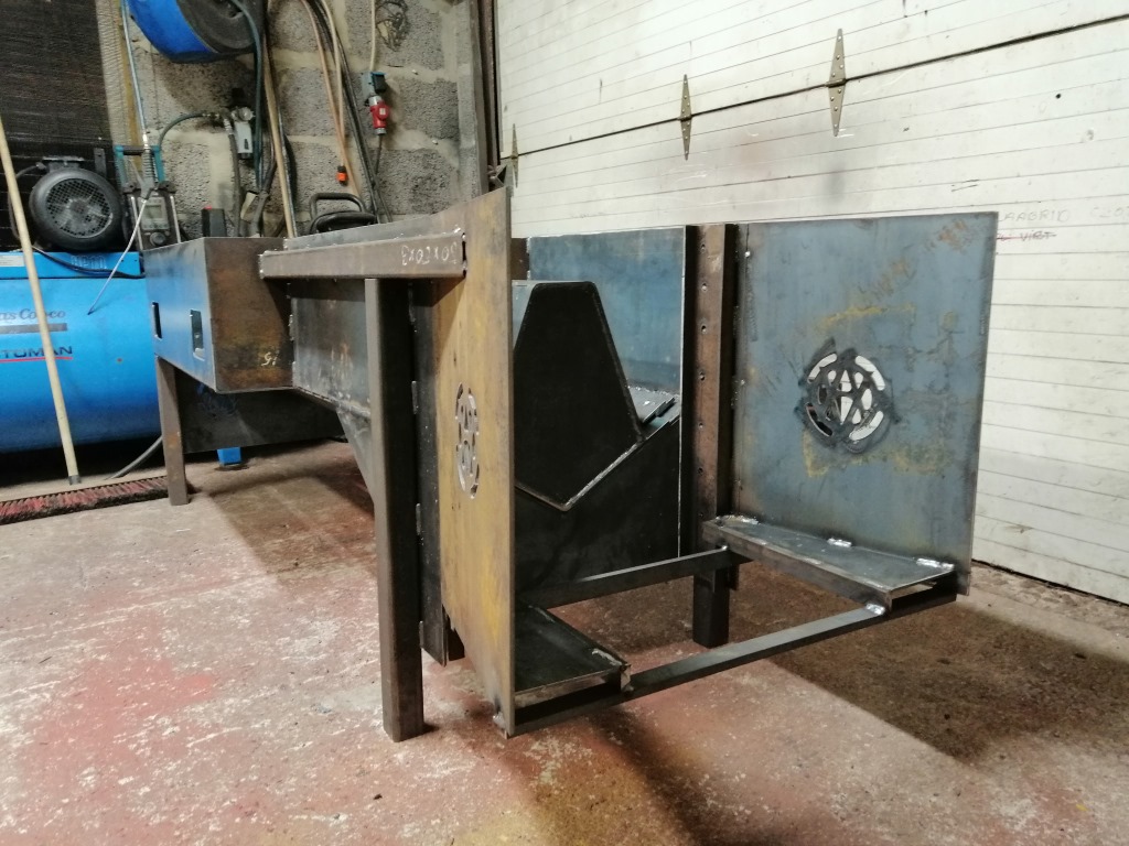

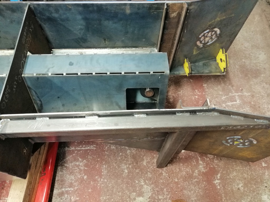

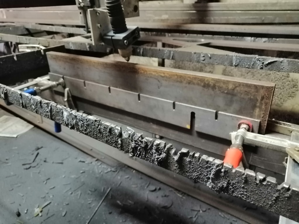

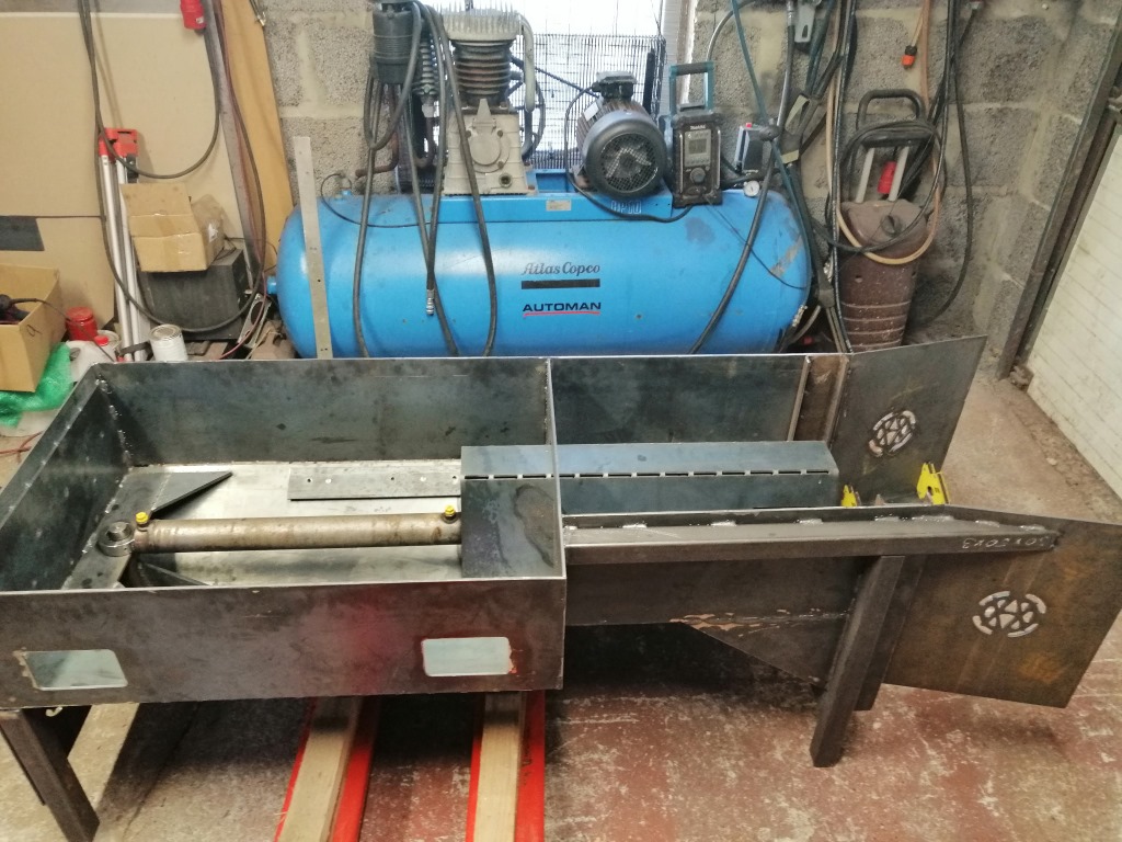

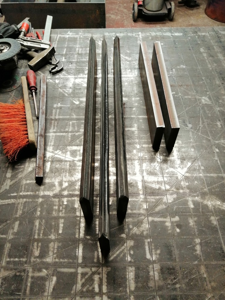

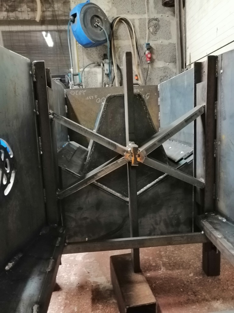

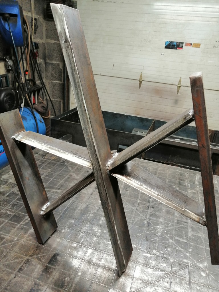

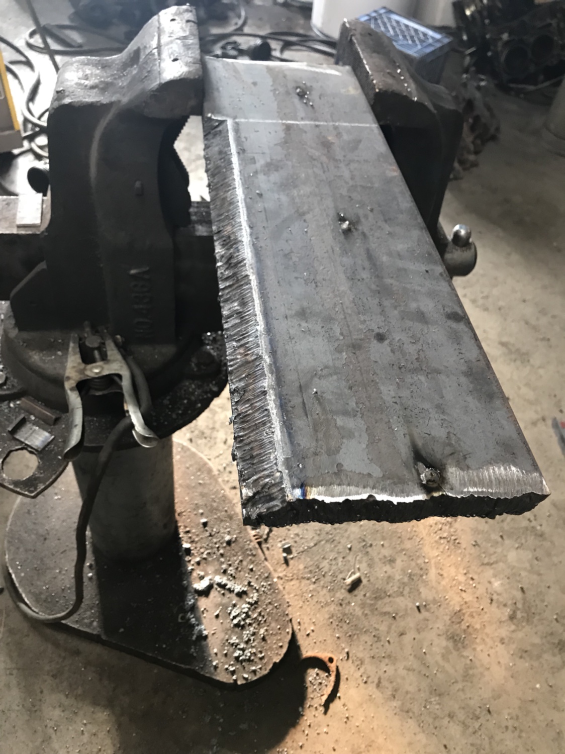

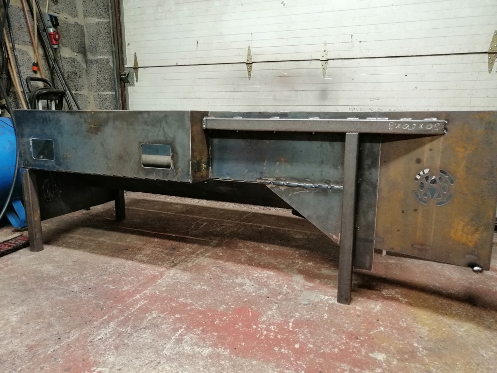

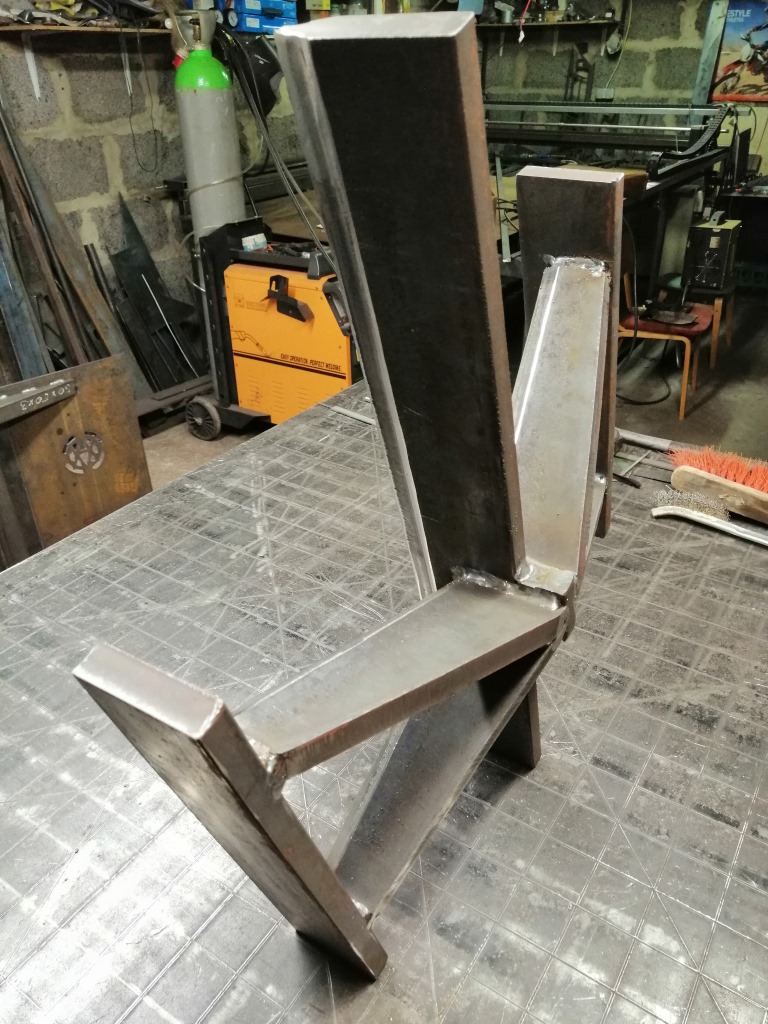

Today I welded the ax together.
Here are some pictures of how the project has gone.
IMG_20190217_154317.jpgIMG_20190217_154324.jpgIMG_20190217_154331.jpgIMG_20190217_154402.jpgIMG_20190219_202057.jpgIMG_20190219_202104.jpgIMG_20190220_202353.jpgIMG_20190221_204410.jpgIMG_20190221_204205.jpgIMG_20190221_204130.jpgIMG_20190221_204031.jpgIMG_20190221_202751.jpgIMG_20190221_202739.jpgIMG_20190221_204455.jpg

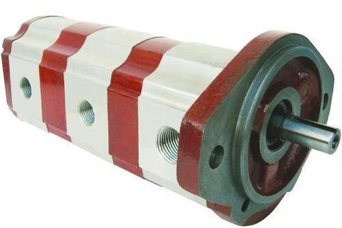

The pump is not an easy question. My plan is to use 2 pto pumps on the same shaft. because I can't find a tandem pump that is big enough.
Or is very expensive.
Surplus center don't have many pump with tandem option. they only have two pump option with a too small second pump.
Do you have a website that sell triple or double pump like you discribe?
I think that you can mount this kind of pump if you have a long shaft.
