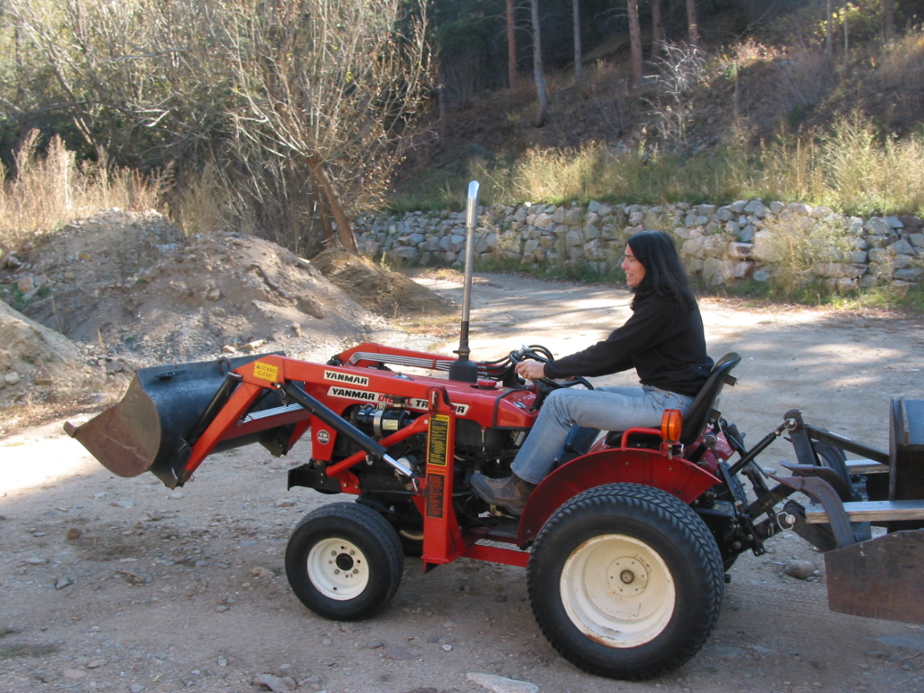

First was the compact 4wd tractor w/loader & blade. Wonderful thing & much better than doing things by hand, but powerwise not a whole lot different from what you can do by hand.... just way more convenient. Kind of expensive for us at the time.

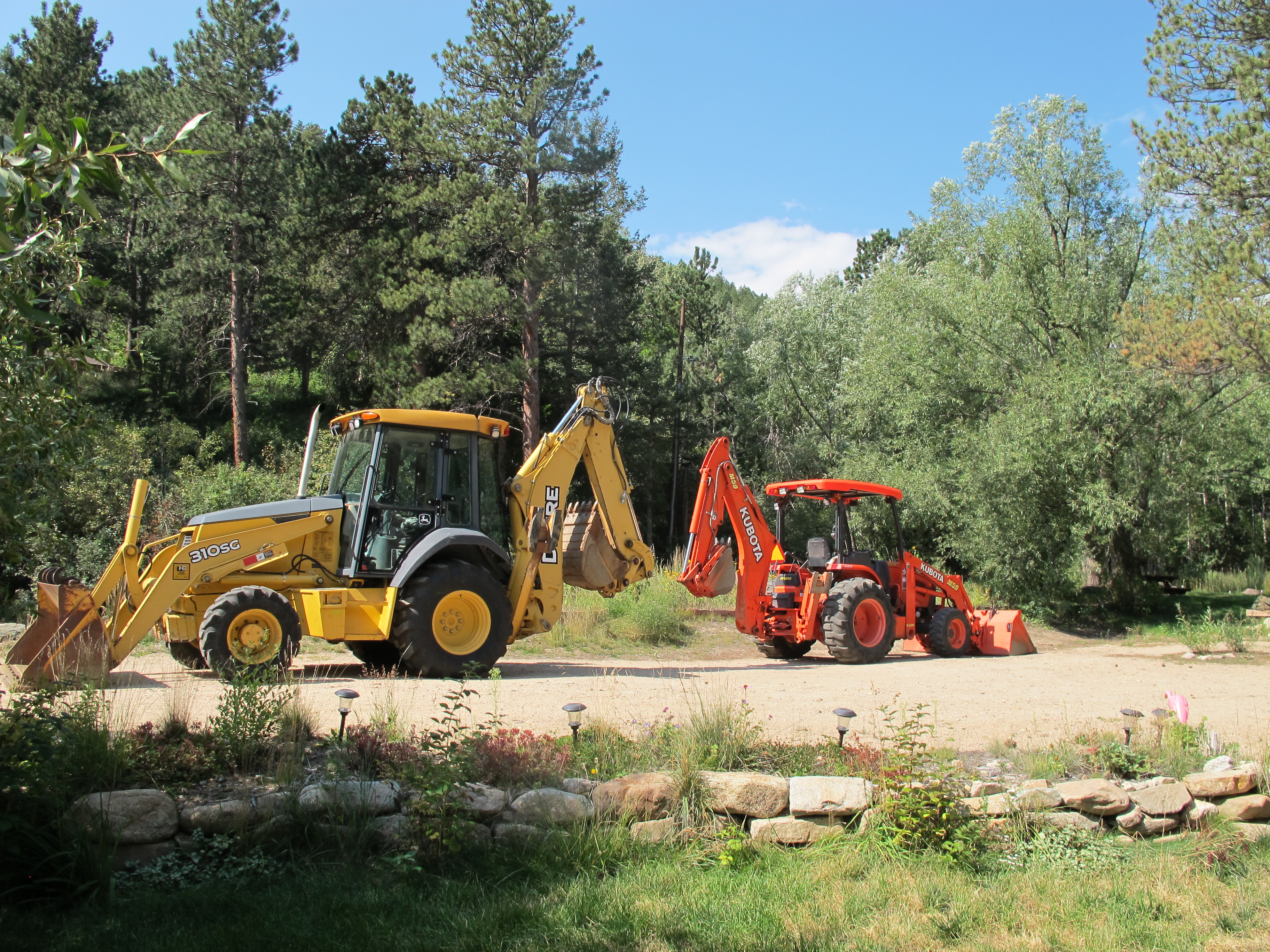

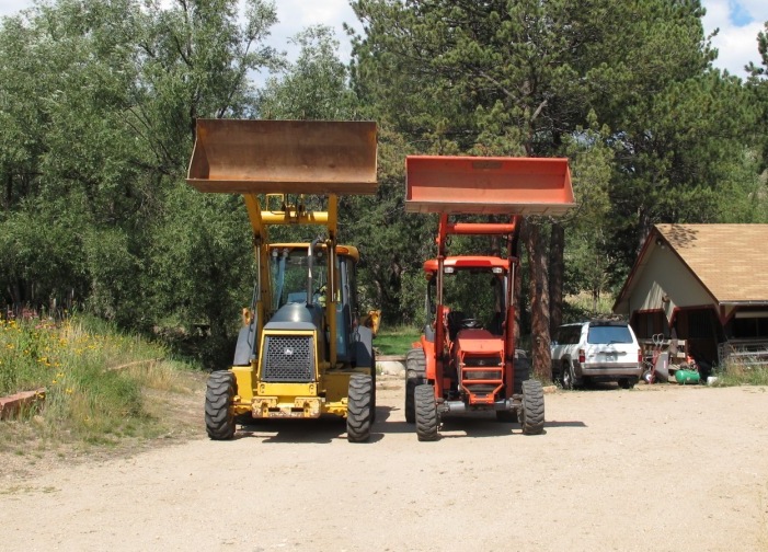

30 years later & retired, my wife bought us a new semicommercial TLB: a Kubota M59 with interchangeable cat. II 3pt/ frame-mounted backhoe. BH HAS A THUMB!!. We still use it everyday. Remarkably handy & crazy strong.

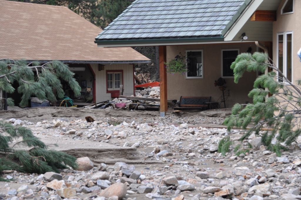

A flood wiped us out in 2013. As part of the rebuild we bought an older construction backhoe - a typical JD310G - to work alongside our M59. It is often used as a dumptruck, in the creek, or for really heavy rocks. No thumb :-(
So we have a lot of thoughts on comparisons if you have questions...

Our old 2006 vintage JD310SG commercial backhoe has powershift and a torque converter but no foot clutch. It has 1,2,3 & Rev. on a powershift lever on the steering column and a torque converter that engages with a lurch. That backhoe can be downright scary on slick hillsides. JD also offered the same machine with a standard transmission, foot clutch, and a shuttle shift. That is a much better combo on slick hillsides than what we have on ours. Ours still scares me sometimes.
