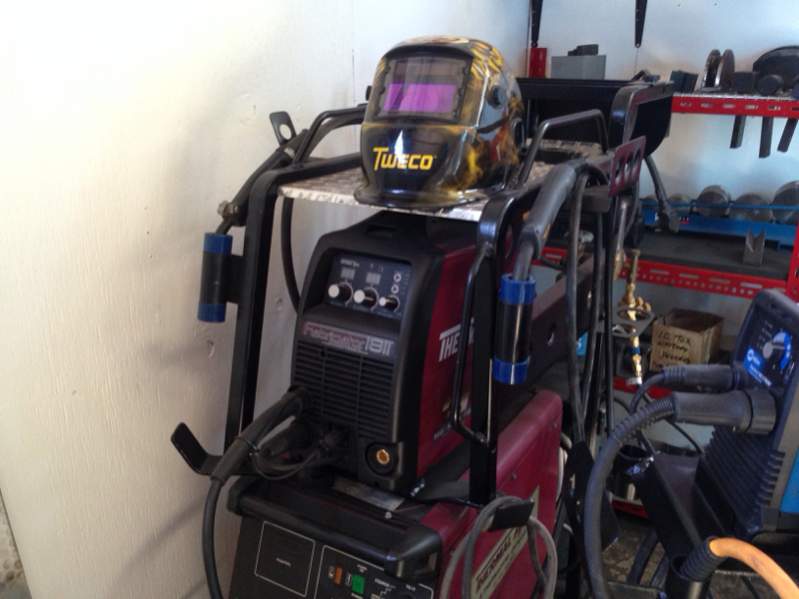

And get yourself an auto darkening helmet. Everyone has their opinions on qualities.
Mine is : just don't buy the cheapest or the most expensive. $100 will get you a good one. Check for fit if possible.
I have two Optrel's that are junk now as I can't replace the batteries. My 'go to' hood is a cheap Tweco that came as a mail in rebate with one of their welders.
