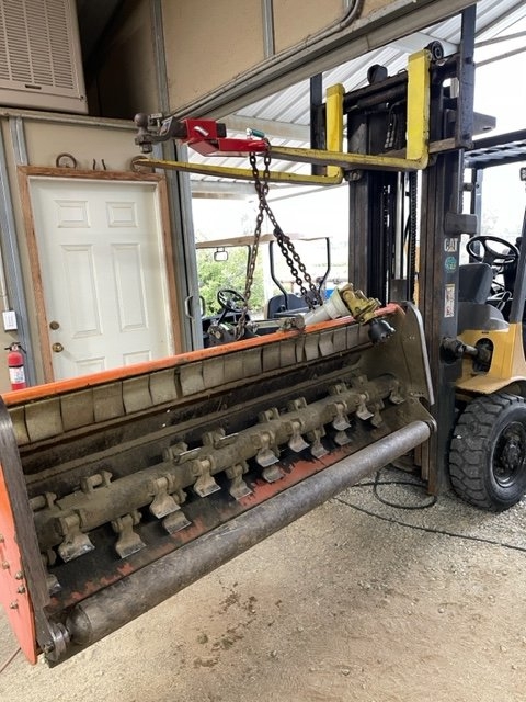

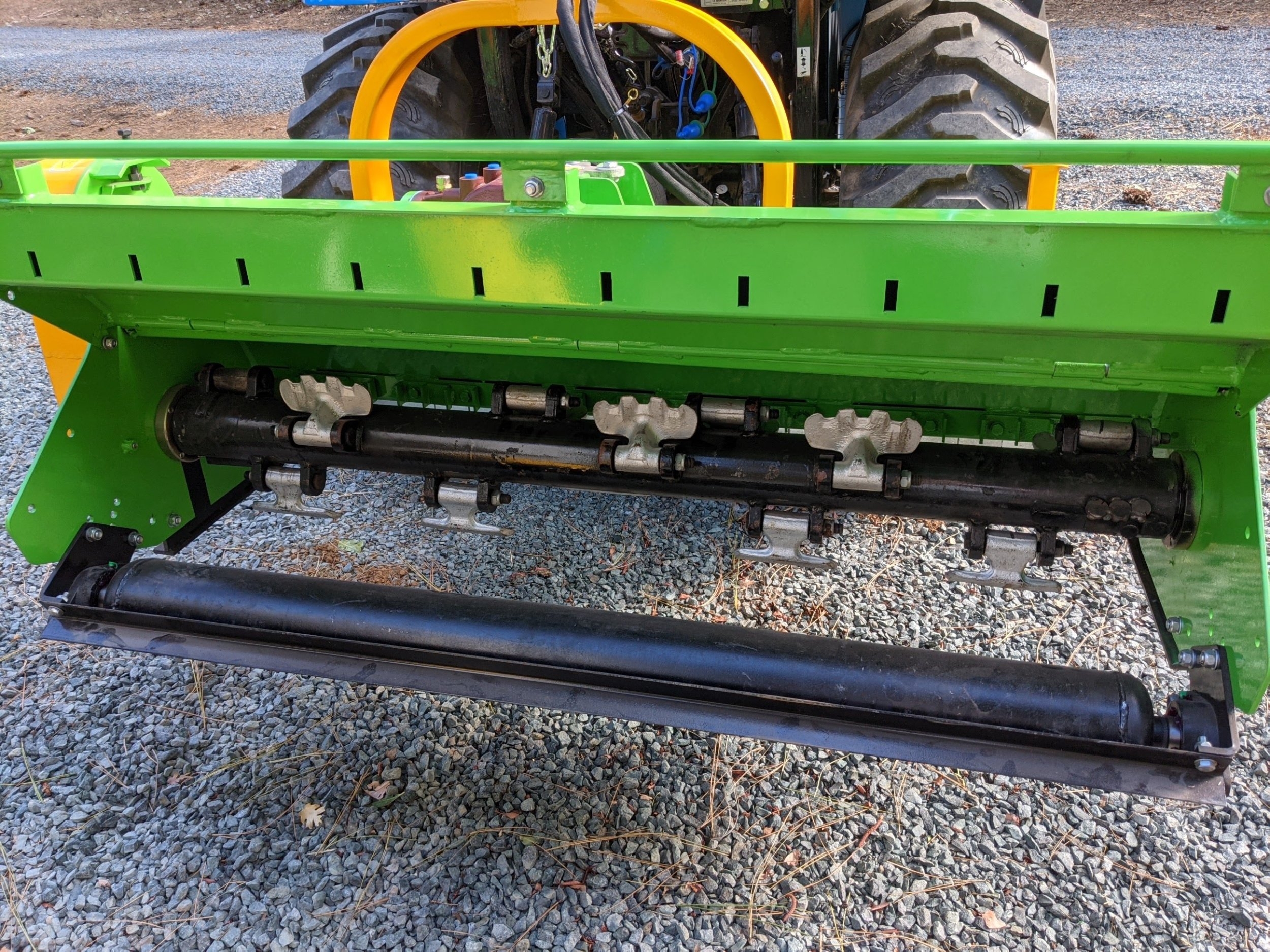

The large flail crop shredders do not make use of a rear roller as they are supported by the very thick flail mower shroud and the rear tubular weldment that prevents the flail mower shroud from twisting and wracking by also using the rear tubular weldment that prevents the mower from being damaged.
The very large flail crop shredders are used in ridge tillage to shred the crop waste on the ridges and the wheels ride in the bottom of the row between the ridges.
If you order a small VRISIMO flail mower with caster wheels you will be sold a machine with either 2 or 4 casters which make the attachment a stable mowing platform.
The rear roller of the flail mower regulates the mower height as long as the top link is set correctly making the mower level as long as you lock the hydraulic lift at the desired

A flail mower works best when the flail mower is set at the 2 inch cutting height and left there as the flail mower rotor shroud is at its lowest height and will create the highest pressure gradient/ water gauge Hg. / vacuum while operating at 2,200+ Revolutions Per Minute to allow the side slicer/scoop/spoon/ hammer knives to slice the brush as cleanly as possible and also at the same time lift the clippings up and over the flail mower rotor and back down to the ground.
If the flail mower is equipped with skid shoes they are designed to do one thing only to prevent the flail mower knives from striking the ground.
If the flail mower is being supported by the caster wheels at the desired cutting height, the front casters will follow the ground contour and the rear casters or the rear roller will follow climbing any mounds that are as wide as the rear roller and or the casters.
If the flail mower is allowed to float with the properly adjusted top link creating a level plane from front to back by leveling the flail mower with a torpedo level on the gear box the top link needs to be locked at that level position with its locknut and left there. The same rule applies with a hydraulic top link as well.
You do not need anything other than the flail mower to mow with.

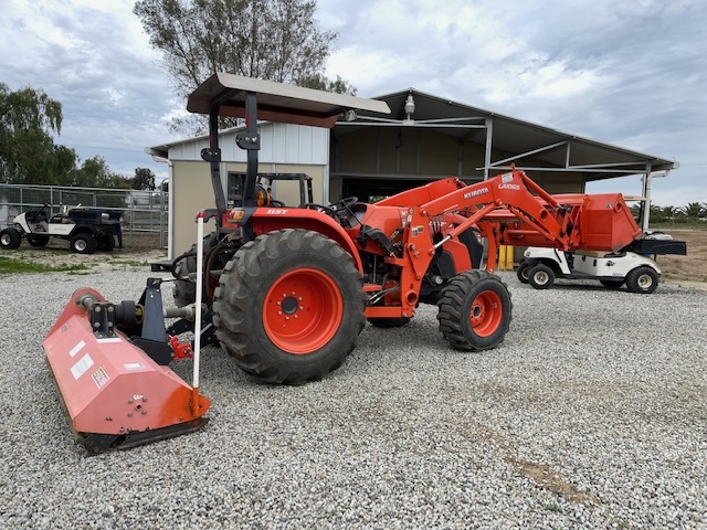

There is a way to lock the position of the hydraulic lift arms on my Kubota L series tractor?

You can lock the position control on the three point hitch but you must understand that if the mower is not set at 2 inches it will not work well and not cut the brush well enough.

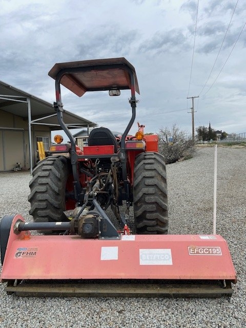

I have a Bestco flail mower # FH-EFGC195 77" for 35 hp tractors. They have smaller models available. This has been a cost effective buy under $3k delivered. There is a flail mower learning curve. I smoked a set of belts (it uses 3 belts $85). And I trashed a set of cutting hammers mowing rocks. I can reclaim the hammers later but it was a paying job so I just put the money into a second set. 32 pieces I believe.
With flail mowers you have a choice of knives or hammer style cutters. Hammers reduce brush to kindling and knives give a better finished cut on weeds and grasses but fail on the big stuff. A well kept set of hammers can give a decent field cut and still take down saplings and mulch downed branches.

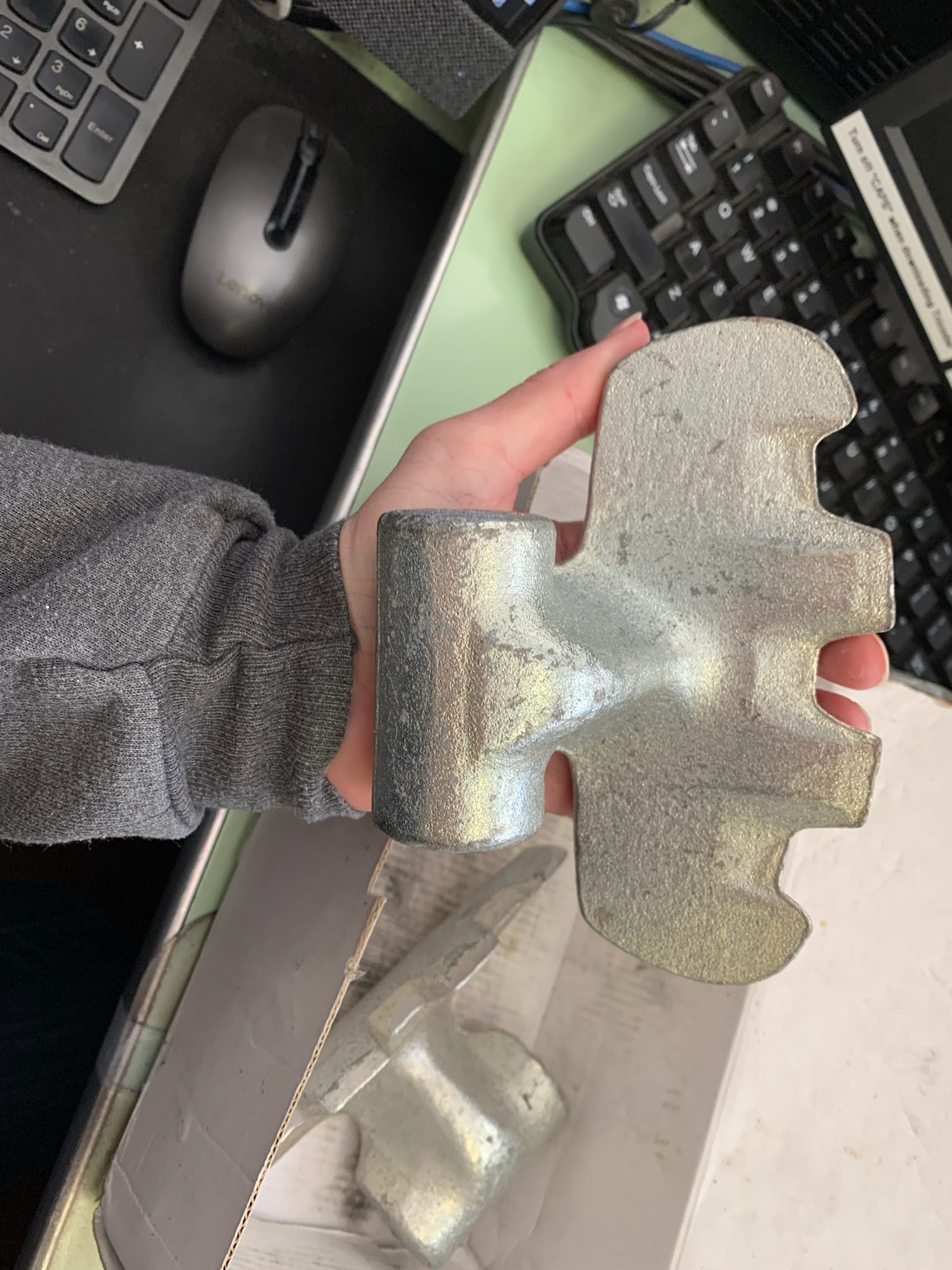

I went with Novatractor for my flail because it has the nastiest hammers I've found. Over 3 pounds each and they look like metal bear claws. If I was mowing a golf course, I would pick a different tool. But for mowing rough stuff, this thing continues to impress me. It munches berry bush, poison oak and saplings into nothing. It's an import made in China, so if you're dead set against that, then pick something else. I did hit a basketball sized rock hiding in the weeds and broke a pulley, but Novatractor had me a new one in about a week. Good support. We call our flail the "Park Maker" because it will turn an overgrown area into a park like magic. My standard setup is grapple on the front, flail in the rear as we work on making our property more fire safe.
