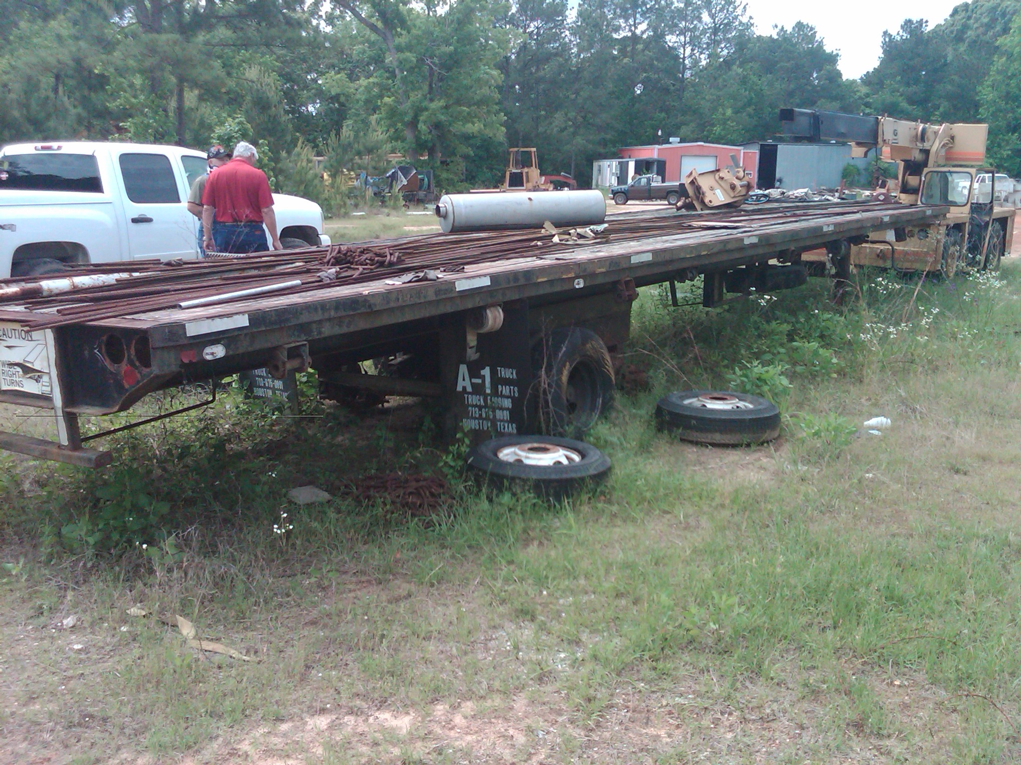

Thanks for the comments. Here is a picture of the trailer. The owner will remove the axles and front jack prior to installing it as a bridge. I will take more pictures when it is installed.

That trailer looks like it's in decent condition. However, I do second some sort of foundation for the trailer to sit on. It doesn't matter if you dig a hole and fill with large boulders, or concrete/rebar or blocks or put large logs like locust or cedar with flat top. Understandably the logs will rot away over time, but will last as long the trailer is since its buried.
/ Flatbed Trailer for a Bridge #11
Looks like a super way to put in a good strong bridge easily. Like others have said something to keep it up out of the dirt will add a lot of life to it. Even digging a footer across each side to let the ends sit on would be great and you could add some bolts imbedded in the footers to set the trailer frame down on to held hold in position.

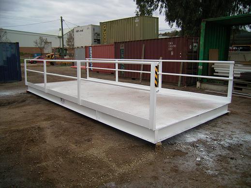

Hi,
I'm currently doing a bridge myself. I'm using a bolster style shipping container. Similar to a flat rack but without the folding ends. These come in 20 foot and 40 foot and are available anywhere you can get shipping containers. Fit onto any truck that can handle a container.
Worth investigating. I've attached some pics of a bolster (doesn't have to have the holes in the top) plus one of a nicely done up bridge made from one.
