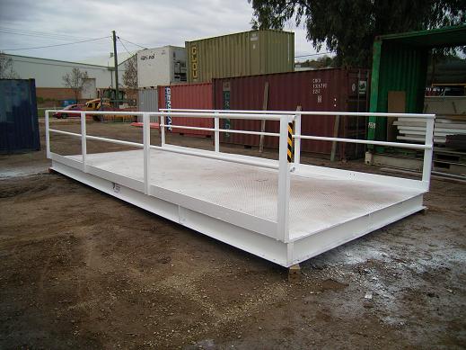

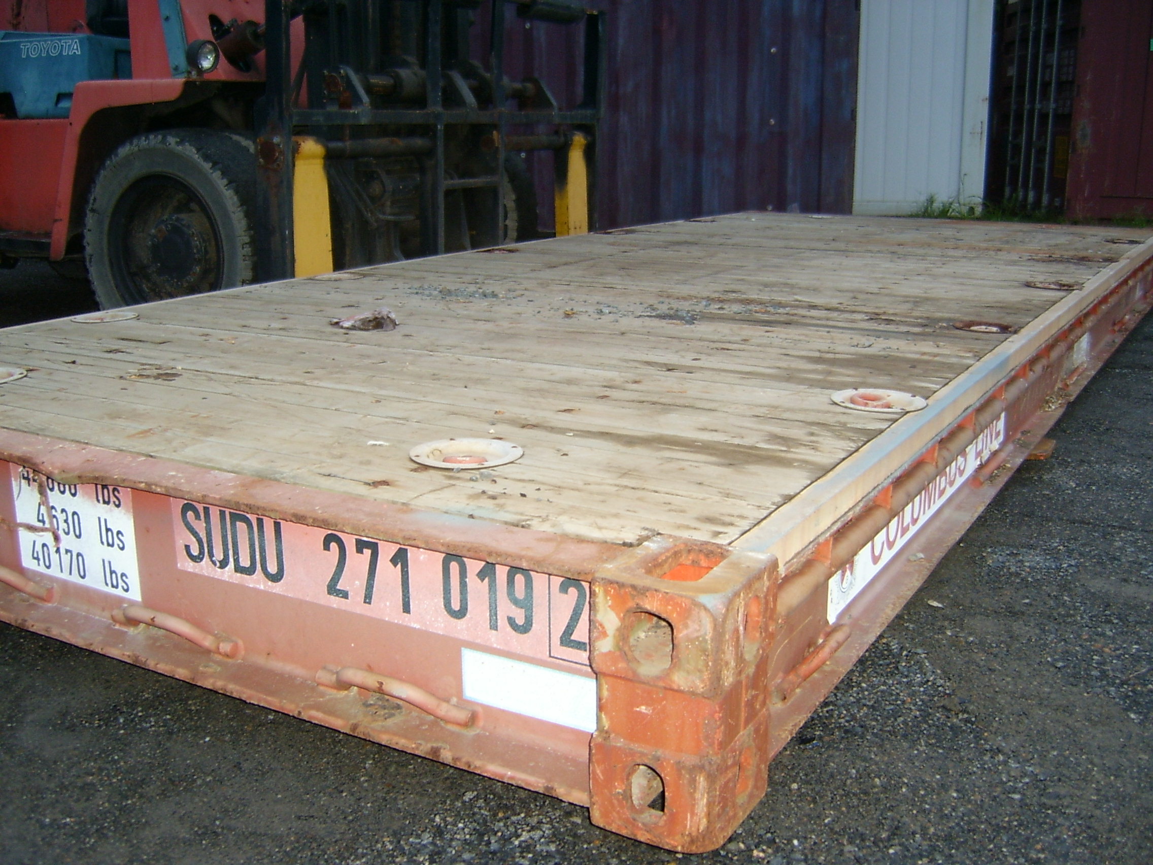

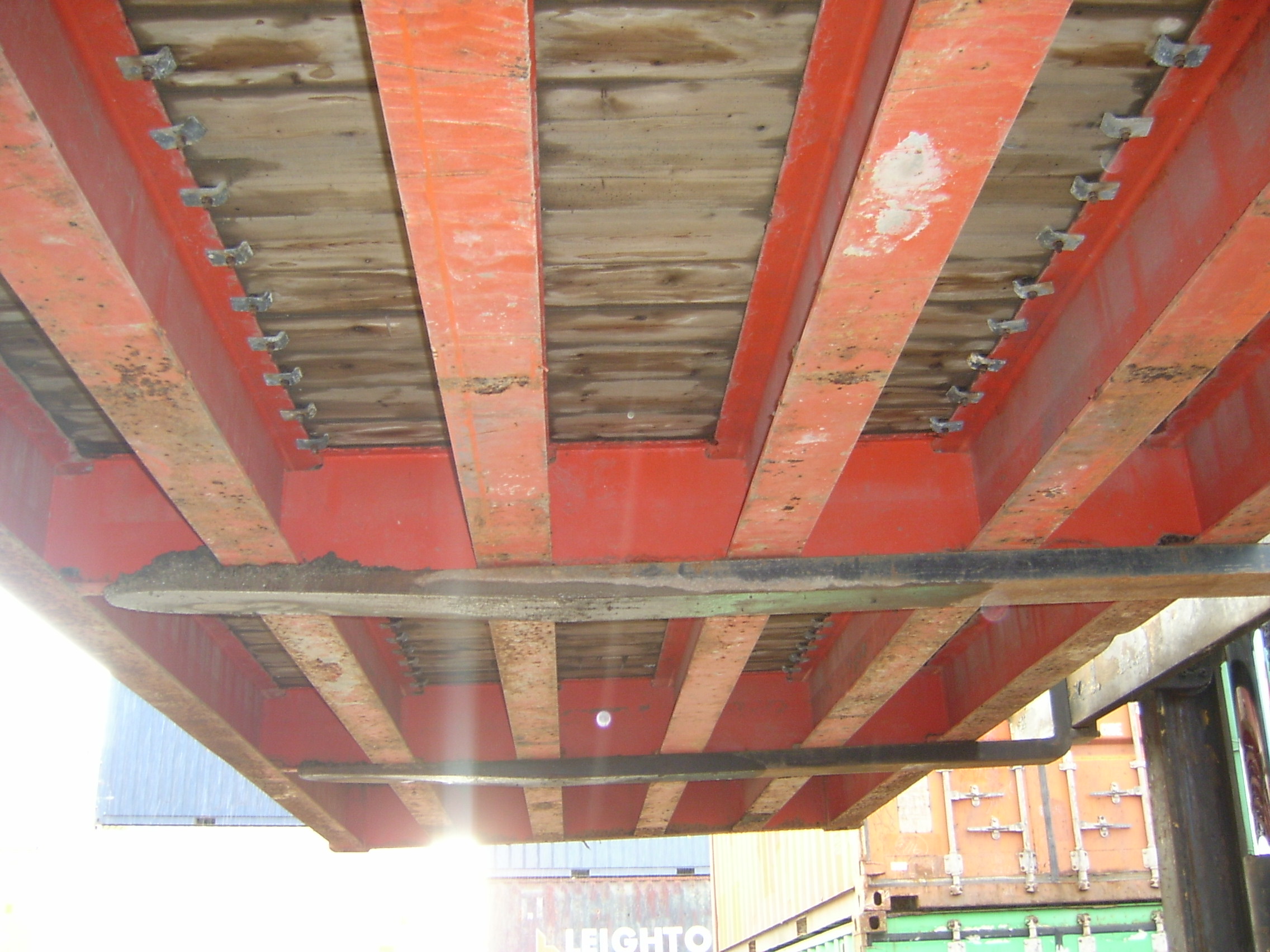

Hi,
I'm currently doing a bridge myself. I'm using a bolster style shipping container. Similar to a flat rack but without the folding ends. These come in 20 foot and 40 foot and are available anywhere you can get shipping containers. Fit onto any truck that can handle a container.
Worth investigating. I've attached some pics of a bolster (doesn't have to have the holes in the top) plus one of a nicely done up bridge made from one.
Mark
