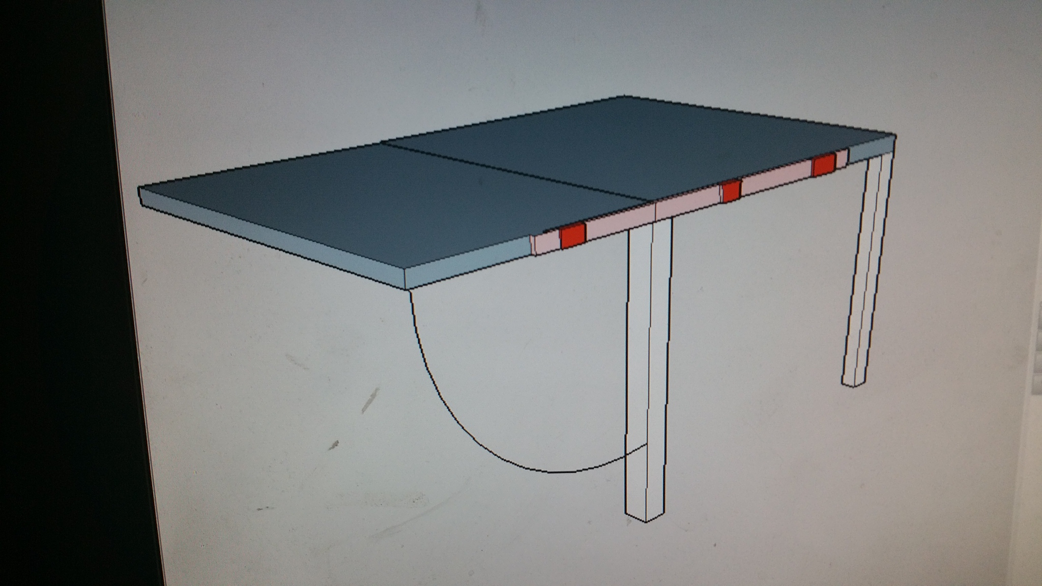

The pink is a flat bar. The red are c-channel to hold the flat bar. Flip up the table, slide the bar into a holder. Do this for both sides. The flat stores out of the way on the table. No extra parts needed. Make it half the length of the swing up portion so it doesn't stick out. Easy!
I don't know why this thumbnail is upside down and I can't remove it.

Okay guys, thank you very much for all the ideas!!!! I have committed to folding braces.
Thanks to LD1 for giving me two bits of critical information in the design. 1) distance from the hinge pin at the table down to the bracket at the bottom of the table leg, and the distance from the hinge pin at the table out horizontally to the bracket on the cutting table MUST be the same length. 2) The two pieces of flat bar that make up the hinging brace have to be drilled exactly the same length between the hinge pin hole and the hole at each end.
