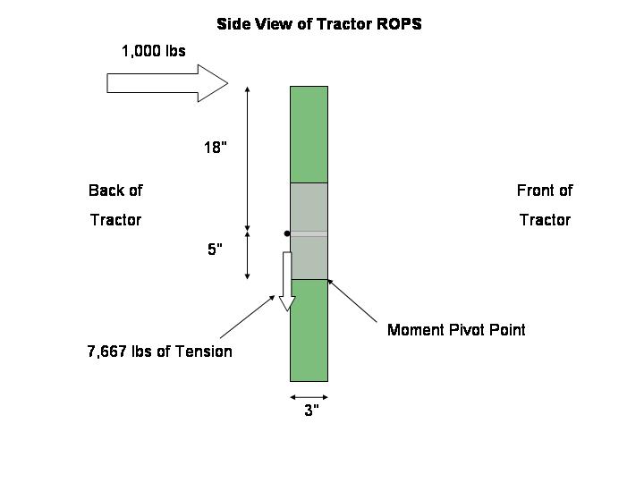

I'm following you now... The JD design has separate bolts for the pivot of the impact force and another to lock the ROPS upright , but your pin is designed to do both. Your intent for the hinges is to just hold the ROPS when you have it folded down, right?
Your fab skills seem good and you probably already thought of it, but you may want to ease all of the edges that will be pointing straight up when you have it folded down.
Good luck with the install and remember this is one of those projects that we don't want see pictures of you testing it out after it's installed!
/ Folding ropes..
#23
Yup just to hold the rops when folded down basically, but will provide some strength once its all welded up as well.. These hings are are petty tough and will be welded just about everywhere except for the hing part..
Once I get the tractor home tomorrow i will see how everything fits together, grind down the edges, weld it up and grind some more...
I am happy with how it is coming out, should be tough as nails when done. The likely hood of me rolling this lil tractor are probably slim to none. But as for my family and friends, sometimes the common sense goes by the wayside.. :)

/ Folding ropes.. #29
Just a guess!
I think his point is that modifying the Rops could/ might be considered a fools errand by some. Yes, you are all a very smart bunch of fellows, but do any of you really have a clue as to whether or not this modification will fail?
Some things hardly seem worth the risk.
/ Folding ropes.. #30
And what is your point?? He is not modifying the attaching point, or how the ROPS is attached to the tractor.
My point is,,,He is in fact modifying the ROPS with a folding attachment that wasn't added by or approved & tested by any manufacture or testing agency... From what I've been told by people that have had ROPS devloped & OSHA tested , that ROPS aren't made from regular grade steel. They have also been tested in a roll over situation by mechanical means. IE, Not tested by a real live person being tossed around by a 3000 - 5000, LB etc,,,,,Tractor to see what happens...Will it work ?? I have no idea... Would I bet my life ??...Not a chance !!.... Hey, he's grown & it's his life .. Like I said ....... Good luck
/ Folding ropes.. #31
Well, I will make the point that the story proves that unexpected and unforeseen things can happen when a ROPS is modified. No one other than the engineer who designed the ROPS in the story would have believed the failure could have occurred.
In the same way, I think it is foolish to do a home-made modification of this ROPS. If you want a folding one, you can buy that at a dealer. Sure this one looks plenty strong, but a lot of things that look strong have unexpected failure modes. I sure wouldn't drive a tractor with a home-made ROPS.
And despite great temptation, I have not modified the ROPS/FOPS on my tractor. In fact, I won't even attach anything metal to it with a nylon wire tie. If you roll over and a fire extinguisher causes the metal post to buckle because it got trapped somehow you end up dead.
"I did a good job", "it looked stronger than the original", etc., do not trump dead.

This will not be received well, but I think it looks terrible-just being honest here. Those hinges look very weak for the intended application.
You should of at least copied the way JD does it on theirs to make it more professional looking and not just welded on some cheap barn door hinges.
Flame suit on...
I still wouda changed the door not the roll bar.

Update... :)
So I was able to finish up the brackets today, then started to tackle the issue I created. When you cut the bar they have a bit of spring to them. So the were about an inch wider than the post.
To fix this I had to cut about an inch out of the top of the bar as well. I was going to just use some of the same bracing i used to the hing brackets. But found this 1 1/2 in steel bar. fits perfectly inside the tube. So now i can weld, grind it down and you should barely even tell i did anything to it.
Brackets welded on:
Still need to weld it..
The dogs:
Up close:
Test Fit:
The roll bar goes all the way down in the bracket untill the hing and the bottom one comes all the way up to the top of the hing.. That's the stopping point for the day....
