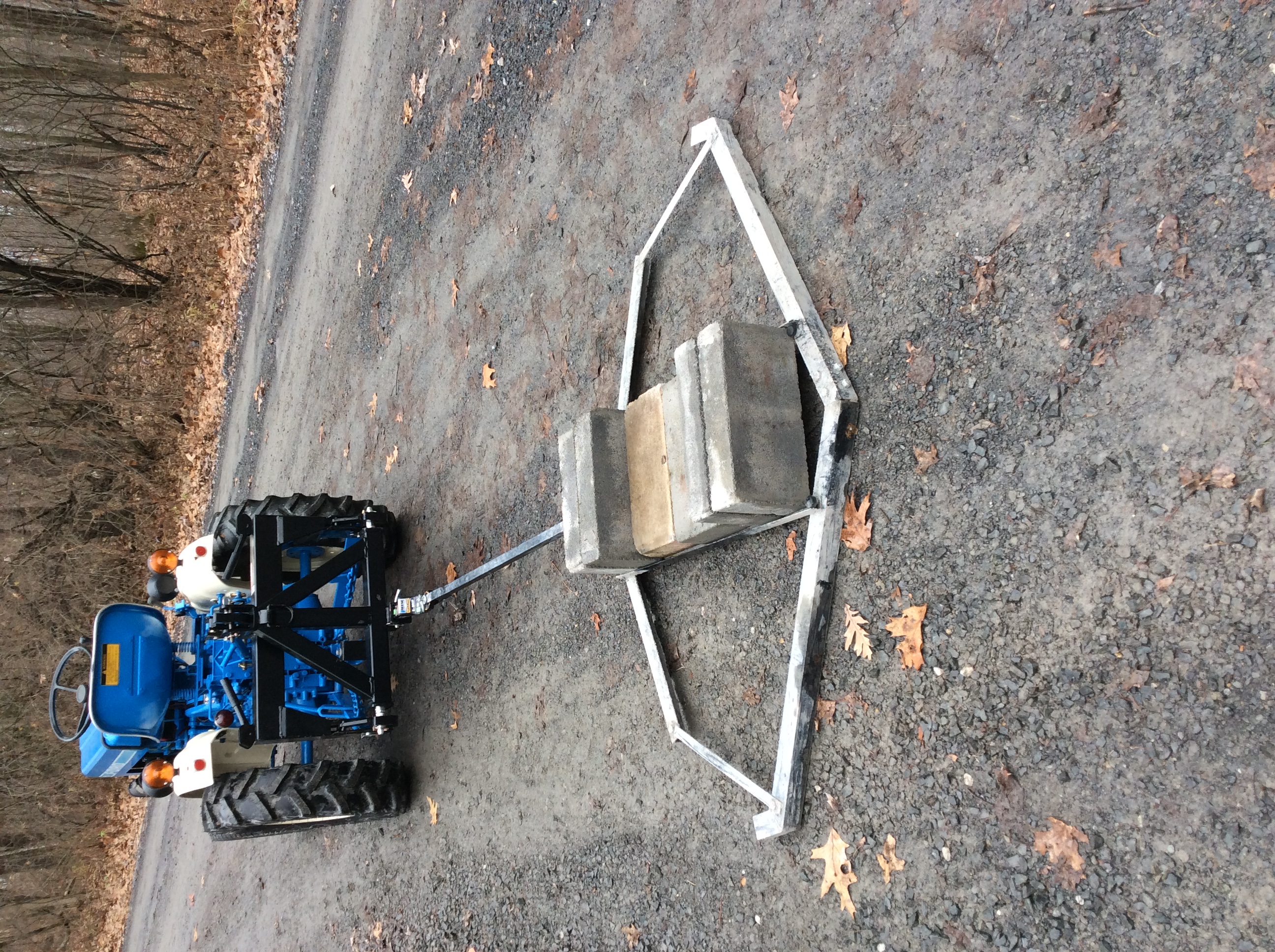

Success! Was able to drag our dirt road some more today to remove washboard and pot holes. The 1210 did great with the extra two weights on the front and using some differential braking on the turns. The front end tried to slide a tiny bit a time or two, but the inside brake brought her right around. Some pics from today.
This drag does a great job for what it is. I can't move dirt with it or bring the crown back to the road, but it is great at taking out washboard.

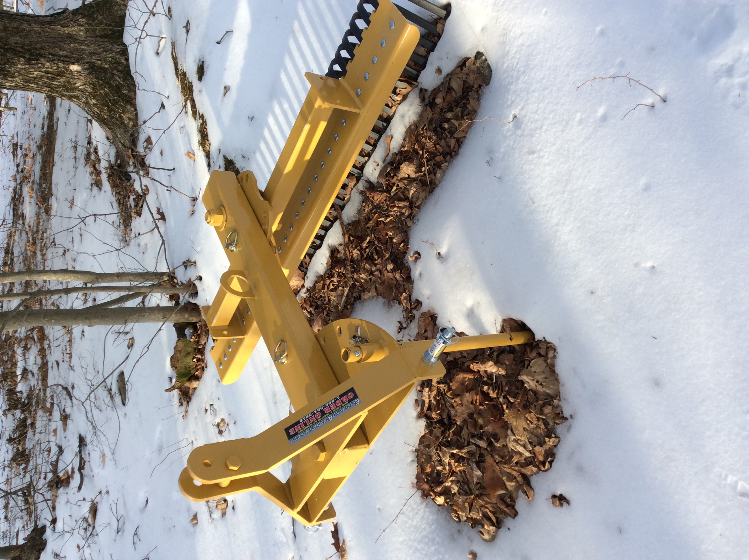

Question about landscape rake. Will this tractor pull a 5' rake? I hope it will, because the 4' ones look cheaply made.

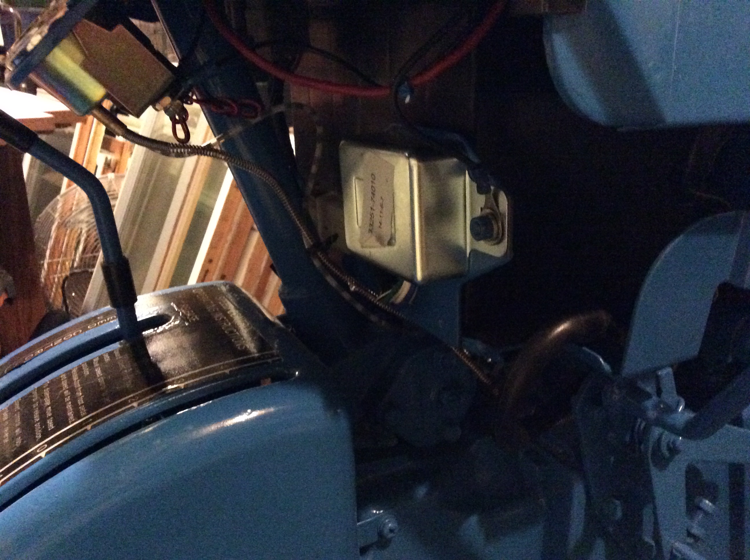

Out with the old in with the new. Finally got around to replacing the voltage regulator. No more voltage drop when I turn on the lights. The new one is a solid state unit too, no points and solenoid in this one.

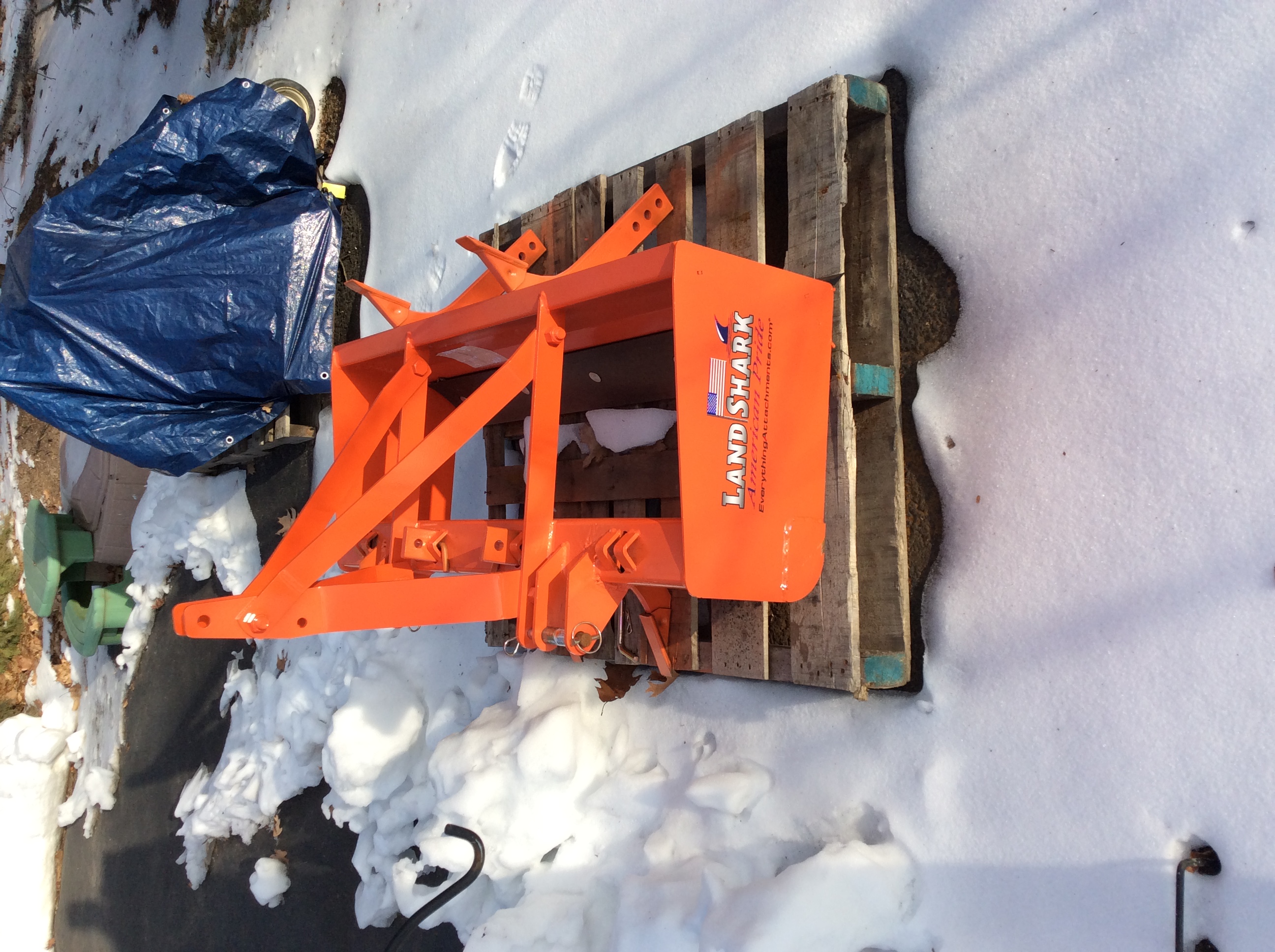

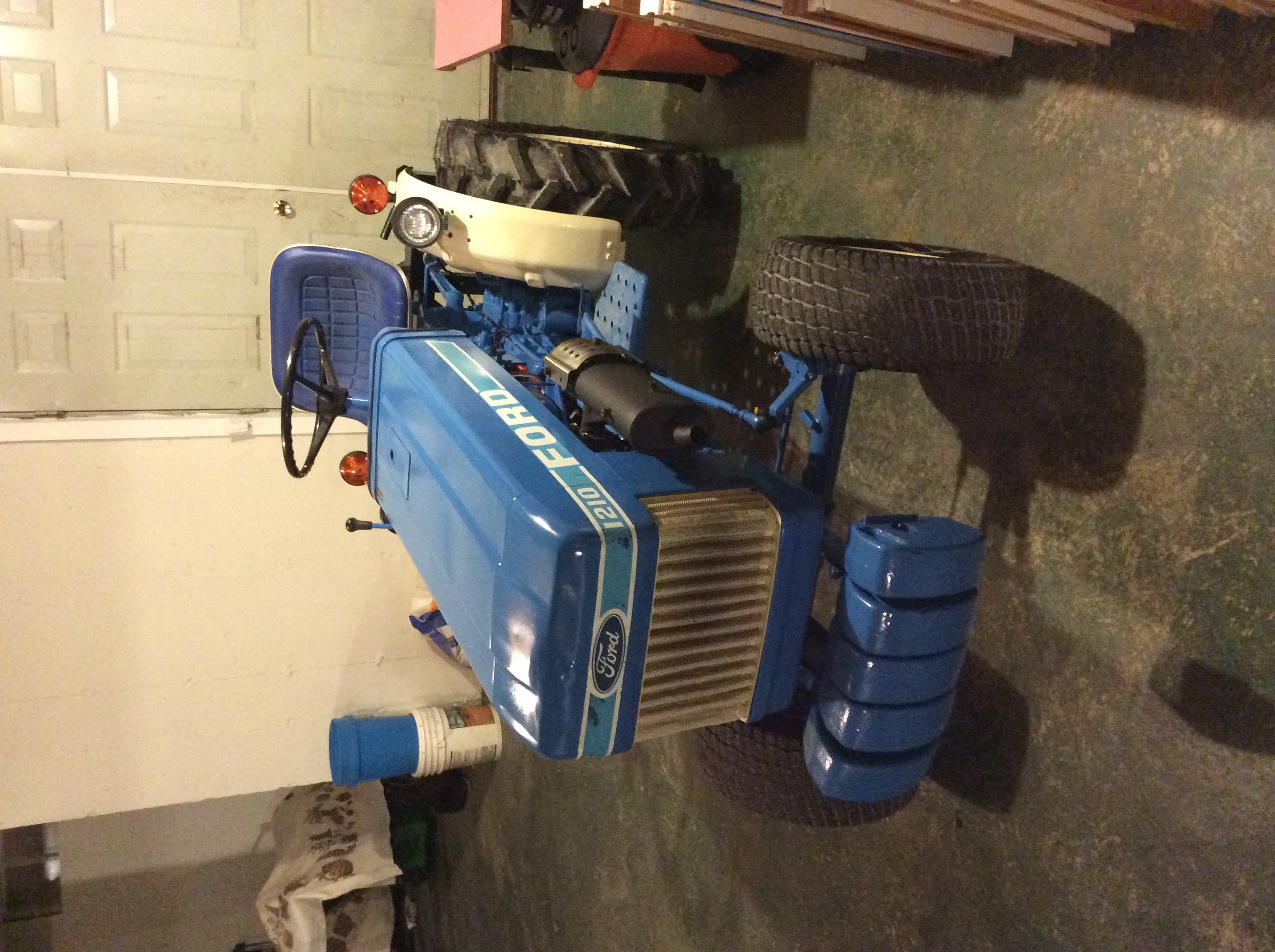

Found some wheel weights to fit this tractor finally. After the first few passes with the box blade it became evident I was in desperate need of traction.
The weights are made by new state and the part number is 3154-1 they are 61lbs each and stackable. New Holland has some kind of shipping deal with them, so you can get them from your dealer for reasonable shipping. The weights were $70 each.
   / Ford 1210 tear down and repair #147
Your 1210 looks new! Fine job indeed. I have a 1710 and a 1600, both have been incredible tractors. 100% with the wheel weights, they really transform the Fords.

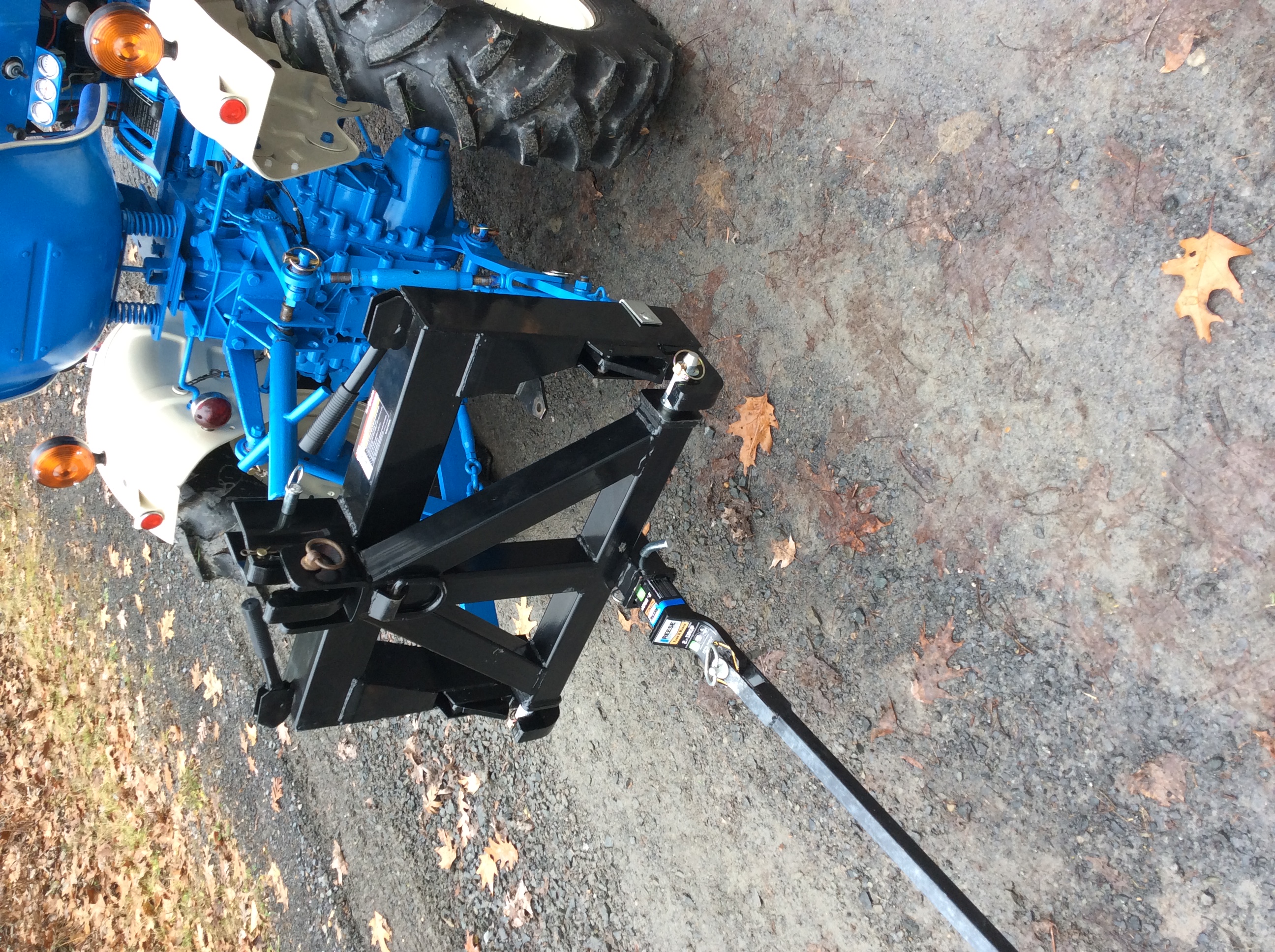

Thank you. I'm hoping the weights will help with the traction issues. Wasn't sure how many I needed, so I got four. Six seemed like overkill. I priced having the tires filled with calcium and it was around $100 for one tire, which is all I needed done since one tire already is filled. Getting weights was cheaper.
I'll be pulling a 4' box blade, and 5' rake.
   / Ford 1210 tear down and repair #149
Good choice!
Do NOT EVER fill your tires with CaCl!!!
If you add any liquid for weight, use windshield washer fluid (cheap), or "beet juice" (best - but expensive).
   / Ford 1210 tear down and repair #150
I would suggest to either fill the empty tire, or empty the loaded tire. I cant imagine the difference is good for the differential.
