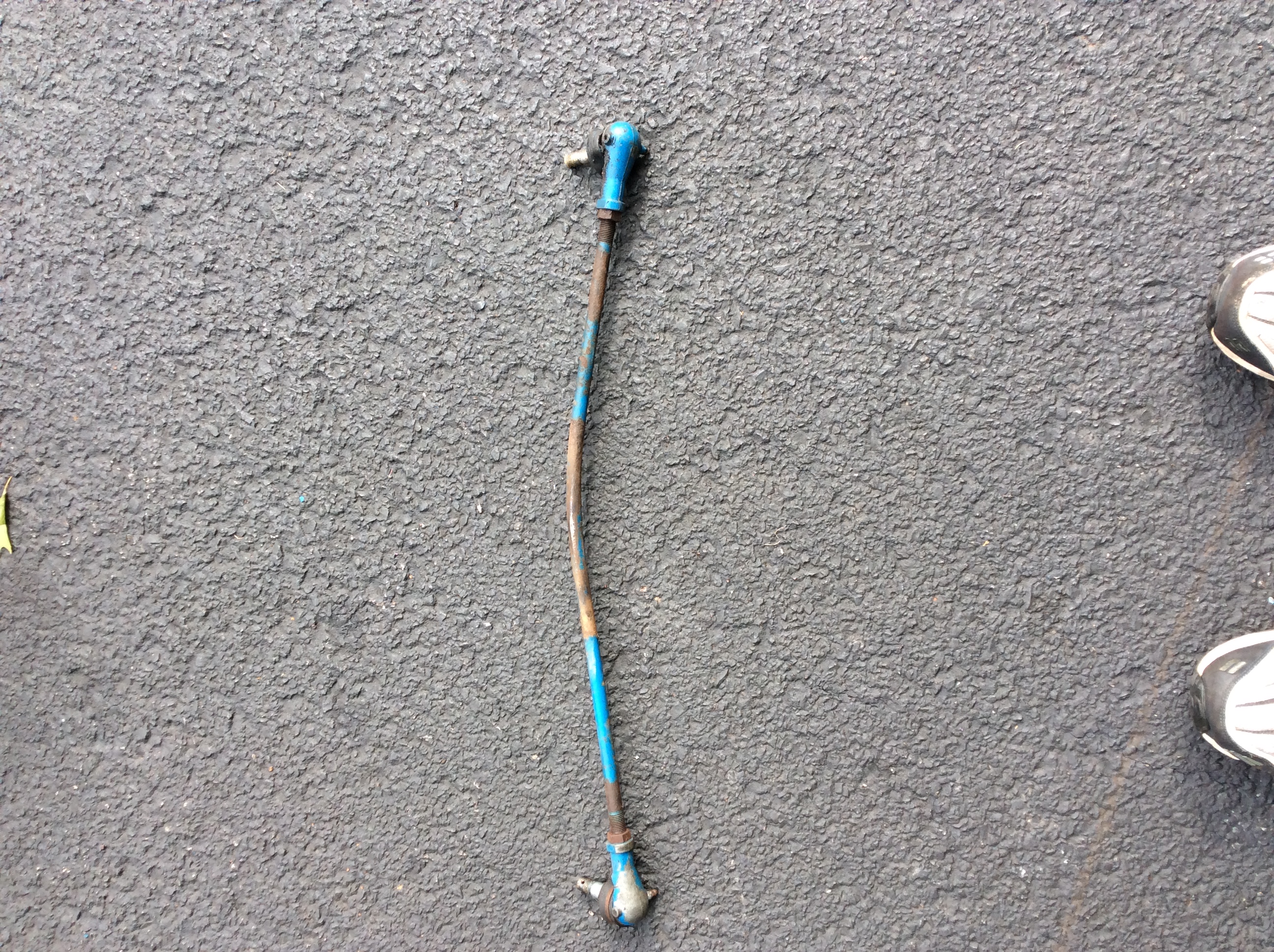

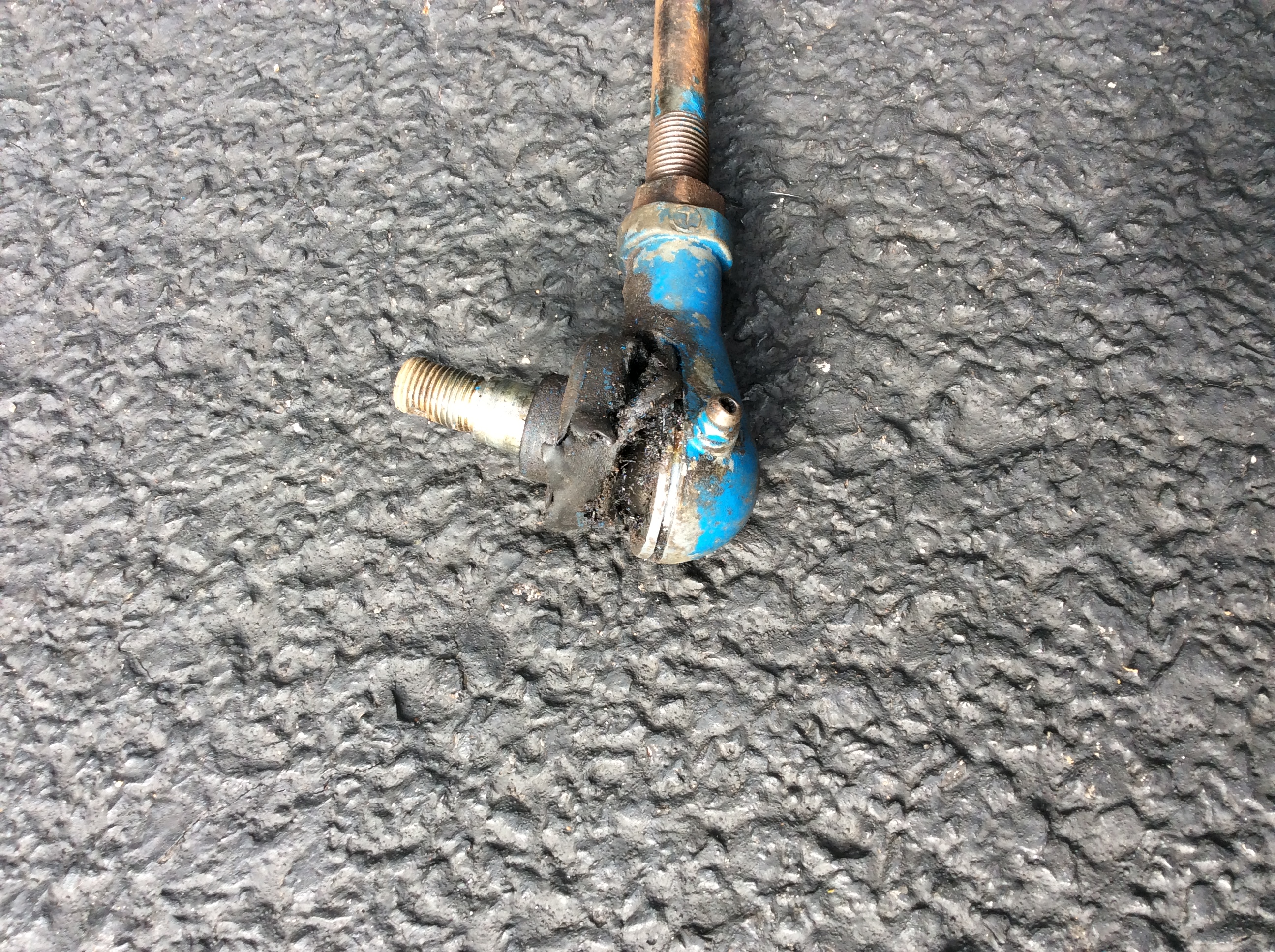

Did some front end work today also. See anything wrong with this steering rod?
How about now?
Got it mostly straight, good enough for Gov't work.

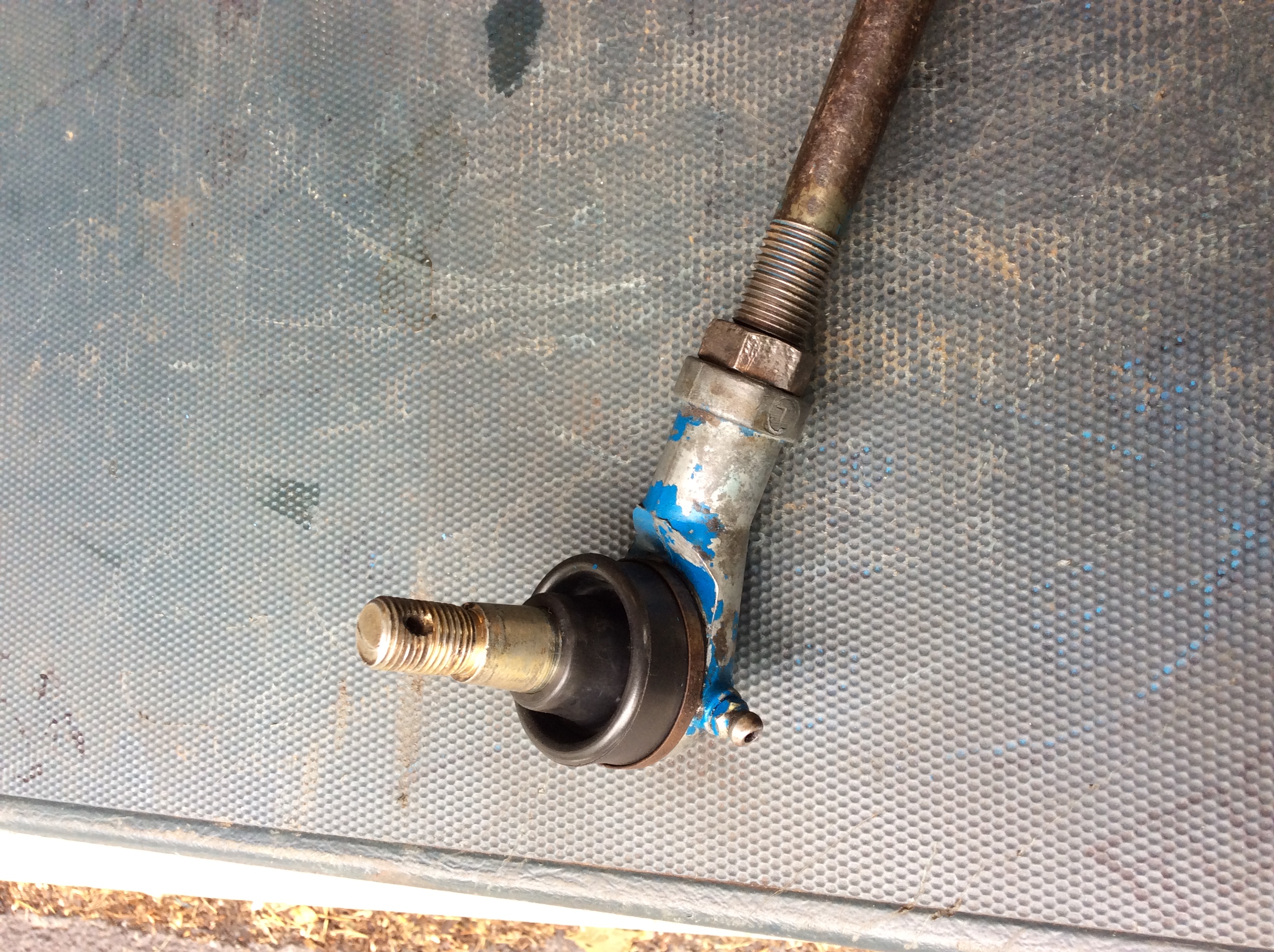

Also needed new ball joint boots.
I reinstalled the metal rings, they were pretty rough but will work for another 30 yrs.
Replaced the boots on the drag link too.

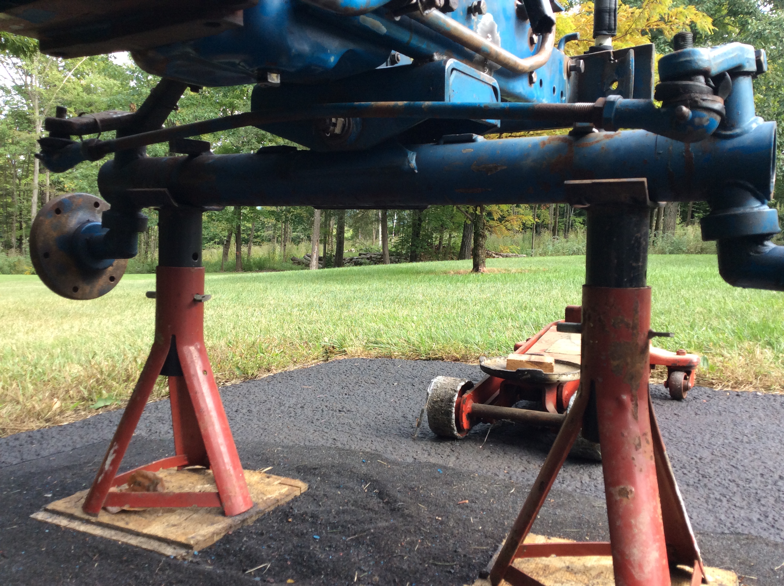

Tomorrow the axle comes out as well as the left spindle.
   / Ford 1210 tear down and repair
#43

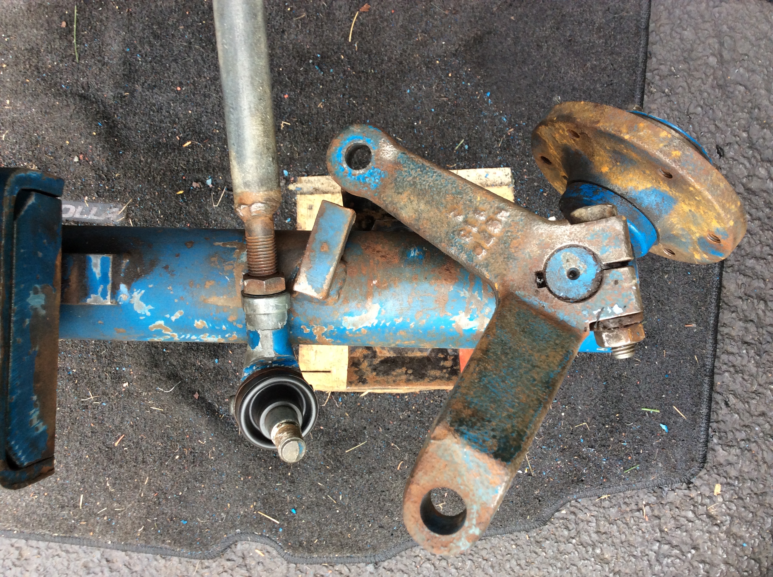

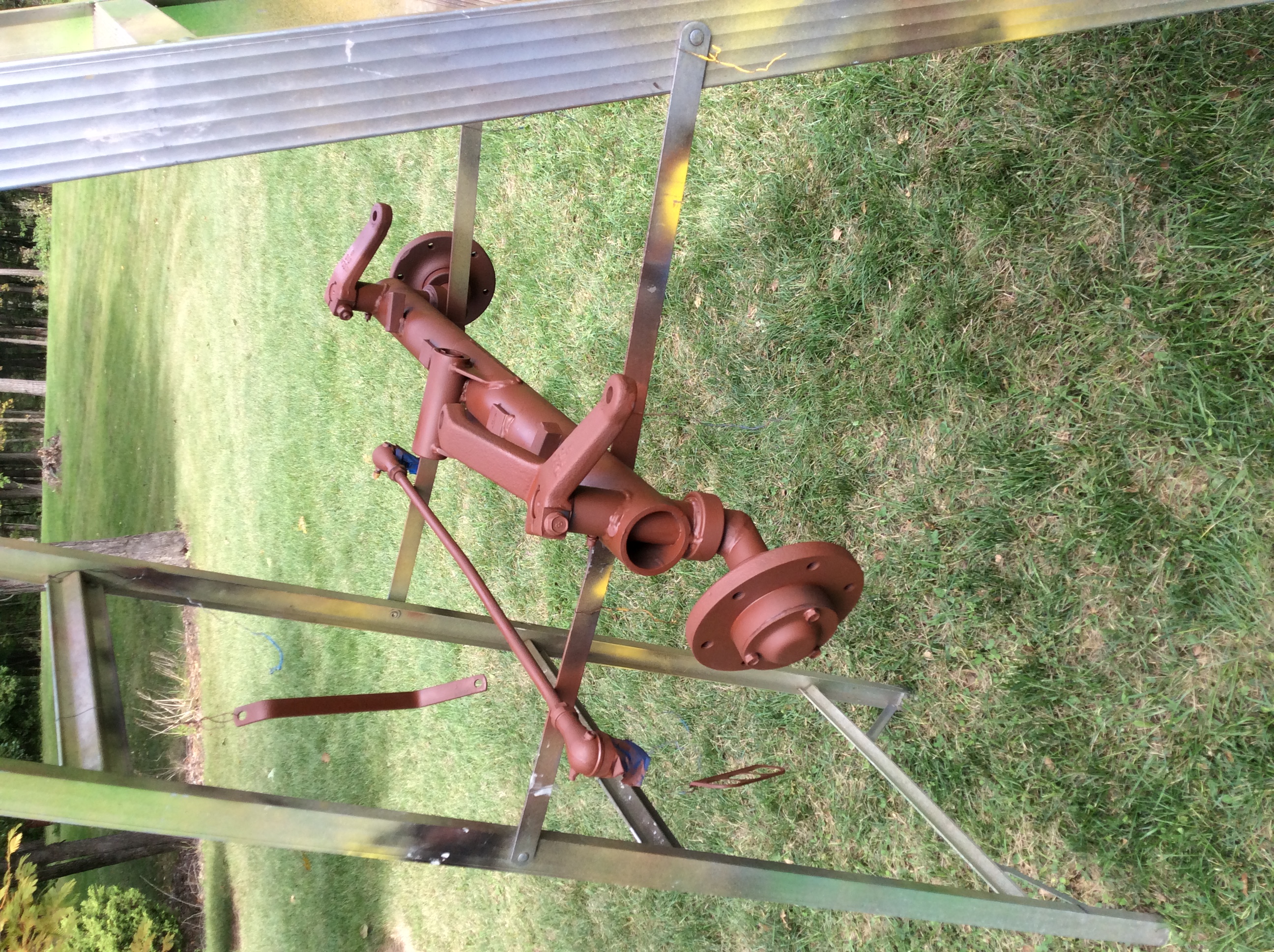

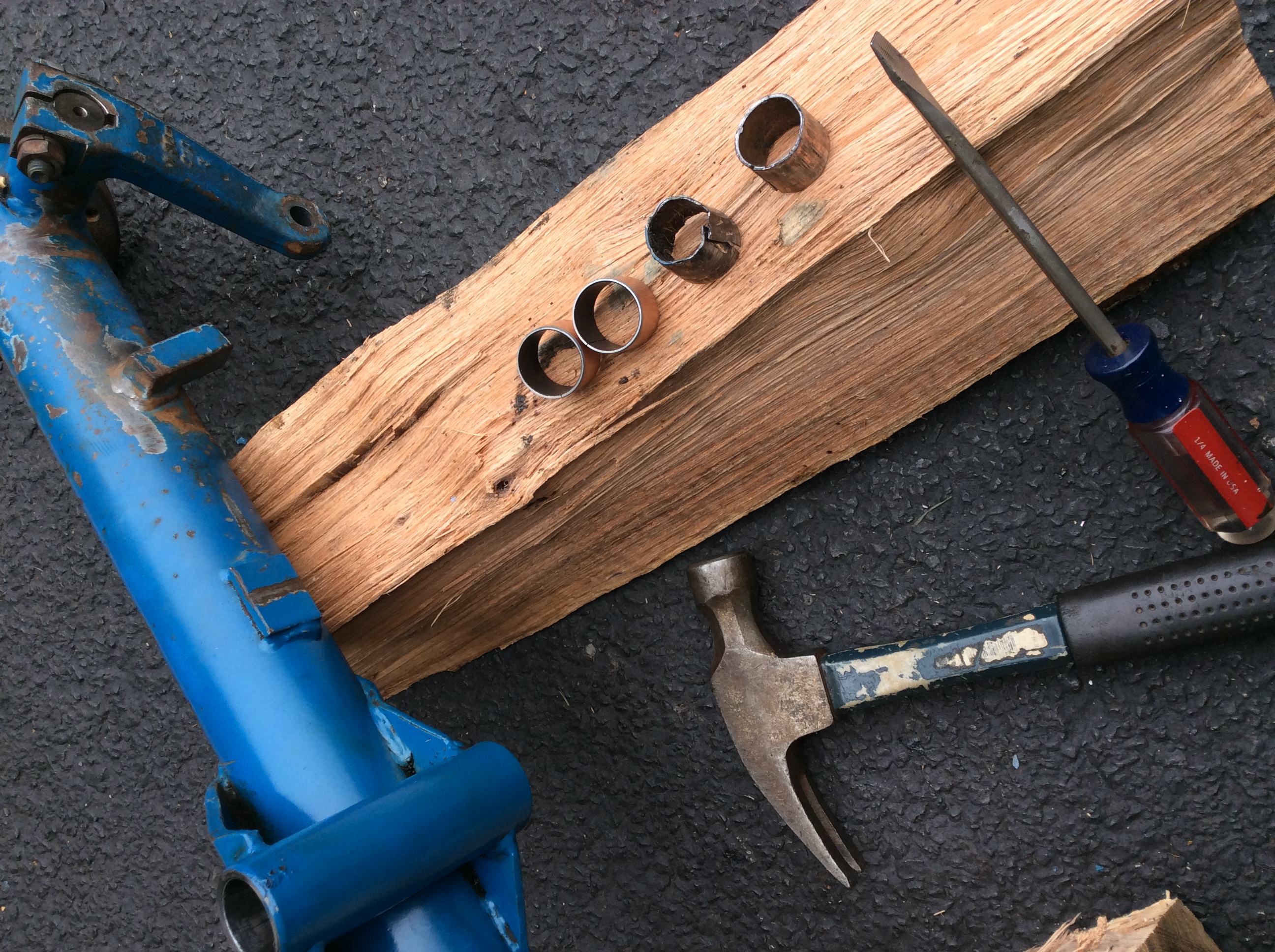

Some work on the front axle today.
Removed the axle to replace the bushings.
A side by side of the old and new bushings. Since I don't have a press, I had to collapse the bushing on itself with a chisel and screw driver. Was then able to drive it out from the other side.
The new bushings installed. They don't seem as robust as the old ones.
I was going to replace the left side spindle bushings too as there was some play (1/8-1/4 inch) in the spindle. After inspecting the bushings though there was no discernible wear that I could see, so I left them alone.

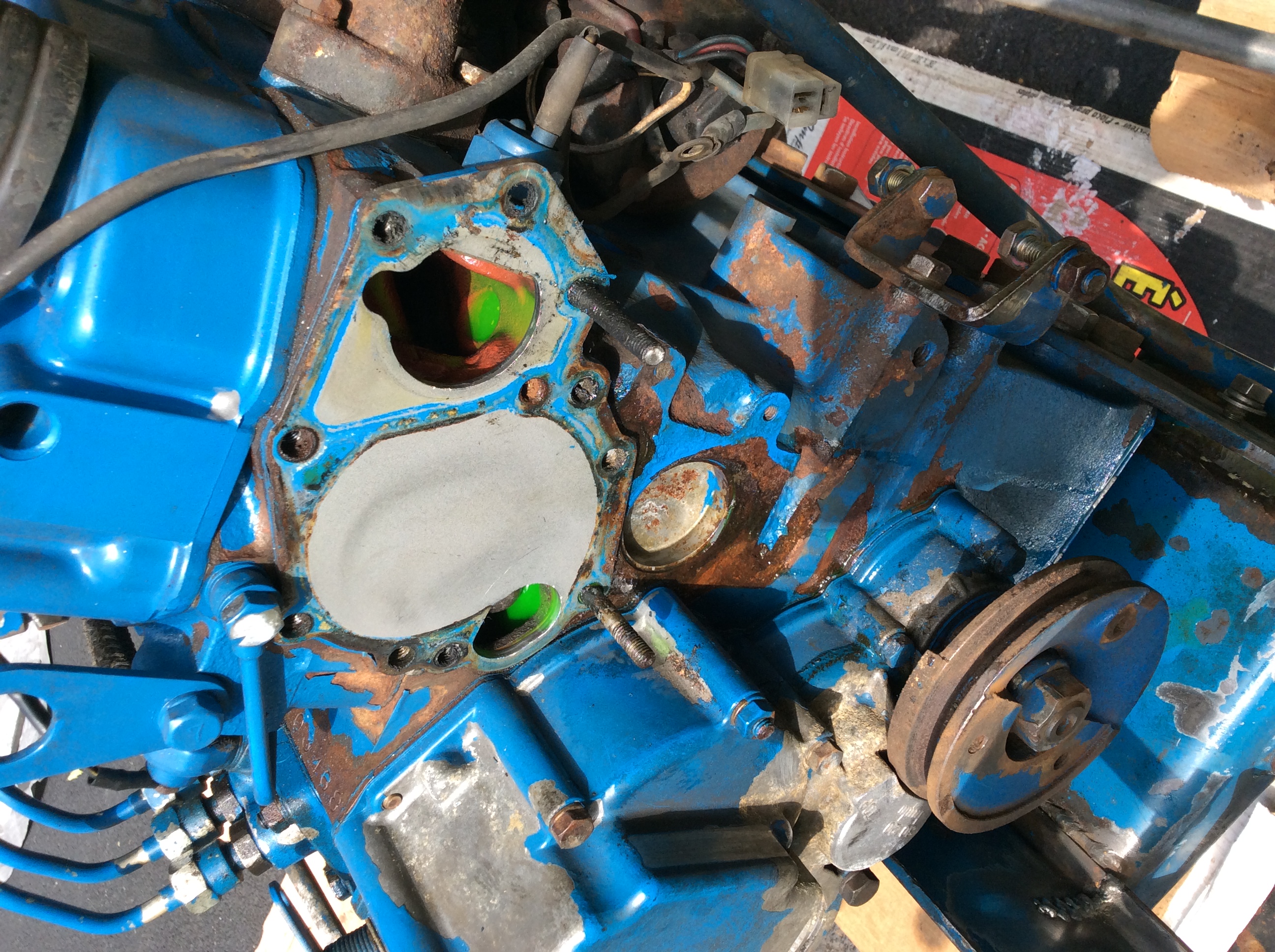

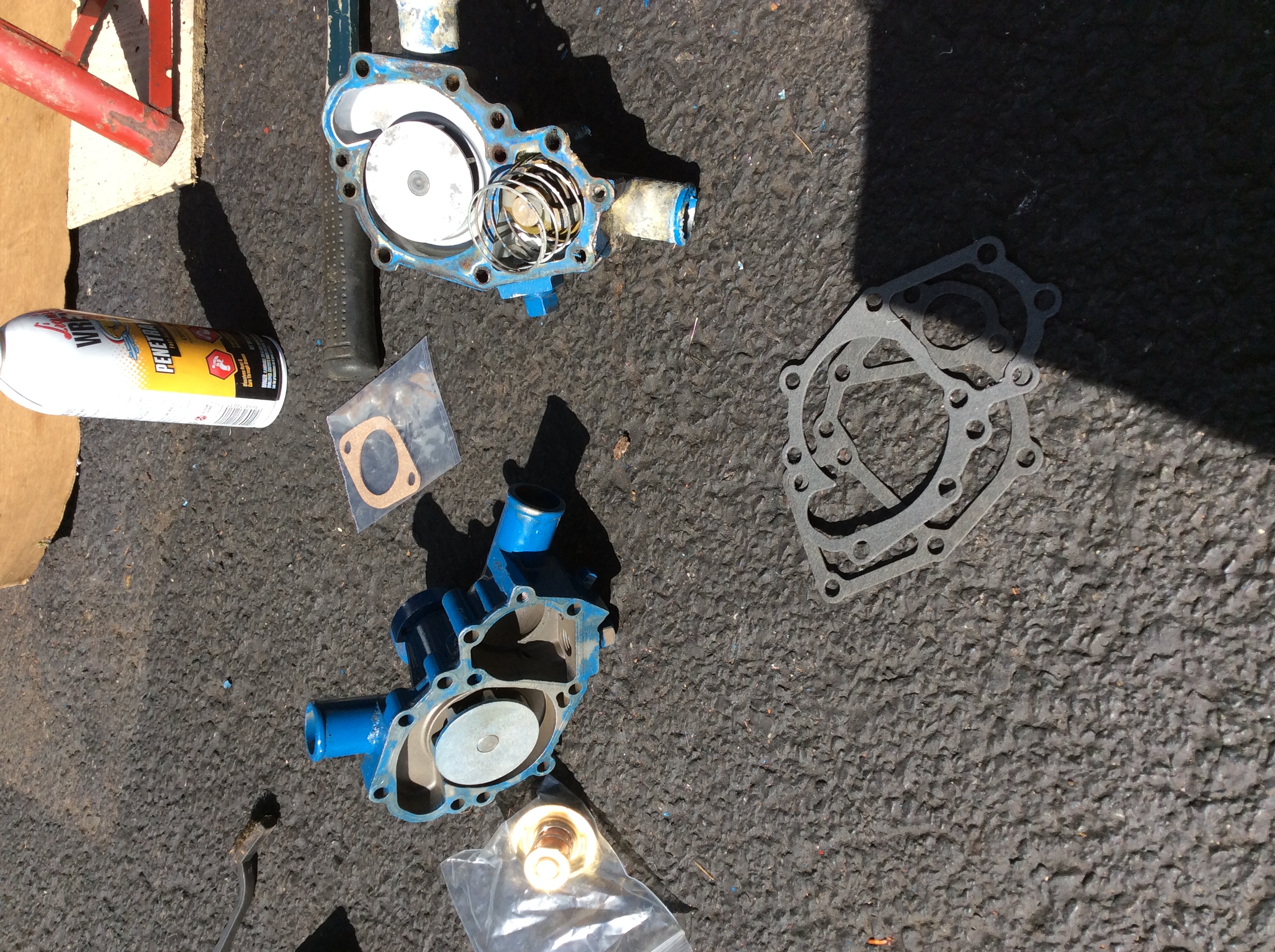

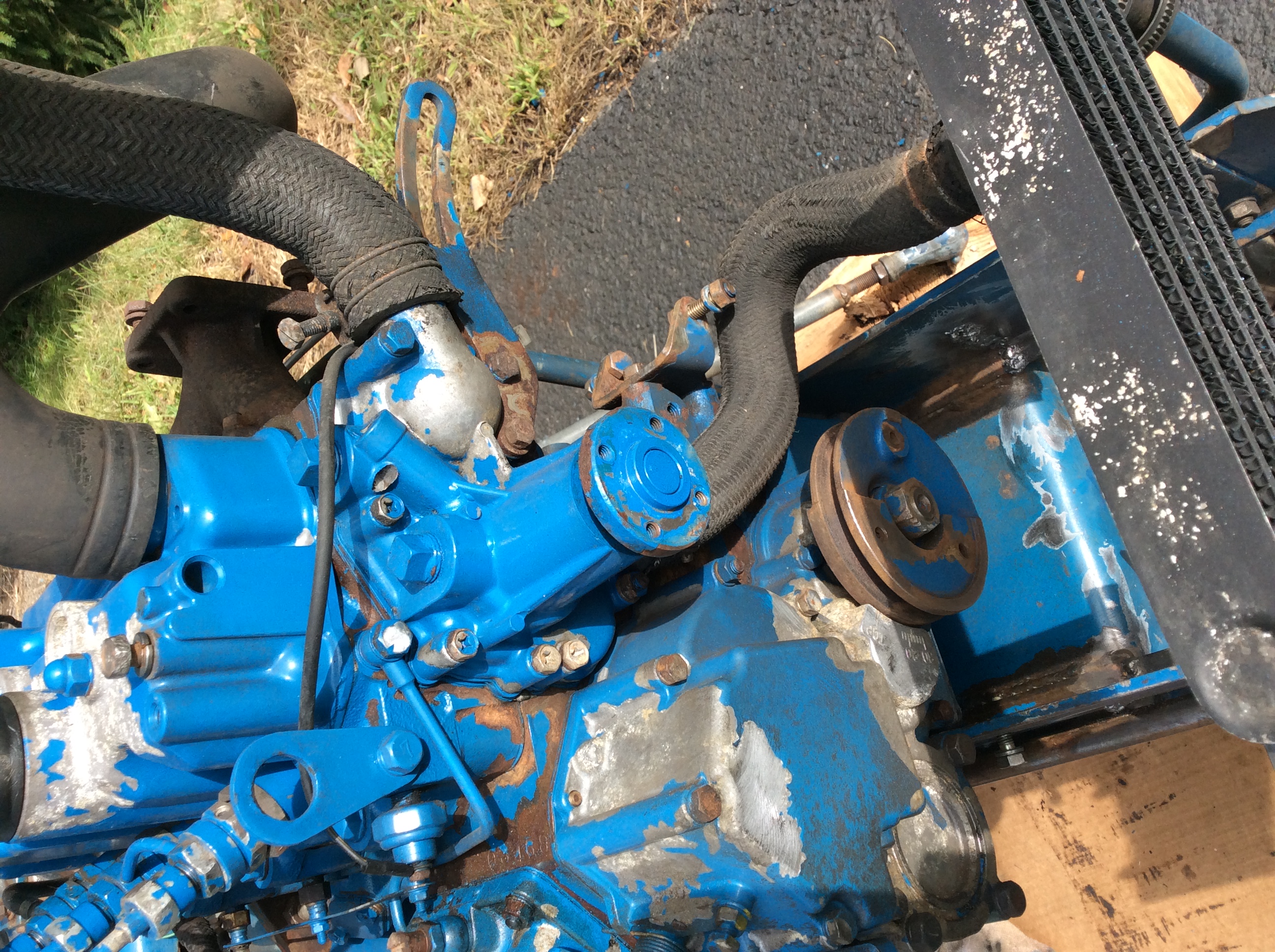

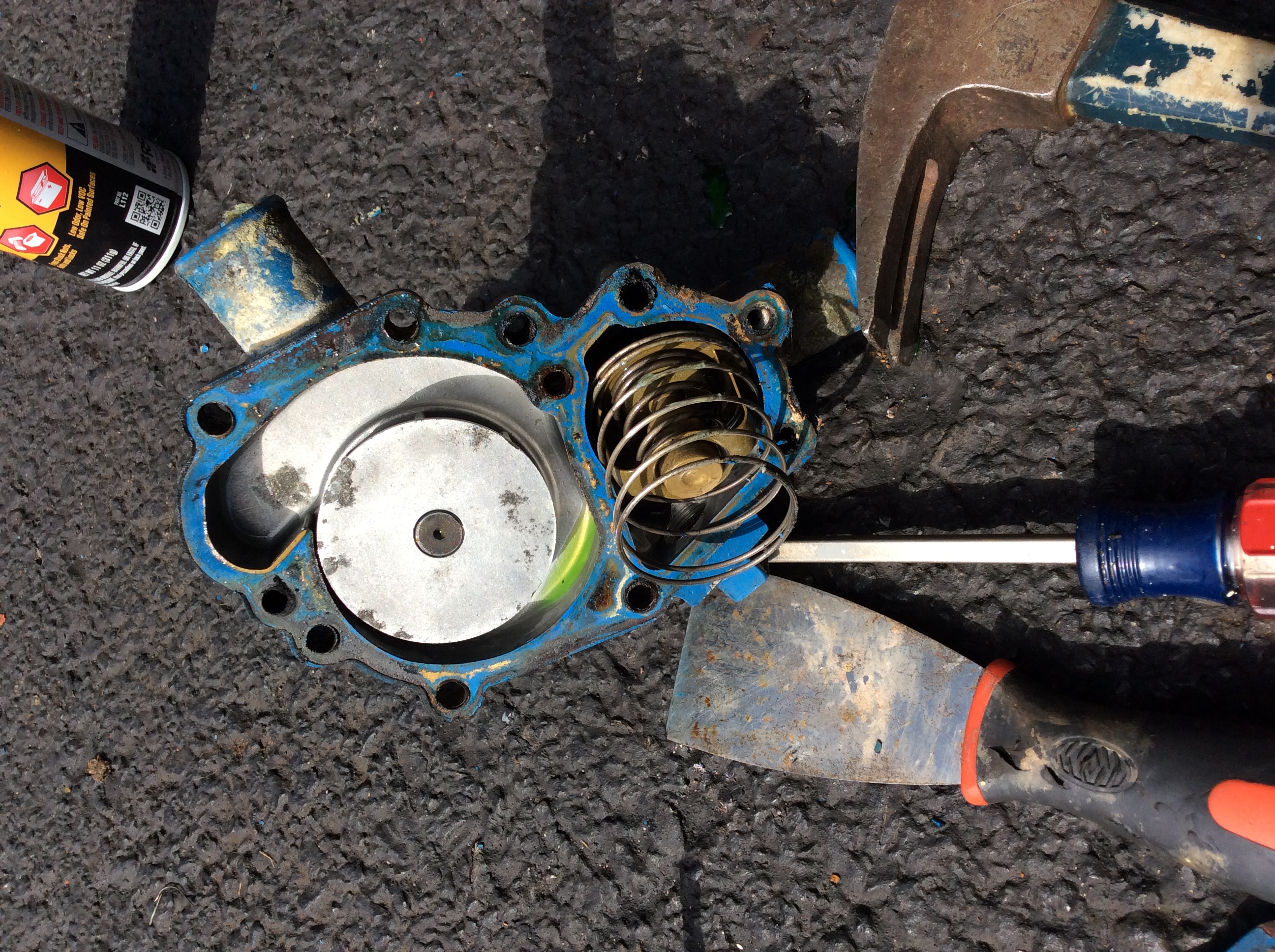

Also started on the water pump.
The first bolt I tried to remove broke off in the head...great!

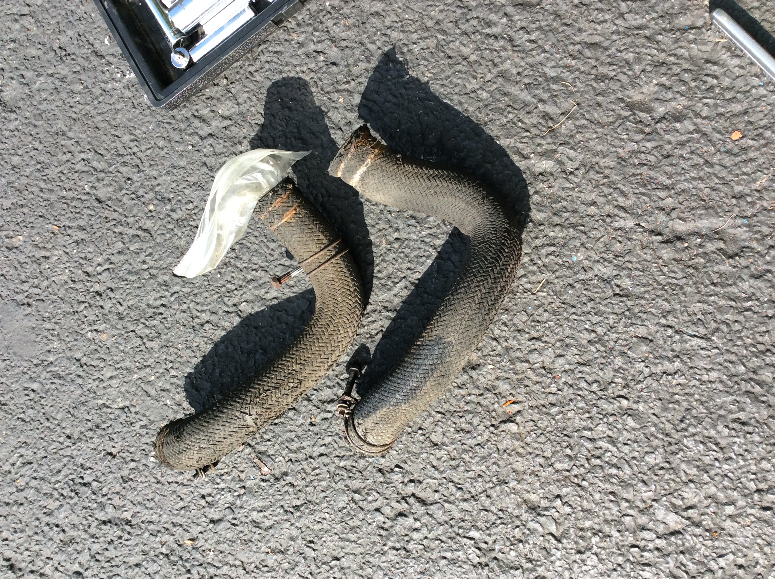

Pulled the hoses off and found lots of corrosion around the neck of the bottom hose barb.
After breaking the first bolt off the rest came out with no problem.
After lunch the new t-stat and pump go in.

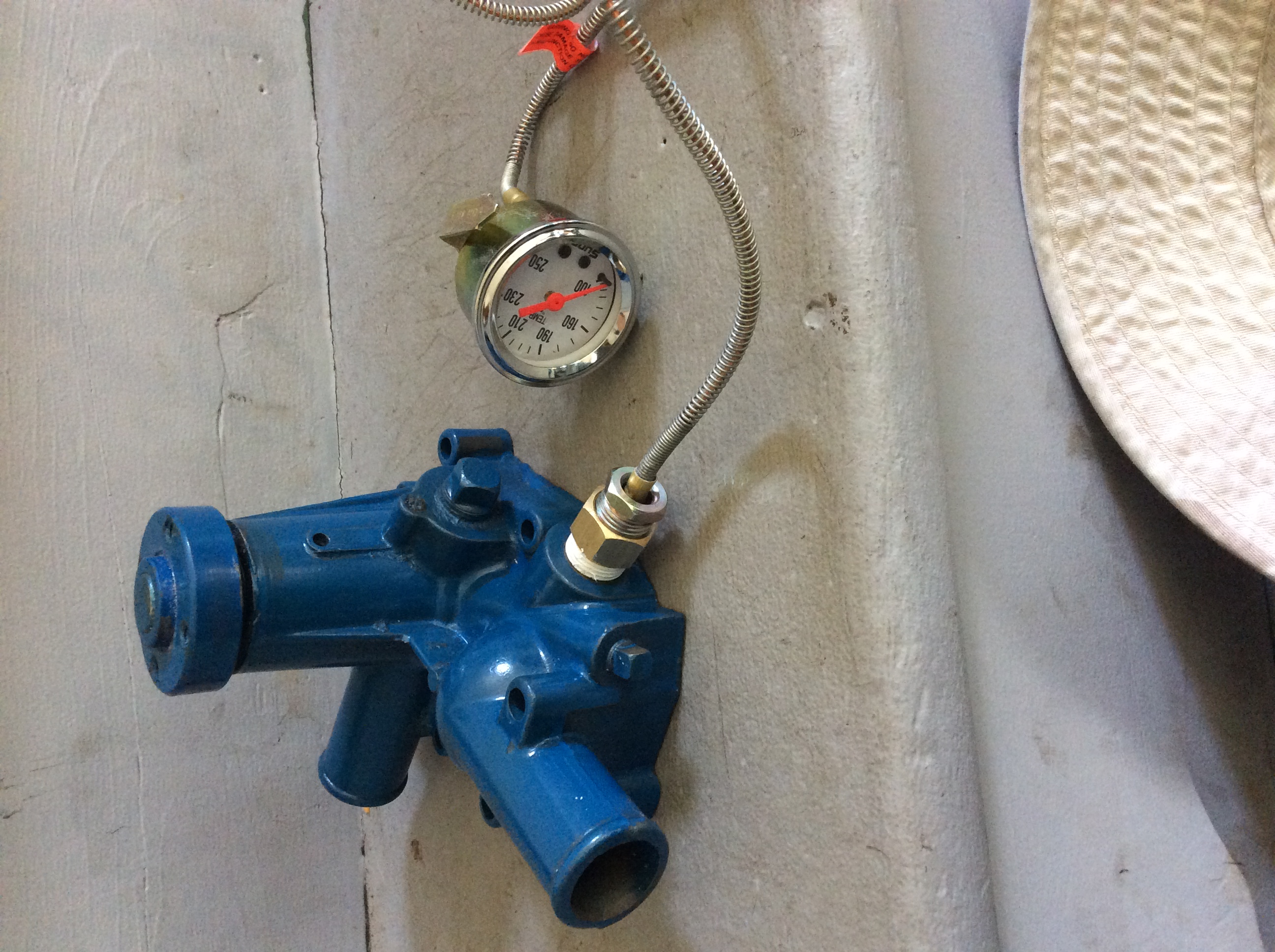

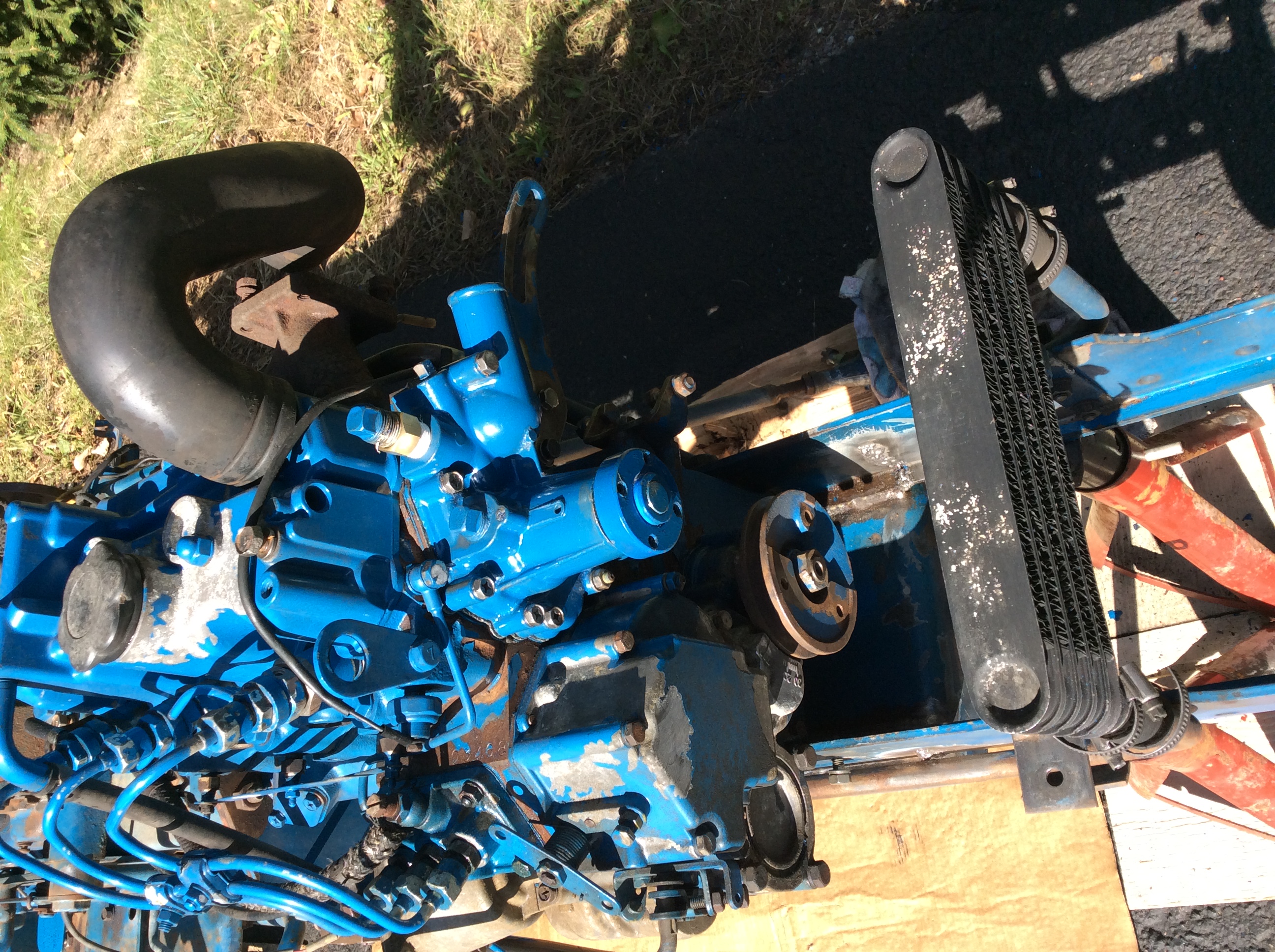

Got the water pump installed. Here is the old and new side by side. Also replaced the thermostat while in there.
Since these engines are prone to cracking heads if they overheat I decided to install a temp gauge. Will also be doing oil press, and volt meter.
All done and buttoned up. I was lucky and was able to get some vice grips on the broken bolt. Used lots of ant seize on the bolts going back in.

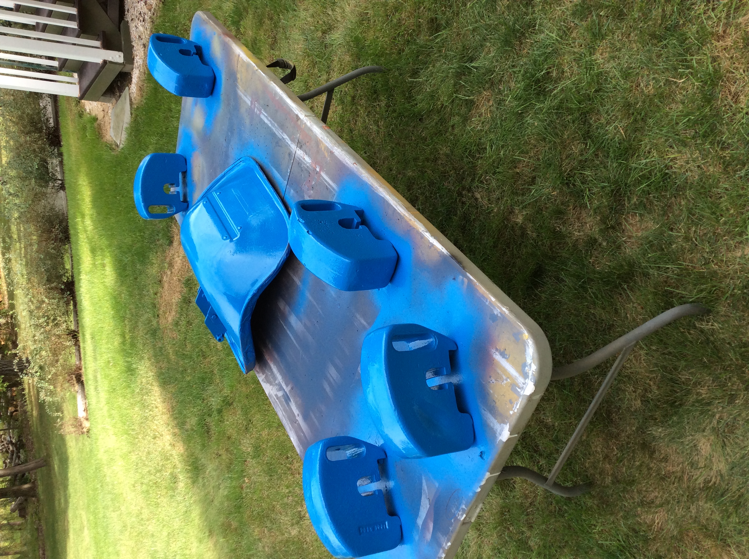

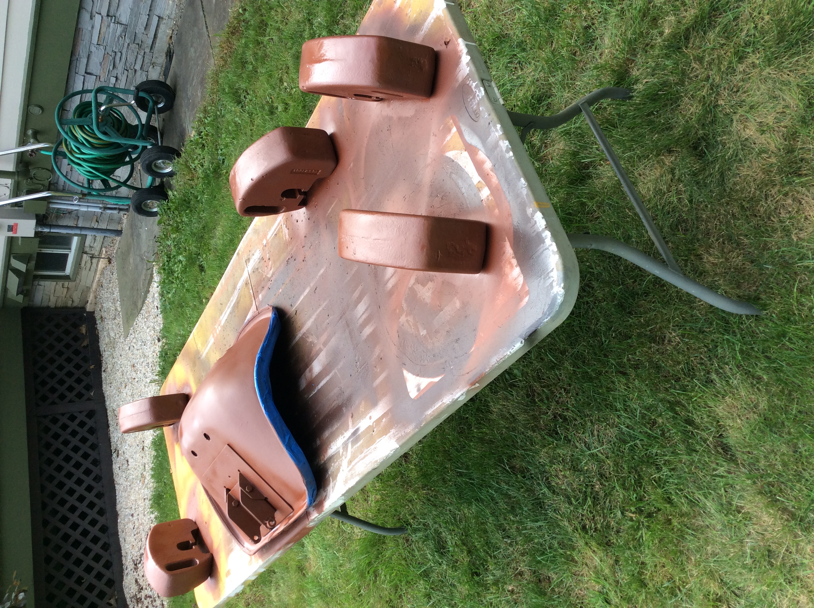

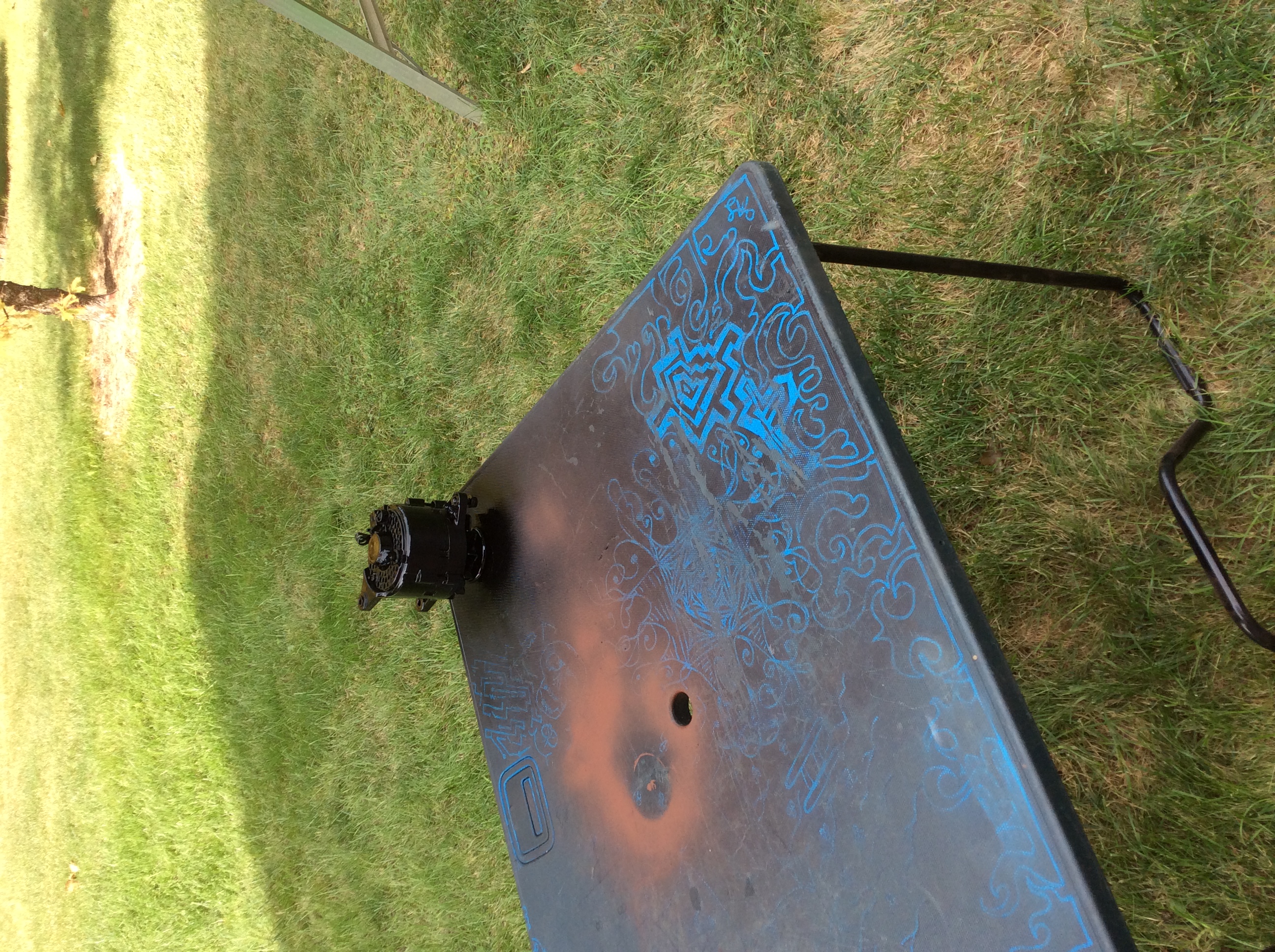

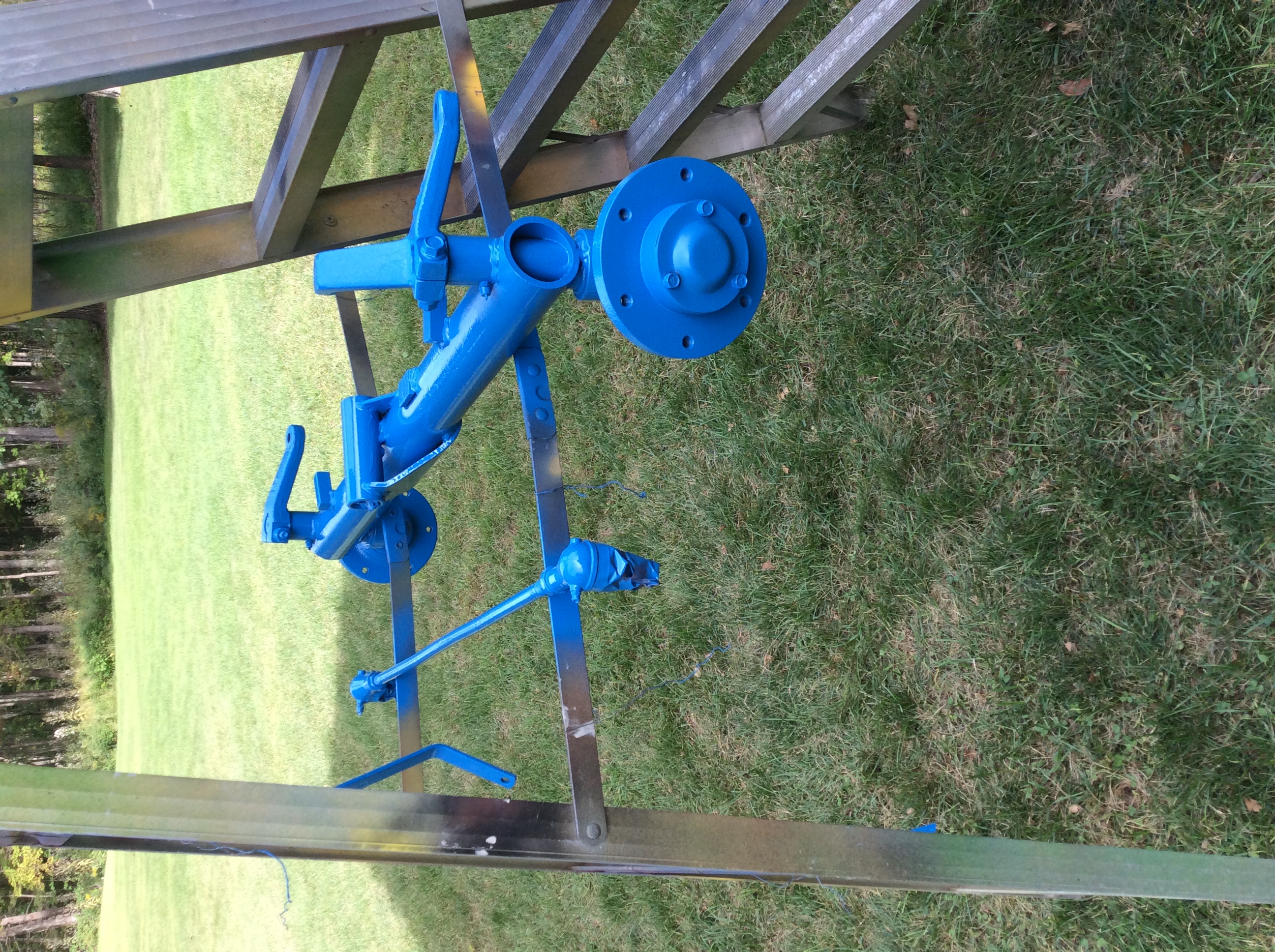

Got lots of cleaning and painting done today. All wiped down with mineral spirits, acetone, and primed.
All painted up with two coats.

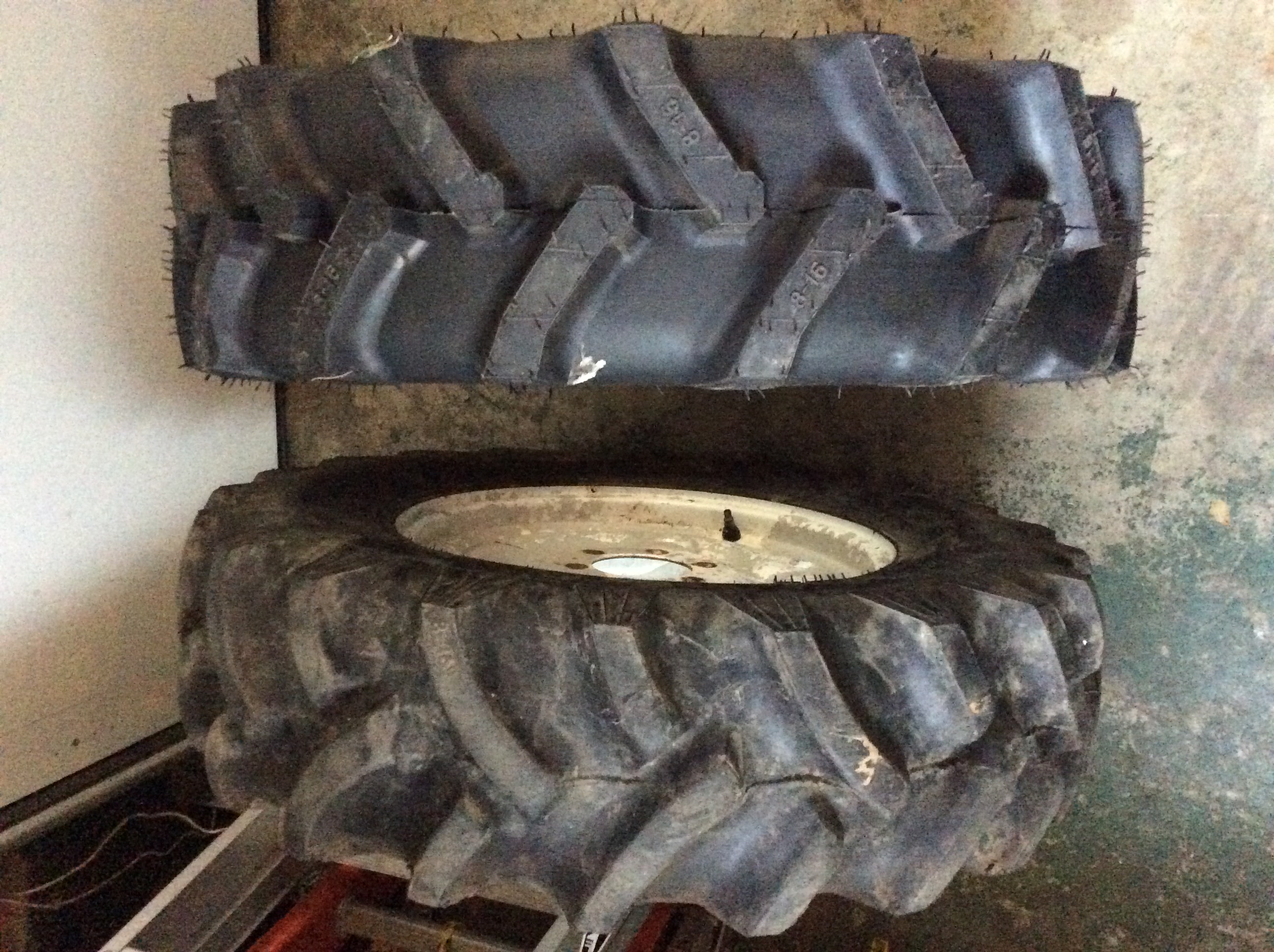

Also received my new rim from Kentucky tractor salvage. They shipped with the tire attached still, and it's loaded with fluid. So now my dilemma is whether to dismount this tire and install the new one I bought, or just leave it installed and paint the rim. Here is a shot of the tire, the tread is like brand new.
The tread pattern matches the tires I already bought almost exactly.
So what should I do here fellas? Change tire or leave it installed. It does have fluid in it which is nice.

If it holds air, use it for a spare. If you have 2 new ones you might as well use them.
