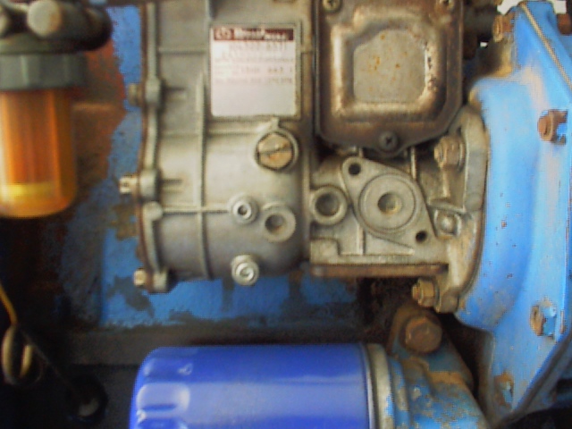

Yea ray I was thinking that too. Im not sure that that picture was with that same group of pictures of the disassembled engine but it might have been. Ok heres what we need to do........all you 1700 owners without the drain plugs, go ahead and pull your motors apart, we need an answer! LOL.
If the oil came from the front, there would have to be an oil journal, a tube, or a splasher of some sort to get the oil through the front of the pump. That would mean alot of different parts that those pics dont show. I have a feeling that if a guy who does not have the plugs, needed a timing cover (or a backing plate for the timing cover) for whatever reason, and he told the parts guy that he did not have the plugs, the parts guy would probably give him the cover like the one in the picture anyway. Mostly because there is only one part number, and the list doesnt specify a secondary type of cover. And if he needed the pump its self, it looks like the same thing would apply, there is only one number listed for the pump (at least on the new holland parts list). The pump would not be able to be fed by oil pressure without a way to drain the excess or it would just over flow. Do any of those plugless pumps have any extra oil lines coming to them?
Is it possible it is lubricated buy the fuel?

Like I said above TB...I am one of the "plug-less" victims and there is NO other connection (save the fuel lines of course) between the injector pump and the block. I also had a thought that it may be lubed by fuel, but it seems there would have to be some metering device to just let so much in and then you have to do something with it when it gets dirty.

I know this is an "aged" thread, but I finally got around to fooling with my tractor again. The question as I recall was....."to plug or not to plug" the 1500/1700 injection pump. I went ahead and plugged mine with 1/16th. NPT plugs. The upper one in the center of the pump is pretty useless, as I see it. It would be very hard to fill through that hole, but it could be done. I do know that if you consider it as a check-for-full opening...it takes around 5-6-ounces for it to run out that center hole, which is too much oil.
Like others suggested, I simply greased my bit...took it easy and drilled the holes. I followed those up with a well greased 1/16th. plug tap and then flushed it 2-3 times with diesel and then flushed it another 2-3 times with motor oil. I plan to change it as soon as I get a few hours on it.
There is plenty of boss on the case for the 1/16th. plug. After I carefully drilled each hole, I checked the depth and discovered that there was fully and inch-or-more of free-space between the case and the back of the hole before I came into contact with anything.
Photo attached and I am now "plugged".

We're indeed relived that now you join the rank of plugged people:):) Was 2 to 2.5 oz the amount of oil you needed?

Good job Old, its definitely better to know you have oil in it than to wonder why there were no plugs and have it go dry.

JC....based on your recommendation...I have around 2 1/2 ounces in there. I know for a fact that much more than that is too much. I am reasonably sure this tractor had not had any service in that area since Adolf ****** was a corporal and I only drained-out enough to barely wet the ground the fist time I checked it. I think there was one guy her someplace in the thread that measured a 4-ounce output when he drained his, but I am not sure if it was a 1500/1700 or what. When I put that much in this thing...I swear it looses rpm and that can only be oil dragging down the weights. I am a self anointed rocket-scientist (like all would-be tractor mechanics) and that's what I think anyway.
Besides my now being "plugged" I can drain and fill as often as I want to.

On 1700 thee is no physical connection or overflow between the pump body and inside of crankcase( at least not on mine and several of the oother 1700 owners here). Putting 1/2 quart of oil will fill the pump completely to the point you will have leftover oil to pour and as the result you'd start overflowing/overfilling from the top. The recommendation is to fill from top while the level hole is open( the level hole is between the drain and top fill). As soon as oil start seeping out of the level hole then you're done. There are tractors that hyd pump share the same oil in crankcase but 1700 is not one of them.

I admit to being way down on the list of tractor experts and most of what I have learned has been off this forum and the school-of-hard-knocks. I can only say that I have some pictures that came off one of these threads that show the oil seal on the injector pump-shaft where it sticks through the housing. There being no other physical connection between the pump and the motor....oil can't get past that seal.
