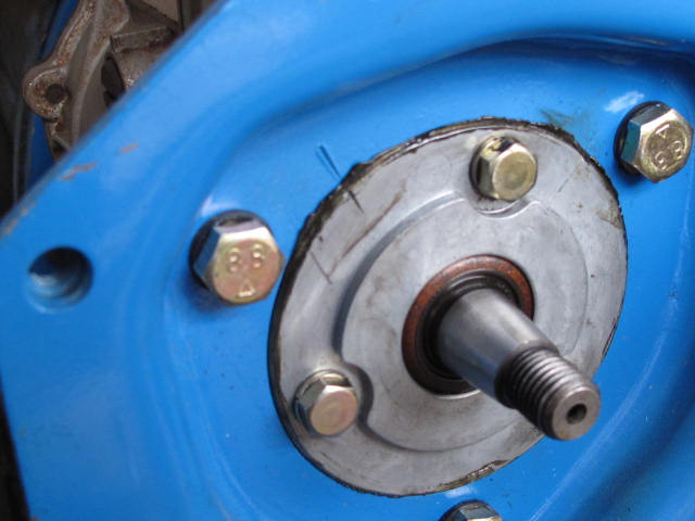

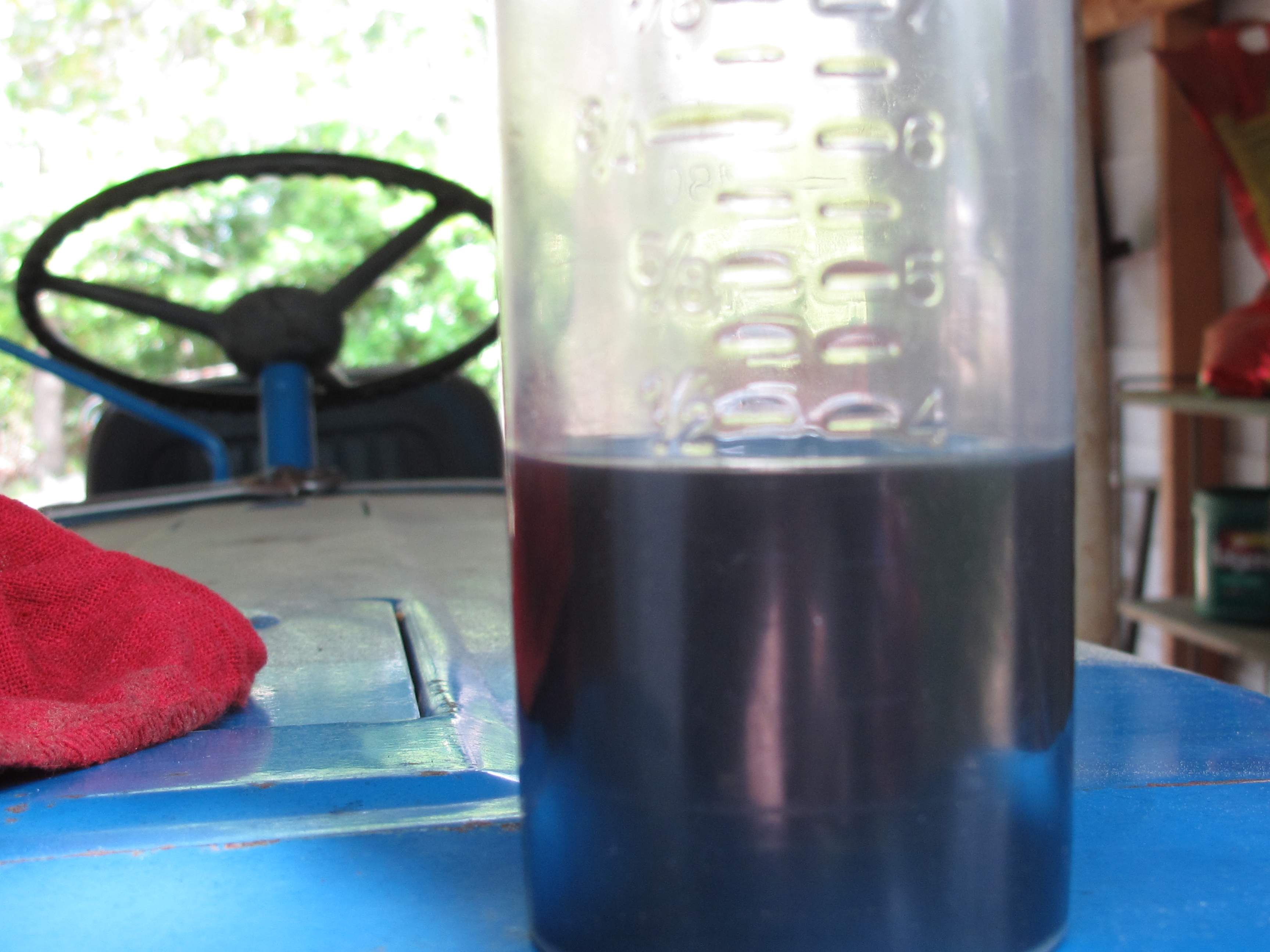

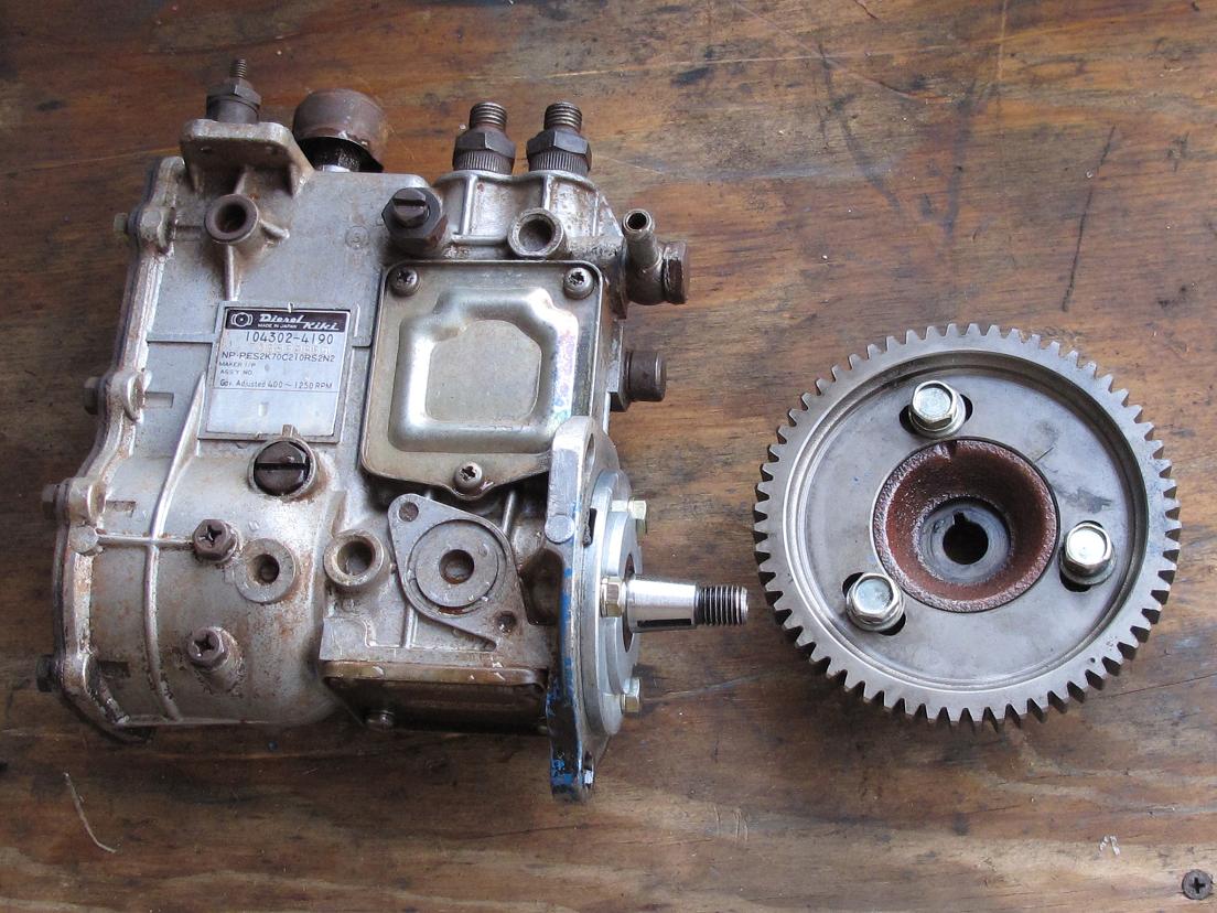

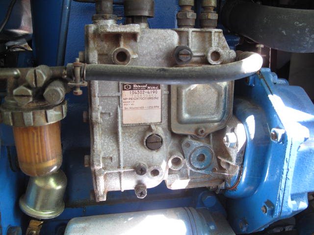

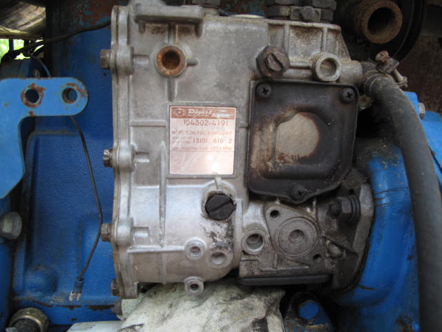

The 1700 that has the injector pump without fill level and drain plugs is a parts tractor. If I drained the oil there is no way to tell if it was the correct amount.
Here is what I have done on the 1700 with fill level and drain plugs. First I topped off the injector. Second I drained it into a measuring cup. The oil volume is just shy of 4 oz.
In the pix below check the P/N of the 2 pumps. The one with plugs is -4190 and the one without plugs is -4191.
Russell

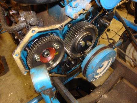

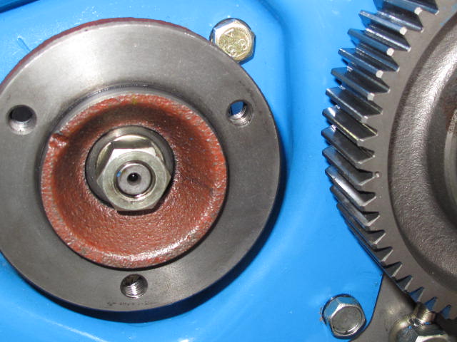

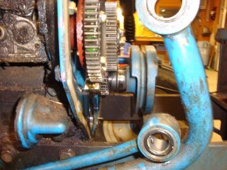

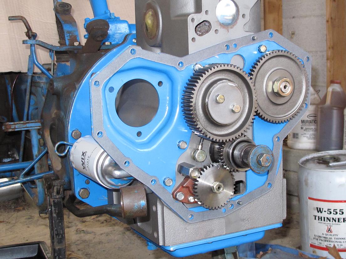

Ok guys, check this out. Here is some pictures of someones 1700 motor apart (thanks to whoever posted those). You can see where the pump bolts on from the backside of the timing cover. Dont see a good way to get oil in the through the front of the pump. Just an observation... TB

   / Ford 1500/1700 injector pump #59
I did notice in the (pump only) picture that the pump has the drain & check plugs. Is it possible that the pumps without the plugs are built different on the inside of the engine? I bet there are some Ford mechanics online here that know all the answers to the questions we are asking.
   / Ford 1500/1700 injector pump #60
Good work there TB. And....there is no connection anywhere on the pump to the block except right there where it bolts-up to the case.
