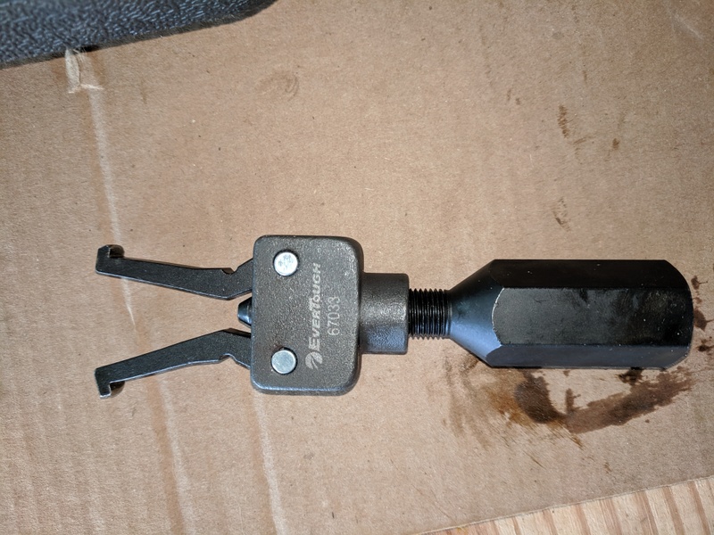

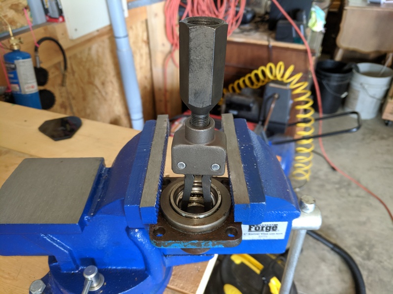

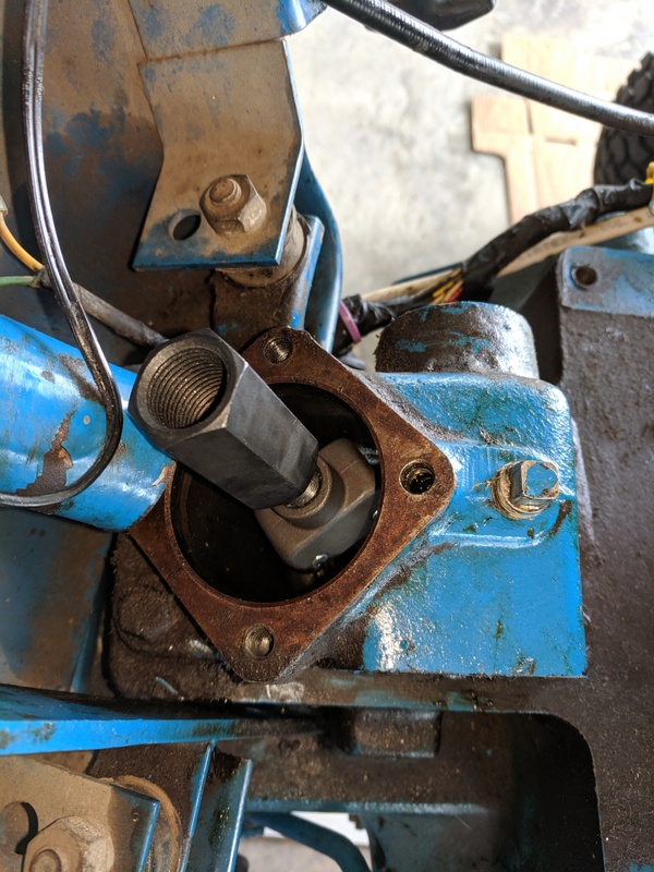

Also... how easily does that release bearing come off? do I just use a puller?

Totally meant pilot bearing, but I might try getting it out with hydraulic action using grease instead. Haven't decided yet. Thanks for the pics! I'm sure we can get it out.
