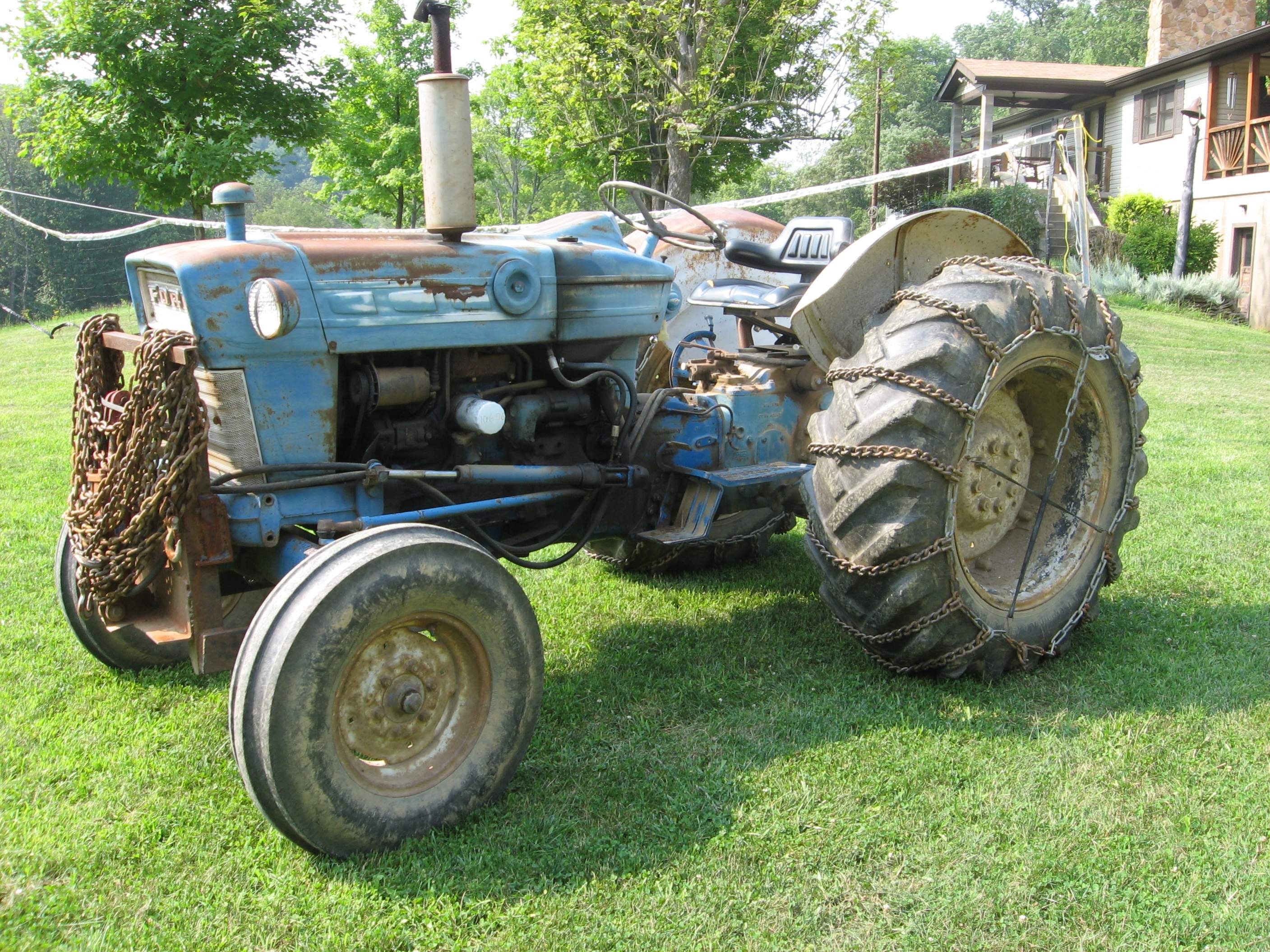

Here is my uncles '68 4000. Originally it was a gas tractor but the owner converted it to diesel some years back.
Has the air cleaner sticking up out of the hood in front and also on the side of the hood drivers side-I'm confused??? Was there 2 air cleaners??
The two air cleaners?? is how this tractor came with the gas engine

Soundguy I'm still confused. My uncles tractor has the filter sticking out of the front of the hood and also the round filter thing on the drivers side. Is one not a air filter? See the pic I posted. That is how it came new.
/ Ford 2000 Question #10
I see a mushroom style inlet breather cap up front, and a cover for a dry air cleaner filter access back of the hood.
are you saying it also has a dry air filter canister or oil bath air filter sump under the nose too? or is the dry air filter back of the hood it's only filter canister.
the mushroom cap is an inlet... not a filter per se...
